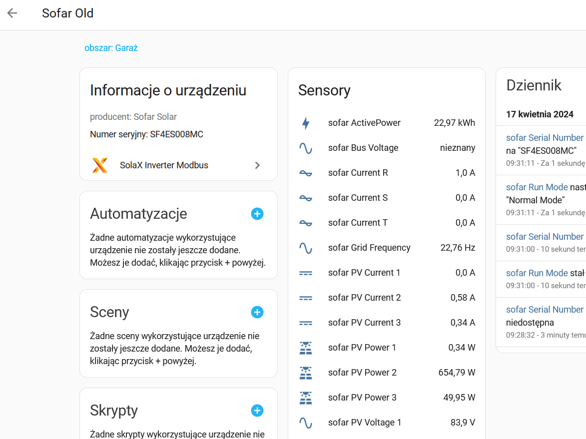

    Hi, I have a home assistant server, a Sofar 8.8ktl-x inverter (2g with a large screen) and an RS485toETH waveshare converter, I made a cable, connected everything, configured the converter. the stairs started when looking for any working integration. Either they are written for a Wi-Fi logger or for Modbus but ESP32 + UART converter. There is no integration for native modbus, I found one ("SolaX Inverter Modbus") but after selecting the sofar_old profile, the entities are terribly mixed up, and with other profiles it returns nothing. For me it works using RTUoverTCP, I`m trying to create the modbus.yaml file, in the worst case I would only need:
    energy produced today,
    current power,
    AC voltage on 3 phases
    and status (normal/gridOVP)
    using https://www.linuxiarz.pl/2323/sofarsolar-ktl-...-monitoring-twojej-fotowoltaiki/?noamp=mobile
    and
    https://www.home-assistant.io/integrations/modbus/
    I made something like this:
    https://paste.linuxiarz.pl/view/f5052273
    Could someone help me standardize these first few lines to make it work?
    Now, at most, from existing integrations I get the following crap:
    Screenshot of Home Assistant interface for Sofar inverter with reading data.

    first of all, change the update time to 5s, because miracles happen in 1s
    take a look here https://forum.arturhome.pl/t/monitoring-sofar-solar-rs485/9251
    and check if your registers are correct,
    first, delete everything, put one register to read, one of which you are sure of the result and check if it works properly

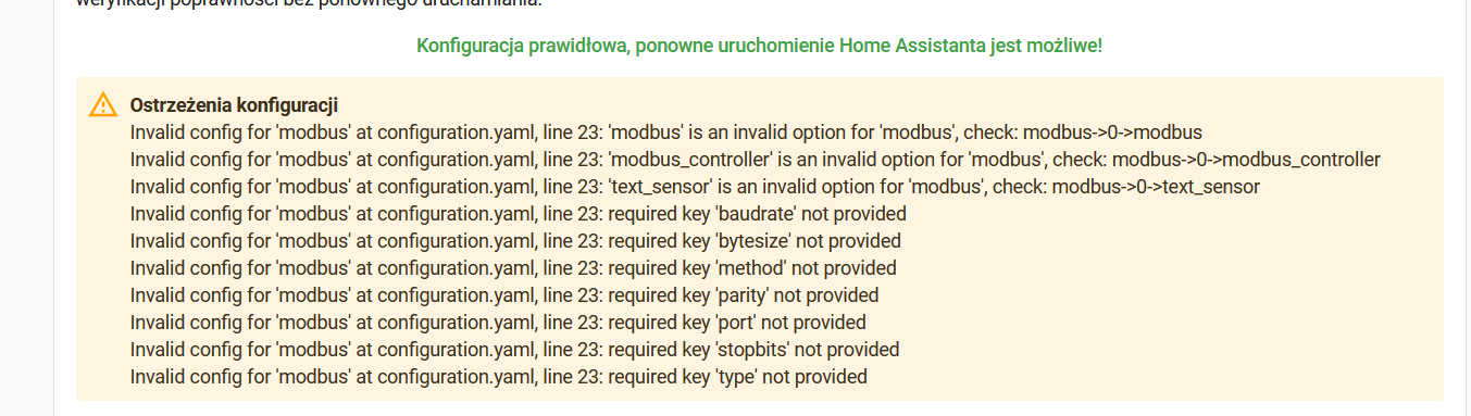

    Screenshot of configuration warnings for Home Assistant.
    and this? rather, there is a problem at the beginning
    Besides, I don`t want to use mqtt or nodeRed here

    well, if you looked at the documentation, you would know that you did the configuration under ESP and you do it in HA
