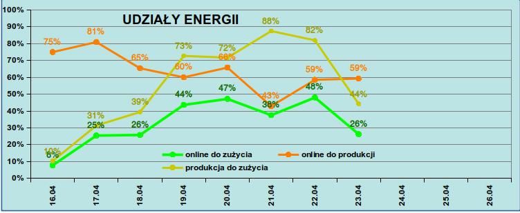

    Marian143 wrote:
    ... Excuse me, I wanted to ask if in the subject of heaters and adjusting consumption in REAL TIME to production and bypassing the maximum accumulation in the network, something has been achieved?
    Well, I'm far in the field right now. I haven't finished the installation yet...
    I'm constantly inventing and changing things, blessing my pace at the moment. :D
    The plan is that in the additional 80L boiler connected in series BEFORE the old 100L
    heat water with a 3x1.5kW heater controlled by Arduino or Rpi based on temperature measurements
    in the boiler, central heating and hot water AND for online information from the inverter. I also want the heat from this water via
    introduce the coil with a separate pump Alpha1 (PWM) to the central heating
    Knowing life and my plans, it will still take time, although I will solder the tubes THIS week!!! :D
    Later I'll plug it in briefly to consume my surplus energy during the season, in the meantime getting distracted
    communication with SOFAR. That's my plan for the pandemic.
    Of course, I will be proud of the success, if it happens. Probably a failure too, looking for a helping hand / brain.
  • Question about Tauron AMI-Plus meter access and Wemos software
    #33 19275065
    Marian143
    Posts: 10
    TadekK wrote:
    Krzychooo wrote:
    .... adjust consumption in REAL TIME to production and avoid grid accumulation as much as possible. ...
    All information is collected in real time. I could - if it would give me anything - make any control based on "instantaneous" values ... I have the production state sampled every 10 seconds, the consumption state I sample at the moment (RESTem) every 10 minutes - but I can change it freely. I do not need consumption data more often, because my installation is too small (too small roof ...) for my consumption ... So I never have "overproduction" ...
    And I do it so that it counts for itself and I don't have to copy anything to the spreadsheet once a week..
    In my solution, I have several very nice formats showing the operation of the installation - including the calculation of the "production capacity curve of the installation" as a function of the current time (the algorithm calculates the current angle of incidence of sunlight on my panels from appropriate astronomical formulas ...).
    Sofar Solar KTL-X Inverter: RS485 MODBUS Integration with Domoticz - Setup & Tips [90]
    I like such intellectual games - being a retired IT specialist, I prefer to show off something impressive on WeMos D1 mini Pro (ESP8266) than to solve crossword puzzles ... The cost of all the equipment necessary to carry out my needlework does not exceed PLN 150 ...
    I did not include the price of the MEW-01 meter above (it kills a bit ...), but I am having unofficial talks with people from Tauron to be able to read my meter through their "AMI-Plus interface" and be able to eliminate the "MEW-01 doubling Tauron". ..
    Hello, I like your design. Soon I will also have an installation with Sofar. The question is, did you manage to get along with Tauron "to be able to read my meter through their "AMI-Plus interface"?
    Can you share the soft for Wemos?
  • #34 19382508
    FrankAB
    Level 20  
    Posts: 294
    Help: 29
    Rate: 63
    Krzychooo wrote:
    ...Of course, I will boast about success, if it happens. Probably a failure too, looking for a helping hand / brain ...
    Be proud of your progress.
    I am doing something similar to your idea.
  • Heat storage test shows 4.5 kW system works well
    #35 19382768
    Krzychooo
    Posts: 141
    Rate: 30
    Prego.
    The current state is that the tubes are soldered, leaks removed ;-) pumps and heaters temporarily connected for testing,
    which has been going on for several days. After these few days, however, I can see that the concept is OK, the system works smoothly and efficiently.
    It's only 4.5 kW (3x 1.5), but it manages to heat 180 liters of water (100 liters in the old tank + 80 in the new one in which there are
    these heaters. The old Wilo circulation pump (28W) after descaling is able to push it through the system and equalize the temperatures
    to about 45-55 degrees. If the circulation is not working, I reach about 78 degrees, including 80L. Then the heater does not heat.
    It has its own thermostat and safety features so keep it that way.
    The Alpha1 pump pushes the central heating water through the coil in this tank (80L) and calmly achieves the parameters required for me, i.e. about 32-36 degrees.
    I have floorstanders everywhere and 3 cauliflowers in the attic, but they're Radsons on steroids so that suits them too.
    I will add that I now have 3 heat sources in the system, because there is also a propane gas stove and a water fireplace next to it.
    Everything works independently, but... each needs electricity.
    In general, the concept has worked (so far) and it seems to be a good direction. The experiment was not expensive, because I planned anyway
    an additional container, and most of the pipes and fittings I had "in the box" so it was cheap.
    Now only until winter I have to do the rest, i.e. AI ;-)
    Of course it's my ai it'll just be a bunch of Nano's (Atmega328) that will communicate (somehow, haven't decided how yet)
    and they will have the task of embracing this chaos. Why several and not one? Because they are ridiculously cheap, but they have little space for the program
    and data. In addition, such a system will be more resistant to errors and failures. If the soft or the board (made in prc) breaks down from e.g
    pumps then heaters will continue to be controlled and the heat will not disappear. I think so. (I also have a dozen drivers for everything in the car
    so here's an example.)
    A separate topic is where to get the data to bypass accumulation in the "network storage". Originally, I wanted to take it directly
    with SOFAR, but the more I think about it, the more sense I see in adding a counter or something like "OneMeter" to the existing one
    to have comprehensive data on the current energy balance online and not to uselessly exceed the current surplus from production.
    A topic for thought and analysis. I have time until winter, because currently I have to consume my surplus online anyway, (for today
    is 3013kWh net).
    After receiving what is mine, I would like to bypass the accumulation as much as possible in real time - "in statu nascendi".
    After all, it is about at least a dozen or so percent (because it is unlikely to miss a full discount), and it is much more
    than the best investment in diamonds, gold or oil. :spoko:
    And without the additional Belka tax... ;-)

    Krzychooo wrote:
    ...Originally I wanted to take it directly
    with SOFAR, but the more I think about it, the more I see the point in adding some counter...
    To manage it sensibly, you need data from Sofar and the meter.
    I bought the DDS578MR on a well-known portal and thanks to my friend @starob I communicate with him from the Node-RED program via RS485.
    In the near future I will also establish communication with Sofar (now I don't want to run a wire through the whole house).
    Colleague @klon111 described how to download data from Sofar via LAN, but these are only data from his website, and RS485 is everything.
    The RPi will send this data to Micrologix 1200, and it will also use its own sensors to do the "dirty work" controlling contactors and SSR.
    I did the hydraulic part of the heating (a little by myself, a little with the help of professionals) during the conversion of the farm building into a residential house.
    At first, there was only a PER-EKO solid fuel boiler and a boiler to have hot water.
    When the professionals laid the underfloor heating, I placed an electric heater with a power of 1.7 kW between the boiler and the underfloor heating unit.
    We did not live in this house over the winter and to protect it from freezing for 5 hours on the night tariff, the pump and the heater were turned on by a time relay.
    Last year, parallel to the solid fuel boiler, I added an electric boiler with 3 heaters of about 2kW each.
    It had a room controller and 2 contactors. I completely changed its power supply and after connecting the heaters: 2 in parallel and 1 in series, it works in this heating season.
    At a temperature around zero, it heats 68 sq m, if it was cooler, I turned on the previously installed heater.
    With this combination of coils, I didn't have to turn on his pump; The underfloor pump was working perfectly fine, and at medium speed.
    In the autumn, 9.9 kWp panels were installed and I had some electricity, and I took a little more from the supplier and when more sunny days come, I will give it back.
    Now I will be thundered that I am not "eco", but what the hell.
    If there is no electricity, I have a fireplace, and connecting the heaters to the panels I tested during a few days between installing the panels and the meter.
    Before the next heating season, I'm going to start all automation.

    Krzychooo
    Posts: 141
    Rate: 30
    Episode two.
    As of today, a week after the launch of the initial "automation".
    Preliminary, because for the time being truncated from SSR to the heaters (I turn them on manually) and does not take into account any data
    with Sofar, because I haven't started communication with him yet. I also don't have any counter to read the data
    from the balance sheet, but that's less important.
    What conclusions?
    Having an initial algorithm (quite simple) to control the central heating circulation pump (Alpha1 PWM), the circulation pump
    and manual control of the heaters, and at the same time having a bad time for experiments because winter is coming
    ends and the heating season is rather symbolic, I have such an effect in the proportions of energy consumption as in the picture.
    Of course, the weather has a big impact on this graph, but you can still see something. Overall I'm happy with these
    data. We'll see what happens next. I have to polish the pump control algorithm and finally connect it
    these SSRs before the heaters, but today I connected the SD card to the system and collect data from all sensors
    temperature, PWM and circulating pump status. When the SSRs arrive, the power used will come to data.
    We will see.
    I now have resistance to hot water, right in front of the valve, and the floor is also evenly warm. Gas stove of course
    completely off.
    Maybe we should start a new thread, e.g. optimization of electricity consumption from PV ?
    The topic is interesting, broad and evolving as this technology develops.
    Moderator :please: will be happy, and we will avoid punishment and penance... :not:
