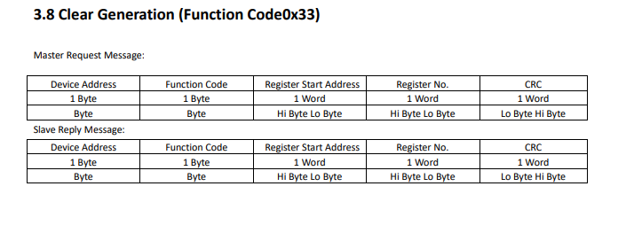

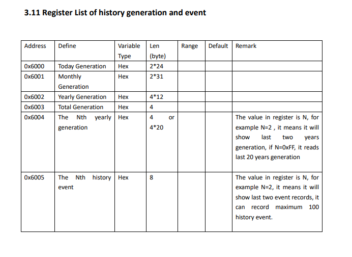

    xury wrote:
    how to clear production data in Sofar
    I can't give you an exact answer, but it might give you a clue.
    Sofar Solar KTL-X Inverter: RS485 MODBUS Integration with Domoticz - Setup & Tips [90]
    I do not know how to interpret this information, because, for example, one register 0x6000 can contain 48 bytes ;) ...and does this apply to your inverter?
    • SofarSolar Modbus Registry Details.pdf (1.14 MB) You must be logged in to download this attachment.
  • #272 20547066
    xury
    Automation specialist
    Posts: 7090
    Help: 878
    Rate: 1501
    Well, that's what I saw, there is no info on which register to send FC33 to
  • #273 20566331
    spin722
    Posts: 27
    Rate: 9
    Try the method as described in instructions
    Menu "1. Enter settings" - "2. Clear energy".
