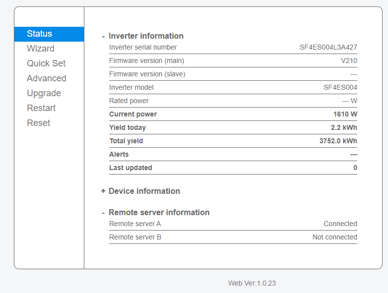

    A non-invasive method based on the so-called "scraping":
    1. Reading the status page and reading the values from the html code.
    The amount of information read in this method is poor. Apparently this is illegal.

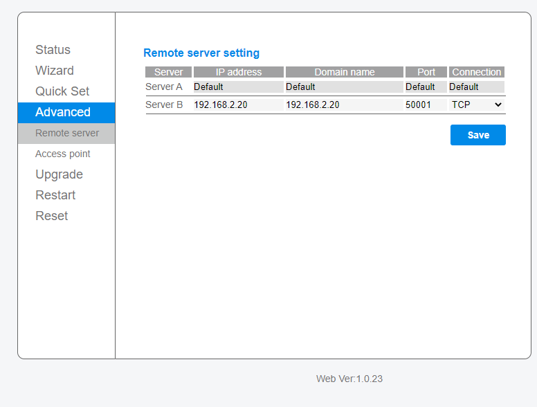

    2. Capturing data sent to the solarmanpv.com server
    The factory logger will send data every 5 minutes to the server whose address is permanently stored in the device.
    The trick is to redirect the data to another own server and decode it.
    This can be done, for example, by having an appropriate router by creating a redirection rule.
    I found many solutions based on this method on the net.
    3. People say that you can set any additional server address to which data will be sent.
    There is such an option in my logger, but I haven't been able to observe any traffic on this port.

  • Three non-invasive ways to extract logger data

    starob wrote:

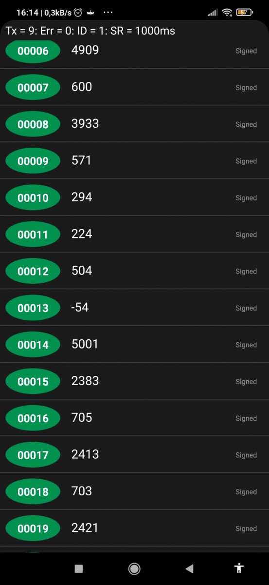

    for me, the script from my friend @klon111 reads the power value over LAN with 11-KTL-x every minute.
    Back to Modbus - the Micrologix 1200 controller reads data from Sofar through the adapter
    RS-232 to RS-485.

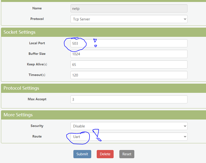

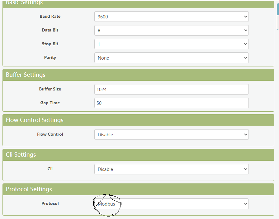

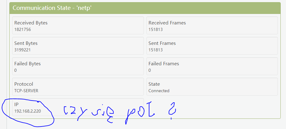

    I tested a ready Eth - RS485 adapter called Elfin-EE11A.
    The Master must be on the Eth side and the Slave on the RS485 side.
    In Node-RED I read 17 parameters from the inverter; nothing prevents you from reading more of them.

    I changed the concept of how the system works and I don't use EE11A anymore because it didn't want to work when Slave is on Eth side.
    The master is Micrologix; Node-RED is a Slave for it and also listens to RS485 communication with the inverter and meter.
    Node-RED puts the received data into MQTT; throwing them into SQL shouldn't be a big problem.

    If Node-RED is the Eth Master, EE11A works fine.

    #82 19596118
    OktawiuszZ
    Posts: 8
    Does your friend remember exactly how he had it set up?
    I'm already struggling with this one evening in a row, and due to Sofar's auto-sleep at night, there's not much time ... As for the speed, I have set 9600/8/N/1, RTU, DTR and RTS, on the rs485- usb works fine and reads data from the inverter nicely.
    The problem starts when I set the same parameters on EE11A - it does not read anything. As for the electrical connection, it's pretty much everything
    I connected it well, because the power is on, the ethernet part works, the RS cable is ok, because the USB adapter works. There may be a problem with a key parameter in the configuration or something related to the RS from the EE11A side ... That's why I'm asking my friend for information about the configuration of his Elfinka.

    starob
    Posts: 1088
    Help: 128
    Rate: 137
    What tool do you want to read it with? You have Modbus TCP set up
    Working settings on the picture, circled what to pay attention to.
    Sofar Solar KTL-X Inverter: RS485 MODBUS Integration with Domoticz - Setup & Tips [90] Sofar Solar KTL-X Inverter: RS485 MODBUS Integration with Domoticz - Setup & Tips [90] Sofar Solar KTL-X Inverter: RS485 MODBUS Integration with Domoticz - Setup & Tips [90]
    I have port 503 - set it properly
    Check the status to find out if the problem is in Eth or RS485.
    IP set means someone is connected

    OktawiuszZ
    Posts: 8
    Both electrically and software is correctly done.
    I was able to connect to EE11A on my phone, which I confirm in the attached screenshot. Sofar Solar KTL-X Inverter: RS485 MODBUS Integration with Domoticz - Setup & Tips [90]
    I also tried to fight with MQTT, but something went wrong and the server said that it did not want to start this system. I need to clean it up, mostly with 15-year-old drives, as well as with the system on the main computer.

    If anyone is interested, I managed to get to Sofar (K-TLX) by IP via the WiFi module (LSW-3 S/N 17xxxxxxx).
    The solution allows you to download all data normally sent to the cloud and made available on the MODBUS bus.
    If necessary, it can also send them to the MQTT server.

    Michalux wrote:
    If anyone is interested, I managed to get to Sofar (K-TLX) by IP via the WiFi module (LSW-3).
    Sure!!! Don't brag, just give it a go :)
    Which firmware version do you have in LSW.. or is it a DNS trick?

    No trick with DNS :)
    The solution polls the inverter directly via the LSW-3.
    Tested on LSW-3 version: LSW3_15_FFFF_1.0.57
    Sofcik is written in python3 for Linux (tested on Raspberry), download here: https://github.com/MichaluxPL/Sofar_LSW3
