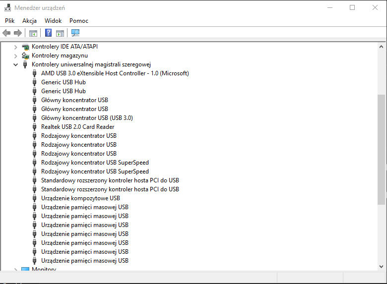

    Device manager:
    Hub TP-LINK UH720 USB 3.0 - teardown, presentation, test
    Further loading caused a reset of all devices connected to the hub, and the system displayed the appropriate message:

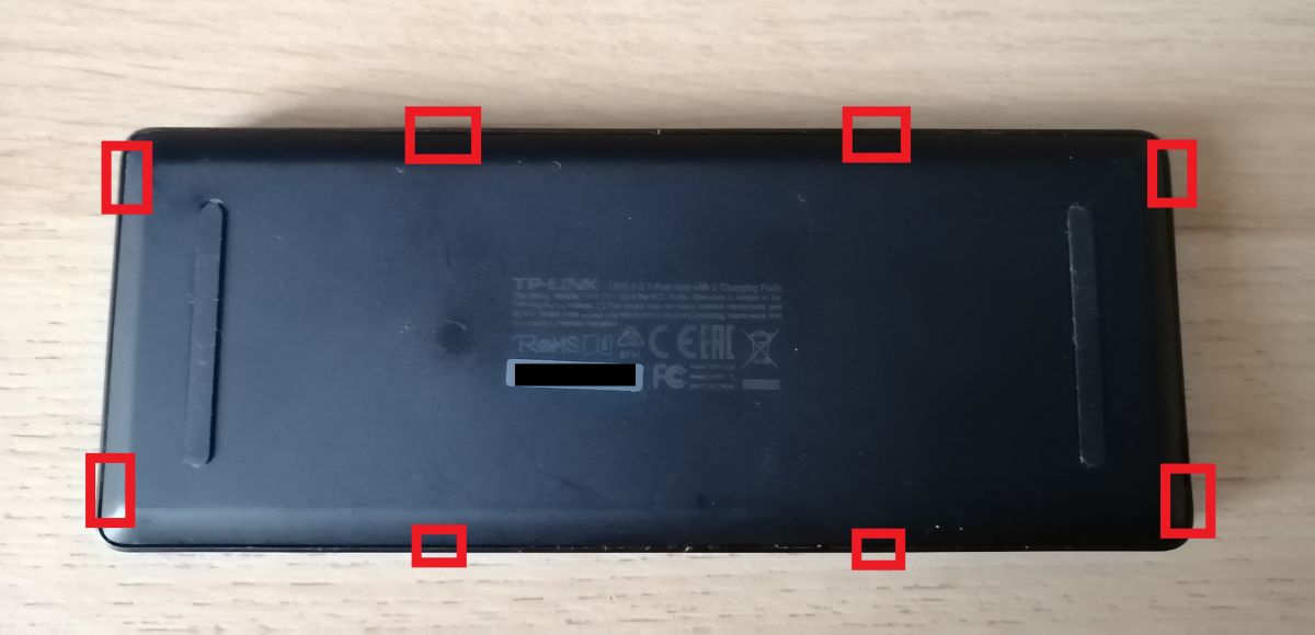

    Now for something you've all been waiting for! Time to open the case!
    It's not very complicated to open, but it does require a bit of fiddling with the snaps.
    The device opens from the bottom. I recommend to equip yourself with a special plate for opening - it leaves less traces.
    We push it into the latch and pry it up.
    Attention! I do not recommend screwdrivers, probes or knives! - they leave a lot of ugly marks and burrs!
    Fortunately, the latches are thick and strong, so they have no chance of breaking when gently unfastening them.
    Snap Map:

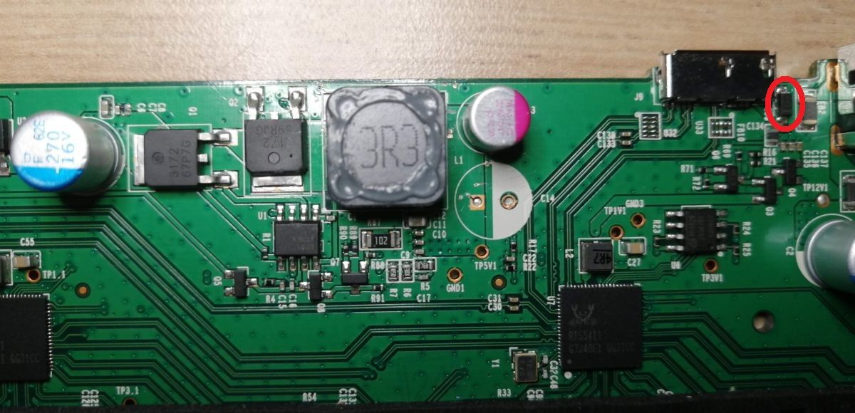

    Power:
    Power goes to the GH15B stabilizer. It is actually AZ1117 (note in the attachment) in the ADJ version, set with resistors R8 and R9 (10Ω and 30Ω respectively ;) on 5V.
    This voltage is probably supplied by a tiny U4 chip, which together with the transistors is responsible for switching the whole device on and off with the SW1 monostable button and controlling the D1 LED. There is a sponge around it to stop the light within the button.
    Then the integrated circuit of the main pulse converter built on the APW8720B system is powered (note in the attachment).
    There is also a coil, smoothing capacitors and two large MOSFET CED3172 transistors (note in the attachment).
    The converter produces a high-current 5V voltage that powers all USB ports.

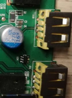

    Charging Ports:
    Contrary to appearances, it is more than a port connected to 5V. The data lines are routed to a tiny but nifty U34 chip labeled 3004. I haven't found any information about it, but it might be something like the TPS2513. The system informs the charged device about the charging method.
    Link to an interesting article on the subject here

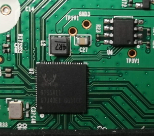

    USB port support:
    The whole thing is supported by two RTS5411 integrated circuits (note in the attachment). Each of them can handle 4 USB ports. So where did the eighth port in the hub go? It was used to connect the systems with each other. Therefore, the operating system detects the entire device as 2 hubs.
    Next to each processor we see a chip in a silver casing. It is a quartz generator clocking the RTS5411 chip with a clock frequency of 12MHz. In addition to them, we can also see a flash memory for the SPI interface containing procedural software (firmware). The second bone is on the bottom of the plate.

  • RTS5411 handles USB device detection

    Can you (or other users) tell me which element is responsible for detecting devices on ports, in order to replace it with a functional one?
    This is entirely done by the RTS5411 chip. I don't think it's likely to just stop detecting devices. However, if this happened, its replacement is possible, but is it profitable?
    https://www.ebay.pl/sch/i.html?_nkw=RTS5411
    The third option where the problem may lie is the drivers, but in this particular case Windows handles them rather well...

    Hey guys, I have the exact same hub (which I love), but mine got a defect. Long story short - I blew an SMD element, which I can't identify. Can somebody help me identify that element? Thanks in advance! Printed circuit board with electronic components, with a red circle highlighting an SMD component.
  • #17 21193527
    Marcinolak xD
    Posts: 378
    Help: 9
    Rate: 178
    >>21173523 .
    Sorry I haven't replied for so long. This is "E2" coded Zener Diode. I attached it's datasheet below.

How do I open the casing without leaving marks?
  1. Unplug power and USB.
  2. Insert a plastic pry card into the bottom snaps and lift gently.
  3. Work around the perimeter until the shell separates. Avoid metal tools that scar the glossy lid [Elektroda, 18724780]
Which component detects USB devices, and what if ports stop working?
Each RTS5411 hub controller handles four ports and device detection. If four ports fail, suspect one controller or its firmware. A user restored operation by replacing the faulty RTS5411 after confirming the other chip worked [Elektroda, 19529550]
What is the tiny "E2" SMD part near the DC jack?
It is a Zener diode used for input surge protection; blowing it can cut power. Replace with the same voltage rating (datasheet linked by author) [Elektroda, 21193527]

Will the charging ports work when the PC is off?
Yes. The two 2.4 A ports connect only to the power rail via a 3004 identification IC, so they source 5 V whenever the external adapter is plugged in, independent of the host [Elektroda, 18724780]

Why does Windows list two hubs after connecting the UH720?
One RTS5411 port links internally to the second controller, so the OS enumerates two cascaded four-port hubs—yielding seven external ports and one hidden interconnect [Elektroda, 18724780]
