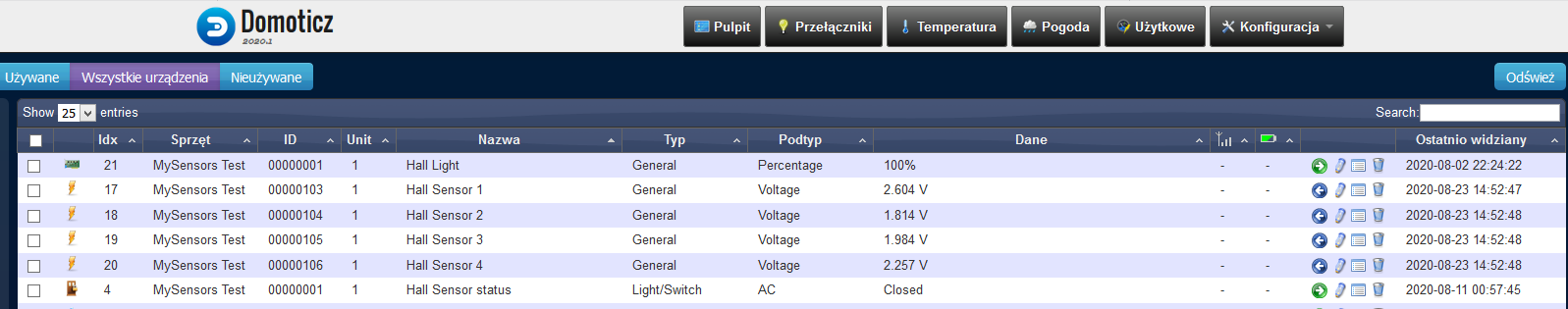

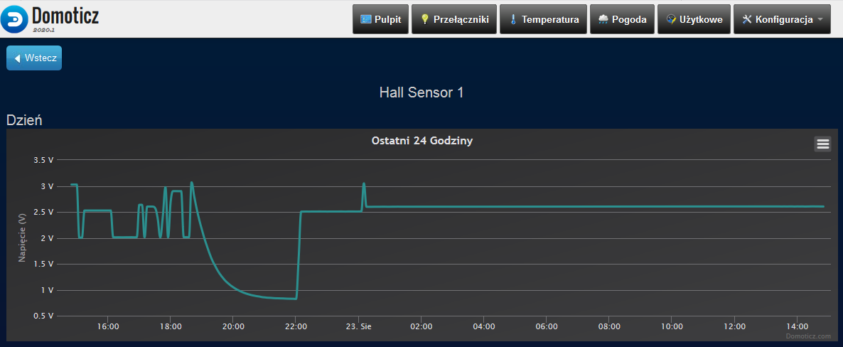

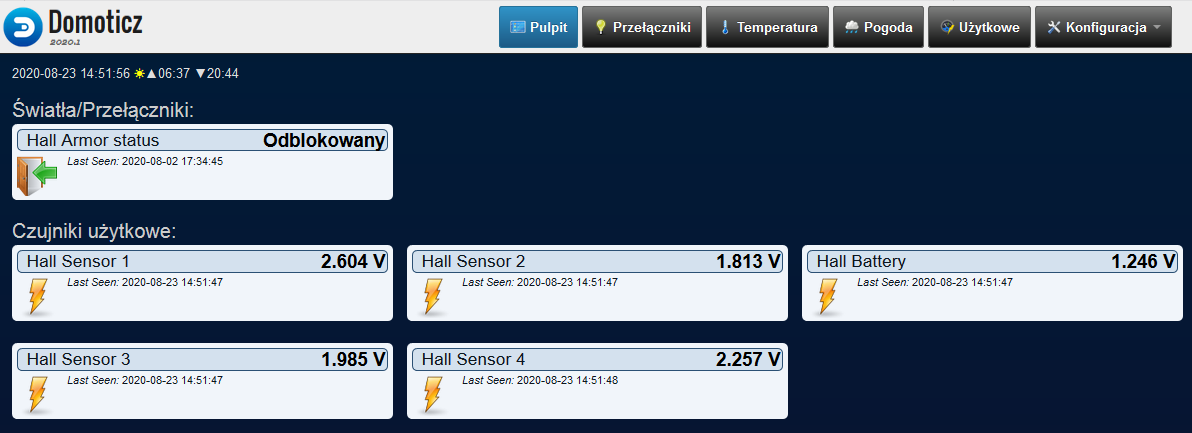

    The sensor has 4 sensors whose output signal is a voltage. Each of these sensors is reported as a multimeter generating a voltage signal. They work in mySensors Voltmeter format and are connected to the computer via USB in serial port mode (Nucleo board).
    As each sensor reports as a node, each sensor has a separate graph and this makes it difficult to compare values. Is it possible to group these 4 signals on one graph directly in Domoticz?

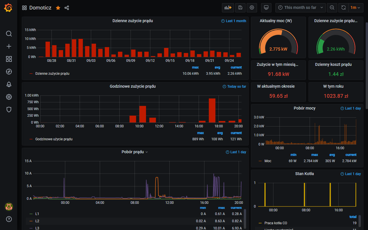

    Directly in Domoticz unfortunately not.
    You can send all the values to Influxdb and display them in one graph in Grafana.

    I don't know if not very interesting?
    See for yourself:
    How do I group the signals from mySensors on one graph in Domoticz? .
