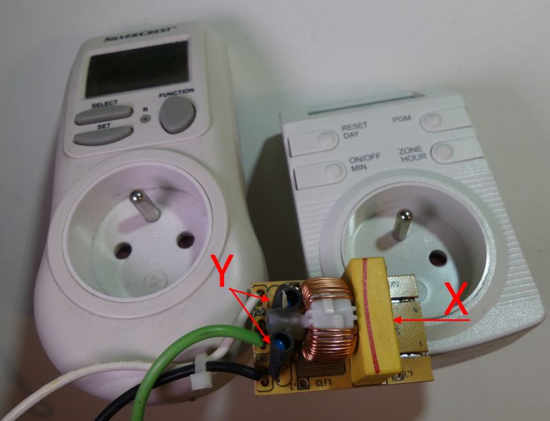

    Film capacitors can also be found in anti-interference filters. The capacitors connected between the phase (L) and neutral (N) conductors will be marked with X (in the example X2 - the number indicates the voltage withstand). In anti-interference filters, you will also find capacitors marked as Y, they are connected between the work conductor and the protective conductor.

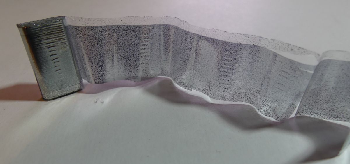

    Let's see what the damage inside the capacitor looks like,
    first the fight with the housing:
    Why film capacitors lose their capacity - MKP X2 capacitor section Why film capacitors lose their capacity - MKP X2 capacitor section Why film capacitors lose their capacity - MKP X2 capacitor section Why film capacitors lose their capacity - MKP X2 capacitor section
    We unfold the capacitor and you can see the remains of the sputtered conductive layer:
    It turns out, however, that this is the beginning of the capacitor and this "launch tube" constitutes some kind of protective / insulating layer, the last turns of the capacitor look the same. As we expand more, the layer becomes darker.
    When we highlight the foil, it turns out that there are visible damages similar to those found in the article. Damage occurs practically along the entire length of the foil.

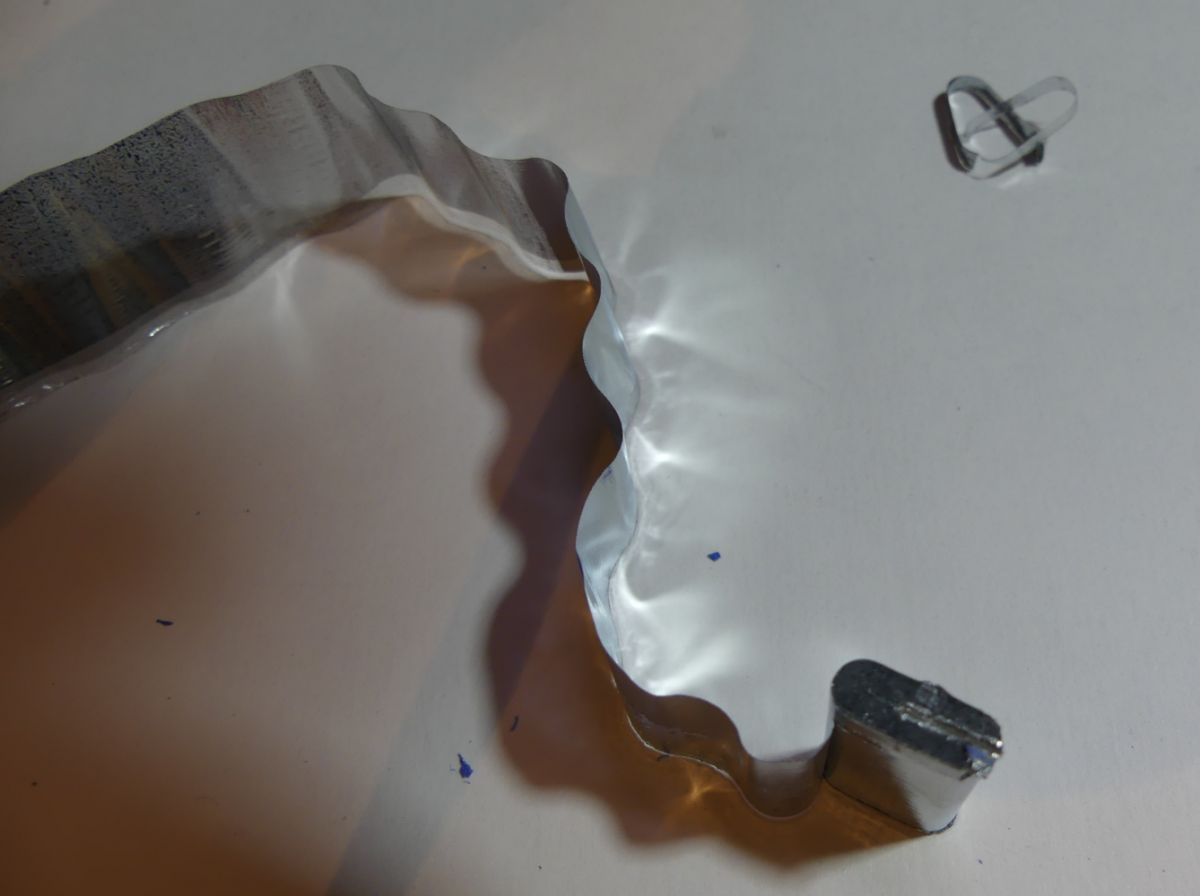

    I decided to develop a functional capacitor desoldered from another device.
    Initially, we have a "starter" foil:
    Then uniform metallization appears:
    This confirms that the found article rightly identified the cause of damage to the foil capacitors, the progressive degradation of the sputtered conductive layer lowers the capacitance of the capacitor.

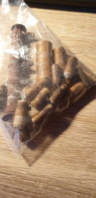

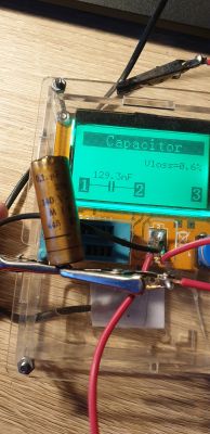

    I have the most trouble with the so-called "potatoes", foil capacitors flooded with some starch filling. They were used in TV and radio tube receivers from the beginning of the 70s and older. TIMES more capacity than the value written on the housing.
    Old cylindrical foil capacitors with markings, from the 1960s. Old foil capacitors in a plastic bag on a wooden surface.
    These are just from TV neptun 64r
    Old Miflex capacitor connected to a meter.
    They were also just flooded with some resin. they are not as defective as "potatoes" but still worth replacing with newer ones.
    Old foil capacitor being measured with a capacitance meter. Foil capacitor from a Neptun TV, filled with starch-based substance.

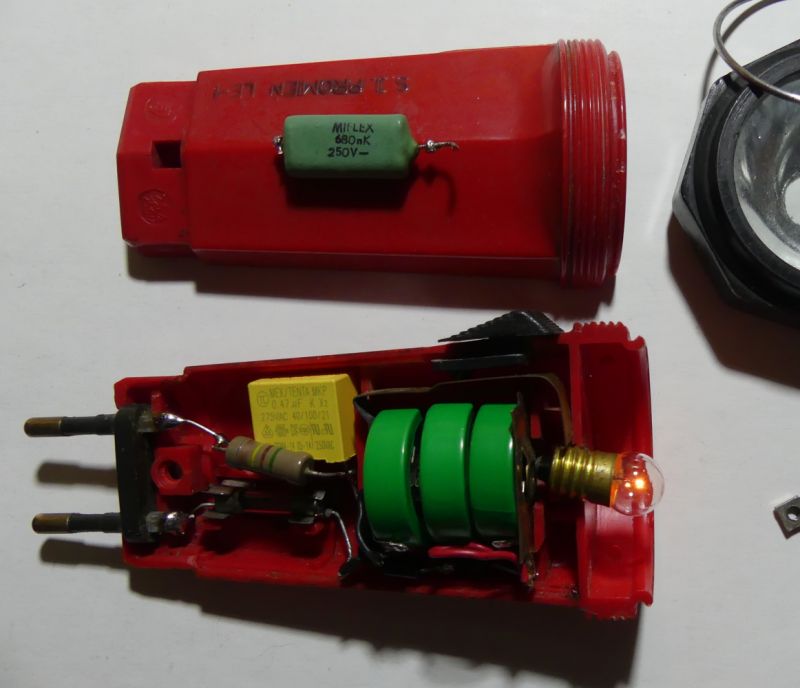

    When I post material on elektroda.pl, it usually happens that either I learn something very interesting from the comments, or later the information from the material comes back to my mind when I solve a problem.
    Today I saw a friend who has an old Promień LE-1 flashlight charged with 230V in his garage. I have already told him more than once that he should leave a LED flashlight there for PLN 5 and it will work for a year on one battery, because he charges the old flashlight all the time. Today I told him that probably the batteries are long to be thrown away and the bulb is a poorly efficient light source. He did not want to replace this flashlight, well every age has its rights and if someone does not want something, it's difficult. He also mentioned that the batteries are good because when the flashlight is charged, it holds, only the charging process takes a very long time.
    Then I put the facts together :) and I said okay I'll fix this old flashlight. After unscrewing it, it turned out that the miflex had a capacity of 80nF instead of 680nF. I replaced the capacitor and after a short charge the bulb was already glowing. It works :) let him have it and be happy ;)

    For me, when something old to repair lands on the table, I first look at the capacitors. Something I never believed them.
  • #23 18929876
    ojciec
    Posts: 1566
    Help: 280
    Rate: 209
    TechEkspert wrote:
    instead of 680nF it had a capacity of 80nF
    I wonder who put it there, the manufacturer, the owner of the flashlight (old repair), the working voltage
  • #24 18929999
    TechEkspert
    Editor
    Posts: 7232
    Help: 17
    Rate: 5609
    I will say yes, it also choked me ... It is 250V, probably DC voltage, as long as I read the markings correctly and who knows if it was not the equivalent of MKT, unless it is material savings and this fuse is there for a reason ...
  • #25 18930034
    ojciec
    Posts: 1566
    Help: 280
    Rate: 209
    The capacitor is DC voltage (MKSE type); a long time ago I put these on 400V (should be 630V) also permanent as a backlight on one LED for power switches; to this day they work
  • LCR-TC1 ESR measurement starts at 300 nF

    Excellent compilation by the author with photographs. Full words of appreciation. Thank you.
    I will add a few comments of my own.
    MKP X2 type capacitors, although designed for harsh environments, can lose capacitance over time for several reasons. Below I explain why this happens and how it can affect the failure of the inverter.
    Why do MKP X2 capacitors lose capacitance?
    Ageing of the dielectric
    MKP X2 capacitors are made of metallised polypropylene, which degrades over time. Factors such as high temperature, humidity and electric fields can cause this:
    Micro-damage to the dielectric.
    Progressive 'self-healing' of the metallized layer.
    Breakdown and repair of the metallized layer
    The self-healing function of MKP X2 capacitors is based on the local vapourisation of the metal at the puncture site, which isolates the damaged area. However, with many such events, the effective metallization area decreases, leading to a reduction in capacitance.
    Impact of operation under harsh conditions
    MKP X2 capacitors operate in systems directly connected to the mains, where they are exposed to surges and interference (e.g. from a dishwasher motor).
    High peak voltages can accelerate degradation.
    High humidity (e.g. in the kitchen) can cause additional damage.
    Manufacturing process and material quality
    Older capacitors or those of lower quality may lose performance faster than modern high-quality models.

    I was more curious why your LCR-TC1 already shows ESR with capacitors as low as 300nF ? Mine only shows ESR at capacitances from a few µF .

    As for the ESR, it's hard for me to say why this is happening, this tester has had many firmware versions and perhaps there are minor differences. Another reason is perhaps it depends on the properties of the capacitor being tested?
