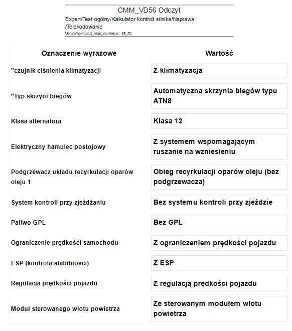

    cannot compare VD46 to VD56 first 14 bytes second 22
    Writing the encoding is done only in 2101 out of 2100, it is only reading possibilities.
    yes it is broken
    2E 21 01 02 AA BB CC DD DD EE FF GG GG GG

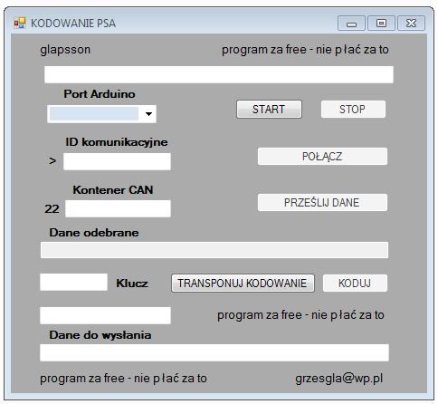

    And with this PSA encoding program you can read and write :) the same as a YAT terminal, as someone is not fluent in coding, YAT is quite fast and efficient because you can save the buttons you want to send and click 4x in turn.

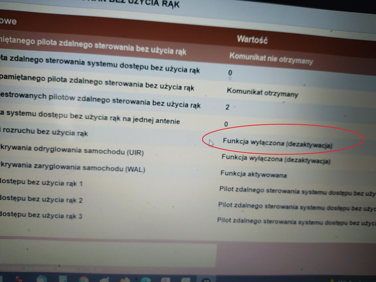

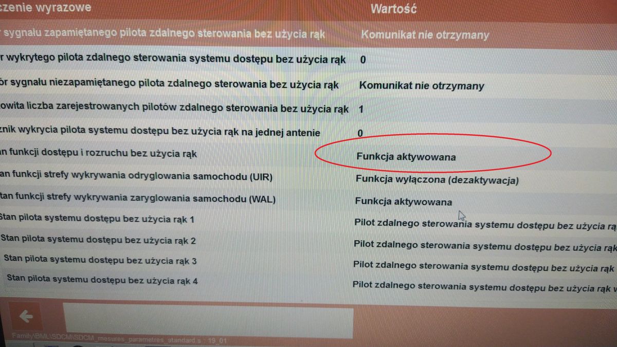

    So now I will ask.
    I would like my car ... actually my wife's car with keyless functions.
    Cool car - factory fired from the start button ... and here I do not understand the PSA concern.
    Why do I need to fire the start button - that I don't need a key in the car to look for ... So what if I have to start the drum of the drawing machine in the parking lot and rummage through the pockets of the sachet or the pocket in the purse to open the car.
    NO SENSE !!!!!
    I would like to add door handles with sensors and program everything properly.
    Of course, the coding has already been worked out ... but unfortunately it does not work despite the coding.
    Let me explain.
    It is not in the coding - it is in the reading of parameters.
    BSI DELPHI series EL HW D6 - TELECODING READING BSI peugeot 208 II corsa F BSI DELPHI series EL HW D6 - TELECODING READING BSI peugeot 208 II corsa F
    Of course, the module with the deactivated function is in the car.
    the other active one is on the table.
    and despite the change in coding - the reading of this function does not change.
    The case will turn out like this:
    in the module in which the function is active, the handles work - there is a reaction to touch and a change in readings.
    And in the module with the function inactive, despite the encryption, the access is still deactivated and the handles do not react.
    I assume (I did not try because I do not like the risk) that the modules once added to the car cannot be changed because even the one attached to the table gives an error of data exchange with BSI (there is a different pin and vin in bsi).
    And the parameters say that VIN and PIN are already loaded into the module.
    Does anyone know how to get around this topic?

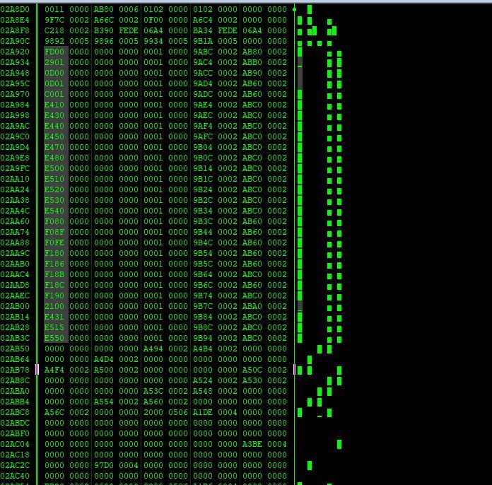

    And lest it be that I deviate from the topic of BSI - it is still closely related to bsi because these devices appear as a pair.
    I have access to 3 modules:
    1 - In the car - I haven't rummaged anything but coding and connecting the handle, no reaction
    2 - light module, the same number as in the car, but has unlocked access and reacts to the handle on the table
    3 - full module that I read but after uploading it does not respond in the CAN network (feel and program) - when it worked, it also responded to the handle because it also had unlocked access.
    No additional antenna is needed
    CAN power supply and the door handle and talking on the table.
    I have a module with the same numbers in the car, but the software has a different number
    I had a full module - i.e. with bt, but attempts to clean vin ended with the fact that despite the fact that it is read and programmed - even with the original - the processor gives an ID
    This module does not talk in the CAN network
    I have a second light, the same number as in the car, but as I already wrote, it has unlocked access and as you can see - only the handle is connected and talks.
    as for the charge
    in the full module it is identical to the PCB as in the light - only the bt section is missing (there are several dozen elements - empty solder pads)
    In the full module there is an RH850 processor that can be read and programmed ... but I beat it somehow
    BSI DELPHI series EL HW D6 - TELECODING READING BSI peugeot 208 II corsa F BSI DELPHI series EL HW D6 - TELECODING READING BSI peugeot 208 II corsa F BSI DELPHI series EL HW D6 - TELECODING READING BSI peugeot 208 II corsa F BSI DELPHI series EL HW D6 - TELECODING READING BSI peugeot 208 II corsa F
    and in the light module, the markings on the prock are encrypted (mask?) - and can not be read - it does not even reflect the ID
    I warn you - upa read but after uploading ... silence in CAN.
    CRC is also to be counted
    I don't know where the PIN is (it's encrypted)
    Of course, it does not do anything as there is no 100% programmer for reading and uploading - unless someone has tested it with a programmer.
    and more ripples
    KEY CODING - A8EE
    CAN
    • Code flash .bin (2 MB) You must be logged in to download this attachment.
    • Data Flash.bin (64 KB) You must be logged in to download this attachment.

    Renesas Read/Write DataFlash (when reading Data Flash, cells that are not programmed return random values).
    moze to to...

    #190 19751850
    glapsson
    Electronics specialist
    Posts: 557
    Help: 11
    Rate: 645
    We still don't understand each other.

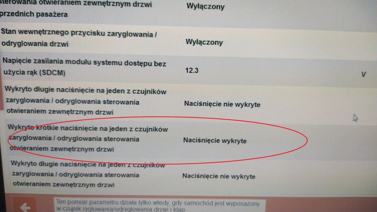

    in my car, ADML does not react at all to the touch of the handle - as if it was not there.
    Whether the key is or not is a secondary matter in this topic.
    I do not have the key to the module, which reacts and the vin in bsi is different at all, but the module sees that someone has touched the handle - of course, the car will not disarm the car because there is no key.
    One has the access function unlocked - the one bought which reacts (in the photos in the circle, activation - deactivation)
    and he reacts to the handle - the pictures show a diagnostic reading - unfortunately, but this is not a module from my car.
    The module in my car has the option of access as deactivation and there is no reaction to connecting and touching the handle.
    wreath wonders can be encoded and this option remains inactive.
    The point is that there should be a reaction here:
    You are probably mistaking the system that I want to activate with remote access - you come and the machine disarms - I don't want it !!
  • #191 19751970
    bbmax
    Posts: 132
    Rate: 62

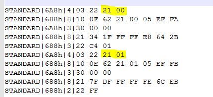

    well, you are confusing the concept because this is AMDL without the use of cancer opening ..
    with the use of a handheld DML, the hand in the handle opens, the finger on the handle closes, twice a finger within 5 seconds closes a double lock.
    to activate it
    741: 641
    DML = 2E210000
    AMDL = 2E210004
    Not set = 2E210008

  • Coding values for DML and AMDL access modes
    #193 19752756
    glapsson
    Posts: 557
    Help: 11
    Rate: 645
    bbmax wrote:
    well, you are wrong, because this is AMDL without the use of cancer opening ..
    to activate it
    741: 641
    DML = 2E210000
    AMDL = 2E210004
    Not set = 2E210008
    I know it should be 04 or 00
    BUT IT DOES NOT WORK AS IT IS - deactivation - I have already written this several times.
    Despite the change of encoding - it is still deactivated.
    And surprisingly
    in this module on the table
    When code 04 is coded, the handle still reacts - and according to your data, it shouldn't.
    But when I do 00 - there is no reaction to the touch of the handle.
    As you can see, everything breaks down on what is not going to be encoded ...

    you can enter F190 and also get the reading
    • SDCM ADML BML.zip (831.41 KB) You must be logged in to download this attachment.
  • #194 19753199
    bbmax
    Posts: 132
    Rate: 62
    What are you saying she shouldn't
    Adml only adds contactless opening, the handles continue to work as in Dml
    In this module, F190 is inactive for writing
    The only active save zone is 2100 ....
  • Speculation on hidden telecoding bytes for handle touch recognition
    #195 19753427
    glapsson
    Posts: 557
    Help: 11
    Rate: 645
    I know it is inactive
    I wrote a preview ....
    such a splash ....
    maybe there is some hidden coding that the zones are open to
    and as for the 2100 encoding - it's like I wrote with this handle touch recognition.
    00 no reaction
    04 sees the touch
    but on condition that the diagnostic option I wrote about is activated.
    There were even older BML modules
    which had broken coding on each door handle, etc.
    in addition, they were not served with VIN.
    and in 2100 there were two bytes of encoding.
    I wonder what the car would say to such a module.
    It just makes me wonder if the key is different encryption.
