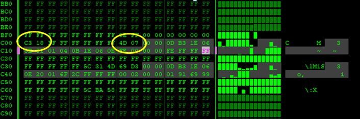

    The diagbox menu was a work that took a long time.
    It involved changing bytes and reading what had changed - and then putting it into the program.
    Such reverse engineering .....

    For now, I will be testing the lock options because it's strange that everything will pass and not save.
    the coding area is extended by a dozen or so cells with "switches"
    the whole area of coding and "switches" ends with a -CRC-16 / MODBUS checksum.
    So there will be no problem to fight with "switches", maybe something will be explained ---- such a hobby.

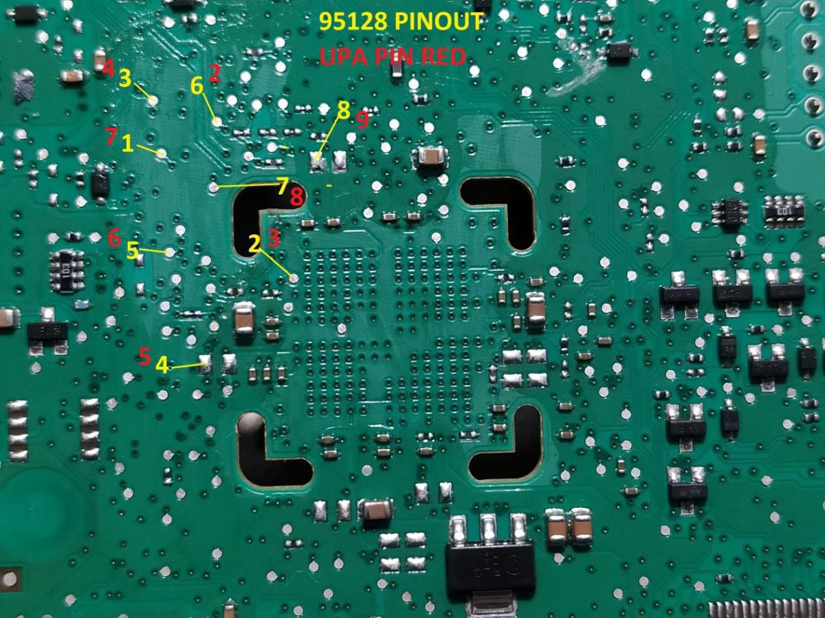

    Due to frequent requests for BSI DELPHI HW D6
    here are the pinout for 95128
    BSI DELPHI series EL HW D6 - TELECODING READING BSI peugeot 208 II corsa F
    - Copying the eeprom BSI batch to the BSI - will not work if there is a different SW version (because the flash batch determines how the eeprom is written) - only a full flash and eeprom copy makes sense.
    Copying the eeprom itself only makes sense with the same SW version otherwise everything will fall out - you have to code and assign
    - copying the same SW version - it will probably not copy the PIN - because it is hardware-encoded in a specific BSI
    and here - coding can go, VIN too, but the rest will fall out. - unfortunately, I have never been able to purchase two bsi with the same SW, so this is a theory .... but as you can see at the beginning of the topic, the same key in different SW has different data ....
    - ENCODING - You can encode on bytes in a batch, but you have to count checksums on foot - this is somewhere at the beginning of this topic and here the pinout makes sense.
    - BUT - For cheap and simple coding I recommend ARDUINO and what's on the web, and those who have Diagbox probably do not look here because and why.
    - Pinout will also be useful if someone wants to make corrections in the batch (Mileage, PIN, VIN, VIRGIN, history reset)
    As for the history reset - the procedure is quite complicated - clearing itself - kills the history record - it has to be done in a certain way
    cars in which it is impossible to read the history - they are corrected and it is very easy to spot it - if someone buys a car, I recommend looking at the history at BSI ...
    And how to improve the history of BSI when migrating BSI I described it in one of the instructions for bsi DELPHI - of course, it is only about the need to migrate bsi due to defects, other activities related to concealing the facts are illegal.
    - For connecting other ECUs to the BSI:
    IMPORTANT - so-called IGNITION was turned on in bsi
    and here the stairs begin because it will only work with a coded mechanical key -
    someone once said that his communication does not work ... maybe because he has an encoded electronic key.

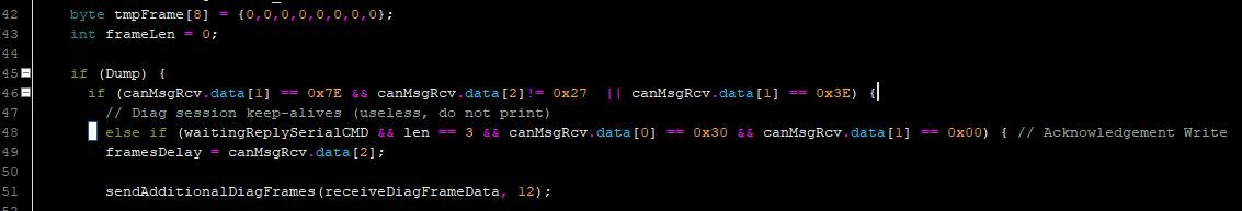

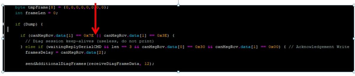

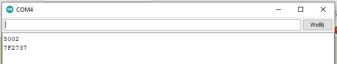

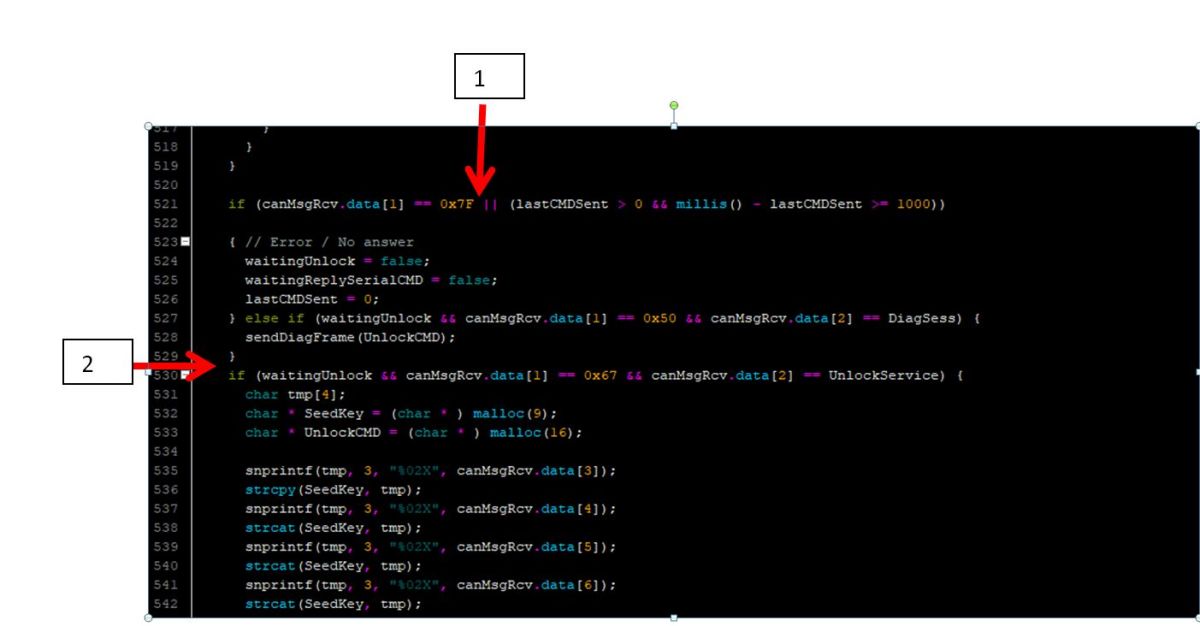

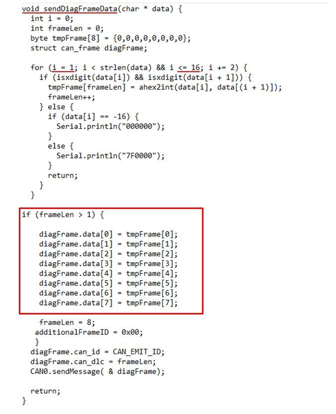

    CAUTION
    If you are using French software and you are using an Arduino terminal.
    And you have a problem logging into the driver, e.g. BSI
    sending commands in this form does not work for you:
    : E4D8: 01: 02
    the driver is most likely blocked from sending SEED
    the software for Arduino from the French does not consider this case and sends the request only once.
    the effect is that you get:
    to remedy this, you can throw in a patch to execute the code until you get a reply.
    As can be seen on inquiry 27 ..
    we get error 7F 27 ..
    we refuse to accept such errors and we order you to resend your inquiry.
    the key is the delay between queries - it may be different for different drivers.
    for the Valeo BSI it could be delay (1000);
    you should paste or paste the code fragments in the following places:
    No. 1 - we add a condition
      if (canMsgRcv.data[1] == 0x7F&& canMsgRcv.data[2]!= 0x27 || (lastCMDSent > 0 && millis() - lastCMDSent >= 1000))
    No. 2 - we add a line of code
     if (waitingUnlock && canMsgRcv.data[1] == 0x7F&& canMsgRcv.data[2]== 0x27 )
                sendDiagFrame(UnlockCMD);
                delay(1000);
    At this point it should look like this:
        { // Error / No answer
          waitingUnlock = false;
          waitingReplySerialCMD = false;
          lastCMDSent = 0;
        } else if (waitingUnlock && canMsgRcv.data[1] == 0x50 && canMsgRcv.data[2] == DiagSess) {
                delay(100);
        if (waitingUnlock && canMsgRcv.data[1] == 0x67 && canMsgRcv.data[2] == UnlockService) {
          char tmp[4];
          char * SeedKey = (char * ) malloc(9);
          char * UnlockCMD = (char * ) malloc(16);
    and here
    after this operation, Arduino asks until it gets a SEED answer
    And another note
    You can apply this patch when working directly from the terminal

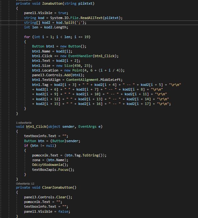

    If you use the windows frontend and you condition the SEED reception there
    you put the fix in this software, not in arduino.

    Of course, the textbox form and the rest - to be changed - I was more concerned with whether the Arduino will handle it.

    To be able to continue logging in, you need to modify the Arduino batch.
    I have the batch prescribed a little differently and if I showed it on my batch it would be a problem for those who start from 0 to understand what is going on, so it will indicate where you can add it.
    And I warn you if some "professional" from this forum for professionals will have comments and will not throw even one screen or link to help or topic or even one line of code as if it could be done differently - this topic will end like the previous one.
    I would like to add that first he should also pay attention to the name of the topic and then refer to the programming method.
    This software that is on Arduino is not my work - it's of French
    Here it just adds something from itself to ... itself - although I already have this batch rearranged in a different way. but these changes here are enough for logging to work. And it works - no one will organize a competition on time.
    In Arduino we add a method
    In principle, you can copy an already existing method of sending a frame
    and then just apply the changes
    firstly, the name has changed ... because it has to be called differently
    Secondly, we leave the first "char" because we will send the frame marker in it.
    so not from 0 to
    • log3.zip (2.62 KB) You must be logged in to download this attachment.
    • log2.zip (839 Bytes) You must be logged in to download this attachment.
    • logowanie do BSI cz II .pdf (547.77 KB) You must be logged in to download this attachment.

    Logging into the date mode looks like this:
    FD 00 00 00 00 00 00 00
    FD 47 E9 04 17 00 00 00
    FE DA DA 35 98 00 00 00
    FE 00 00 00 00 00 00 00
    Unfortunately, it is not possible to generate a key from this pair based on a known algorithm.
    The diagnostic session key is C318
    unfortunately after substituting this SEED and key
    47E90417
    generates:
    657F5D7B
    and it should
    DA DA 35 98
    and no other key from the scope:
    0001 to FFFF
    does not give such a SEEDKEY
    So either a different computation algorithm or other algorithm codes.
    Maybe someone has something?
    Here are a few working pairs - for any of them it is impossible to generate a key from the current algorithm and codes.
    BA9C053B
    0D868B58
    6007F43B
    95AF9B83
    F9FD9F19
    740A2104
    D9C7F26C
    672C2847
    F60E69CB
    58EC7560
    0E59E495
    05C403B6
    6233ED06
    41091E50
    E12AC4B1
    392E3736
    A457AEAC
    6BA6C124
    I even wrote a decoder for these secret codes, assuming we know the key
    then we have to decode a number consisting of 255x255x255x255x255x255 possibilities
    The jump to the 4th position takes place every 24sec - with a good, unloaded 20sec comp.
    255x20 = that is, every 17 minutes for 5 positions
    255x17 = 72h need to jump to the 6th position ..
    and on the 6th position there are another 255 possibilities ... it's about 2 years ... well, you need some time
    and this is assuming that we know the key.
    because we still have 65535 key possibilities.
    Sooner the sun has time to become a red giant ............
    However, there are interfaces that read this bsi - so the algo or the codes are known.
    Maybe someone came across something on the network?
    in this video you can not see the change in pos. 1 and 2 because it is so tight that you simply cannot see it.
    [movie: d8719fdfd0] https://filmy.elektroda.pl/81_1635520940.mp4 [/ movie: d8719fdfd0]
    As for the keys, I have certain types
    Because in flash next to the encoding key in diag C318 mode.
    there is ... maybe a second key .. with an emphasis on maybe
    because it might be in a different place entirely.

    As in another thread, I admitted to my colleague:
    tzok
    he was right - that's why I asked to close.
    I know this is far from perfect but I improved:
    part of the code is above.
    Buttons and all descriptions are dynamically generated from an external txt file.
    The code has been greatly simplified.
    For those few buttons in the middle, you can also do it, but ... without exaggeration ...
    Although I will actually do it - it will be easier to translate into other languages like something.
    [movie: f635447c70] https://filmy.elektroda.pl/47_1635689869.mp4 [/ movie: f635447c70]

    [movie: 2715582559] https://filmy.elektroda.pl/74_1635938897.mp4 [/ movie: 2715582559]
    I must add that in the version here posted as a DEMO with the possibility of encoding the calculators present, I did not implement the "N" normal function for the Arduino batch.
    If, during the test, someone receives artifacts instead of the VIN number and has problems with communication, I suggest manually switching to this mode from the terminal.
    Just fire up the terminal and enter N on the send line and send it to arduino.
    The full version of the PL and EN program, which is basically ready - also has the ability to download the full configuration without the need to break through single coding when transferring data to another BSI.
    • BSI TOOL VS.zip (1.82 MB) You must be logged in to download this attachment.
