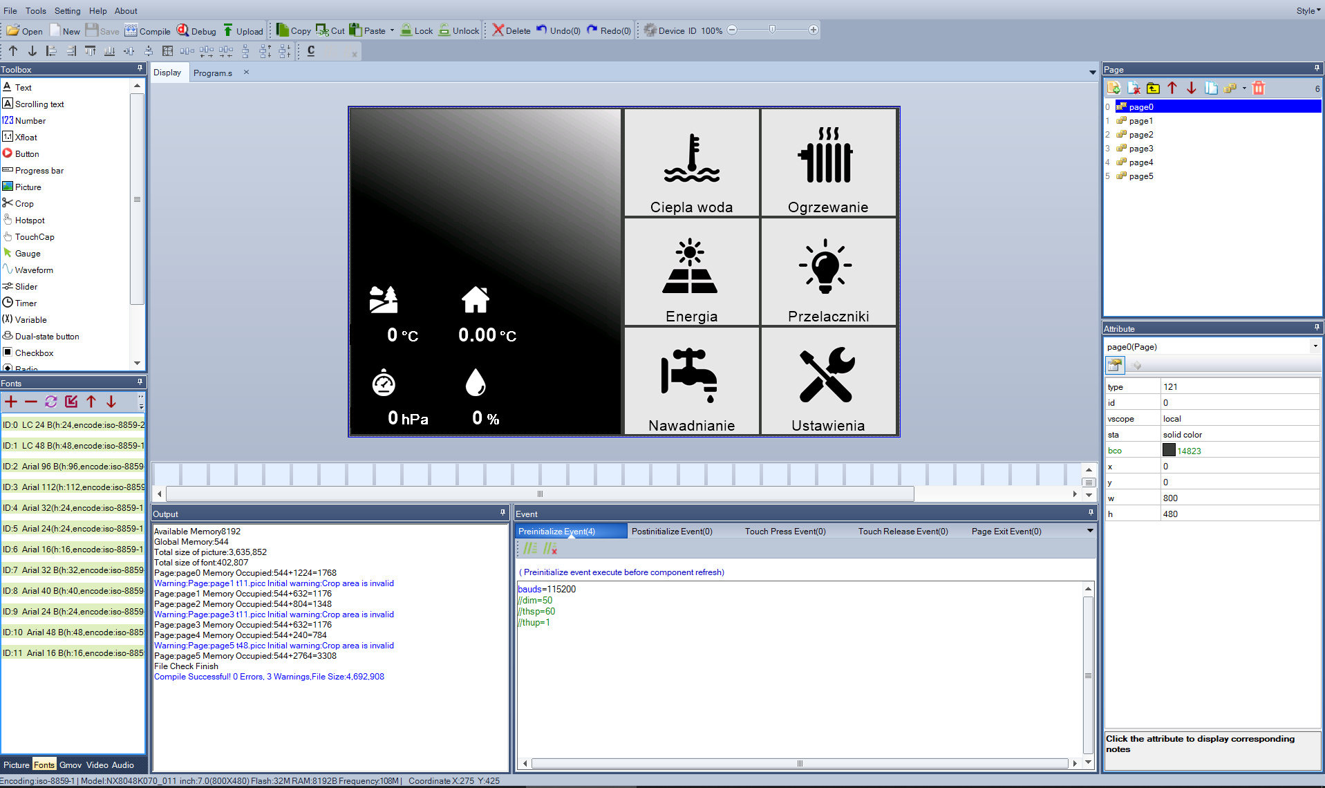

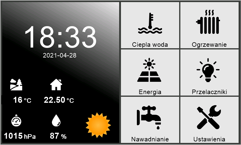

    I have a Nextion 7" 800x480 for home automation and the main screen looks like this :
    Factory-style 5-10 ESP8266 Smart Home Display With Buttons for Thermostat Control .
    And this is how it looks in the interface design software :
    I bought from elty.pl
    You have a version right away with an enclosure https://elty.pl/pl/p/-Wyswietlacz-Nextion-Enh...ezystancyjny-panel-dotykowy-oraz-obudowa/2019 - I made my own.
    Here you have without the casing cheaper https://elty.pl/pl/p/Wyswietlacz-Nextion-Basi...-NX8048T070-rezystancyjny-panel-dotykowy/1625
    Best regards
