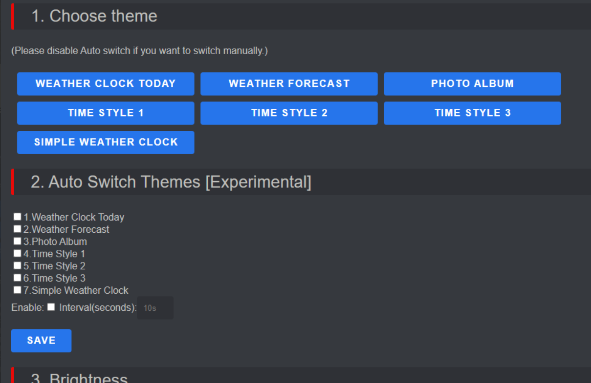

    This device, however, can do much more. On the configuration web page we have a whole range of possibilities
    SmallTV-Ultra configuration interface with theme selection options. .
    Let's start with the clock styles:

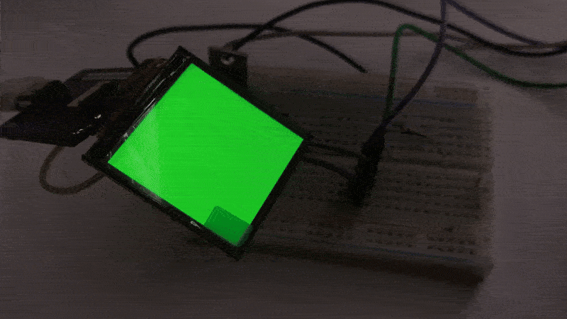

    You might have guessed it was an SPI interface, presumably pixels are sent via DMA:
    Table with pin definitions for the electronic module by GoldenMorning Electronics Co., Ltd. .
    I found a sample driver for it on the internet, but haven't fired it up yet:
    Interior of the source code file for the TFT display. .

    In the settings you choose what you want to display. Either rigidly, or there is also an experimental option that one by one each screen is.
    Software settings panel with options for selecting and auto-switching themes. .
    Vendor authored software, the vendor does not share the source code, but the binaries on Github are.

    I have been experimenting a bit more with this display recently. Based on the example code from the manufacturer, I managed to run the SPI in Mode3 and send sample colours to it:
    Green display with connected wires on a breadboard. .
    Code: C / C++
