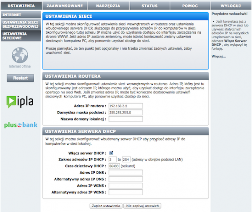

    Assign the Arduino device some IP address from the end of the router-assigned pool (one that would not normally be assigned by the router's DHCP to any device on your network).

    klon111 wrote:
    For me, the idea is to find the IP by MAC address .
    But why do you need this? After all, every time you restart the router there will be a different IP on your server.
    In your server, set a fixed IP from the router pool - you will always have the same IP.

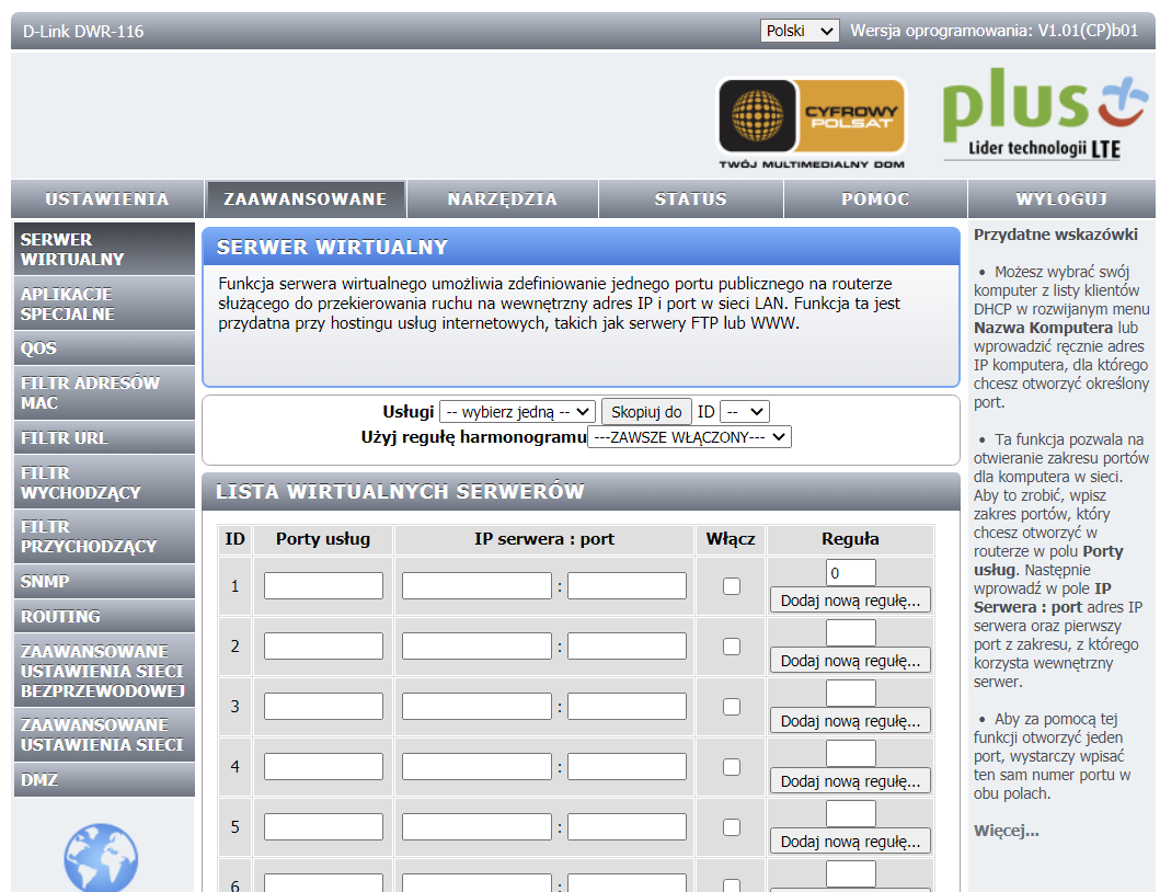

    The router is like this
    I will try to assign an IP on the Raspberry Pi
    • How to find the IP address when I know the mac of the arduino device ruter.png (192.81 KB) You must be logged in to download this attachment.
  • #10 19241780
    cysiekw
    Level 42  
    Posts: 5430
    Help: 1003
    Rate: 1409
    Advanced network settings, see if you have static for dhcp there
  • #12 19241833
    klon111
    Posts: 140
    Rate: 23
    cysiekw wrote:
    Advanced network settings see if you have static for dhcp there
    dhcp - no such tab exists
    this router is good for scrap
  • #14 19242484
    klon111
    Posts: 140
    Rate: 23
    Thanks for your help ex-or after setting on osmc the address is ok
