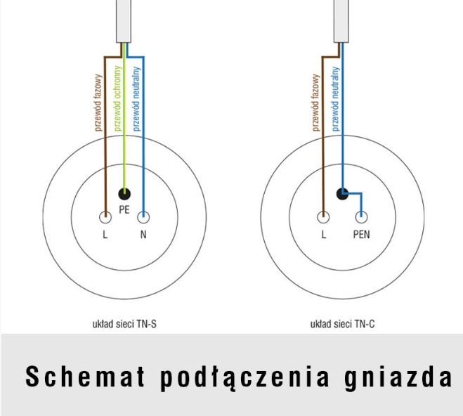

    Check with your colleague that you don't have the number that you have the phase on protective...
    It should be connected properly like this:
    Diagram of the correct connection of a socket to TN-S and TN-C network systems.
  • #7 20698644
