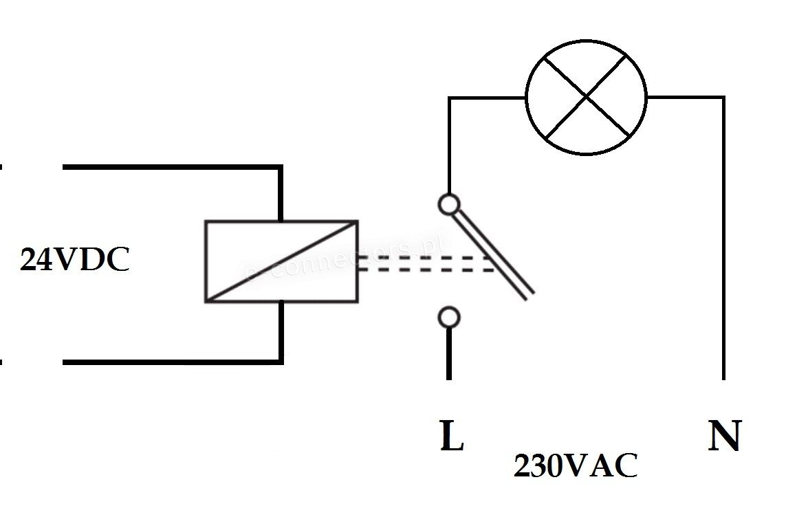

  • #5 19778965
    gumisie
    Posts: 17938
    Help: 1667
    Rate: 2485
    shl222 wrote:
    Probably fixed on the bulb
    Probably, there is a big difference.
    You could connect the coil of the relay (24 V DC), in parallel with the bulb and the lamp to the contacts:
    shl222 wrote:
    Power supply to the lamp at 230 V.
    Gate operator HATO 180 - Connection of an external 230V lamp via relay .

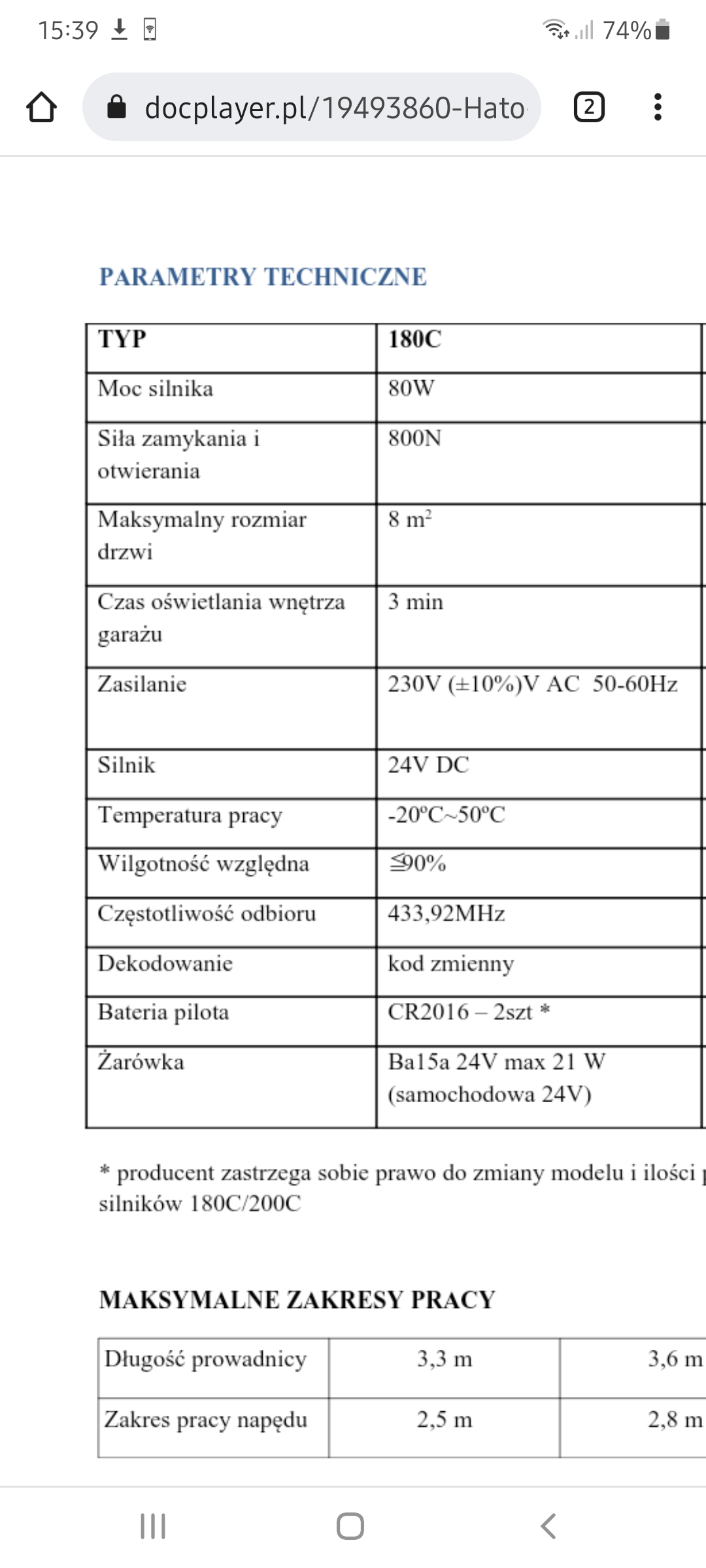

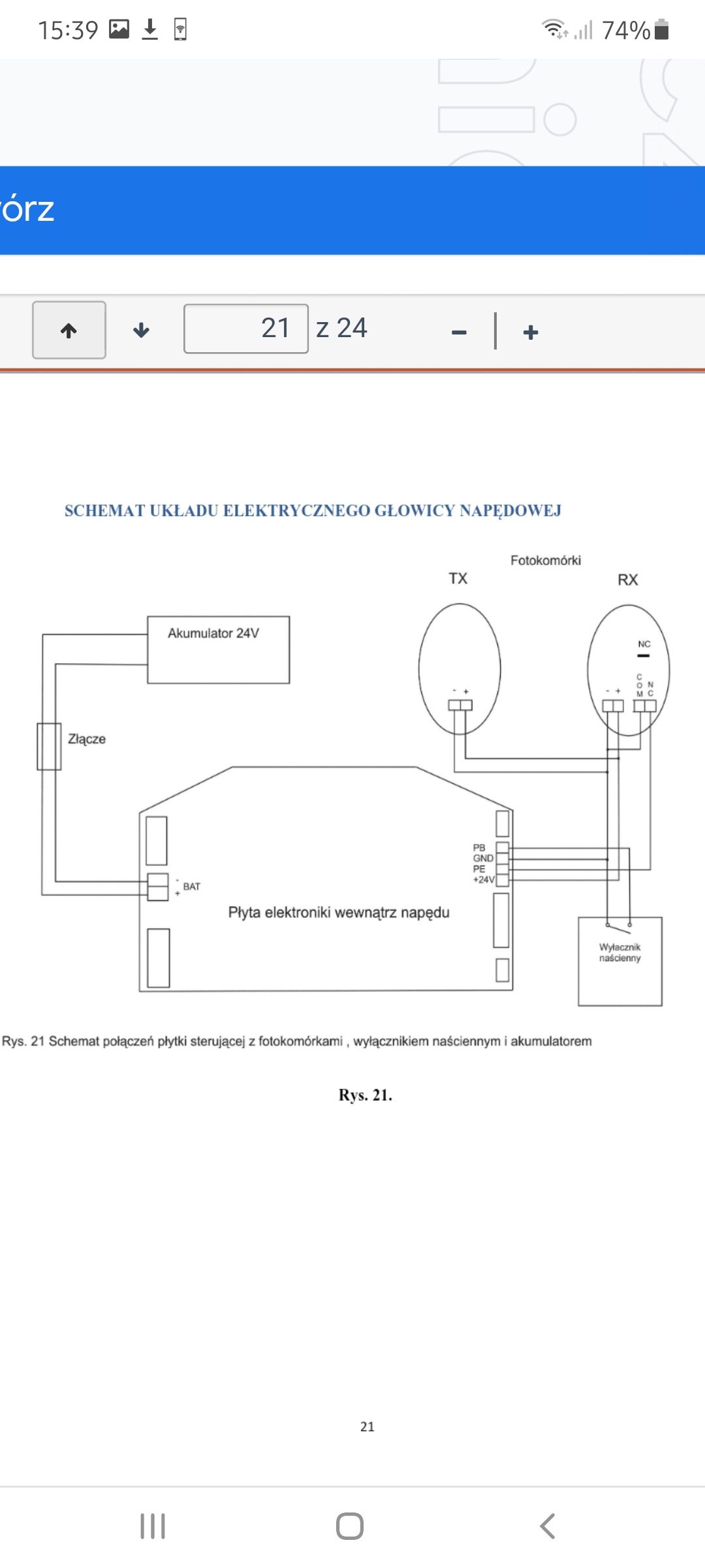

    Sam Sung wrote:
    Is there such electronics? https://sklep.hato.com.pl/elektronika/156-elektronika-do-napedu-hato-180c.html
    Do you have assembly instructions, especially a description of the connectors?
    Yes it is.
    • Gate operator HATO 180 - Connection of an external 230V lamp via relay Screenshot_20211223-153928_Chrome.jpg (330.34 KB) You must be logged in to download this attachment.
    • Gate operator HATO 180 - Connection of an external 230V lamp via relay Screenshot_20211223-153955_Chrome.jpg (209.26 KB) You must be logged in to download this attachment.

    gumisie wrote:
    shl222 wrote:
    probably fixed on the bulb
    Probably, there's a big difference.
    You could connect the coil of the relay (24VDC), in parallel with the bulb and the lamp to the contacts:
    shl222 wrote:
    Power supply to the lamp at 230V.
    Something like that?
    • Gate operator HATO 180 - Connection of an external 230V lamp via relay Screenshot_20211223-170750_Chrome.jpg (424.52 KB) You must be logged in to download this attachment.
  • #8 19779175
    gumisie
    Posts: 17938
    Help: 1667
    Rate: 2485
    shl222 wrote:
    Such a thing?
    I won't answer you unequivocally, but I suppose it could be 'suitable'.

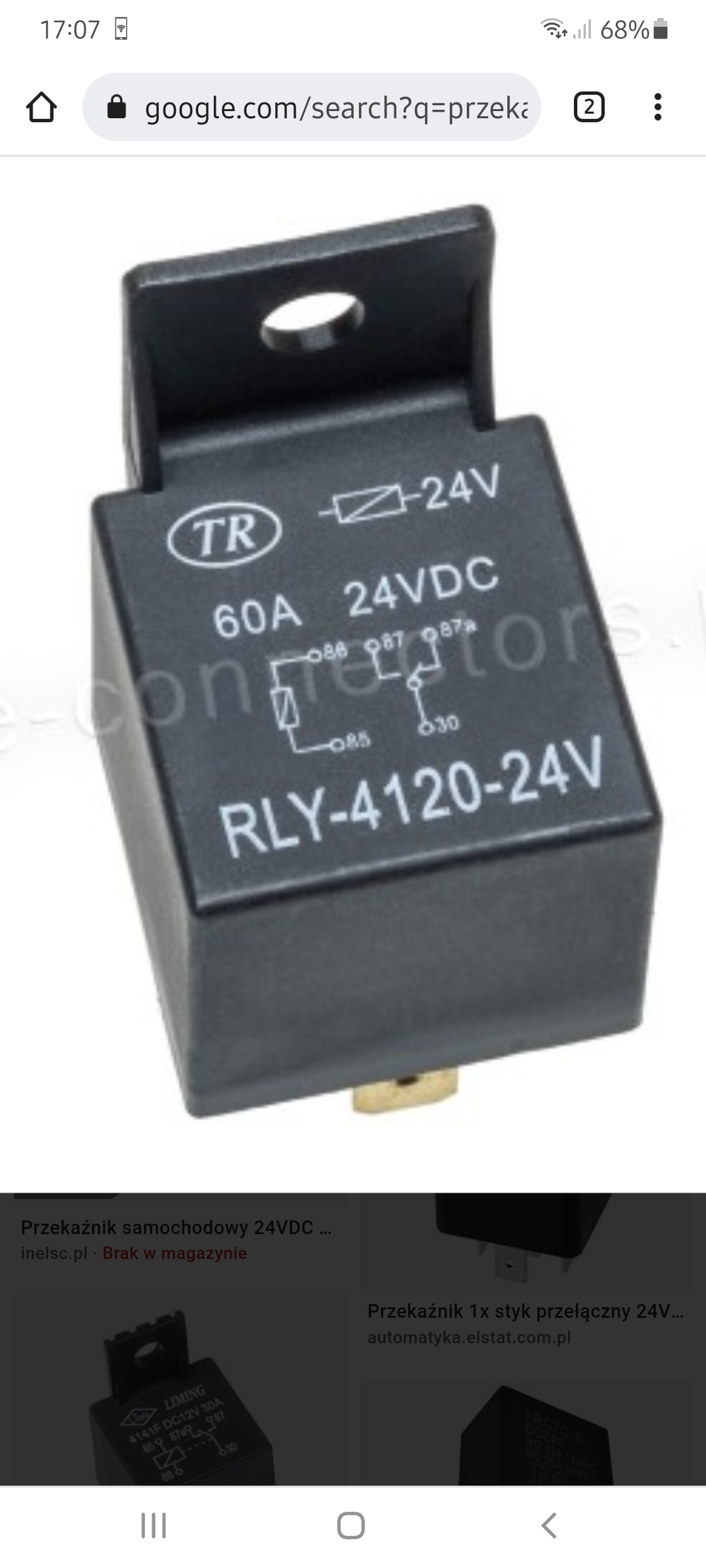

  • #10 19779183

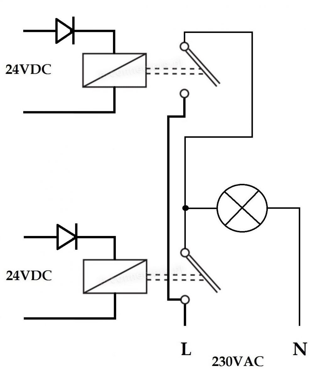

    Okay, and now I'll add something else. One 230 volt lamp so that it lights up from two drives/bulbs alternately. Because I have two drives. ;) .

    This relay is not suitable for switching 230 V circuits.

    But how do you alternate?
  • #13 19779199
    alster1
    Posts: 2105
    Help: 352
    Rate: 540
    shl222 wrote:
    Good, and now I'll add something else. One 230 volt lamp so that it lights up from two drives/bulbs alternately. Because I have two drives. ;)
    A separate relay for each drive, and their actuating contacts connected in parallel.
    Hence:
    gumisie wrote:
    I will not answer you unequivocally,
    But, in my opinion, the lack of description: 230 V AC does not prove anything.
    In the case of this relay, it's rather more about the ceki voltage and the maximum contact current at 24 V DC. :cry: .

    78db78 wrote:
    But how to alternate?
    Two gates one lamp. And once one opens the other time the other, but the light is supposed to come on one
    #16 19779269
    gumisie
    Posts: 17938
    Help: 1667
    Rate: 2485
    shl222 wrote:
    Two gates one light. And once will open one other time the other but the light has to light up one
    alster1 wrote:
    For each drive a separate relay, and their actuating contacts connected in series
    Rather; Parallel and separate the relay coils with diodes?
    E.g.: Gate operator HATO 180 - Connection of an external 230V lamp via relay .

    gumisie wrote:
    Rather; In parallel and separate the relay coils with diodes?
    Actually, a slip of the tongue, sorry already corrected.
  • #18 19781313
    pafciowaw
    Automation specialist
    Posts: 2439
    Help: 480
    Rate: 365
    These isolation diodes (in post #16) are unnecessary...since the coils are fed from two different drives.
