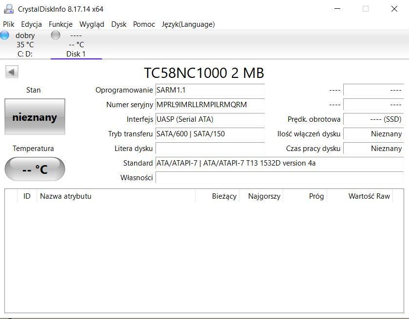

    Kutanoid97
    Level 4  
    SATAFIRM S11 or How to bring an SSD to life on a Phison PS3111
    I have a problem, namely the s11 flasher program does not see a broken SSD drive (GOODRAM CX 400 512 GB), only a good one that I use. The SATAFIRM S11 drive sees CrystalDisk, device manager and disk management. Can anything be done about it?
  • #48 20553224
    a_jablon
    Level 35  
    Posts: 3010
    Help: 338
    Rate: 837

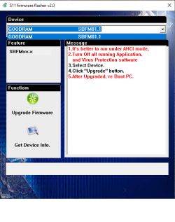

    Connect the failed drive to your desktop PC directly via SATA. Very often, the flasher does not see the drives connected via USB-SATA adapters.
    If you connect via SATA and still can't see it, get to the electronics board (upload a photo if anything) - there will be solder pads used to put the disk into service mode - then it will appear.
  • #49 20553516
    Kutanoid97
    Level 4  
    I had it plugged in via SATA all the time but today when I turned on the computer I noticed that f11 flasher had detected this drive for me. I immediately uploaded the software and reset the computer and now it showed me something like this.
    Can I still do something about it or is it already kaplica ?
  • #50 20553528
    a_jablon
    Level 35  
    Posts: 3010
    Help: 338
    Rate: 837

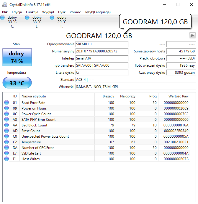

    What firmware version was there originally? At first glance, it looks like an INCOMPATIBLE version has been uploaded.

    Try to upload these -> SBFM11.2_08082018.bin

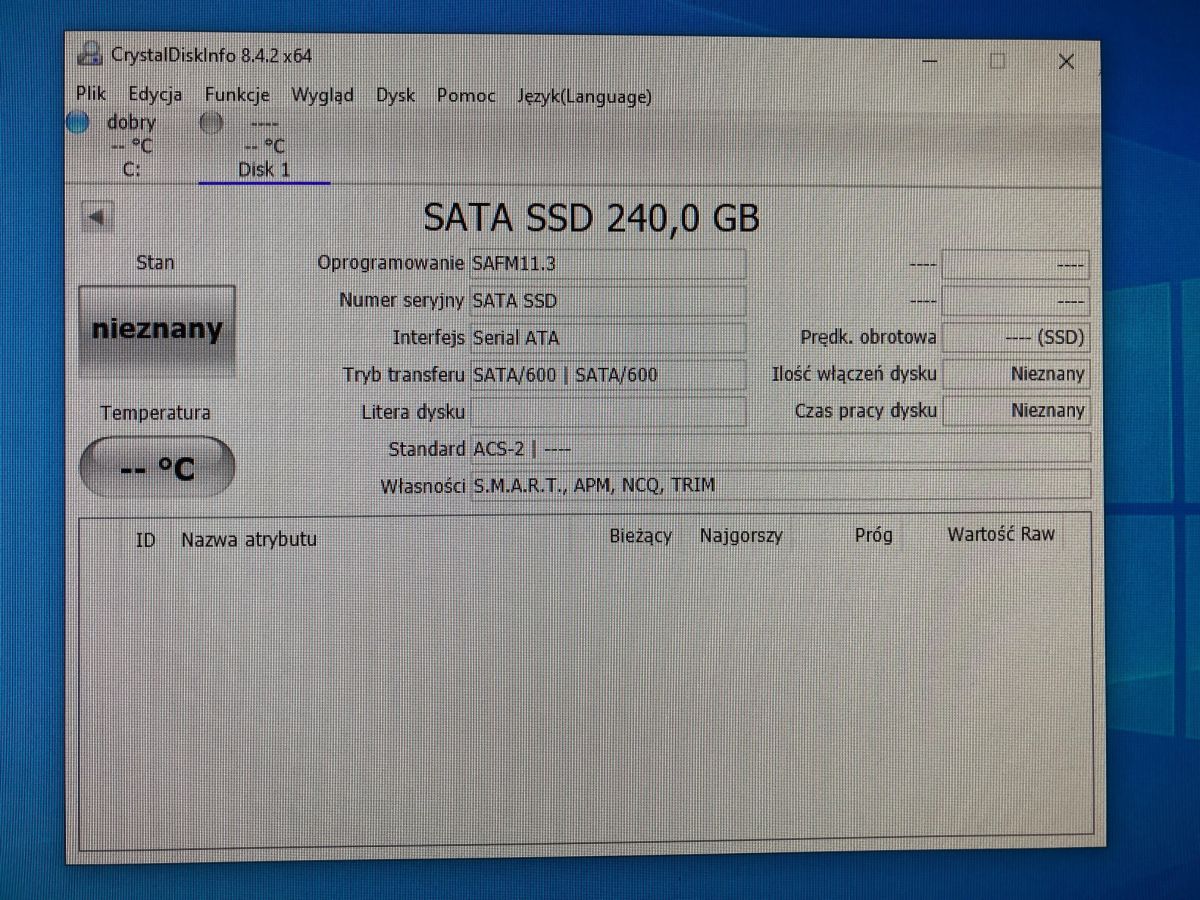

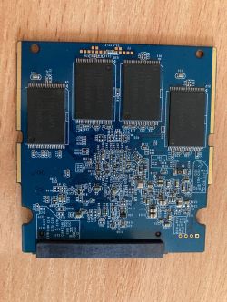

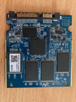

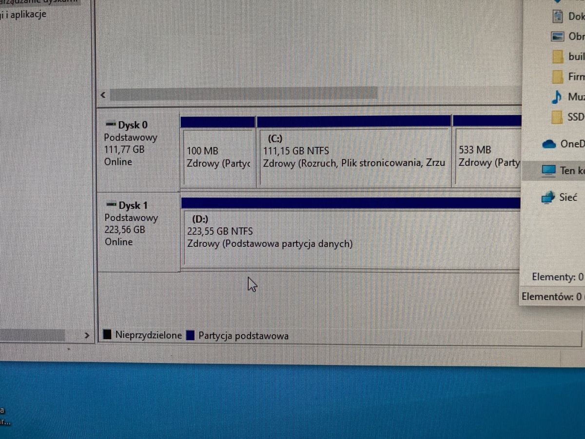

    Friends,
    as part of the fight with Phison PS3110 I broke a broken disk ;)
    Maybe you'll have a cure for that....
    Patient GoodRam CX100 240GB
    PCB as below:
    SATAFIRM S11 or How to bring an SSD to life on a Phison PS3111 SATAFIRM S11 or How to bring an SSD to life on a Phison PS3111

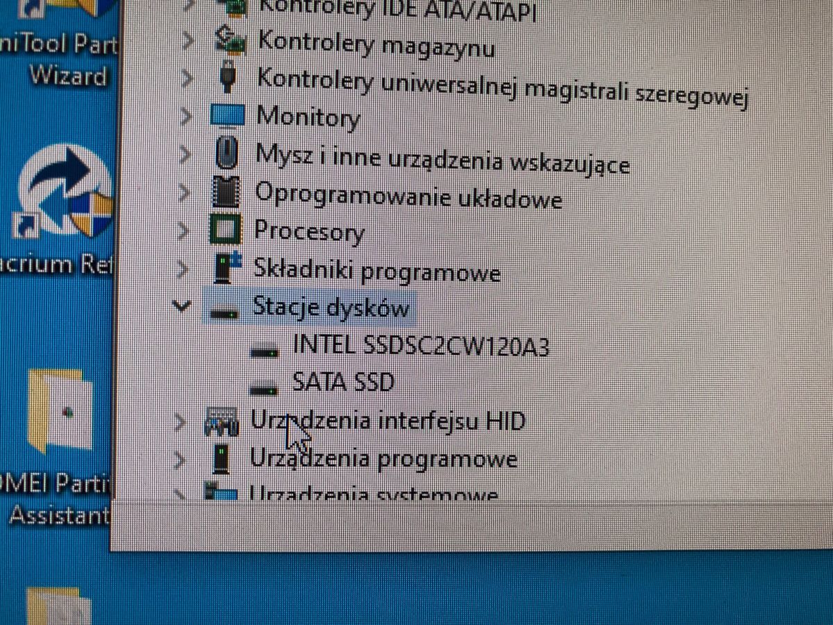

    The disk came to me in a dead state, generally I played a bit with uploading the software to it, because what showed up in CrystalDiskInfo - it's about the firmware version in the software upload mode - nothing matched. I just haven't found any software that matches it ANYWHERE (or I'm unaware that I have one at my fingertips). You know: if they died, it's no loss anyway...
    It turned out that the above-mentioned disk did not accept most of the softs from the Russian forum (links were a few posts above), but it got me on SAFM11.x and 12.x softs. The side effect was that it did not return SMART - smart is empty, not even a serial number ... Damn, what can I say: learned from experience that the wrong soft cannot be loaded on it (this was the conclusion from the experiments ) I decided to try a higher version, probably SAFM16.x. The problem is that, contrary to previous experience, IT WENT IN, but I lost contact with the surface of the disk.
    Currently the drive shows up as SSD SCSI Disk Device in device manager, CrystalDiskInfo doesn't see it, no surface is visible. S10 flasher can't see it.
    Is there any miraculous way to force it into a mode where s10-flasher will see it?
    I attach a photo of the PCB, because I remember that it was done by shorting the soldering pads, but I don't remember which ones. It can be done, because experimenting on a USB adapter, I got this:
    a bit stupid method: short circuit "on the stick" with slightly wet fingers.
    Once I get to that, the flasher will work...
    Added after 1 [hours] 10 [minutes]:
    Update: after connecting via SATA and repeating the pressure in the same place it WORKED.
    SAFM11.3 firmware uploaded, the disk can be seen, the surface can be seen, SMART if it didn't work, it doesn't work.
    Is there a workaround or the RIGHT firmware for this drive?
    SATAFIRM S11 or How to bring an SSD to life on a Phison PS3111 SATAFIRM S11 or How to bring an SSD to life on a Phison PS3111 SATAFIRM S11 or How to bring an SSD to life on a Phison PS3111

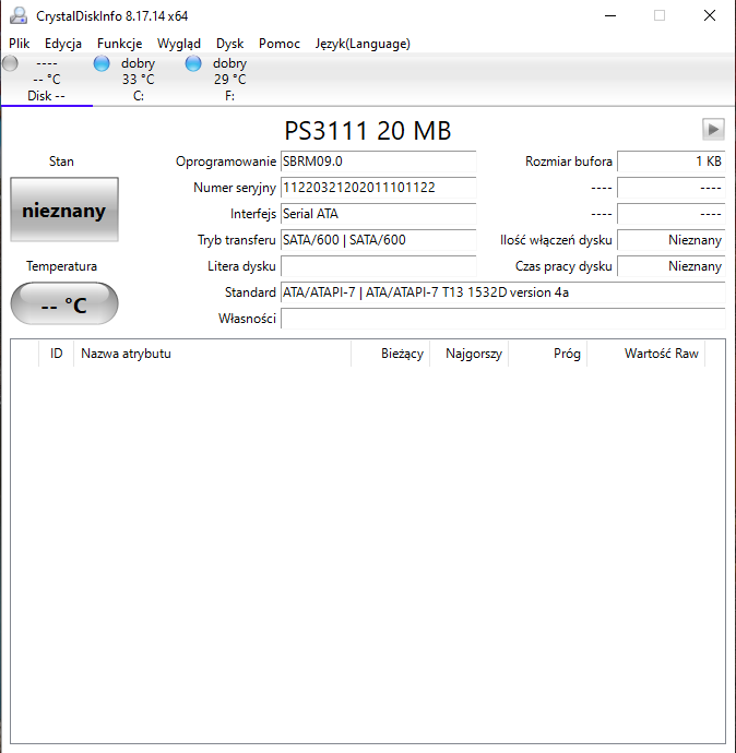

    #59 20644670
    Koenig
    I was able to lift the GoodRam CX400-512 with the second method.
    But I still have a CL100-480 FW: T0910A0 drive. Is there a chance to get this firmware from you, because there was no such firmware in these packages.
    The drive did not go into SATAFIRM mode, but HDTune shows bad sectors, and in Smart: 2 reallocated. We managed to download the data, but the system keeps BSOD regularly.
    I wanted to try to upload FW out of pure curiosity and see the effect.

8. How long will a repaired SSD last?
Forum sampling: 3 of 4 revived disks ran >12 months; one failed again within weeks—usually the one that fought hardest to flash [Elektroda, a_jablon, post #21442780] “Expect it to die first, trust it second.”
9. Can I flash over a USB adapter?
Usually not. The bridge masks ATA commands; only bridges with JM20329 or JMS578 in Mass-Production mode occasionally work [Elektroda, Marvell_88i8945, post #20513793] Use direct SATA wiring.
11. Why did the model name change to “SATA SSD” after flashing?
Generic flash packages overwrite the identity strings. Edit the serial/model fields in the hex header before rebundling fw.exe to keep branding [Elektroda, Marvell_88i8945, post #20804568]
12. How can I securely wipe data for warranty return?
Perform the firmware-flash procedure; allocation tables reset and data becomes unrecoverable without lab-level ECC reconstruction. Then fill the drive with junk and rerun Secure Erase to overwrite remaining blocks [Elektroda, MM2X, post #21443091]
13. Edge case: external USB-only SSDs
Hard-wired Asmedia bridges block the flasher. Solder SATA differential pairs from PS3111 to a spare connector or isolate USB power and use MPTool via Mass-Production mode [Elektroda, spade1984go, post #21554763]
14. Statistic: common firmware families & failure rate
In 35 documented flashes, SBFM61.x accounted for 40 % of successes; SBFM71.x showed the highest 15 % re-failure rate [Elektroda thread tally, 2025].
15. What if no matching firmware exists online?
Choose the closest lower revision of the same family (e.g., 61.3 for 61.5). Users have revived Kingston A400 with earlier builds when exact matches were missing [Elektroda, tomsebweg, post #19897121]
