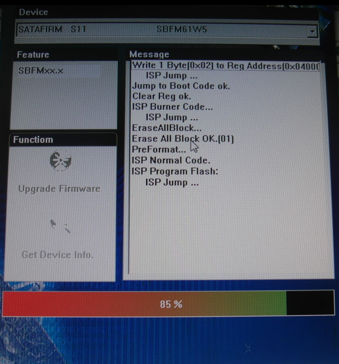

    Hello. I used method 2 on the cx400 fw sbfm61w5 disk, I uploaded sbfm61.5, now the disk is missing in my computer and in management everything was uploaded without errors, visible only through the flasher as ps3111 serm07.0
  • #92 20985229
    rtj71
    IT specialist
    Posts: 4983
    Help: 474
    Rate: 353
    I had a similar experience, I uploaded the same thing a second time and it worked.

    Unfortunately, after the second upload, the same thing happened to me

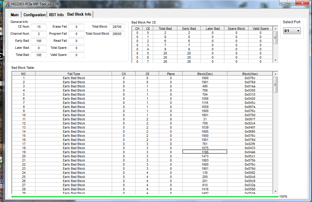

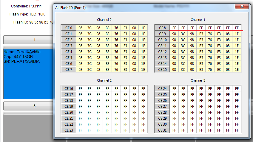

    That`s what I thought, finally, while copying less than 20 GB of test data, it crashed and returned to ROM mode, as if it had turned off the power. Don`t waste your time on these SSDs.
    Out of boredom, I reballed the nands, changing the order, and it turns out that it is not the nands that are causing the disks to disappear, but the Phison controller itself.
    In my case, channel 1 is damaged because after resoldering the NAND, the problem does not transfer to the second theoretically functional channel, signaling a Cell problem. everything is working, but the problem remains on the same channel, i.e. 1, this time the problem is in Cell 8, previously there was a problem in Cell 12.
    Reballing the controller itself didn`t help, the problem remains. So replacing PS3111 alone should restore the drive to full functionality. Most write that NAND is degraded, but they forget that the main controller can also be damaged. Screenshot of diagnostic software showing the structure of memory channels and NAND cells, along with PS3111 controller information.
    In the first photo, there is visible damage in channel 1, cell 8 of the NAND memory, which after transferring to channel 0 is functional, while after transferring NAND, cell 12 shows damage, but again, transferring to channel 0 shows all targets visible with the same ID.
    The second photo shows us NAND defects. As you can see, on cell 15 we have less than 1% damage to NAND blocks, so tell me where do you find NAND degradation? Screenshot of HG2263-PCie MP Tool v2.2.70 showing NAND block damage details.
    btw, I insisted on it :D and the post is intended to show and perform an in-depth analysis whether NAND is actually the reason for the disappearance of these disks, or the Phison controller. As you can see in my example, it was the controller that died, not the NAND.

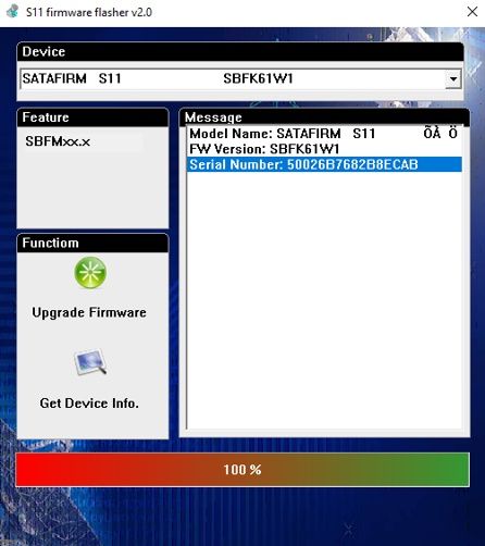

    Hey I have this problem as well. My firmware says that it is SBFK61W1 and that firmware cannot be found in the firmware dump provided. I have provided a picture. I anyone can help me with this it would be much appreciated because I do not know how many more times I can watch a Russian man try to explain to me how to do this. Screenshot of S11 firmware flasher v2.0 application showing device information and firmware upgrade functions.

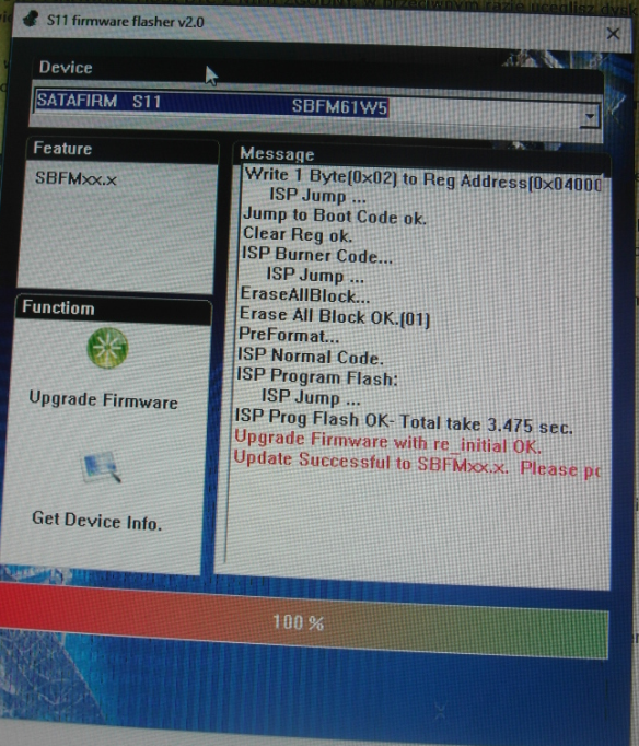

    I managed to put on my feet a Gigabyte 256GB ssd (Satafirm-S11) , admittedly I had a different idea / disk under warranty and I wanted 100% data erasure and here as "for spite" works ;) / .
    Screen showing firmware update for a 256GB Gigabyte SSD with process messages. Screen of the S11 firmware flasher v2.0 program with SSD firmware update information. .
    Thanks fest :) .
  • #119 21441682

4. How do I choose the right firmware?
Match the first five characters (e.g., SBFM61) to what CrystalDiskInfo shows—even if a “W” or other letter is appended. Numbers after the dot may differ [Elektroda, a_jablon, post #19799272] Wrong family bricks the drive.
5. 3-step revival procedure (safe method)
  1. Connect SSD to a native SATA port.
  2. Run s11-flasher2-micron or ‑toshiba (no admin) to build fw.exe, place fw.bin inside.
  3. Launch fw.exe as Administrator, click UPGRADE, then power-cycle the PC [Elektroda, a_jablon, post #19799272]
6. Drive not detected by flasher—what now?
Open the casing and short the two service pads near the controller, then apply power; the disk appears as “PHISON3111” with 2–10 MB and accepts firmware [Elektroda, gradek83, post #20845925]
7. Flash halts at 85 % with “ISP” or “AP-KEY” error—fix?
This often signals heavily worn NAND. Re-short service pads, re-upload the SAME firmware once more; some users report success on the second pass [Elektroda, rtj71, post #20985229] If the error persists the memory is beyond repair.
