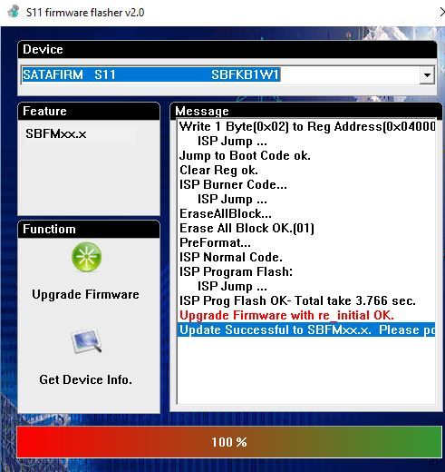

SATAFIRM S11 or How to bring an SSD to life on a Phison PS3111
a_jablon 198762 195
How can I revive a Phison PS3111 SSD that shows up as SATAFIRM S11?

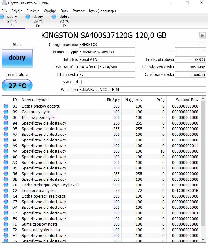

Flash a matching PS3111 firmware build for the exact SBFM family/version you find in CrystalDiskInfo or on the label; the useful rule is that the letters and the first two digits must match, and if the latest compatible build fails, try the older compatible one from the package [#19799294][#21449568] If the flasher does not see the drive, connect it directly by SATA, not through a USB-SATA adapter, and if needed short the service jumper/pads so the controller appears in PS3111/ROM/safe mode with a tiny capacity for flashing [#20553224][#21449568][#21557753] The procedure is destructive: it erases the data, rebuilds the defect/translator tables, and the drive may only be temporarily revived because the underlying NAND can still be worn or damaged [#19801406][#21466775] SMART readings are often meaningless on these SSDs, so they should not be treated as proof of health; the real indicator is whether the controller comes back after the firmware rewrite [#19801406]

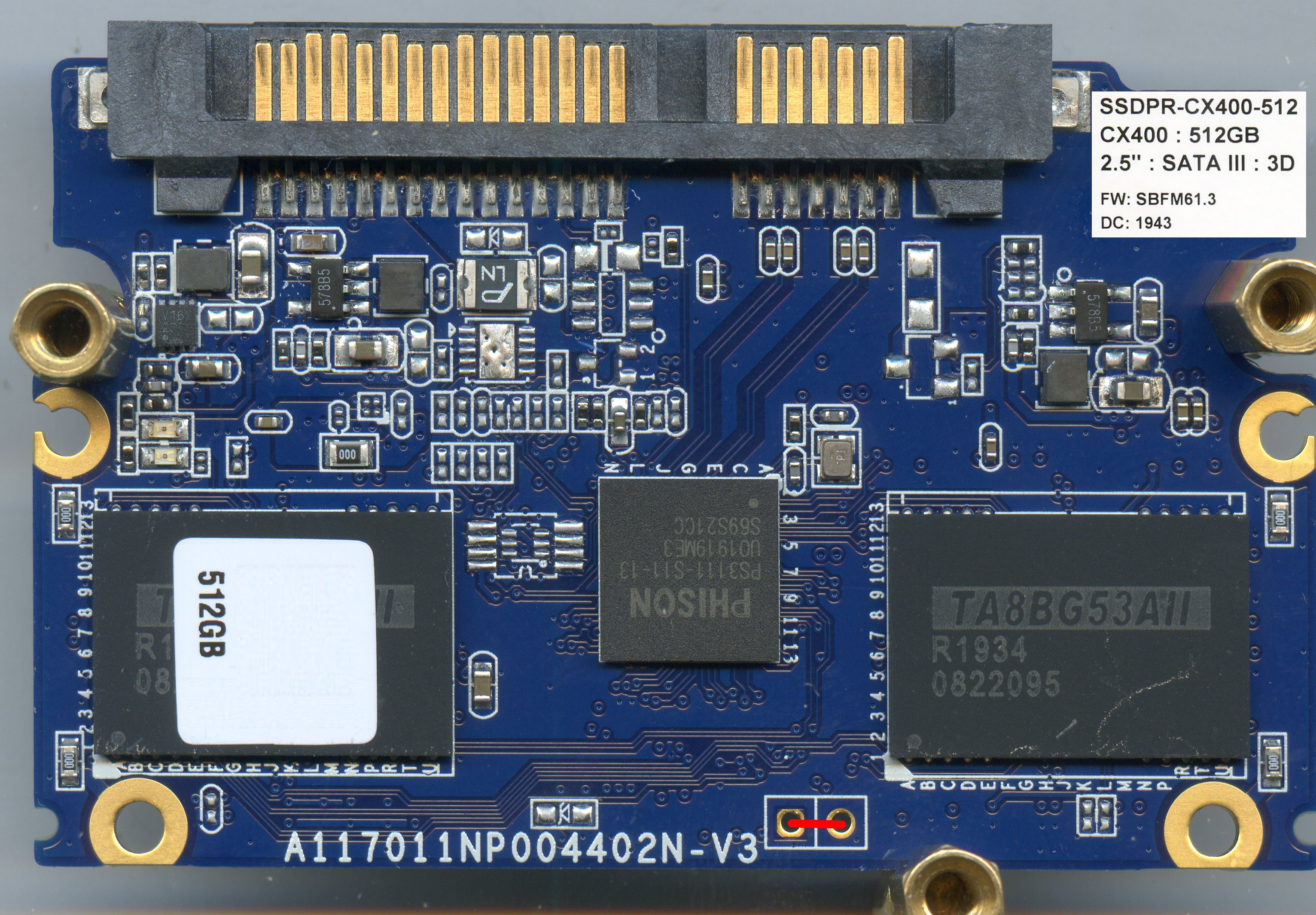

    1) I start the SSDMPTool program
    2) I short-circuit the jumper on the motherboard PCB
    3) I connect the drive to the SATA-USB adapter
    4) I connect it under USB 2.0 ( the drive in the "Device Manager" detects as "PS3111 SCSI Disk Device". Hardware ID: SCSI\DiskPS3111__________________6601
    Profram information: ChipGenius
    Spoiler:
    Description: USB-attachable SCSI storage device (UAS)(PS3111)
    Device Type: Mass Storage Device
    Protocal Version: USB 2.10 <- Hint: This device can run faster when plugged to a USB3.0 port
    Current Speed: High Speed
    Max Current: 30mA
    USB Device ID: VID = 7825 PID = A2A4
    Serial Number: MSFT30DB9876543211347
    Device Vendor: JMicron
    Device Name: JMS567
    Device Revision: 6601
    Manufacturer: PS3111
    Product Revision: 6601
    Controller Part-Number: Unknown
    5) In the SSD MP Tool in the Main tab on 1 port I have a blue window
    6) I go to the tab "Configuration" I click on "EDIT" I enter the password 123
    Then I click on "Detect" and a window appears saying "Flash ID is unkown!".
    7)Double-clicking on the blue window in the "Main" tab gives me this result:
    Screenshot showing a program window with All Flash ID (Port 1) information and several values. .
    8) Selecting Manual there is no configuration under this memory.
    And I still don't know what to do.
    Maybe I have too old a version of this program?
    There is already a version Phison PS3111 SSD MPTool v2.2.85 you can download from this page ? I get a message "You are not allowed to access this file!"
    If you manage to download it, please share thanks in advance.

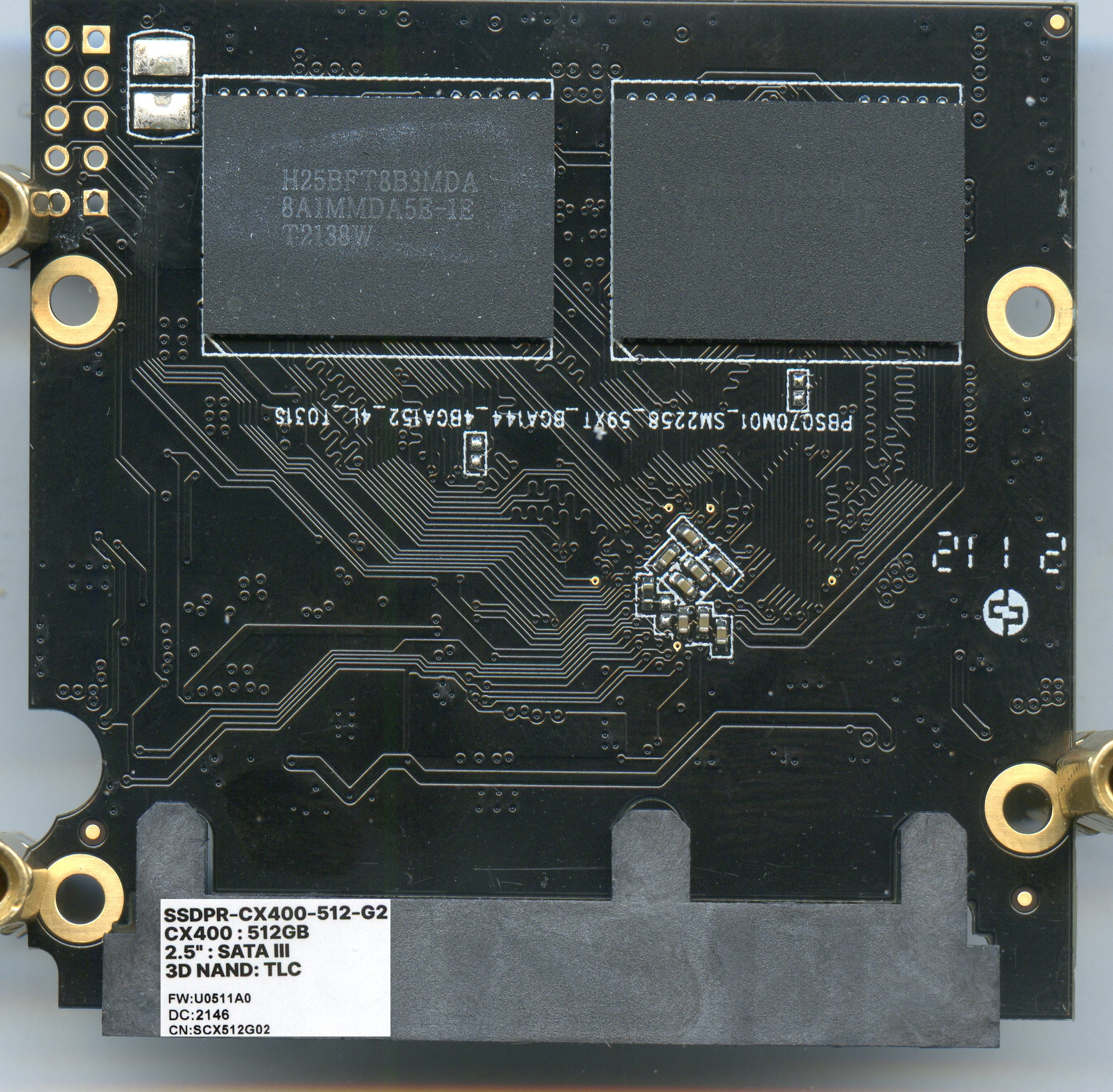

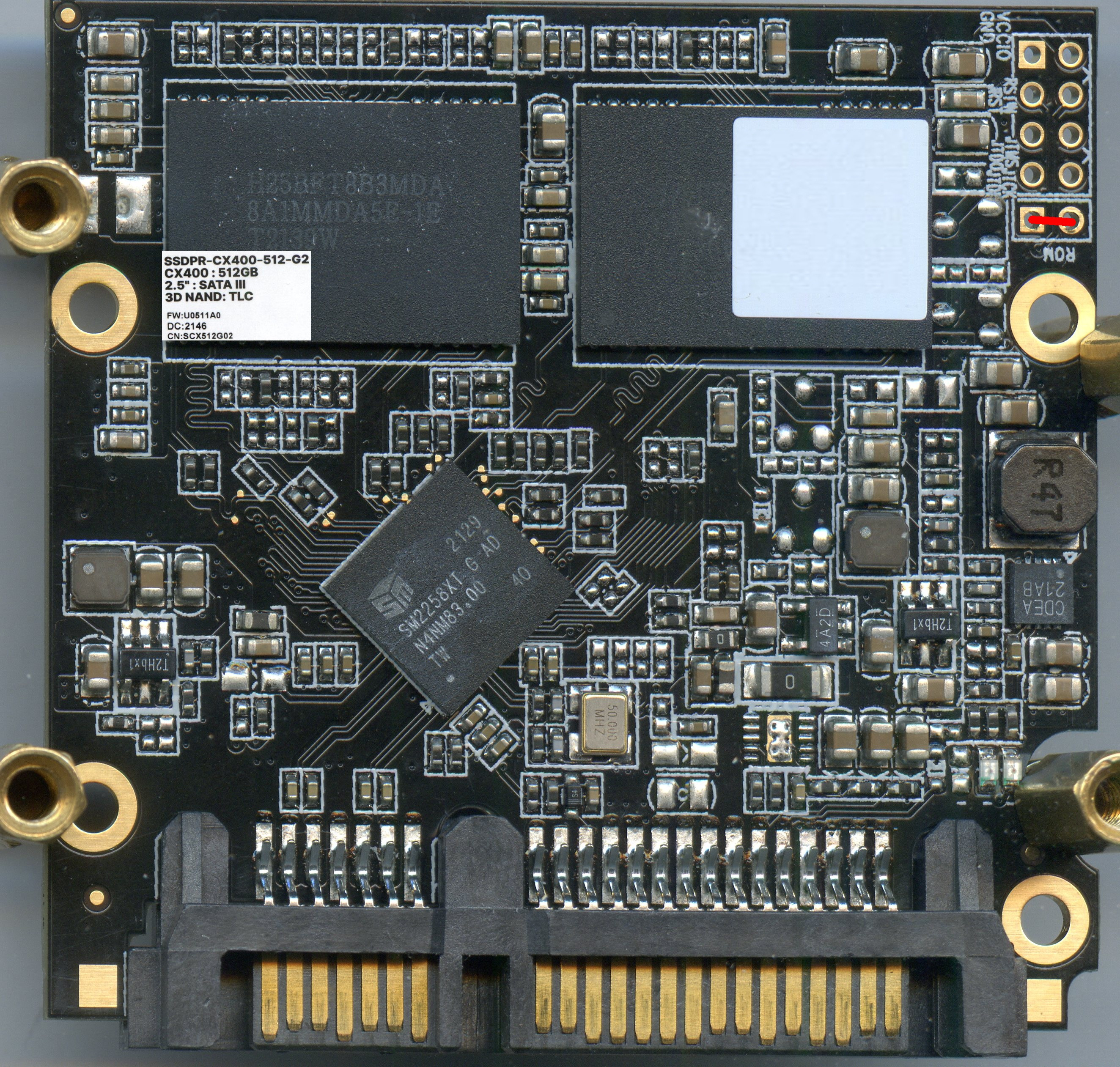

    EDIT:1
    Under the same disc name, GOODRAM has released another version of the motherboard if it is not another of many this one is on a
    Chip : SM2258XT
    Memory: H25BFT8B3MDA
    Firmware: FW:U0511A0
    EDIT:2
    And another version of the motherboard.
    Layout: PS3111-S11-13
    Memory: TA8BG53AII
    Firmware: FW:SBFM61.3
    Spoiler:

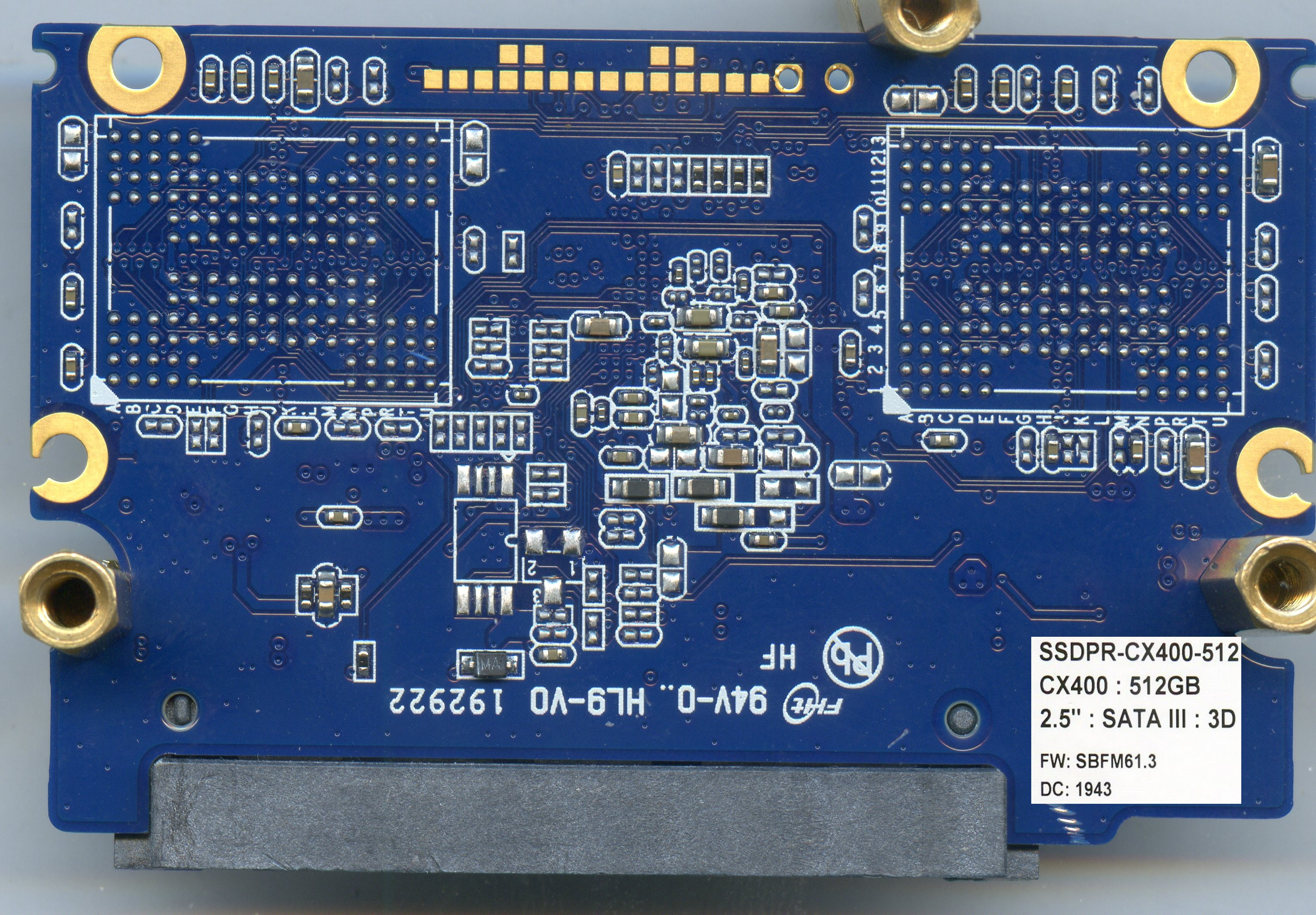

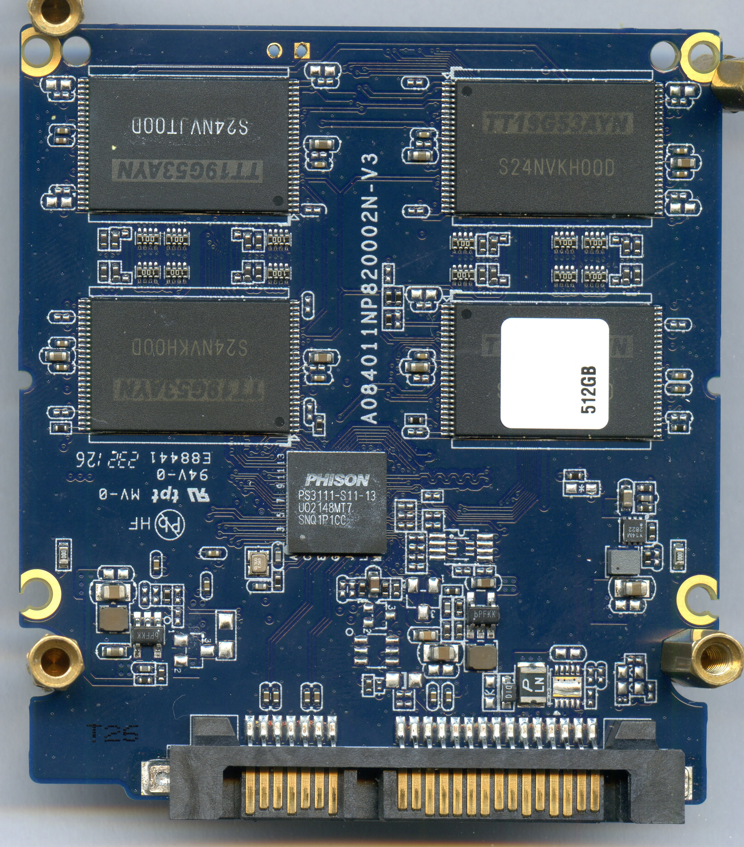

    • SATAFIRM S11 or How to bring an SSD to life on a Phison PS3111 PS3111-S11-13 TA8BG53AII PCB_A.jpg (1.72 MB) You must be logged in to download this attachment.
    • SATAFIRM S11 or How to bring an SSD to life on a Phison PS3111 PS3111-S11-13 TA8BG53AII PCB_B.jpg (1.85 MB) You must be logged in to download this attachment.
    • SATAFIRM S11 or How to bring an SSD to life on a Phison PS3111 PCB_A_SM2258XT.jpg (2.07 MB) You must be logged in to download this attachment.
    • SATAFIRM S11 or How to bring an SSD to life on a Phison PS3111 PCB_B_SM2258XT.jpg (1.96 MB) You must be logged in to download this attachment.
    • SATAFIRM S11 or How to bring an SSD to life on a Phison PS3111 PCB_B.jpg (3.37 MB) You must be logged in to download this attachment.
    • SATAFIRM S11 or How to bring an SSD to life on a Phison PS3111 PCB_A.jpg (3.34 MB) You must be logged in to download this attachment.

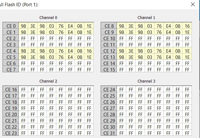

    Spoiler:
    v0.844a
    Drive: 5(ATA)
    OS: 10.0 build 19045
    Model: SATA SSD
    Fw : SBFM61.5
    Firmware lock supported [FB 00 01 01]
    Drive unlocked [FB 00 01 03]
    S11fw: SBFM61.5, 2021Jun17
    Bank00: 0x98,0x3e,0x98,0x3,0x76,0xe4,0x8,0x1e - Toshiba 112L BiCS5 TLC 16k 512Gb/CE 512Gb/die 2Plane/die
    Bank01: 0x98,0x3e,0x98,0x3,0x76,0xe4,0x8,0x1e - Toshiba 112L BiCS5 TLC 16k 512Gb/CE 512Gb/die 2Plane/die
    Bank04: 0x98,0x3e,0x98,0x3,0x76,0xe4,0x8,0x16 - Toshiba 112L BiCS5 TLC 16k 512Gb/CE 512Gb/die 2Plane/die
    Bank05: 0x98,0x3e,0x98,0x3,0x76,0xe4,0x8,0x1e - Toshiba 112L BiCS5 TLC 16k 512Gb/CE 512Gb/die 2Plane/die
    Bank08: 0x98,0x3e,0x98,0x3,0x76,0xe4,0x8,0x16 - Toshiba 112L BiCS5 TLC 16k 512Gb/CE 512Gb/die 2Plane/die
    Bank09: 0x98,0x3e,0x98,0x3,0x76,0xe4,0x8,0x1e - Toshiba 112L BiCS5 TLC 16k 512Gb/CE 512Gb/die 2Plane/die
    Bank12: 0x98,0x3e,0x98,0x3,0x76,0xe4,0x8,0x1e - Toshiba 112L BiCS5 TLC 16k 512Gb/CE 512Gb/die 2Plane/die
    Bank13: 0x98,0x3e,0x98,0x3,0x76,0xe4,0x8,0x1e - Toshiba 112L BiCS5 TLC 16k 512Gb/CE 512Gb/die 2Plane/die
    Controller : PS3111
    Flash CE : 8
    Flash Channel : 2
    Dram Size,MB : 32
    Flash CE Mask : [++--++-- ++--++--]
    Flash Mode/Clk: 5/7 (Set 0/0)
    Block per Die : 3324
    Block per CE : 3324
    Page per Block : 1344
    SLC Cache : Default
    PE Cycle Limit : 100335706
    ParPage : 00
    MaxBBPerPlane : 37
    Plane : 2
  • #75 20813048
    Marvell_88i8945
    Posts: 505
    Help: 20
    Rate: 72
    This drive of yours has different types of memory with the same organization. You can see Banks 08, 04 confirm this.

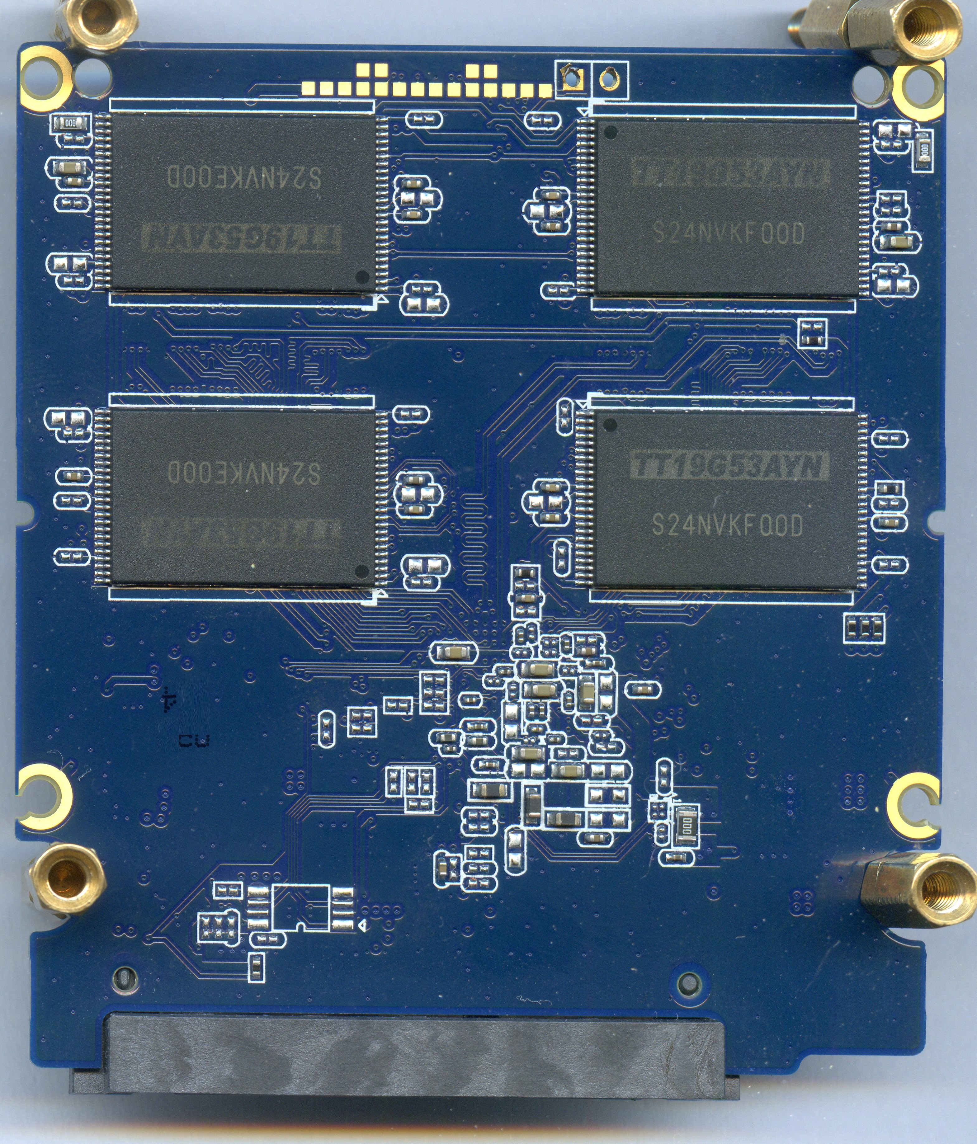

  • Asking which PS3111 pins to short for recovery

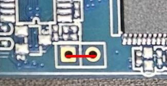

    #76 20845911
    TomaszTorbus
    does anyone know which pins to short-circuit? Currently, after the update, I had the same problem as my colleague @Kutanoid97 - ps3111 20mb. Currently, sata and usb adapters do not see it. Apparently, short-circuiting some fields causes a restart. Unfortunately, I don't know which one or how to do it? (whether the disk is turned on or off.
    Goodram CX400 128GB.
    Close-up of the circuit board of a Goodram CX400 128GB drive with a field marked in a red circle.
    Is it what I marked in the photo?
  • #77 20845925
    gradek83
    Posts: 9107
    Help: 930
    Rate: 2103
    NO
    Close-up of a circuit board with a red wire bridge connecting two solder points.
  • #78 20845929
    TomaszTorbus
    thanks, so I'll move on to further tests ;)
    ps. unfortunately it didn't help. No change whatsoever :C

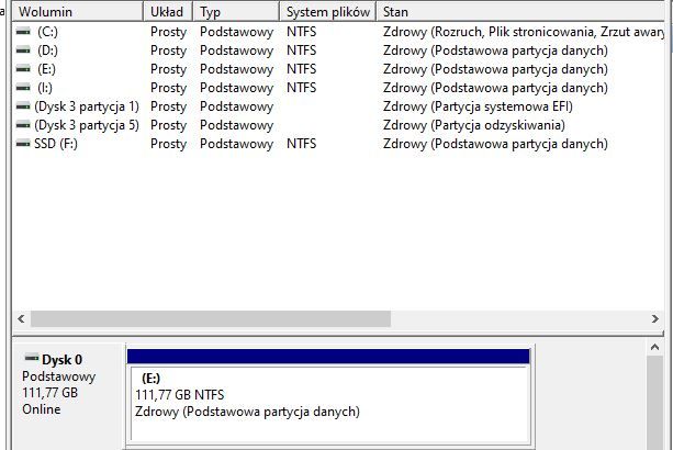

    TomaszTorbus
    oh damn xd it worked, I can see it in the manager now, so pour you a beer ;p I'll see if I can bring it back to life with an attachment from you. Regards
    edit: unfortunately - the disk is probably dead, it still stays as SBRM02.0, the goodram program only throws errors. According to the FW sticker: SBFM61.3. I uploaded each of the packages one by one, but it's still the same.

  • NAND self-test and defect list reconstruction needed
    #86 20847381
    Marvell_88i8945
    Posts: 505
    Help: 20
    Rate: 72
    gradek83 wrote:
    If you think that it may be the fault of one of the memory chips, maybe (if such a trick works) it would be possible to purely experimentally cut off the power supply to each of the memory chips and maybe then you will be able to locate the faulty chip and replace it or, if it will be possible to use it without it. This can be treated as an experiment.
    I have 2 sticks of 256 GB each with 2 x 16 channels, crappy Toshiba Bics4, I reballed them one by one, I reballed Phison's main MCU as well, I poured warm urine on this disk because I lost the BGA balls, I only spent a lot of time on experiments . Which turned out to be a fiasco anyway.
    gradek83 wrote:
    So the disk has two firmwares or should it be treated separately? How to check what firmware I have for the masked ROM? Which program shows this, which firmware can be updated, or is it done during the update, the name is a regular firmware, e.g.: SBFM61.5
    Yes, the disk has 2 FWs, one is used to initialize the controller, in this case for Phison, the other is the Nandow FW, and depending on the manufacturer, many are used, it is for NAND access, there is also a FW for RDT, which is used for low-level Nandow self-tests, for new NANDs. Revision Masked ROM will not show you when FW Nandow is loaded because there is no need for it. Masked ROM is needed to reinstall FW for NANDs, for JTAG, debug over UART, but anyway, in my case I have already diagnosed that I need to perform a full self-test of NANDs, reconstruct the Defect list, translator to re-initialize access to NANDs, because currently it is it's a mishmash and nothing works. And this is achieved through a USB dongle that allows you to force the RDT NAND selftest mode, you just need to build it.
    The fact is that this is absolutely not a profitable endeavor, because there is no evidence that such a "refurb" works longer than the moment to which the files are copied.
  • #87 20889757
    maulyy00
    >>19799272
    Thanks brother!
    worked on : GIGABYTE GP-GSTFS31240GNTD - SBFM61.3 Screenshot of CrystalDiskInfo showing details of a GIGABYTE GP-GSTFS31240GNTD 240 GB SSD.

    rtj71
    IT specialist
    Posts: 4983
    Help: 474
    Rate: 353
    The third disk was saved, this time Kingston SA400
    Screen of S11 firmware flasher with firmware update for Kingston SA400 drive. Screenshot of Windows Disk Management showing various disk partitions, all healthy. Disk marked as Kingston SA400. Screenshot of CrystalDiskInfo displaying details of a Kingston SA400S37120G 120 GB disk.

  1. Connect SSD to a native SATA port.
  2. Run s11-flasher2-micron or ‑toshiba (no admin) to build fw.exe, place fw.bin inside.
  3. Launch fw.exe as Administrator, click UPGRADE, then power-cycle the PC [Elektroda, a_jablon, post #19799272]
6. Drive not detected by flasher—what now?
Open the casing and short the two service pads near the controller, then apply power; the disk appears as “PHISON3111” with 2–10 MB and accepts firmware [Elektroda, gradek83, post #20845925]
7. Flash halts at 85 % with “ISP” or “AP-KEY” error—fix?
This often signals heavily worn NAND. Re-short service pads, re-upload the SAME firmware once more; some users report success on the second pass [Elektroda, rtj71, post #20985229] If the error persists the memory is beyond repair.
