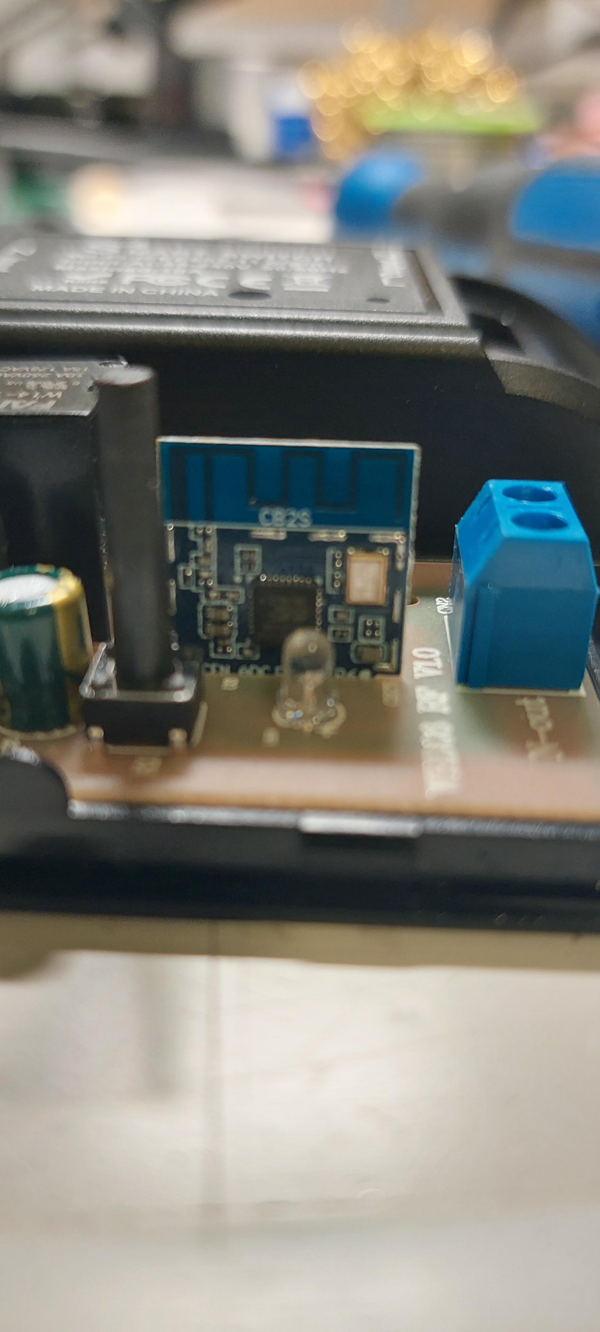

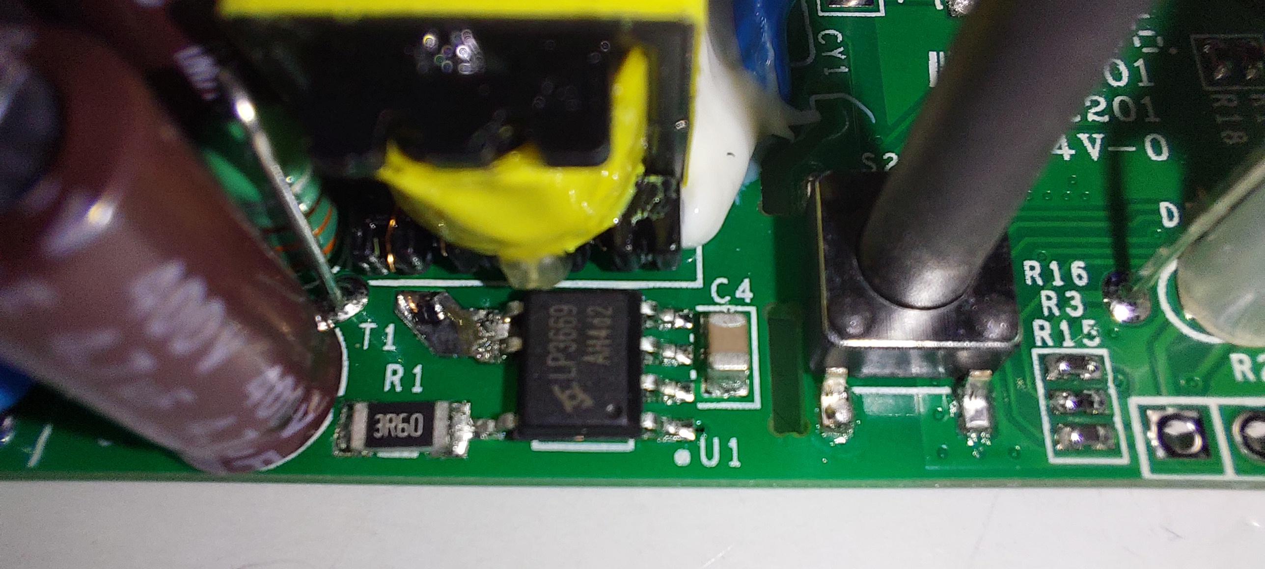

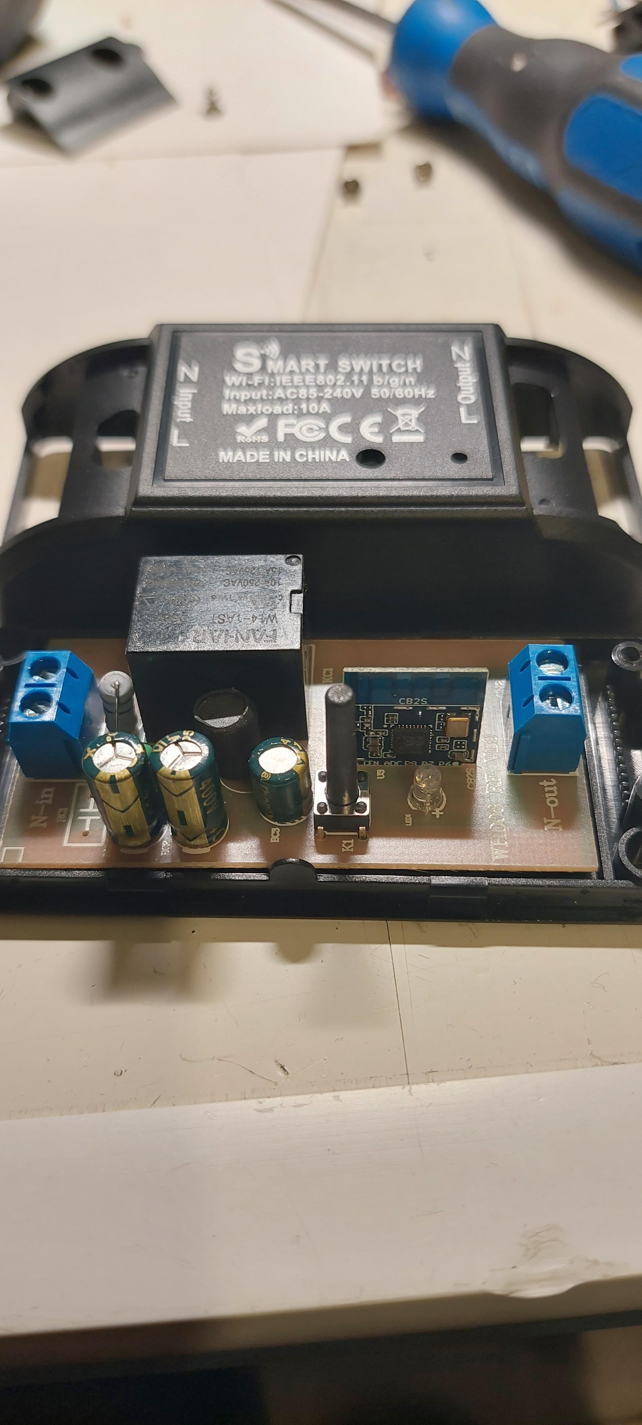

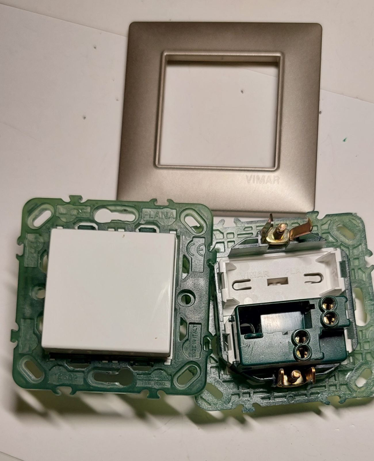

    These switches were used in the experiments.
    At the same time, one of the modules received, by mistake, voltage to the brain, and not to where it is needed and will be used further as a body. The WB2S module. I used the "programmer" for ESP-01.
    The second test subject was assembled on the CB2S module on BK7231N. He has not yet participated in experiments.
    Schematics from modules, pinout, are found here
    The third module, Sonoff, is built on 8285. The firmware will be loaded either homemade or ESPEasy.
    Spoiler:
    Foto
    Garden Tuya CCWFIO232PK Double Relay - BK7231T - Programming20220903_0..356.jpg (664.57 kB)You must be logged in to download this attachment. Garden Tuya CCWFIO232PK Double Relay - BK7231T - Programming20220903_0..712.jpg (1.04 MB)You must be logged in to download this attachment. Garden Tuya CCWFIO232PK Double Relay - BK7231T - Programming20220903_0..921.jpg (632.57 kB)You must be logged in to download this attachment. Garden Tuya CCWFIO232PK Double Relay - BK7231T - Programming20220903_0..914.jpg (740.31 kB)You must be logged in to download this attachment. Garden Tuya CCWFIO232PK Double Relay - BK7231T - Programming20220903_0..931.jpg (567.29 kB)You must be logged in to download this attachment. Garden Tuya CCWFIO232PK Double Relay - BK7231T - Programming20220903_0..058.jpg (364.22 kB)You must be logged in to download this attachment. Garden Tuya CCWFIO232PK Double Relay - BK7231T - Programming20220910_1..745.jpg (829.23 kB)You must be logged in to download this attachment. Garden Tuya CCWFIO232PK Double Relay - BK7231T - Programming20220910_1..032.jpg (781.81 kB)You must be logged in to download this attachment. Garden Tuya CCWFIO232PK Double Relay - BK7231T - Programming20220910_1..831.jpg (965.08 kB)You must be logged in to download this attachment. Garden Tuya CCWFIO232PK Double Relay - BK7231T - Programming20220910_1..726.jpg (1.37 MB)You must be logged in to download this attachment.
    p.s. The plans are to add an external triac relay, G3MB-202P, to the small module and output another control channel.

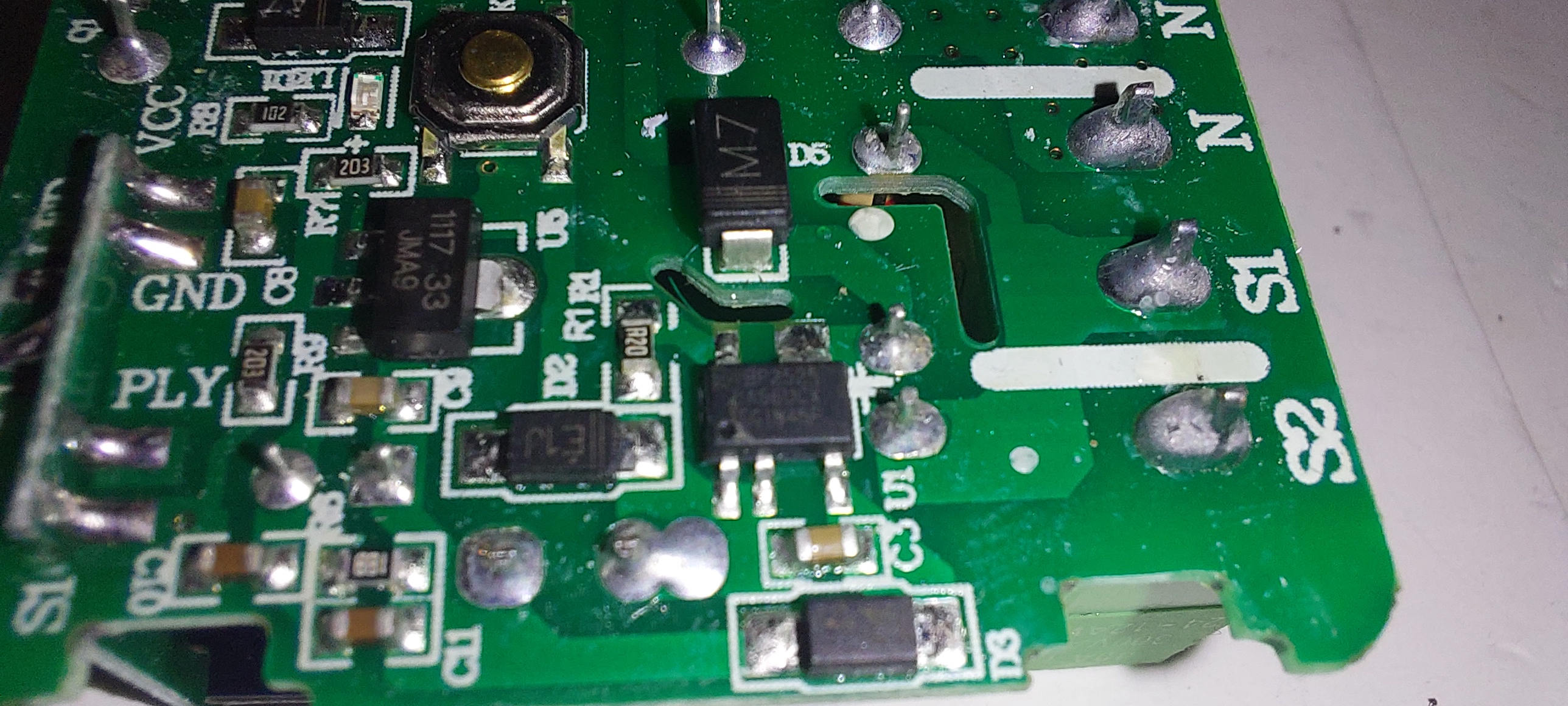

    https://www.elektroda.pl/rtvforum/topic3793509.html
    Yes, that's what I wanted to understand!!!Link
    That's how they came up with it!
    D3, 4 and 5 are zener diodes. Probably about 3-5 volts.
    The supply voltage minus the voltage required to trigger the optocoupler in the feedback circuit. R3 is not 195, it's 561.

    It was very fun to reverse engineer that schematic, altough I would note that I saw some slightly different solutions used as well, but I didn't draw schematics for them yet.
    Also, T2 is not BC547 on that schematic, I just used the first transistor I had at hand in Eagle. It is rather MJE13001.

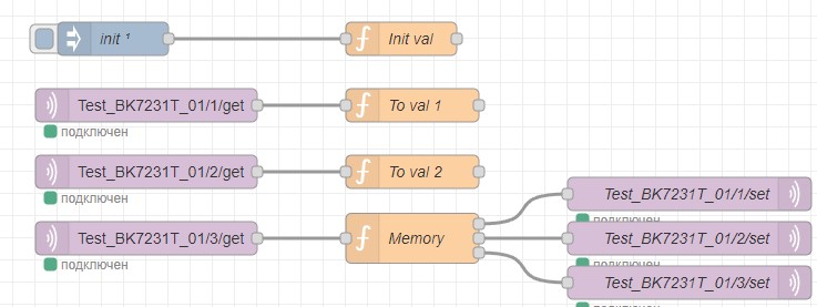

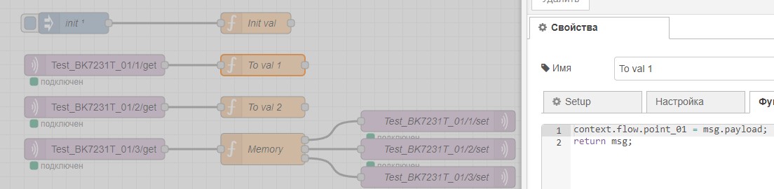

    Another experiment.
    Configured - button 1 turns on channel 1 by a single click, channel 2 by a double click. Button 2, located on the board, is configured for channel 3, the output for it is P8, it really exists, but is not used yet.
    On Raspberry, channel statuses are accepted in Node-Red, the following happens:
    With each change in the status of channels 1 and 2, their values are assigned to variables.
    When the status of channel 3 changes to on, 1, we check the status of channel 1 and 2. If at least one has the status 1, we store the statuses of channels 1 and 2 in other variables, and send them to three channels off, 0 for management.
    If there is currently 0 and in memory the current statuses are 0 - we just turn on channel 1.
    Otherwise, we restore the last saved state.
    There are no rules yet, or I have not found them due to lack of education, I am trying to implement them like this...
    A switch will be used for implementation, the power internals will be dismantled, two buttons will be added, they will be connected directly inside, as well as an additional relay - the terminals on the module are not enough.
    Button 1 will be activated by pressing the upper part of the key, 2 - by pressing the lower part. the photo is just a fitting.

    omelchuk890 wrote:
    Once again, I apologize for the importunity, but perhaps the marked topics should be attributed to a separate opportunity to send or not? Isn't this necessary only at the debugging stage?
    Spoiler:
    As far as I know, it was added by @iprak and in the current state of things it's always published. Do you think it should be only published when a certain flag is set?
    Very nice setup! I like how advanced is your Node-Red usage.
    We already have event handlers and timer, more advanced scripting is coming soon.

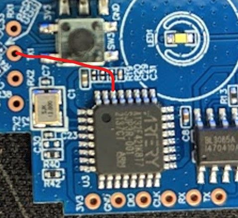

    I was referred here to ask for help, so here goes:
    I recently found they updated the circuit board inside the FEIT wifi dimmer switch to one that looks easier to get at and uses the BK7231TQN32 chip.
    Unfortunately, I am running into issues getting it to flash. I have been able to connect to RX2/TX2 and see the logs, and I can reset by grounding CEN. However, Beken Writer fails every time I try to read/write to it.
    I'm guessing I am overlooking something simple. Are there any steps beyond connecting the HW-597 and flashing? I'm starting to wonder if the pinouts on the board are not quite true to their labels.

    Can you check with multimeter, is the RX/TX of BK7231 chip connect to any pins of the secondary MCU on the board?
    I would guess that this board is using TuyaMCU to communicate the WiFi module with secondary MCU and its using RX/TX lines for this purpose, so MCU interferes with programming.

    @p.kaczmarek2 Right you are!
    It looks like the TX1 pin is connected to one of the pins on the larger chip. Not sure I can easily disable that with it so small/tight.. I'll have to bust out the bench magnifier to see what I can trace on the board. Unless there is another option?

    Option 1: cut RX/TX traces to secondary MCU
    Option 2: Find secondary MCU datasheet, determine if it has a RESET pin, and if so, put this MCU in RESET mode so it does not interfere with programming.
    What is the marking on this MCU? It looks somewhat like AT32F421K817, but that one seems incorrect. Still, maybe it is:
    https://www.arterytek.com/download/DS_AT32F421_EN_V1.01.pdf
    Maybe try grounding NRST?

    You got the right datasheet. It is the AT32F421K8T7
    https://www.arterychip.com/download/RM_AT32F421_EN_V1.01.pdf
    I will give grounding NRST and see if that works.
    Wish me luck!
    Added after 2 [hours] 1 [minutes]:
    Well, on the plus side, there is a NRST contact on the back of the board connecting directly to the NRST pin on the secondary MCU:
    On the downside, I cannot seem to get it to read the firmware no matter when I touch off the NRST and click "Read flash" in BKWriter.

    If that's a NRST of MCU, you just ground it forever, do a flash read, and then unground it only if you want MCU to run again.
