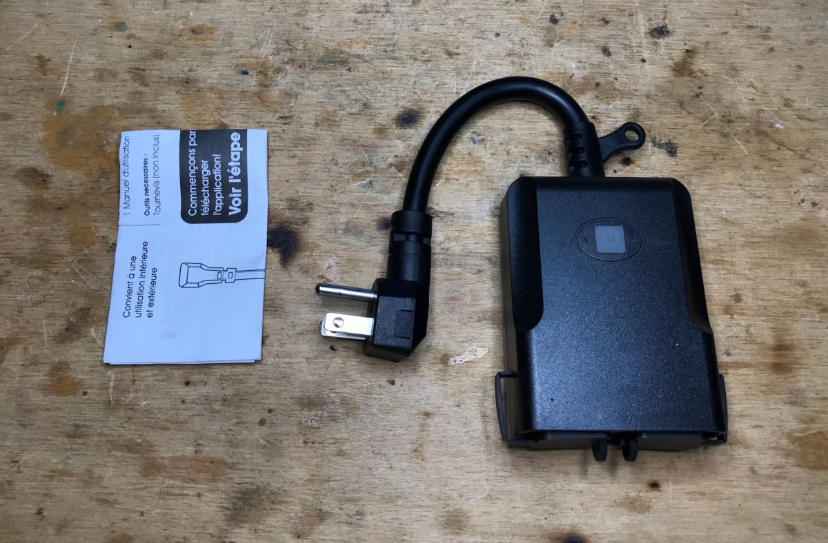

    Kit Contents:
    Garden Tuya CCWFIO232PK Double Relay - BK7231T - Programming Garden Tuya CCWFIO232PK Double Relay - BK7231T - Programming

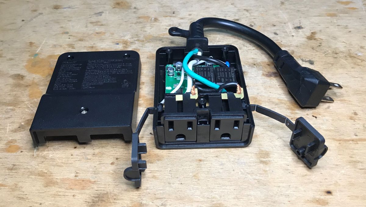

    Well, in Canada they have a different standard of sockets than ours. The device is on 120V. I think that 230V would also work, but you need to check it after opening (check the parameters of all elements and their catalog notes, from the inverter controller as there is, through capacitors to relays).
    The housing is screwed together with screws.

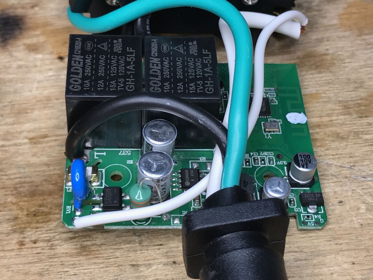

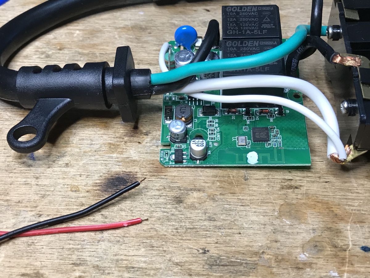

    Inside we have two relays, one button and a 32-bit microcontroller with WiFI BK7231T, but simply placed on the main PCB of the device, not in the form of a module such as WB2S or WB3S:
    There is a fuse at the input, a varistor, a simple filter on the choke:
    The power supply itself is transformerless - based on the ICW4008.
    BK7231T - we will program it. Right next to it you can see the voltage regulator 3.3V, because BK works at 3.3V and the relay works at 5V (sometimes at 12V).
    Garden Tuya CCWFIO232PK Double Relay - BK7231T - Programming Garden Tuya CCWFIO232PK Double Relay - BK7231T - Programming Garden Tuya CCWFIO232PK Double Relay - BK7231T - Programming
    You can also see two transistors that control the relays.

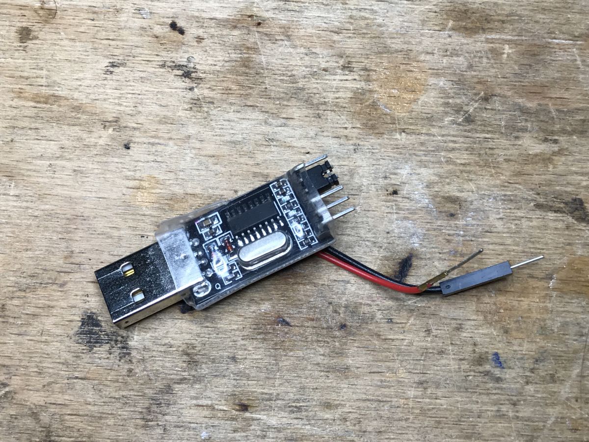

    Connect the USB UART converter, here the HW-597 USB I like is TTL, in the 3.3V mode (jumper between VCC and 3V3), along with the power supply derived directly from the USB (it will not work from the pin signed 5V because it has a slightly different role):

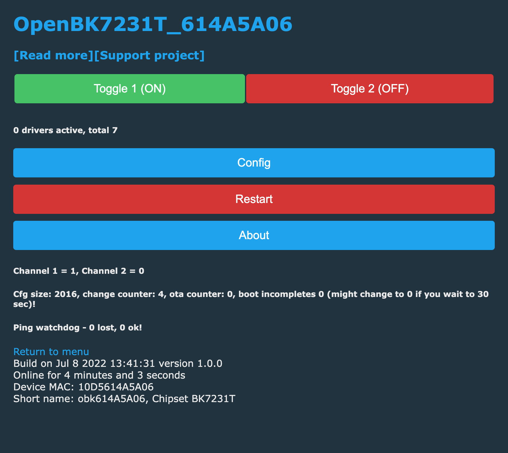

    The BK access point is already visible:
    We connect to the WiFi point created by the BK7231T.
    Here you may need to set our WiFi to a rigid IP, e.g. 192.168.4.10, in case DHCP does not work:
    We open the page 192.168.4.1:
    In Config, we set what we need (e.g. information on our home WiFi):
    After setting the bearings on our home WiFi, we reset the system. You may also need to disconnect the power supply temporarily or wait a minute for the device to join our network. Its new IP can be found on our router in the list of DHCP clients:

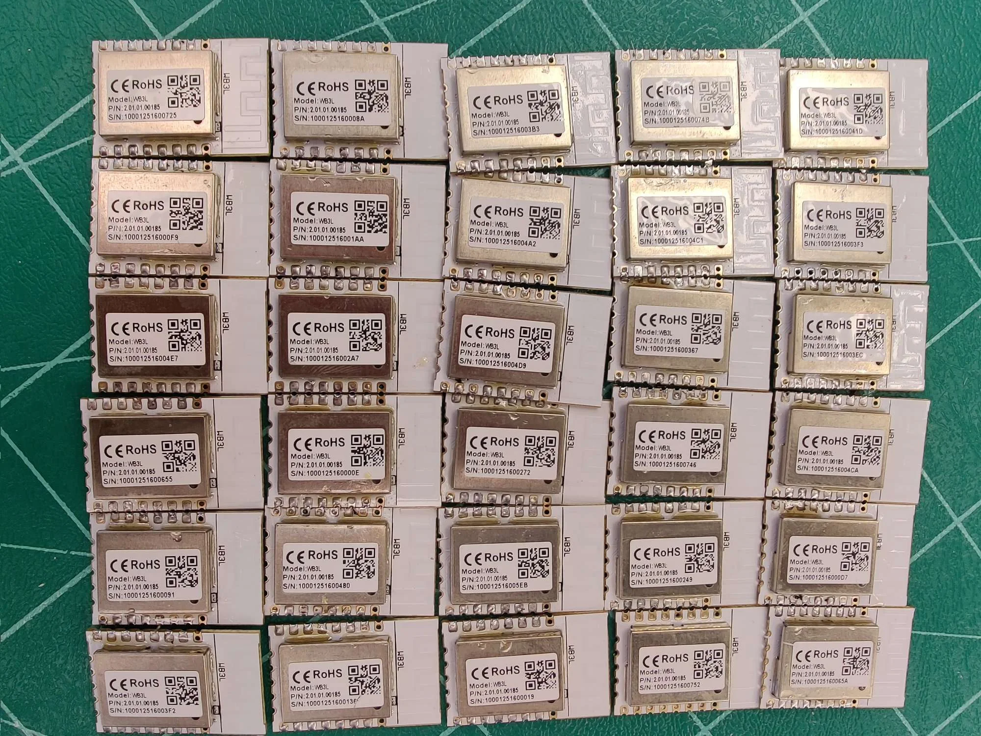

    I can see that there is some interest in movement with ESP32, but is it possible to find it in a finished Tuya product, and not buy it separately and solder it?
    But overall that's not what I meant. The topic that I had in mind had photos of several / a dozen ESP12F modules attached and its author showed that he is massively desoldering WB3S (probably this one) and in its place he gives ESP12F.
    AHA, I have this topic I wrote about.
    It was this:
    https://www.reddit.com/r/esp8266/comments/l9i...t_moment_when_you_realize_the_30_tuya_lights/
    this user "sculpted" 28 (sic!) lamps to replace their WB3L modules with ESP8266 to upload Tasmota ... and he could wait a year and would have OpenBK from me ready to go without replacing the chips.

    I did quick makeover of the html pages for OpenBK7321T_App. I added 1,474 bytes worth of CSS. I have tested it with TYWB3S chip and it seems to run fine. I will add a pull request.

    Here are some samples. I have tested it with Buttons and dimmers. And Text only. Seems to look OK. You can test further and let me know. Also my Git Build seems to fail for one of the apps (OpenXR809). Not sure if I broke it because I did not change any code in that App. I submitted a pull request too.
    Garden Tuya CCWFIO232PK Double Relay - BK7231T - Programming Garden Tuya CCWFIO232PK Double Relay - BK7231T - Programming Garden Tuya CCWFIO232PK Double Relay - BK7231T - Programming Garden Tuya CCWFIO232PK Double Relay - BK7231T - Programming Garden Tuya CCWFIO232PK Double Relay - BK7231T - Programming

    It is blue because it is a link. I fixed it now. I also added the state of the buttons ;). I tested all pages and specially the Config Module and the Index Page. Happy to fix issues as they get reported from users.

    Today opened two more smart plugs of same Feit brand but one is old model and the other is new model.
    The old one uses same WB2S (BK7231T chip) module while new one uses CB2S module (BK7231N chip).
    PCB layout is completely redone on this new model.
    Garden Tuya CCWFIO232PK Double Relay - BK7231T - Programming Garden Tuya CCWFIO232PK Double Relay - BK7231T - Programming Garden Tuya CCWFIO232PK Double Relay - BK7231T - Programming Garden Tuya CCWFIO232PK Double Relay - BK7231T - Programming Garden Tuya CCWFIO232PK Double Relay - BK7231T - Programming Garden Tuya CCWFIO232PK Double Relay - BK7231T - Programming Garden Tuya CCWFIO232PK Double Relay - BK7231T - Programming Garden Tuya CCWFIO232PK Double Relay - BK7231T - Programming Garden Tuya CCWFIO232PK Double Relay - BK7231T - Programming
    The module is no longer on the daughter board which is a good thing to access TX and RX pins.
    I extracted complete 2 MB of flash dump from both models.
    The old model with WB2S module read flash succeeded without any problem.
    However the new model with CB2S module, read flash fails every time with CRC error with Python uartprogram tool.
