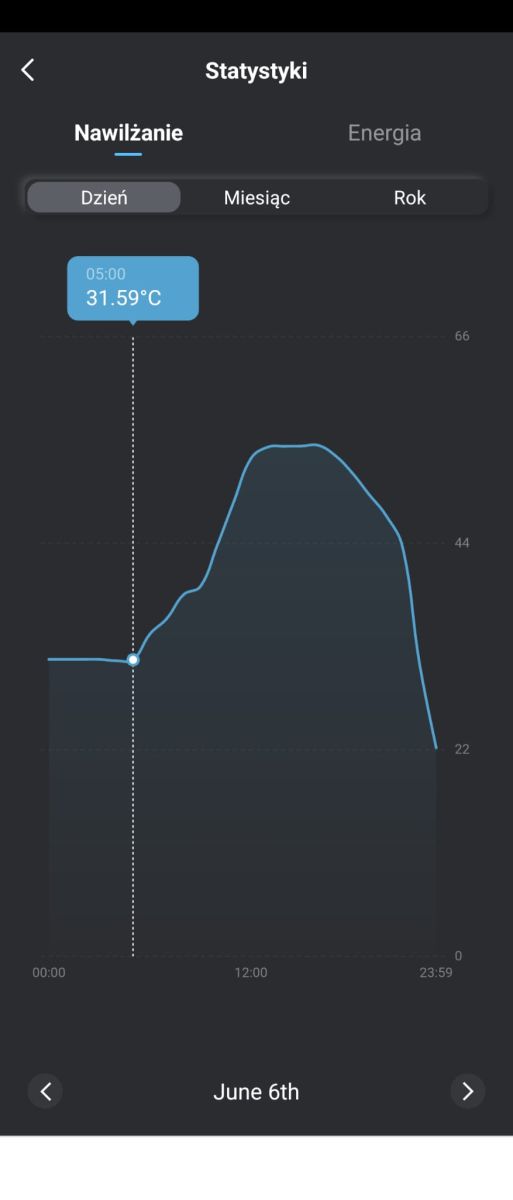

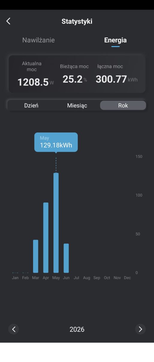

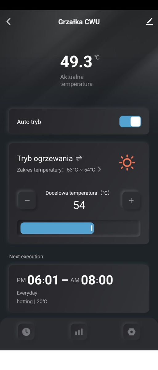

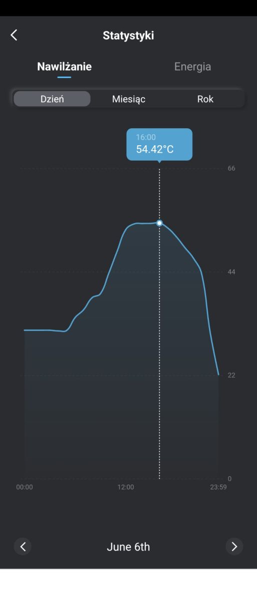

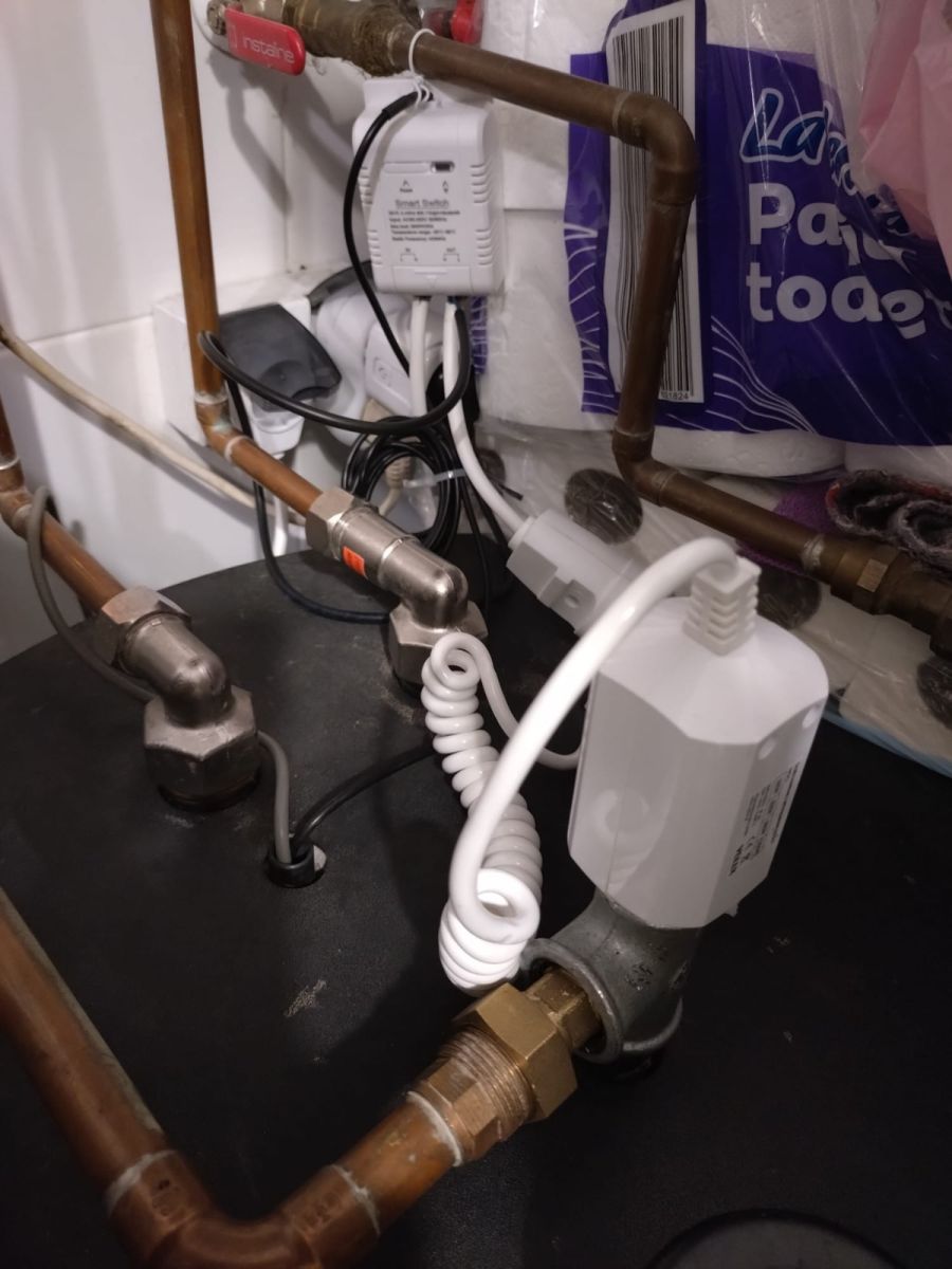

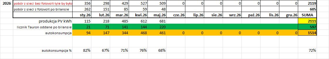

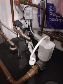

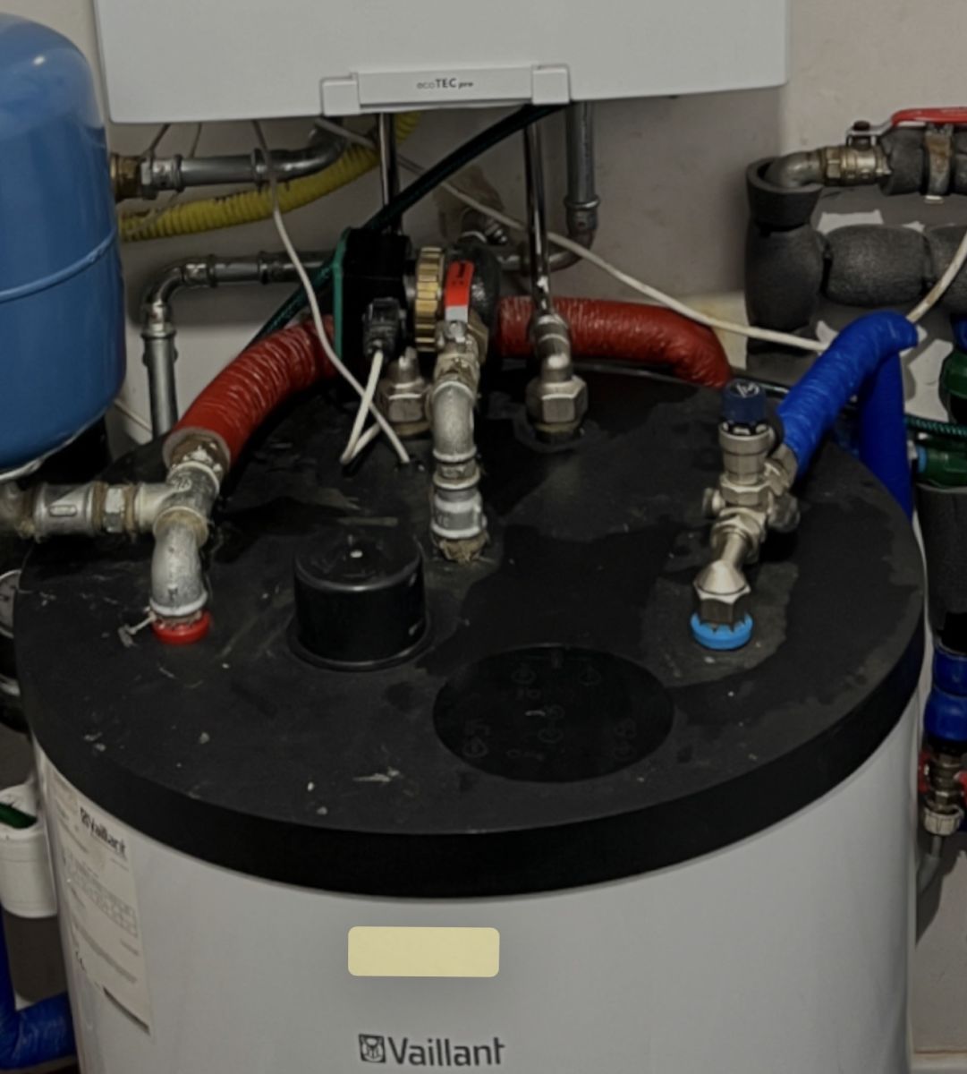

    I finally managed to sort out the problem with my failed attempt to screw in the drain plug, as the coil inside was getting in the way.
    In November, I fitted a 1000 W heater to the DHW tank along with a Smart Life thermostat, and the heater activates the circulation pump to allow the heater to cool down. It works well with this vertical reverse screw-in fitting in the return pipe of the water circuit to the tap
    Copper pipes and valves on a tank, with a white Smart Plug controller and a coiled white cable
    [url=https://obrazki.elektroda.pl/5816275600_1781069481.png]Installation of an electric heater in the Vaillant vih r 150/6 B storage tank
    [/url] App screenshot of energy statistics with a monthly bar chart for the year 2026
    App screenshot “Grzałka CWU” showing 49.3°C current temp, 54°C target, and schedule 06:01–08:00

    How does the circulation pump connect to this pipe? How long will it take for a 1000 W pump to heat the water?

    >>21918465

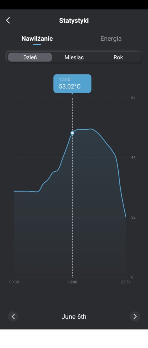

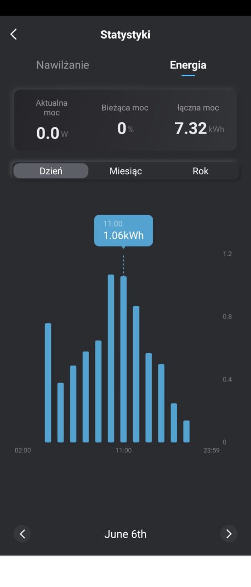

    Installation of an electric heater in the Vaillant vih r 150/6 B storage tank Installation of an electric heater in the Vaillant vih r 150/6 B storage tank
    >>21918472 From 9:00 to 12:00, when the sun is shining, it reaches over 48°C.

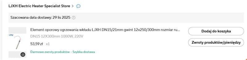

    I ordered one of these, but the white casing with the cable is from a faulty heater element, which broke when I was screwing it into the drain plug.

    The fact that it is screwed in at the hot water outlet does not block the flow?

    >>21918489 This is screwed into the return from the circuit - the heater at 1.5cm diameter, and the return pipe at 3/4 inch in the boiler.

  • #102 21918503
    przemyslawbugaj
    Posts: 12
    Also a good solution, I don't donate Danube electricity, but I do have PV and storage, so I reheat with air conditioning during these periods and an infrared cooker, but I'll take that into consideration too.
    In my case with connecting a heater like that from the top it should go smoothly.
    Vaillant cylinder with a black top cover and connected pipes with red and blue insulation

    I’ve got a Vaillant boiler too, and on the room controller I’ve set the DHW temperature to 39°C, and in the time schedules, water heating runs from 5.50 to 6.00, and then from 13.00 to 22.00, so that there’s hot water even if there’s no sun.
    However, the electric heater heats the water to 55°C when there’s power from the PV system, ensuring there’s a supply of hot water until the morning. Yesterday in Kraków, I was even heating with the PV system until 17:30.
    I run the circulation pump from 6.00 to 22.00 for just 3 minutes, as that’s how long it takes to push the hot water to the return connection on the DHW tank, i.e. towards the heater.
