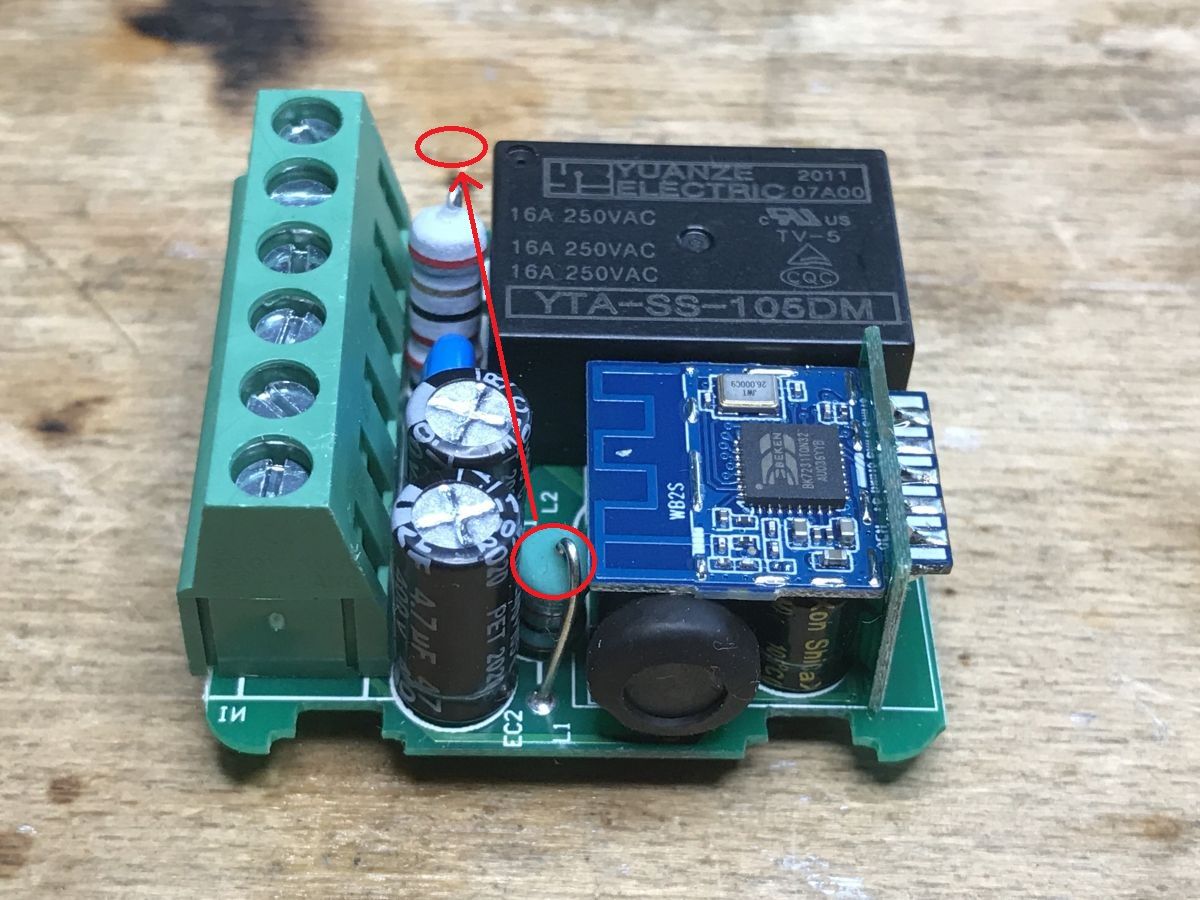

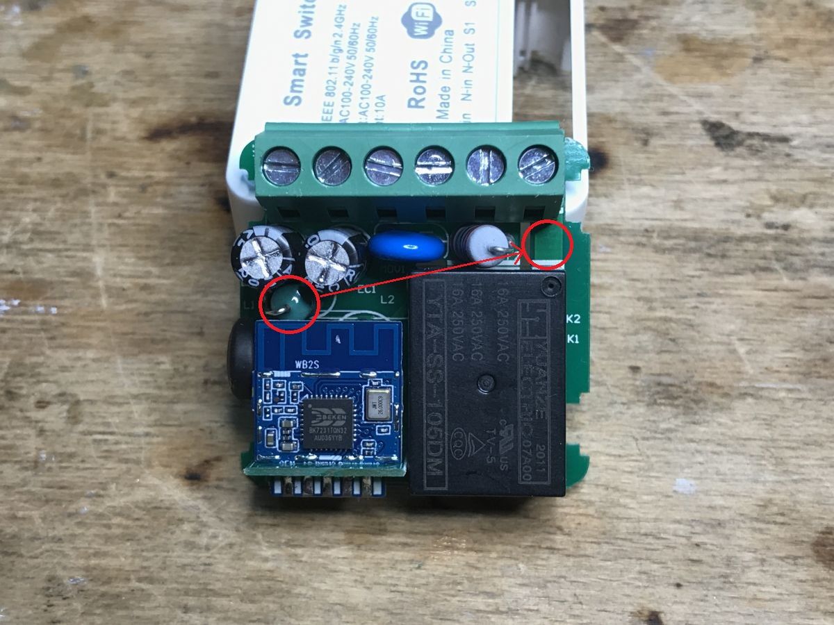

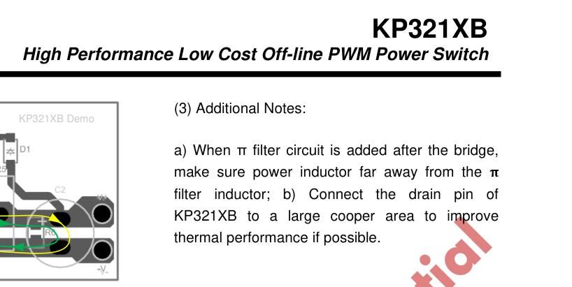

    #10 21049673
    omniron
    Posts: 114
    OMG just reread this article.
    No wonder these fail rather quickly, the Pi-filter inductor is RIGHT NEXT to the switch inductor!
    I've never seen them THIS close.
    Every other designer tries to keep these two inductors as far as possible, it's even mentioned in some of those switch-IC datasheets.
    Sometimes they "hide" the Pi-filter inductor behind the two capacitors, or put it on the other side of PCB.
    But here?
    And that switch inductor is also right next to the antenna!!
    Wow.
    The Pi-filter inductor filters 50/60Hz, so it is not as critical as the switch inductor which needs to be as close as possible to the switch IC.
    I would move it (with shrink tube) far away, behind the last resistor in picture, between relay and screw header.

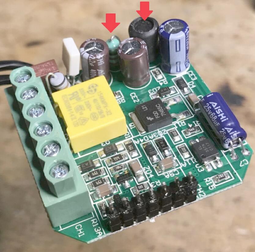

    #11 21051090
    omniron
    Posts: 114
    Another of these (too) small units with inductors way too close.
    Eventhough they are a few mm apart, they are collinear so their inductivity influences each other quite much.
    OP's inductors were 90 degrees tilted, so only the (still significant due to closeness) angle of the windings would interfere.
    This is just bad design which could be avoided by caring more for the placement of these two coils.
