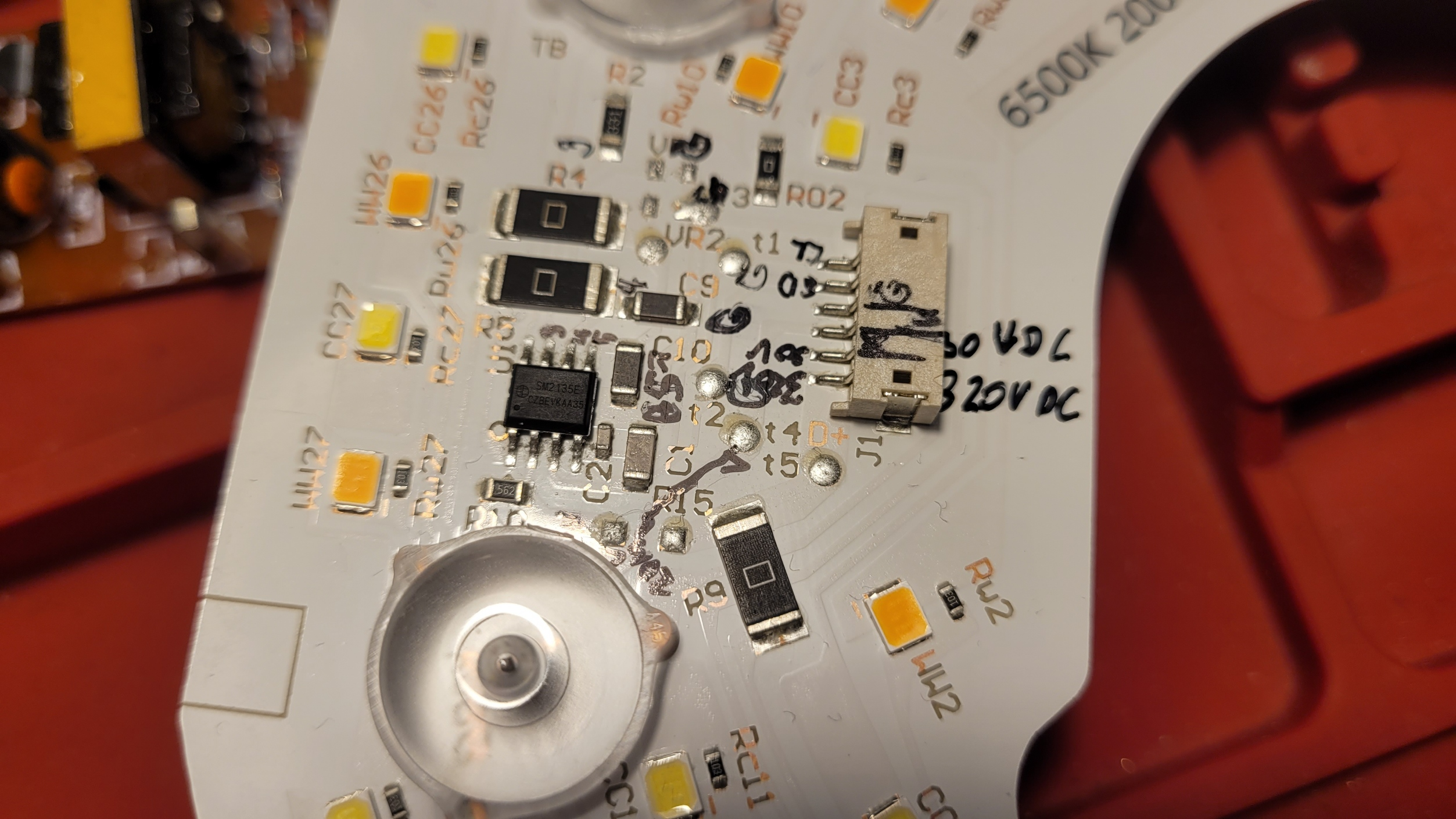

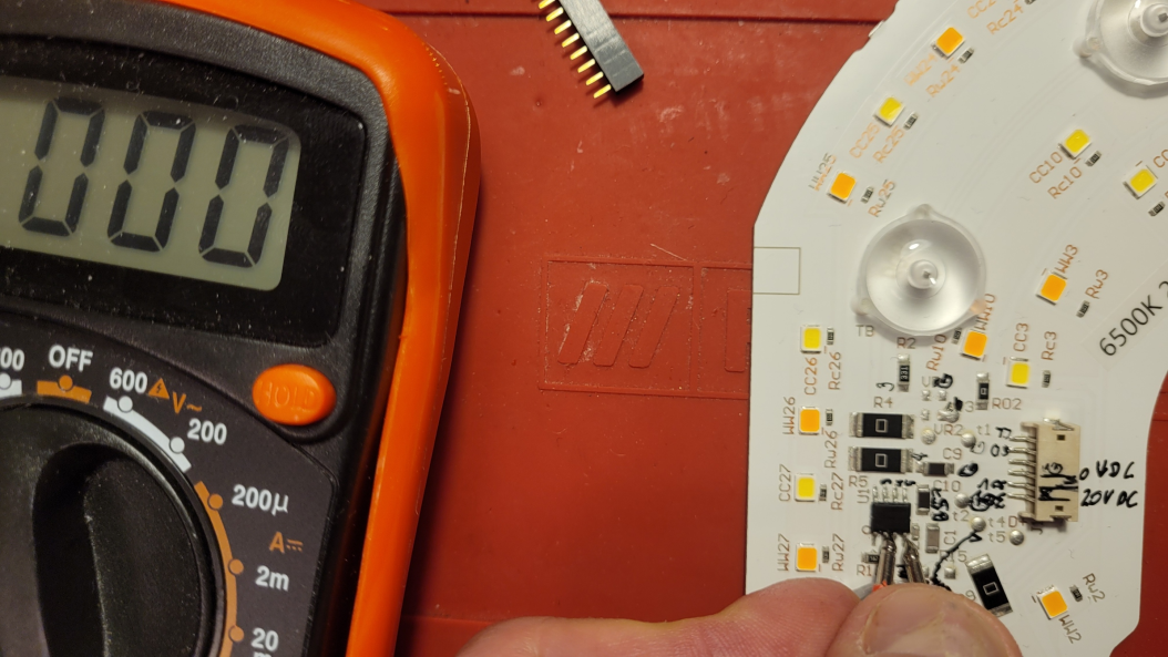

    Is it normal, to have continuity between 2 pins (i hope those are data and clock) on image bellow or did I break another lidl light? :)

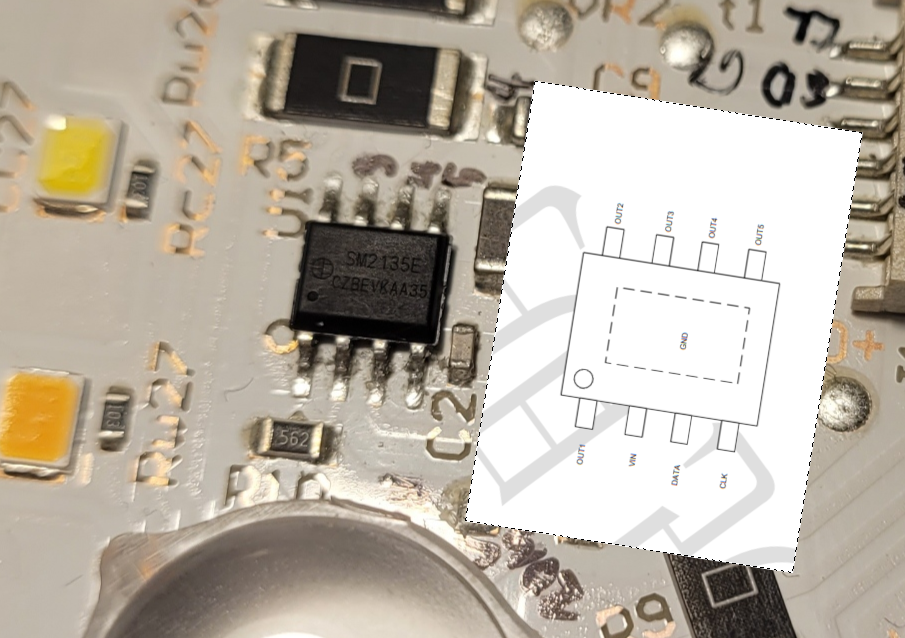

    What is the marking of U1 and where is the first pin?
  • #33 20519721
    evlo2
    Posts: 35
    1st pin, as far as I understand, is in the bottom left corner
    WiFi LED RGBCW WOJ14415 with SM2135 - I2C communication protocol, interior
  • #34 20519757
    Posts: 14781
    Rate: 12920
    See modified photo:
    I don't think there should be a 0 resistance between DATA and CLK.
