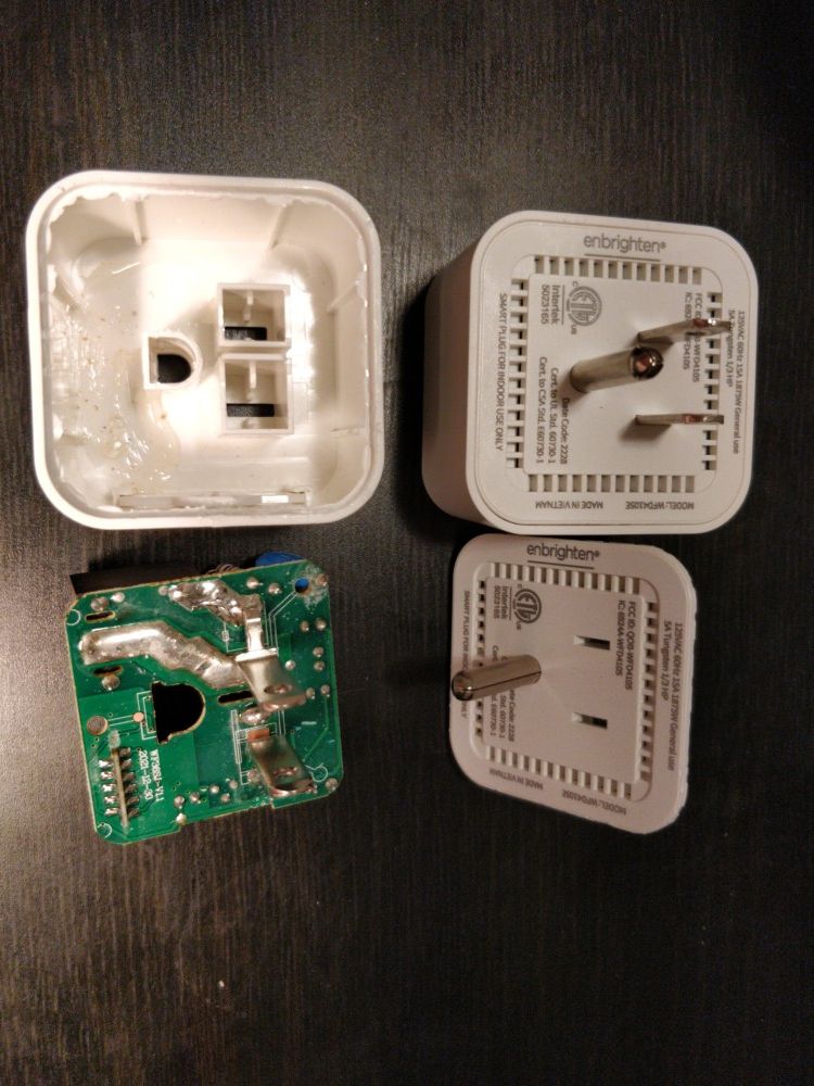

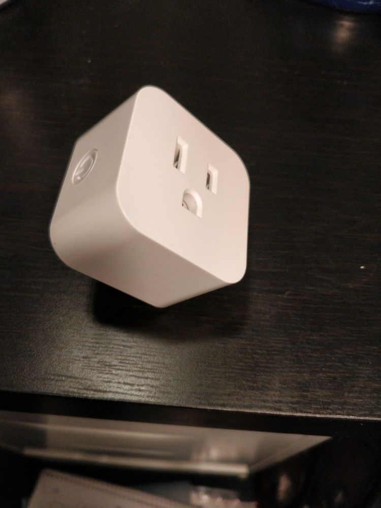

    It just has one button with a built-in LED.

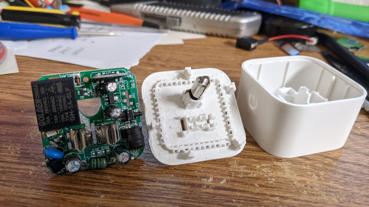

    The back plate is glued and can be separated by inserting a spudger, start from opposite edge where the the button is located.
    Enbrighten WFD4103 WiFi Switch Teardown - BK7231T WB2S module

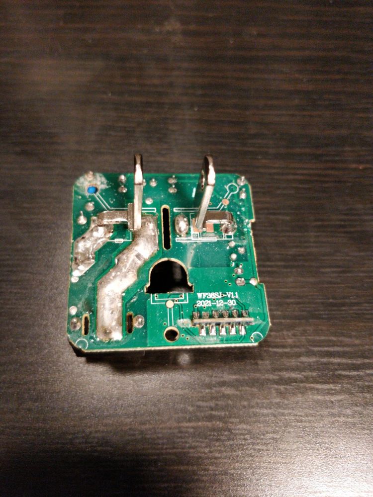

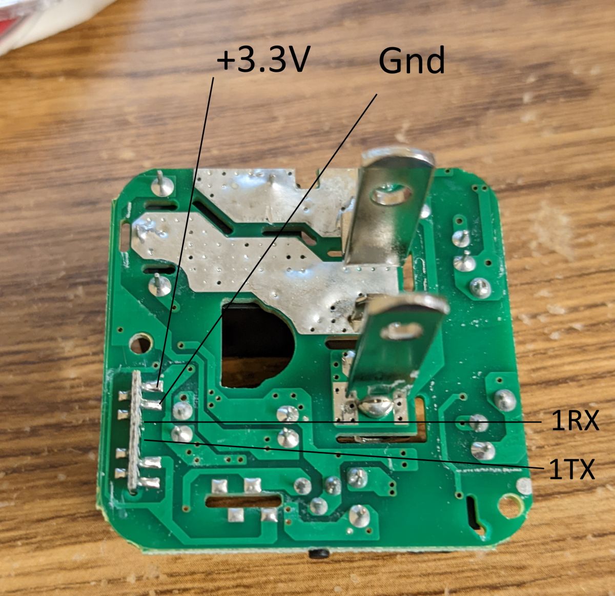

    The power pins are attached to the board but the ground pin comes out completely. This makes accessing the bottom of the chip very easy.
    Enbrighten WFD4103 WiFi Switch Teardown - BK7231T WB2S module Enbrighten WFD4103 WiFi Switch Teardown - BK7231T WB2S module

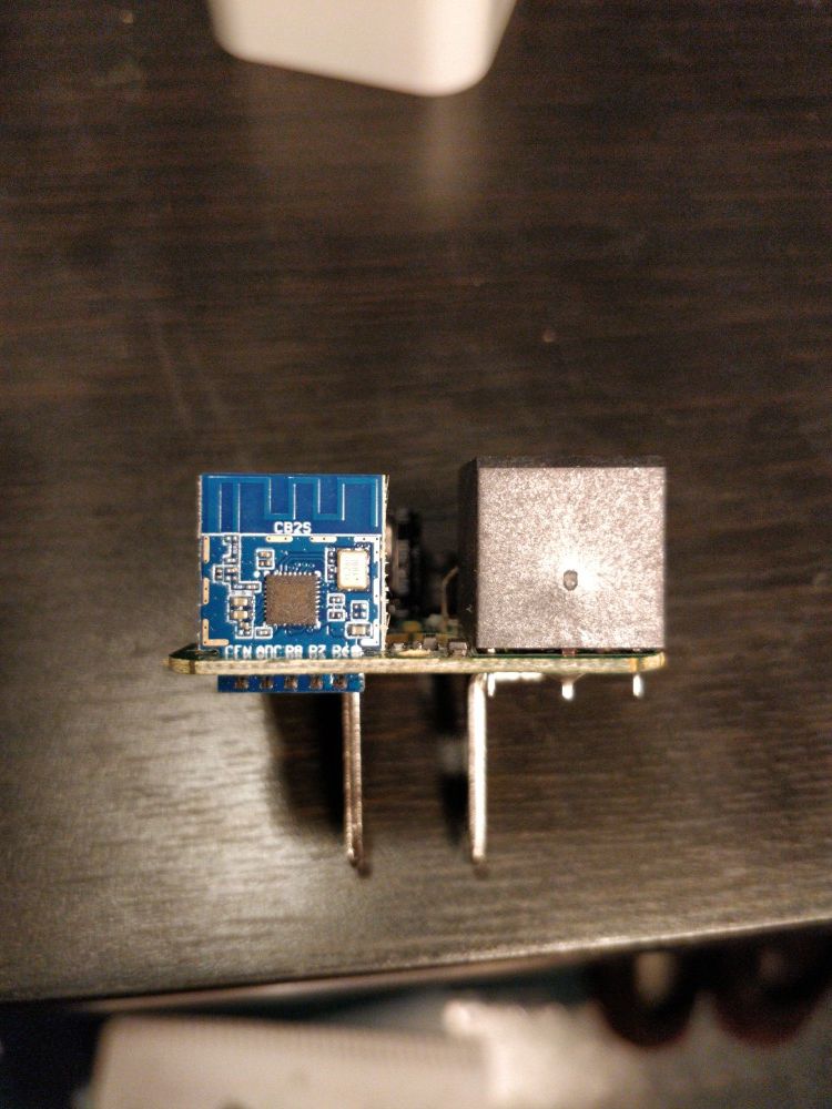

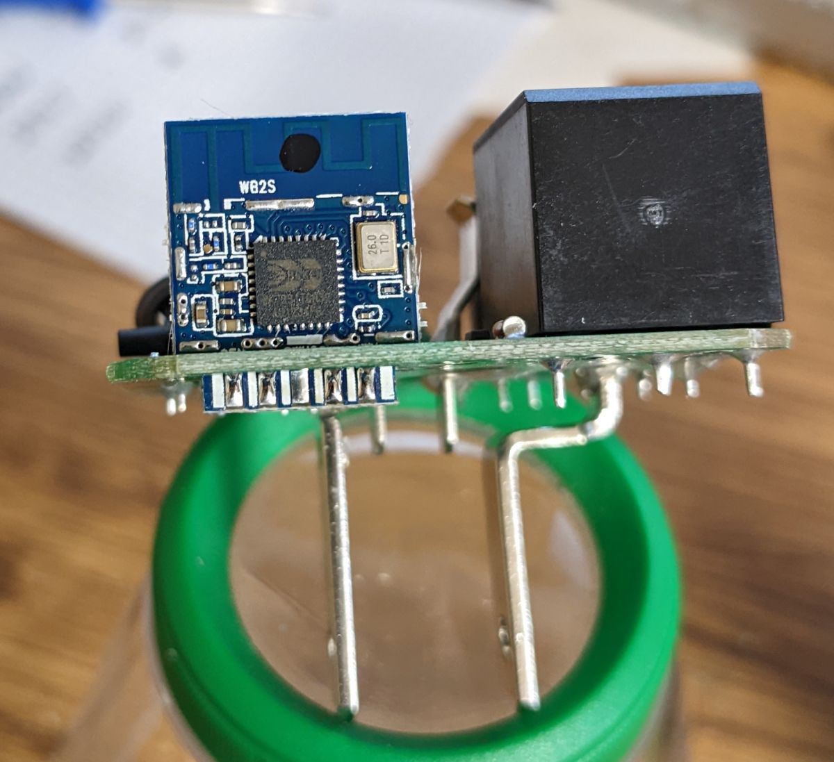

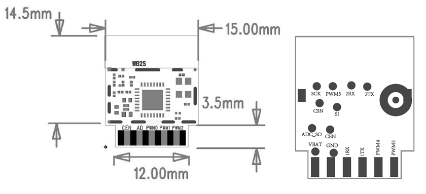

    It uses a BK7231T WB2S module.
    And can be flashed by using these 4 pins.

    For initial flashing use the UA (UART) version of the firmware for BK7231T.
    I used uartprogram for flashing.
    python uartprogram -d com4 -w OpenBK7231T_UA_1.12.16.bin
    To configure the module use:
    * P7 = LED_n, channel=1
    * P24 = Rel, channel=1
    * P26 = Btn, channel=1

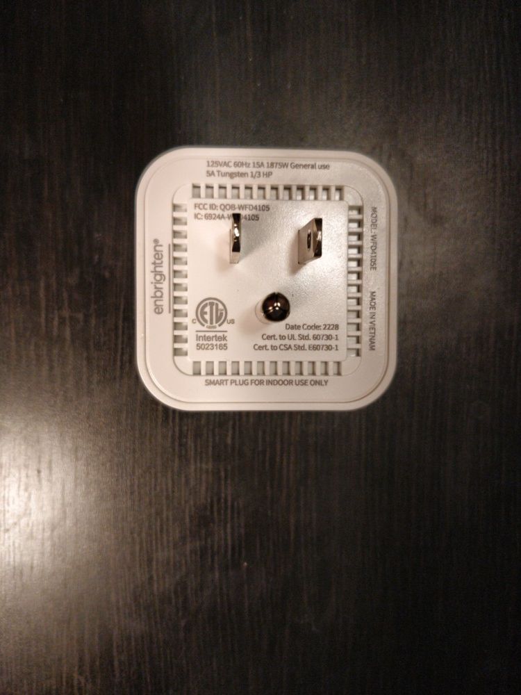

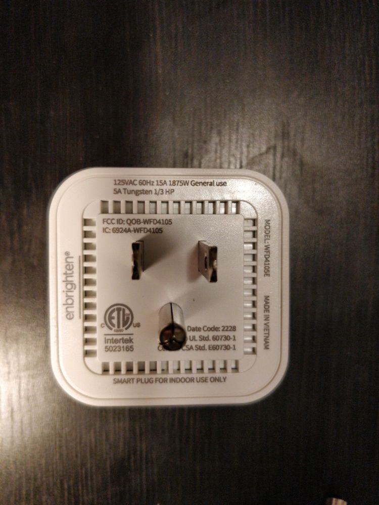

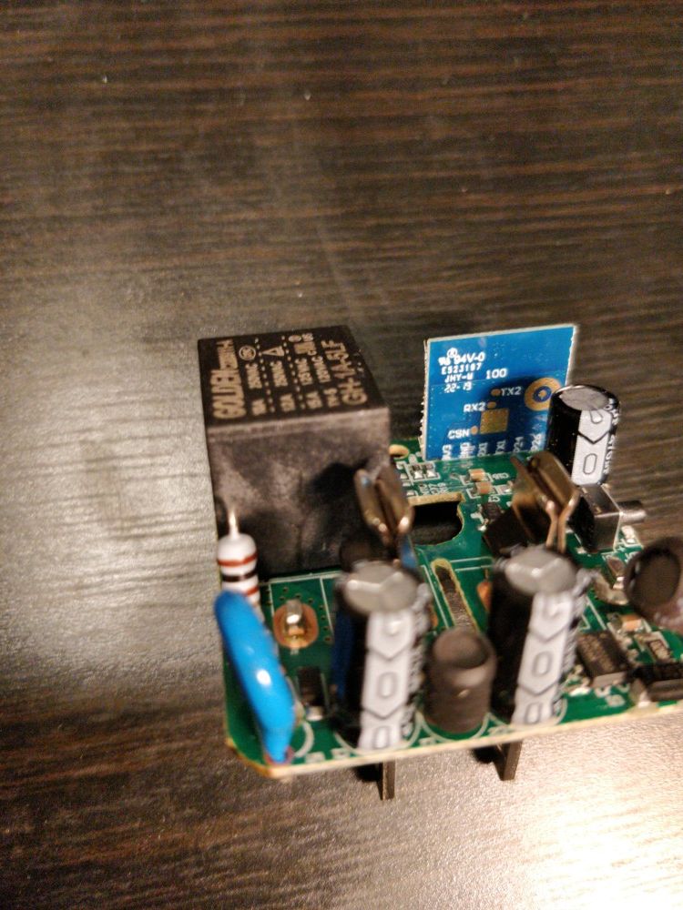

    These pin assignments also work for the Jasco Enbrighten WFD4105E which is CB2S/BK7231N-based but otherwise seems very similar internally.

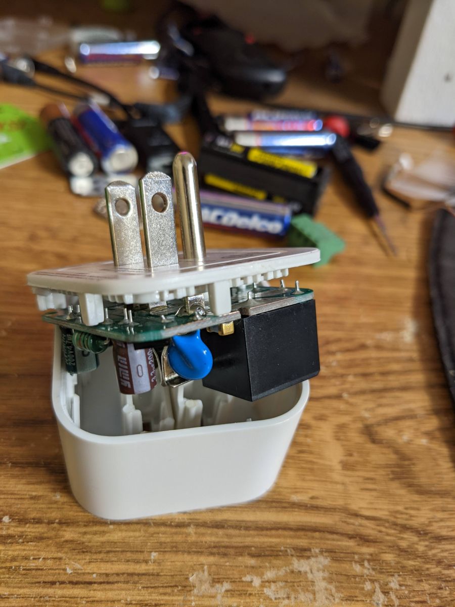

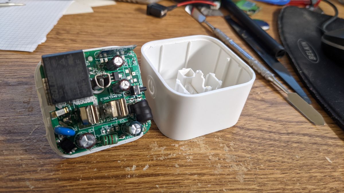

  • Photos of the WFD4105E switch teardown
    #6 20473496
    interfect
    Level 4  
    Here are my photos of the WFD4105E:
    Enbrighten WFD4103 WiFi Switch Teardown - BK7231T WB2S module Enbrighten WFD4103 WiFi Switch Teardown - BK7231T WB2S module Enbrighten WFD4103 WiFi Switch Teardown - BK7231T WB2S module Enbrighten WFD4103 WiFi Switch Teardown - BK7231T WB2S module Enbrighten WFD4103 WiFi Switch Teardown - BK7231T WB2S module Enbrighten WFD4103 WiFi Switch Teardown - BK7231T WB2S module Enbrighten WFD4103 WiFi Switch Teardown - BK7231T WB2S module
  • #7 20475447
    Posts: 14797
    Rate: 12954
    Thank you for posting. The device has been added to our online database. If you have any other devices, please also consider submitting teardowns/templates.
