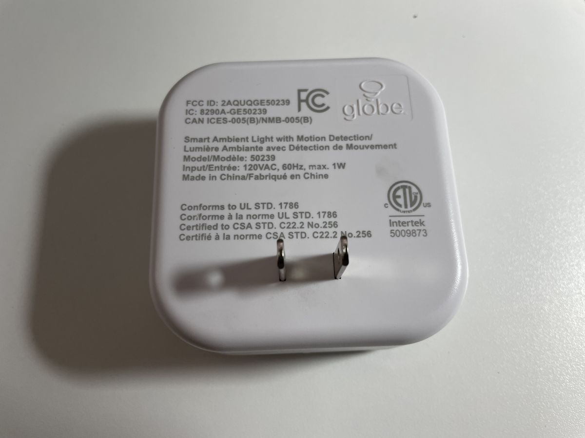

  • Globe Electric Smart Ambient Light Wifi, SKU 50239, is a plug-in RGBWW LED night light with motion sensing built around a WB3S chip.

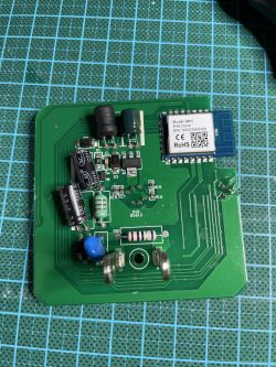

  • The unit was flashed with OpenBeken using hid_download_py and a 3D-printed jig that holds pogo pins directly on the chip.
  • The pin map assigns warm white to Pin 6, cold white to Pin 8, red to Pin 9, green to Pin 24, blue to Pin 26, with the button on Pin 1 and PIR on Pin 14.
  • The remaining open question is the best way to upload firmware dumps and submit new configs.
  • Posting a new device teardown and OpenBeken flash. Not sure the best way to upload firmware dumps and/or submit new configs...
    I've also posted additional details (including ESPHome config) to the HomeAssistant forums here.
    Device name: Globe Electric Smart Ambient Light Wifi
    SKU: Globe 50239
    Manufacturer URL: https://globe-electric.com/en/product/smart-ambient-night-light-with-motion-detection
    Description: Plug-in RGBWW LED + Motion Sensor
    Chip: WB3S
    Summary:
    Flashed using: hid_download_py; used a 3d printed jig to hold pogo pins against the chip directly.
    Config:
    Light PWMs…
    * Pin 6 = Warm White (channel 5)
    * Pin 8 = Cold White (channel 4)
    * Pin 9 = Red (channel 1)
    * Pin 24 = Green (channel 2)
    * Pin 26 = Blue (channel 3)
    Button
    * Pin 1
    PIR
    * Pin 14

    This is the way! Thank you, @Matt_J
    The next two steps are:
    1. add an entry to online device templates database: (submit a pull request)
    https://github.com/OpenBekenIOT/webapp/blob/gh-pages/devices.json
    Globe - Wifi Night Light with Motion - WB3S
    2. send full 2MB original firmware dump to tuya-cloudcutter:
    https://github.com/tuya-cloudcutter/tuya-cloudcutter/issues
