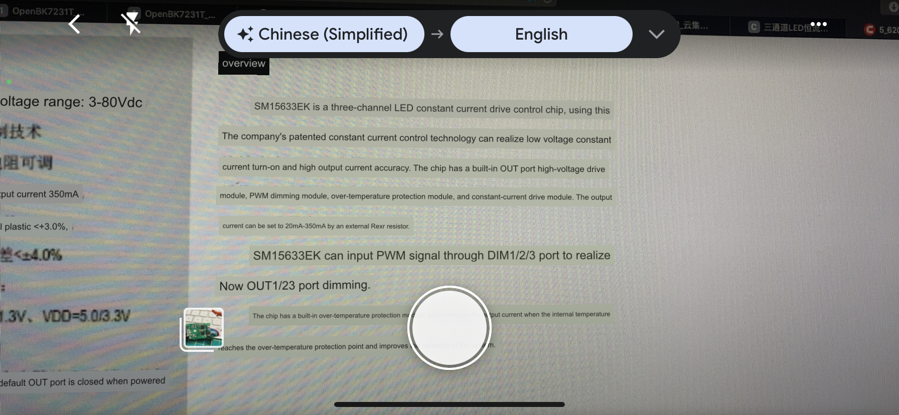

    And in tracing the circuit, identified that it is using a pair of SM15633EK to drive the LED's. After some intense googling, found some details here on the chip - https://www.dianyuan.com/bbs/2511027.html

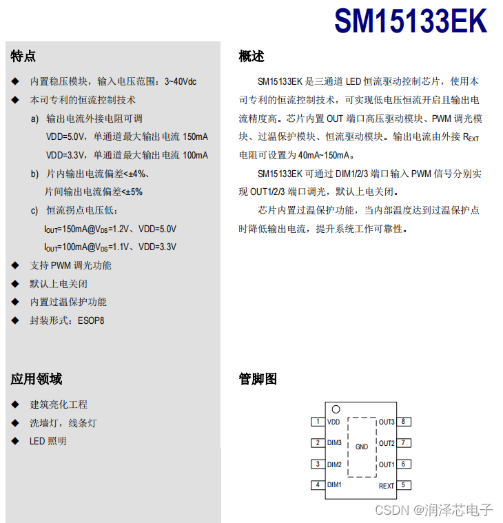

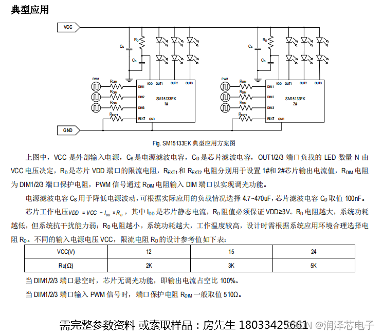

    can anyone find the spec sheet for SM15633EK, in any language?
    can anyone advise the correct PWM frequency?
  • Tuya PWM frequency and SM15133 chip lead found
    #5 21100195
    Posts: 14827
    Rate: 13015

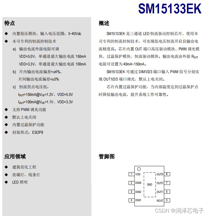

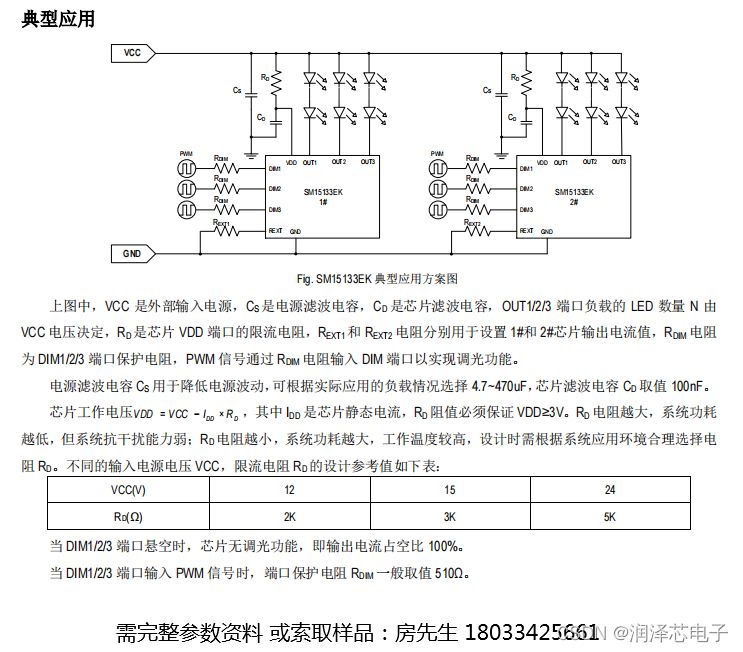

    Why do you need SM15633 datasheet? The PWM frequency used by Tuya is as far as I know either 1000Hz or 600Hz. In OBK, you can configure any supported PWM frequency by hardware.
    I'm searching, found this so far, but slightly different chip:
    Circuit diagram with Chinese description containing electronic components and their connections.
    Data sheet for the SM15133EK chip with a description of functions and pin diagram.
    Added after 4 [minutes]:
    strange, names seems to be 恒流LED驱动芯片SM15133EK SM15133EH 明微电子_sm15633-CSDN博客

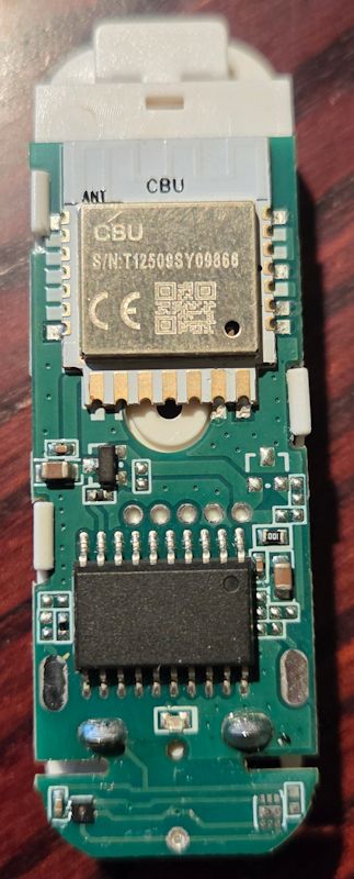

    Got another batch of these and am busy flashing them. A couple of notes for myself if I do them again.
    When flashing with a Mac mini M4, do not use a USB Hub, but a straight cable.
    Used a cp2102 ttl adapter.
    Also the template is wrong
