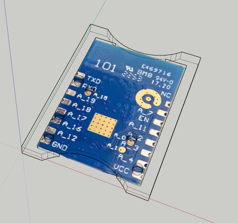

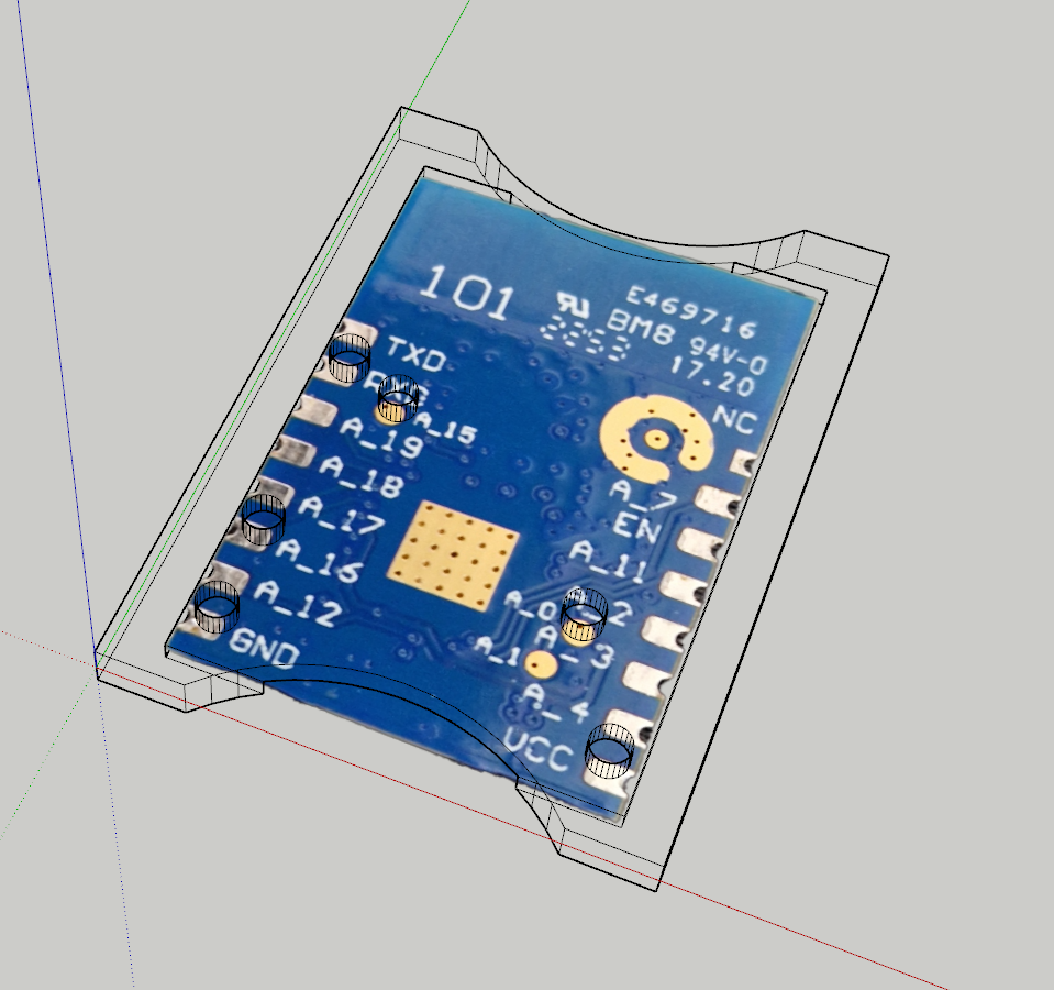

    Recently, however, @DeDaMrAz has been reworking quite a few WBR3-based devices, hence the need to simplify the process. The idea was to make an adapter that allows an already soldered WBR3 module to be programmed without additional soldering. The module still needs to be removed from the board, but the rest of the process is greatly simplified. We started by dimensioning the board:
    3D view of the WBR3 module in a transparent adapter with labeled signal pads.

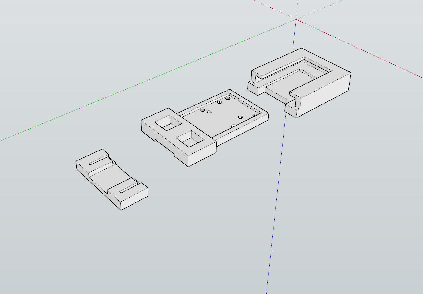

    Then the adapter was modelled - several versions were tested, below is the final one:
    3D view of three-part adapter for programming WBR3 Wi-Fi module
    The holes are for the BOOT and RESET buttons.

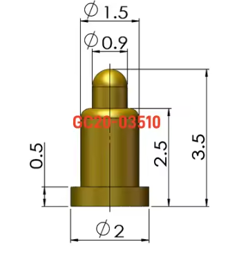

    However, you still need to take care of the contact with the pads. The pogo pins are used for this:
    Set of 5 gold-plated pogo pins, 9 mm high, on millimeter grid background
    These pins come in different versions, but all have a built-in spring - this ensures good contact with the pad. We chose the 3.5mm high version:
    GC20-03510 pogo pin with dimensions: 3.5 mm height, 0.9 mm tip diameter

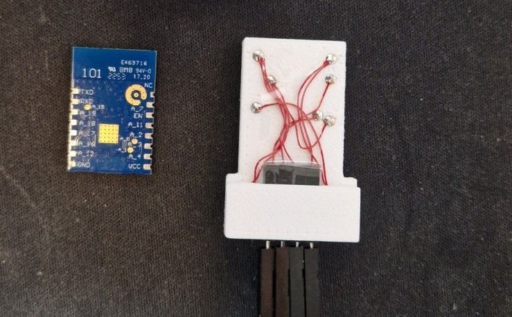

    All this has been suitably connected inside the adapter:
    WBR3 module next to a programmer adapter with red wires and pogo pins in a white housing

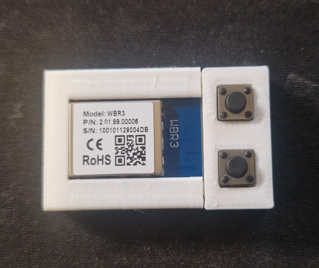

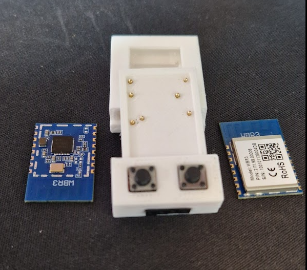

    The completed adapter and two WBR3 modules (one with the screen removed):
    WBR3 module and white adapter with pogo pins and two buttons

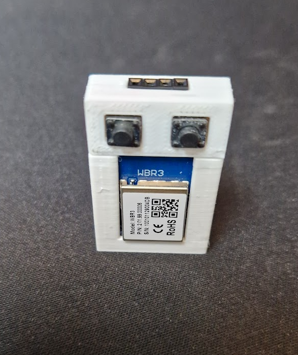

    Adapter together with programmable module:
    Programming adapter for WBR3 module with BOOT and RESET buttons
    WBR3 Wi-Fi module in a white adapter with BOOT and RESET buttons

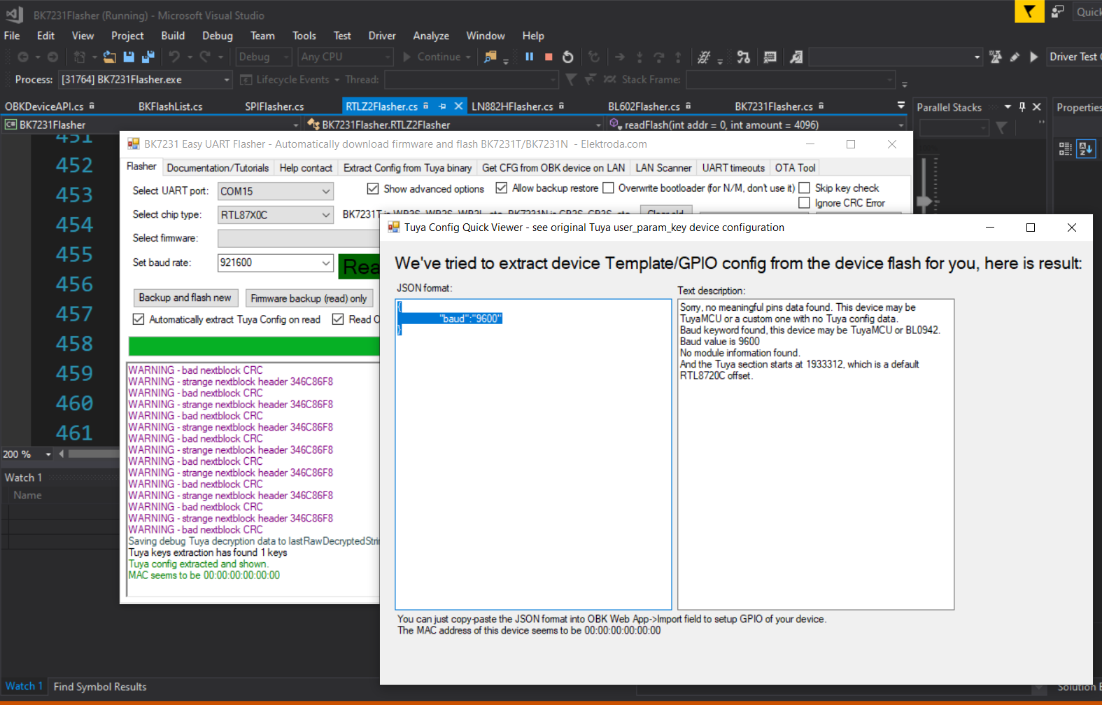

    We used our flasher to test the adapter:
    It correctly reads and programs the RTL87X0C:
    BK7231GUIFlashTool interface with warning messages and Tuya config result window
    That's basically it - from now on we can conveniently upload our open source software .
