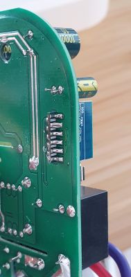

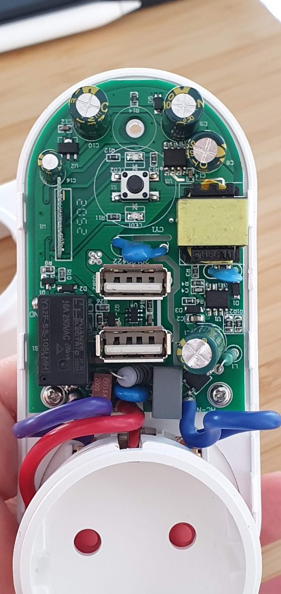

BSD31 plug with dual USB charging ports BK7231 teardown
Nanganator 2838 4
  • BSD31 16A Euro plug with dual USB charging ports gets a full teardown, with other regions described as similar.
  • Removing the rear sticker and one screw lets the housing split, exposing a BK7231T board, daughterboard solder points, and rear circuitry.
  • The teardown identifies a BK7231T-based design and confirms the plug is rated for 16A.
  • After dumping stock firmware, tuya-cloudcutter enabled OpenBeken OTA flashing with no disassembly or soldering, and the pinout works for the button, LED, and both relays.
  • Teardown images of the 16A Euro plug BSD31. Other regions are simlar.
    Remove rear sticker and single screw
    Separate at button end
    Insert opener
    Slide opener down side edge to separate clips. Repeat on opposite side and lift off top housing
    Internals
    BK7231T Front
    BK7231T Rear
    Daughterboard solder points
    Circuitboard rear

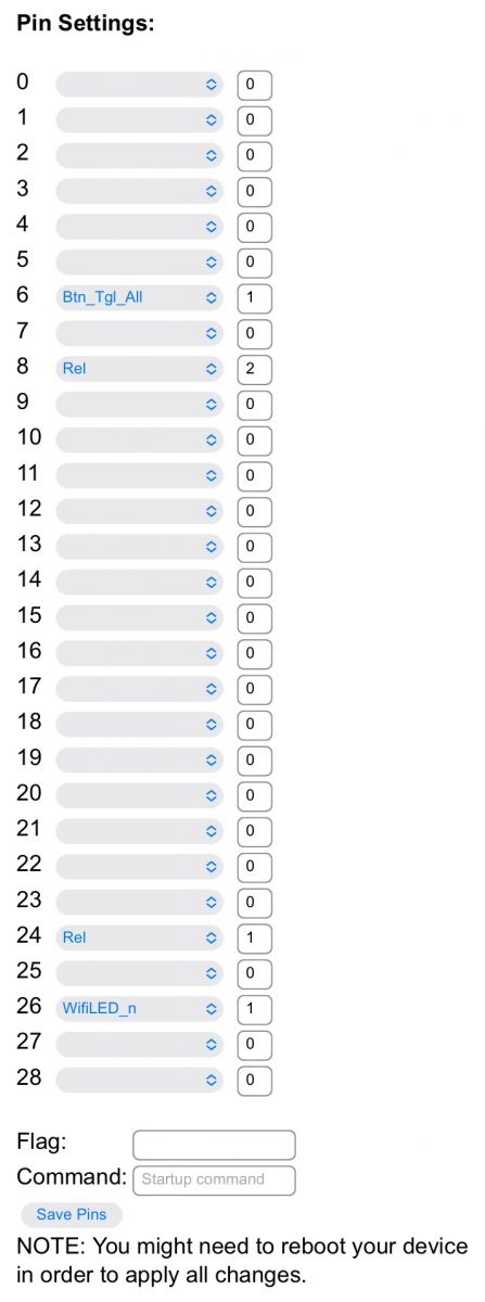

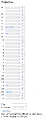

    Finally dumped the stock firmware and provided for our friends over at tuya-cloudcutter. Can confirm, using tuya-cloudcutter, device can now be flashed with OpenBeken OTA with no disassembly or soldering required.
    Perfect working pinout including button, LED and both relays:

    Thank you, have you also checked which BK7231 IOs are used to toggle relay and the USB? What is the real USB current capability?
