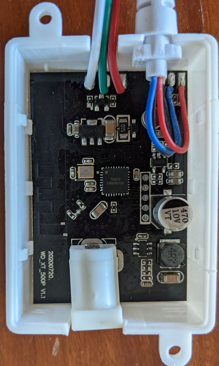

  • W600 identified in WX500P LED controller
    #38 21721681
    Posts: 5236
    Help: 450
    Rate: 920
    W600 also seen with chip marking as "T6605"
    Image and boot log from user Discord post for a WX500P LED strip controller
    Circuit board with microchip T6605 and colored wires in white plastic housing
    20200720.
    WD_XT_500P V1.1
