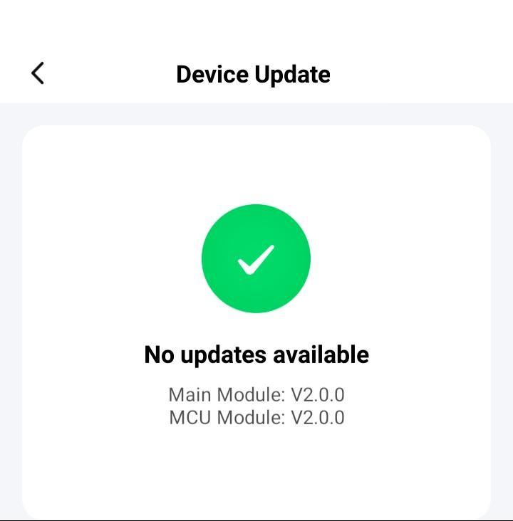

    So, it's not a TuyaMCU but you still got "MCU version" string in the app? Hm, interesting.

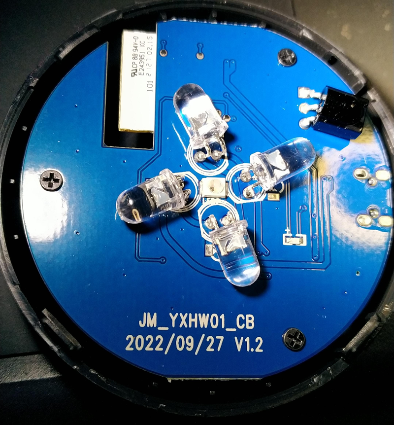

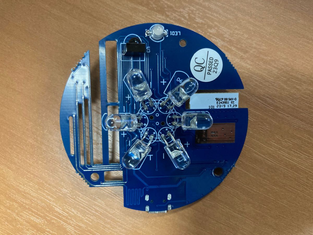

    Aubess WiFi Smart IR Controller

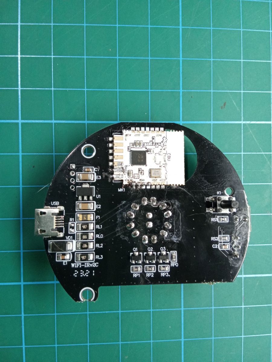

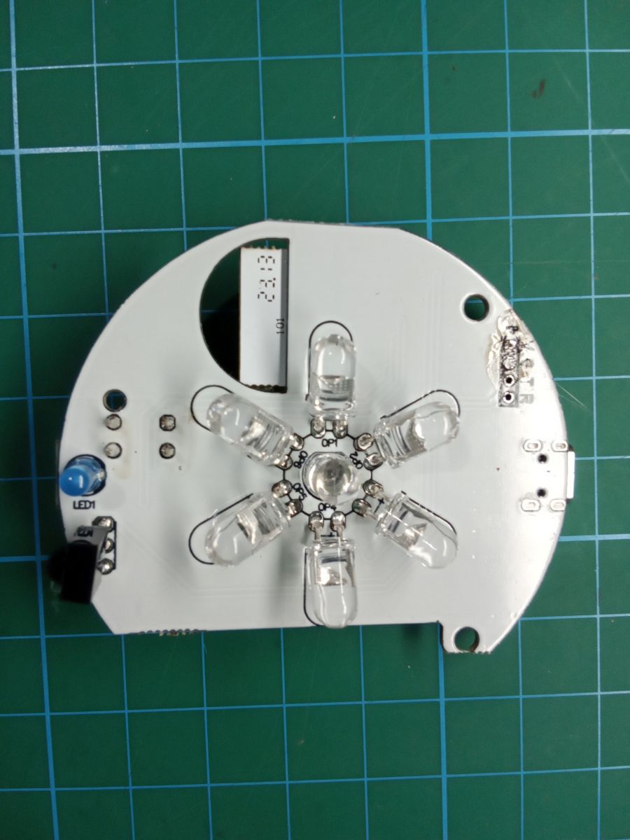

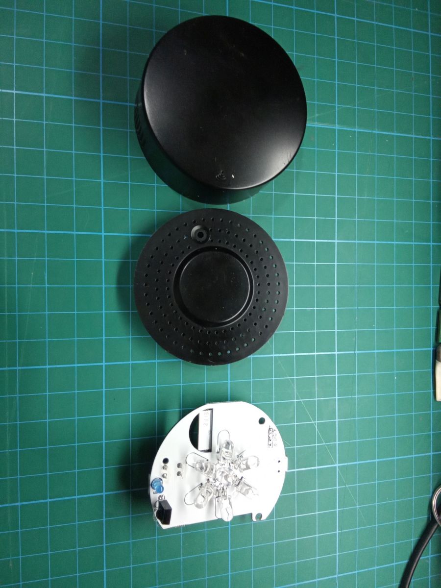

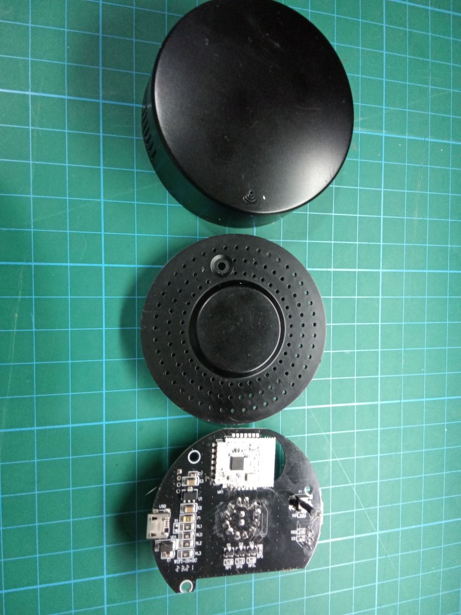

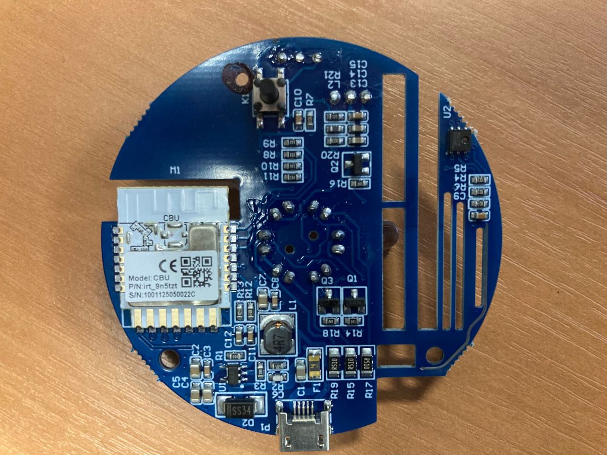

    Here are the pics of the hardware (Huggwic Tuya WiFi IR Remote Control Smart Home For TV Air Condition Universal Infrared Controller Work With Alexa Google Home):
    I have physically verified the PIN connections:
    PIN PIN Setting
    7 IRSend
    8 IRRecv
    24 LED_n

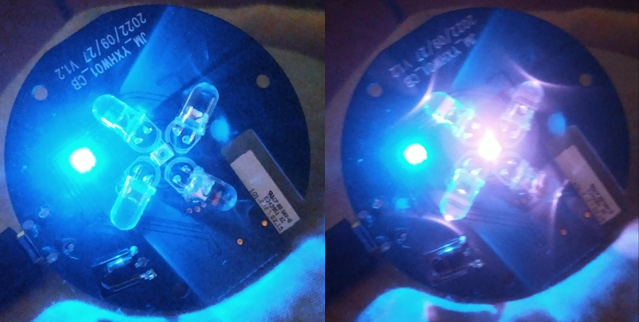

    Also I have checked Pin 7 output using GPIO Finder. The output works fine
    Picture taken with a Mobile Phone Camera:
    So the hardware works fine. Infact I was able to fully configure a remote of a Panasonic Fan using Tuya App. So hardwarewise everything is fine.
    OpenBK is not helping me here.

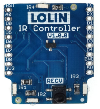

    I was looking for a ESP8266 based module which had a somewhat comparable pin arrangement for CBU module and could not find any.
    This opens up the possibility of using the device that I already have. It has a ASM1117 based LDO chip, hopefully can give out more than 500mA during boot to support ESP32.

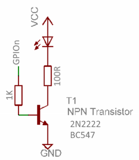

    tried building one myself, but i can't quite get irsend working
    Need a Transsistor driver circuit for the IR LED. The IR LED needs to be 940nm type (there is also a 850nm type which has a reddish glow when powered).

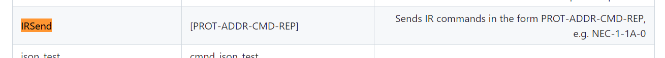

    Hello, have you tried the IRSend format recommended by documentation? The one with dashes?
    Screenshot from documentation showing IRSend format for IR commands.
  • #43 20684286
    ployd915
    yes from this post https://www.elektroda.com/rtvforum/topic3933390.html#20551713
    Custom command:
    IRSEND Sony-1-15-1
    log:
    Info:IR:Delay 44ms
    Info:IR:Delay 100ms
    Info:IR:IR send Sony-1-15-1 protocol 21 addr 0x1 cmd 0x15 repeats 1
    OK
    same result as IRSend Sony 0x1 0x15 1, IR light flashes but TV does not power ON

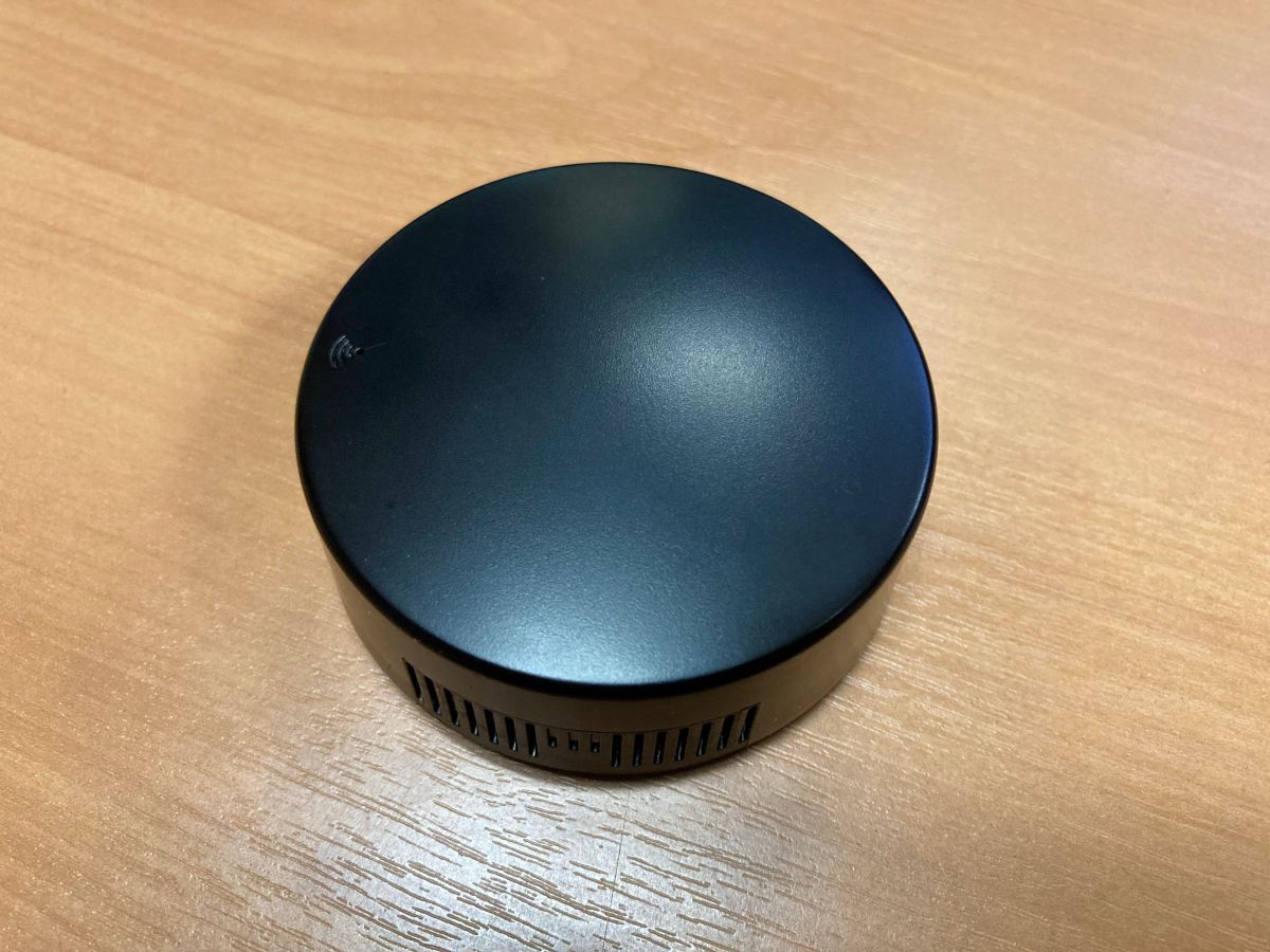

  • Questions on cracking and integrating a Tuya IR controller
    #44 20870090
    enricolazzerini
    Hi,
    I came here through an internet search by entering the wording smart ir CBU.
    Mr.'s device jkwim reminded me of mine I just purchased on Aliexpress and of which I am sending photos.
    It allows you to clone remote controls with Smart Life and Tuya, but on the TuyaIoT site there are no .json and consequent .yaml files that I could use with Tuya integration in Home Assistant.
    I was wondering how to crack the device.
    I have some rudiments with electronics, but I have no experience with all this and I've only been playing with Home Assistant for a month.
    I ask to know how to do it because you must always try to learn.
    1) how to put the CBU in a position to be cracked
    2) with which firmware
    3) how to integrate the cracked device into Home assistant
    4) how to find out the switching on and off sequences of a Hisense DJ25VE00G air conditioner
    (PS: I gave up on using the Hisense AEH-W4A1-xxxxxxx wifi directly with Home Assistant because it is unstable even with its own Hi-Smart Life APP)
    Image of Tuya Smart IR Remote Control with USB charger and app displayed on a phone. Photo of a black device with a label AI Smart Remote Control, model LQ-Y06, featuring a QR code for app download. LQ-Y/W06 circuit board with electronic components and flame logo. Image of a round PCB with various electronic components including a Wi-Fi module and connectors.

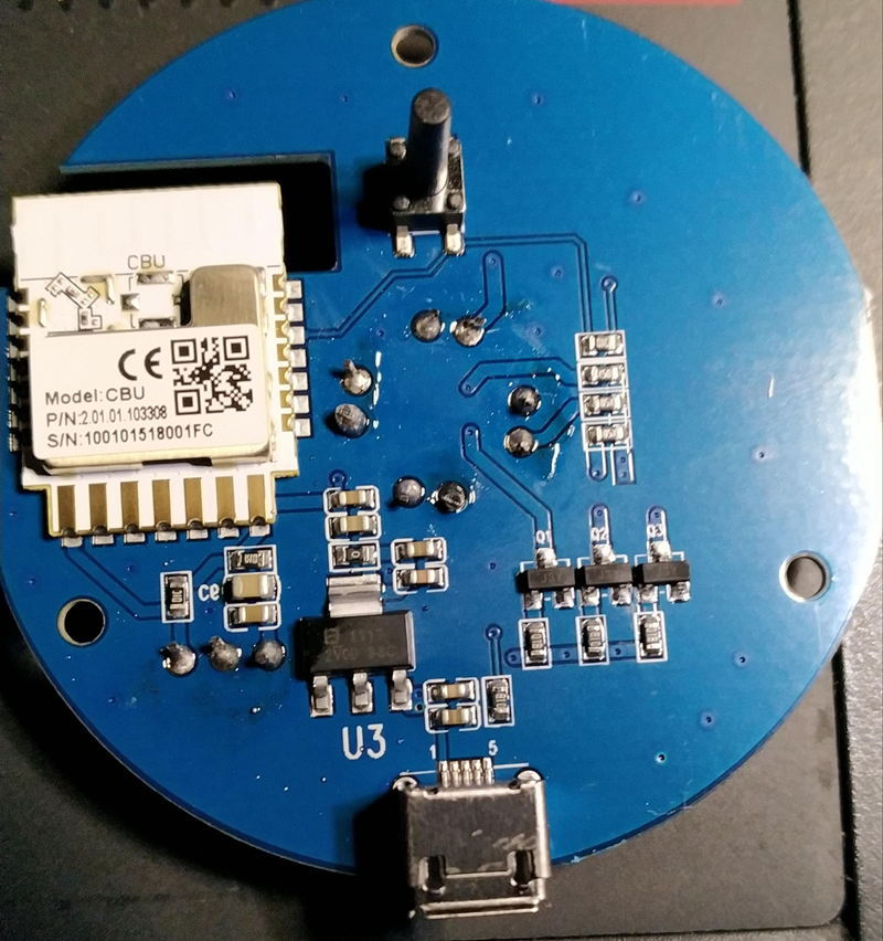

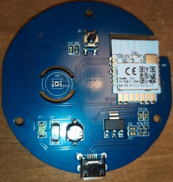

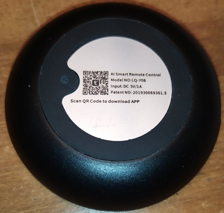

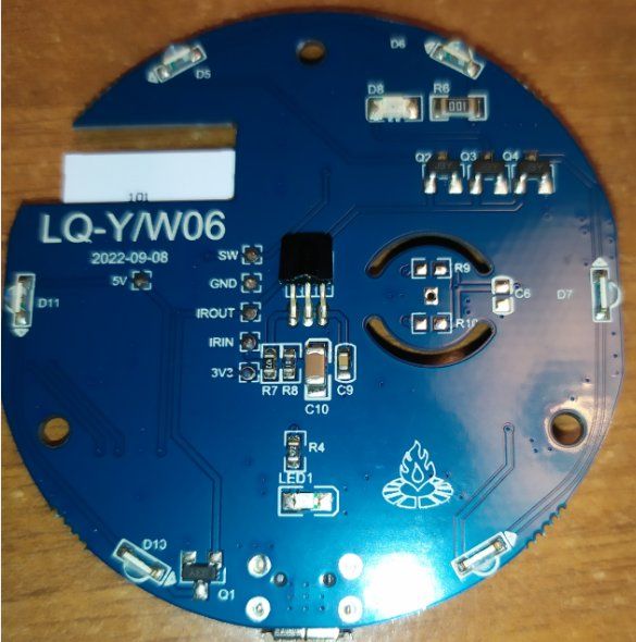

    Recently i received a similar ir remote, but with an additional temperature and humidity sensor cht8305. The device is built on CBU module, and it is also successfully added to the tuya application. I read original firmware, but the program could not recognize the configuration. This is strange, but if I configure the device and connect it to my home Wi-Fi network, the program reads the configuration, but it is obviously incorrect. If the device is removed (reset), the program can no longer read the settings. Below I have attached a photo of the device, also a file of the original firmware configuration received from the activated device, and a log from uart2. Any ideas on how I can get the configuration? Can I use openbk firmware?
    Photos
    Spoiler:
    Black, round electronic device on a wooden surface. Black, circular infrared remote with holes and a button on top. Printed circuit board with a CBU module and electronic components. Blue circular PCB with mounted LEDs and electronic components.
