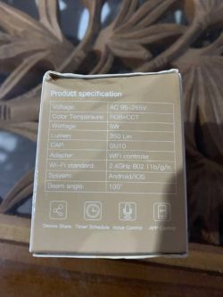

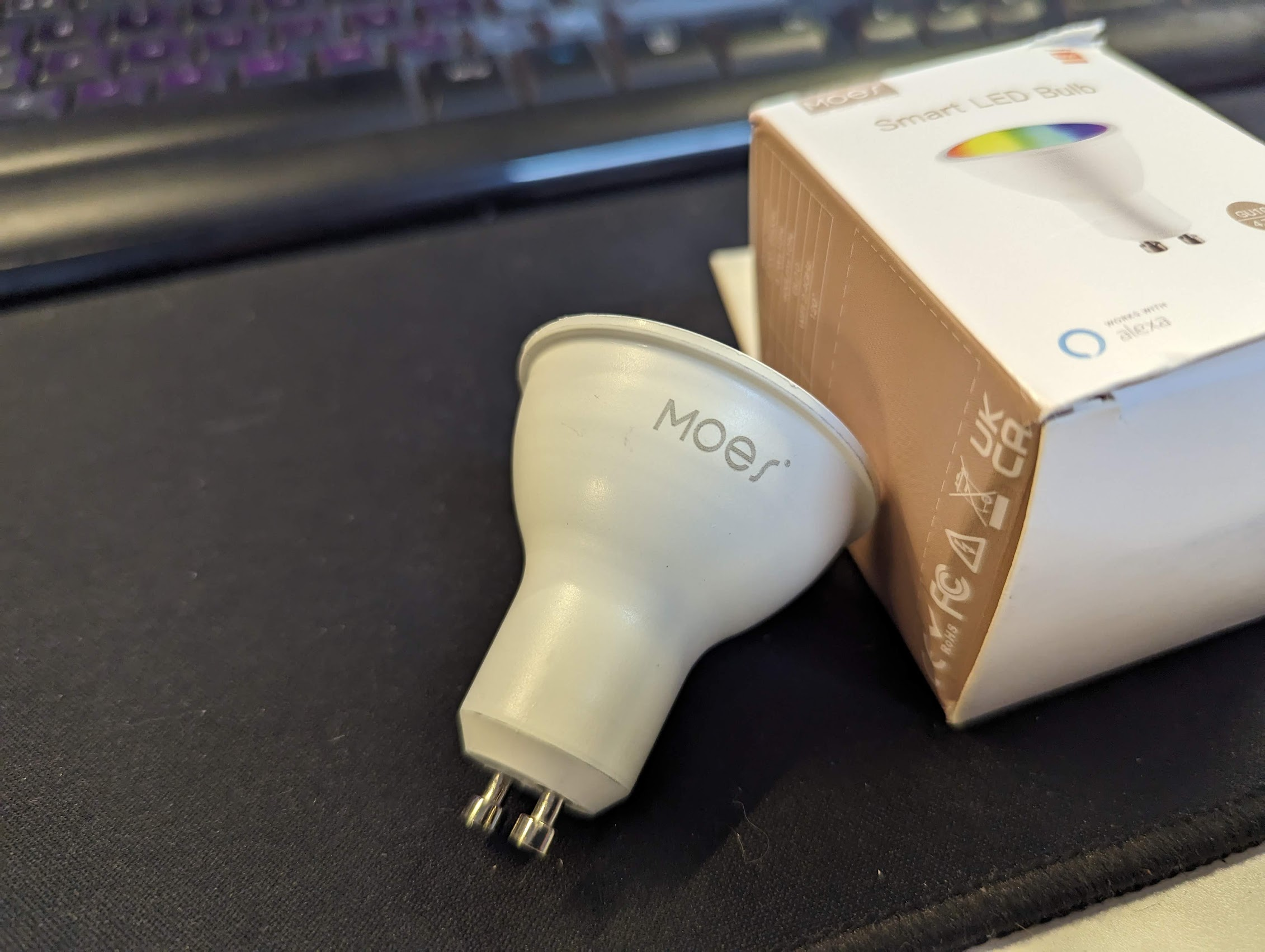

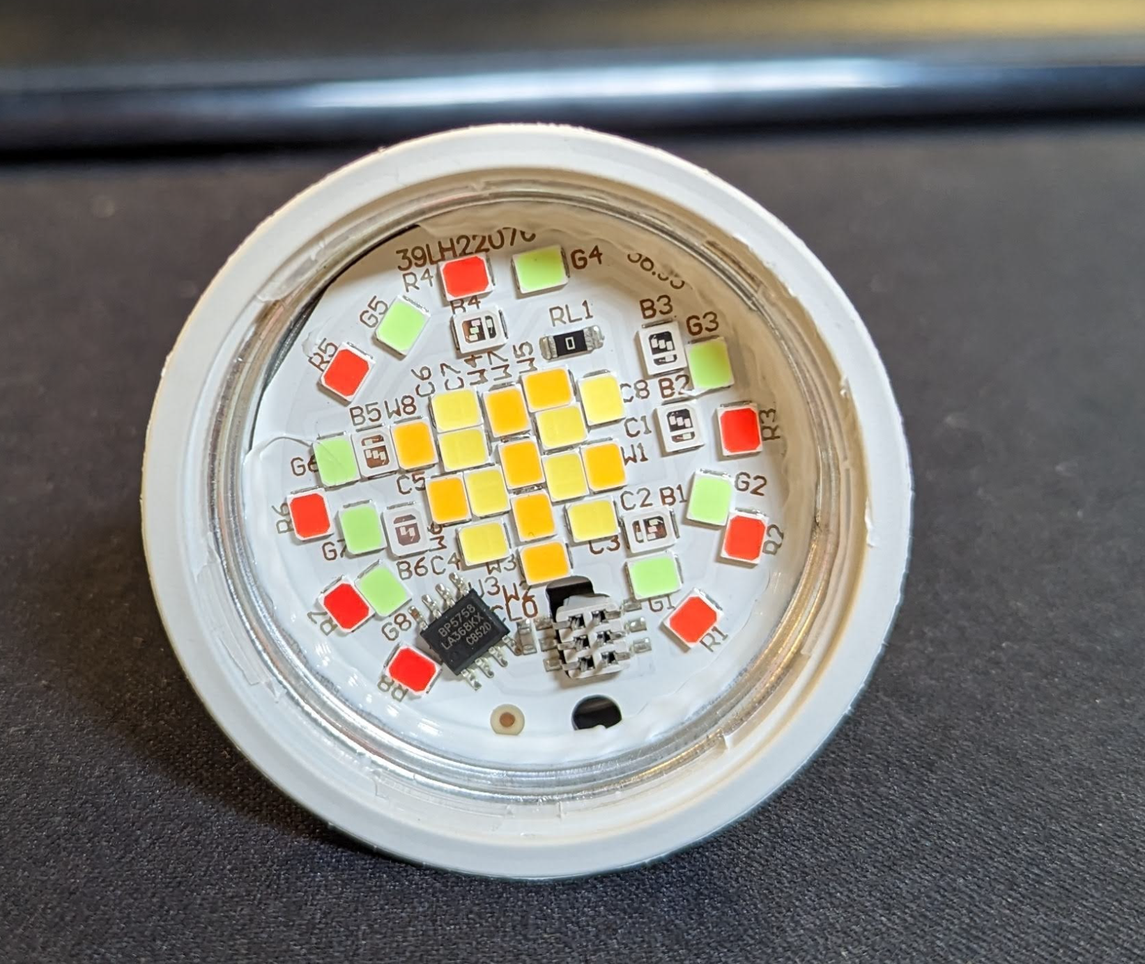

  • Teardown of the Moes Smart LED Light Bulb RGBCCT 5W GU10, model WB-YL5-RWW-GU10, built around a BK7231T [WBCL5] chipset.
  • The bulb uses tuya-cloudcutter for flashing, with the "A19 RGB" profile under Helloify and a startup command tweak for correct color mapping.
  • Pinout shows P24 as BP1658CJ_DAT and P26 as BP1658CJ_CLK, and the Tuya firmware version was 2.9.16.
  • The PCB was hard to remove without destroying the case or pulling the leg pins.
  • This is a short teardown of the Moes Smart LED Light Bulb RGBCCT 5W GU10 based on - BK7231T [WBCL5]
    Basic information:
    Brand: Moes
    Model: WB-YL5-RWW-GU10
    Chip: BK7231T [WBCL5]
    Local Vendor: https://www.lazada.com.my/products/i2303278194-s9802172838.html
    I've got them since early this year, however I couldn't figure out how to remove the pcb without destroying the case or removing the leg pins.
    Teardown Photos
    Package:
    [BK7231T] MOES Smart LED Bulb GU10 RGBCCT + BP1658
    [BK7231T] MOES Smart LED Bulb GU10 RGBCCT + BP1658 [BK7231T] MOES Smart LED Bulb GU10 RGBCCT + BP1658 [BK7231T] MOES Smart LED Bulb GU10 RGBCCT + BP1658 [BK7231T] MOES Smart LED Bulb GU10 RGBCCT + BP1658
    Flashing Method:
    Using tuya-cloudcutter
    Select 'A19 RGB' under Helloify. The tuya firmware for this was on 2.9.16
    Pinout:
    Pin Assignment
    P24 BP1658CJ_DAT
    P26 BP1658CJ_CLK
    Change Startup command text for correct color mapping:
    BP1658CJ_Map 2 1 0 3 4

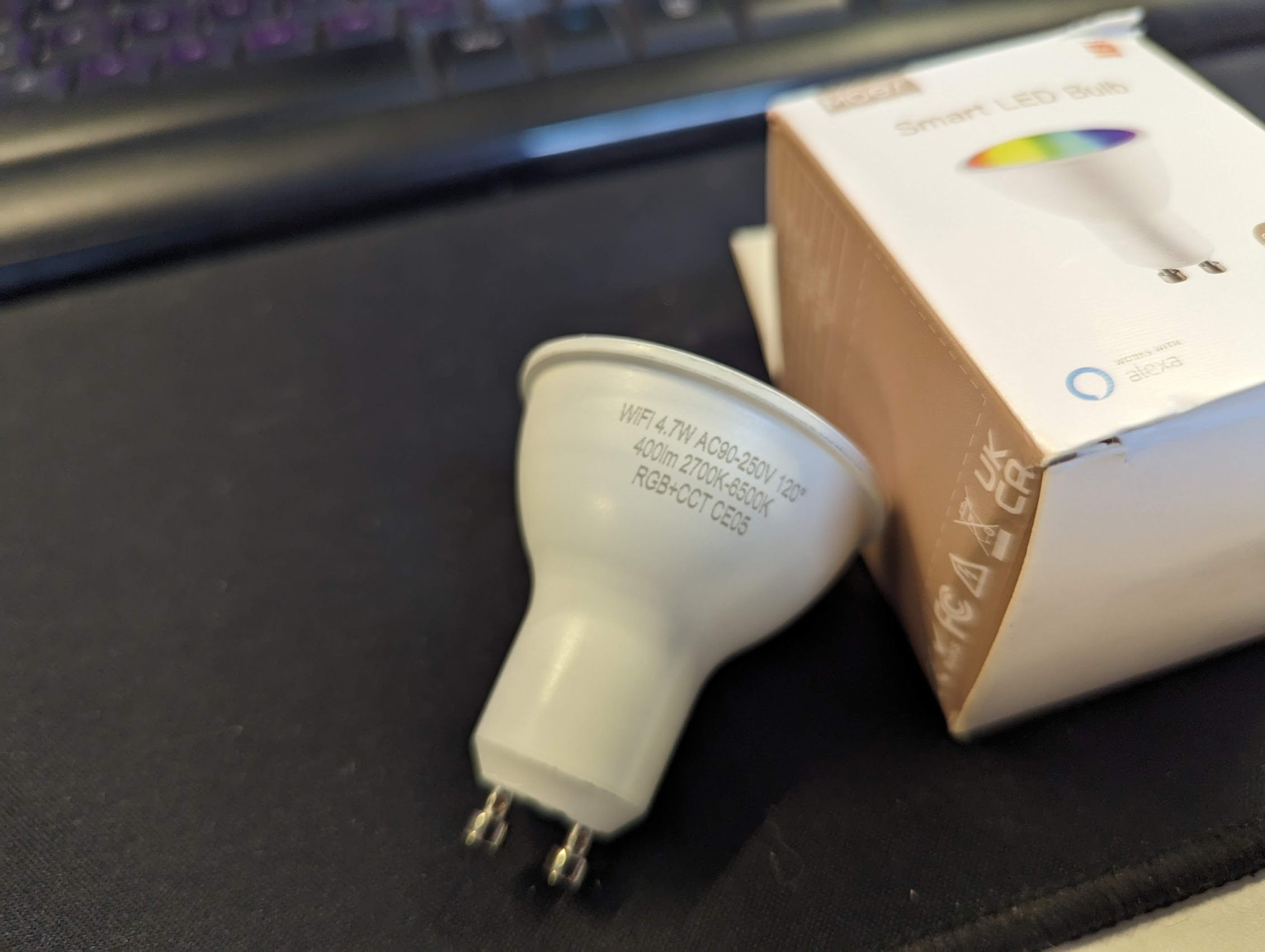

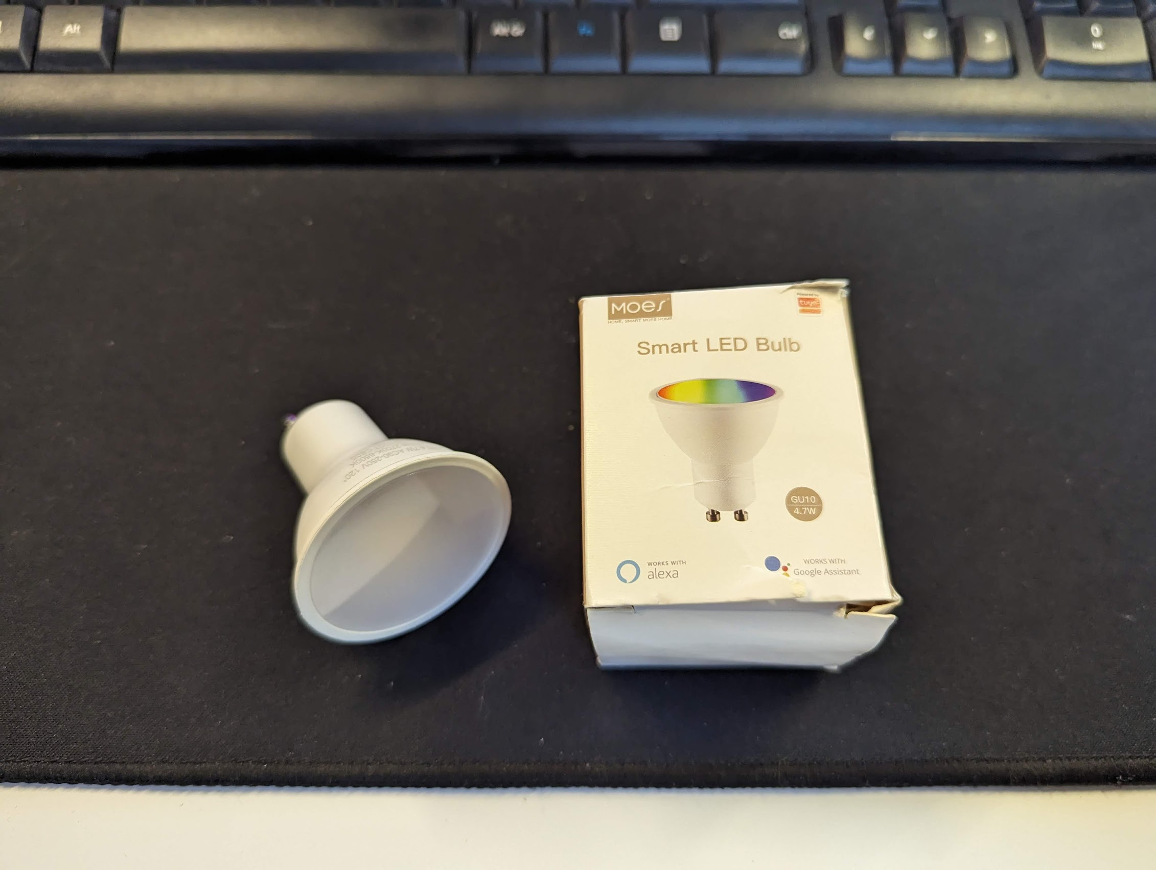

  • Cloud Cutter profile missing for 4.7W bulb
    #6 20655164
    anthonythomas
    Posts: 40
    Rate: 16
    Has anyone managed to flash via cloud cutter the 4.7W version?
    I have a few and I can't find a profile - or it's been patched and can't be flashed with cloud cutter.
