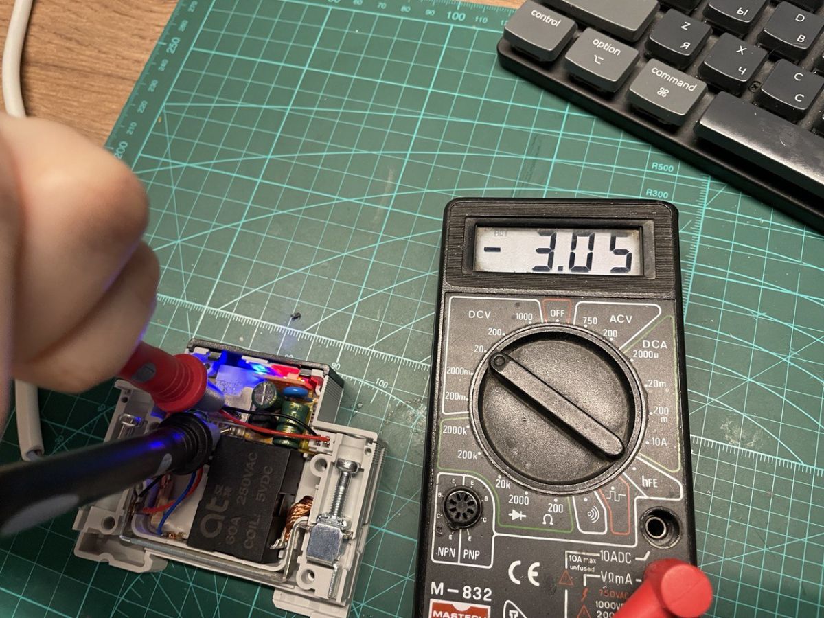

    Each at a time of controller output remains high forever:
    "24": "Rel;1",
    "26": "Rel_n;1"
    Also relay coil input remains or high or negative. But not fall to 0.
    Here I measure one of controller output:
    Digital multimeter showing -3.05 V next to an electronic module with test probes.
    I use latest firmware: Build: Build on Dec 13 2023 21:51:33 version 1.17.343
    And configuration from (Tongou) TO-Q-SY-JWT Switch and Meter for DIN Rail.
    I'm newbie in OpenBK so may be somewhere I do something wrong.

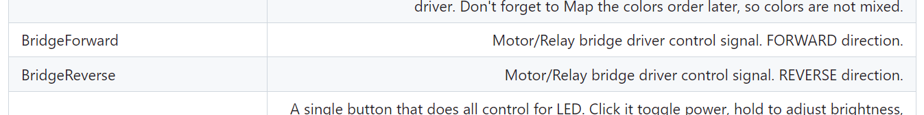

    Well, it looks like you have configured the GPIOs as a "dumb" relays, the ones that just copy the channel value to GPIO (in _n version, it's a negated value). This will not work as expected, as it's not a bridge.
    If you want to use our bridge driver, then you have to choose the bridge driver pins:
    https://github.com/openshwprojects/OpenBK7231T_App/blob/main/docs/ioRoles.md
    Here are bridge pins:
    Table showing motor/relay bridge control signals and their function descriptions.
    Please try to choose them, then reboot (so driver can autostart) and recheck if it behaves differently.
    PS: Once you configure it as I said, assuming it works better, can you post your config so I can update the old one? You've got the Rel/Rel_n from old config, correct? We need to fix it.

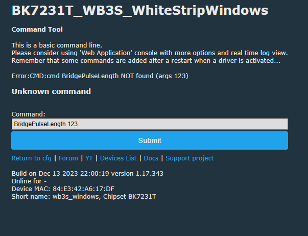

    Debug:API:POST to api/cmnd
    Debug:CMD:cmd [BridgePulseLength 100]
    Error:CMD:cmd BridgePulseLength NOT found (args 100)
    Info:CMD:[WebApp Cmd 'BridgePulseLength 100' Result] Unknown command
    also i try to add this string: "BridgePulseLength 100"
    To autoexec.bat.
    Nothing.
    I feel myself dumb.
  • #36 20862439
    Posts: 14622
    Help: 655
    Rate: 12638

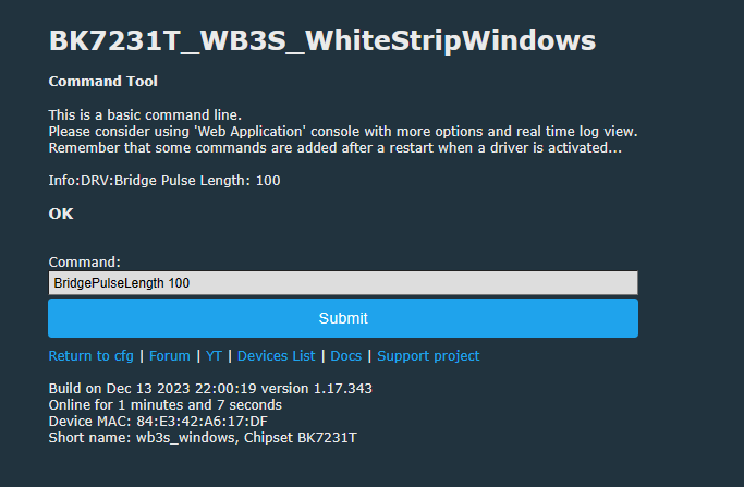

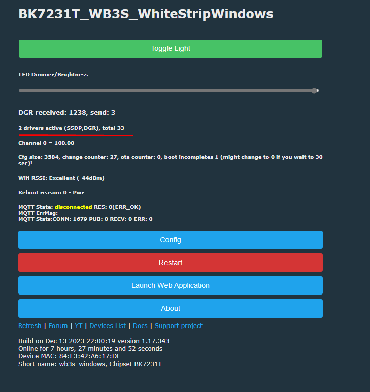

    Well, you mean you get that:
    Screenshot of Command Tool with an unknown command error.

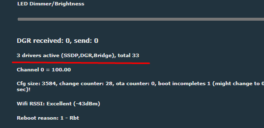

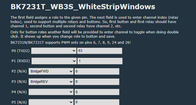

    That means bridge driver is not running. Look here:
    Screenshot of the user interface for the BK7231T_WB3S_WhiteStripWindows controller.
    What do you have running there?
    If I set bridge pins, look:
    Screenshot of the BK7231T_WB3S_WhiteStripWindows interface.
    and I reboot my device, I get:
    Screenshot showing a diagnostic message about drivers.
    and then command works:
    Screenshot of Command Tool for BK7231T_WB3S_WhiteStripWindows.

    Exact!
    0 drivers active, total 34
    But I add Bridge pins to configuration, and reboot not once after add it.
    Thank you for your support!

    Well, do you have older version or something? In worst case... you can start driver manually with startDriver...
  • #39 20862676
    Osrx
    Posts: 11
    As I said before
    No ideas...

    Ok , do what happens when you do startDriver Bridge in command line?

    Yes, after executing command: "startDriver Bridge", driver loaded and all start to work like a charm!
    Strange, that driver was not loaded automatically, so I've add it to the autoexec.bat. Now all work as expected.
    Thank you very much for supporting!

    Bridge driver should be starting automatically, unless you have disabled autostart in flags....

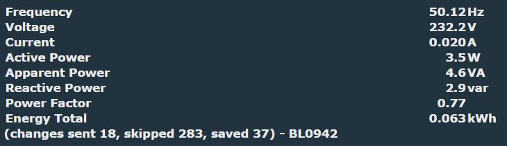

    Added after 5 [hours] 5 [minutes]:
    Screenshot of electrical parameters including frequency, voltage, current, active power, apparent power, reactive power, power factor, and energy consumption.

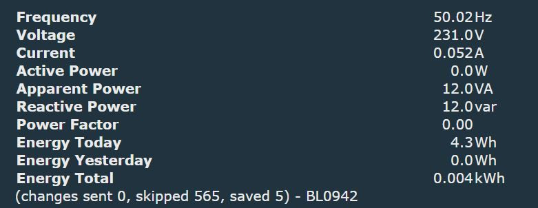

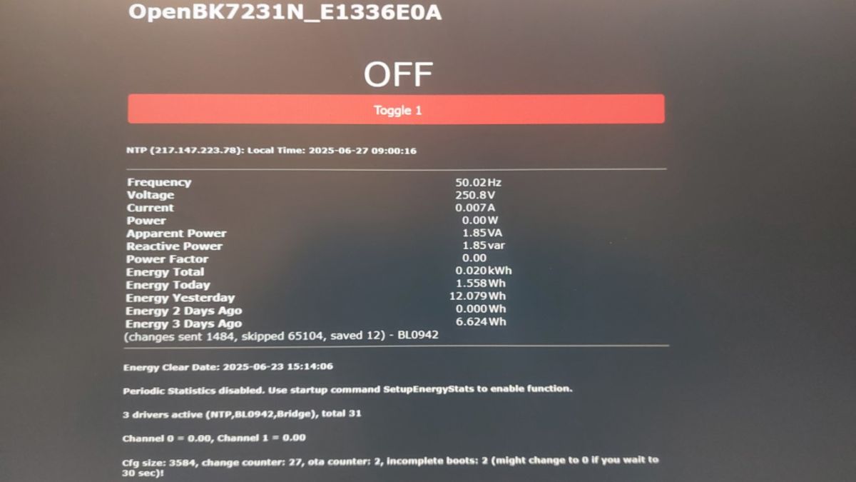

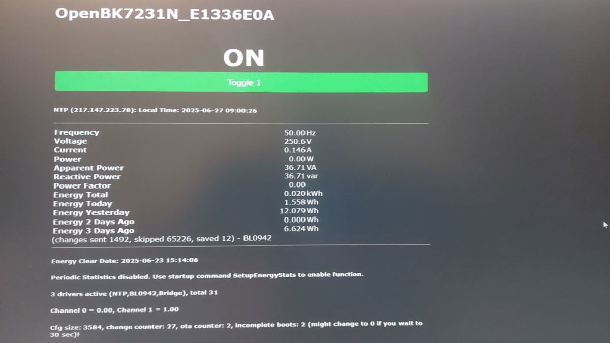

    For me, I used the json data printed after programming, and it seems to work fine except the following :
    - When OFF, the Power is 0.00W but Apparent and Reactive Power are not 0 :
    [BK7231N - CBU] TONGOU TO-Q-SY1-JWT Din Rail Wifi Switch with power metering
    - when ON, Power is still 0.00W and Apparent and Reactive Power are valued :
    Why Power is not computed ?
    I also wonder why the relay stays ON after a power outage (quite normal), when the power comes back ON, but the LED become ON when the power comes back ON, meaning that the breaker is OFF ?
    Is there a parameter to set, as default value for the LED ?
    Thx

    >>21591023 Please can you show me how ? I elso edited my post because I noticed a strange behaviour
    Edit : OK, in Configure Startup, I set -1 to Channel 1; and it is OK. Thank you !
    but why Power is 0.00W whatever the state ON or OFF ???

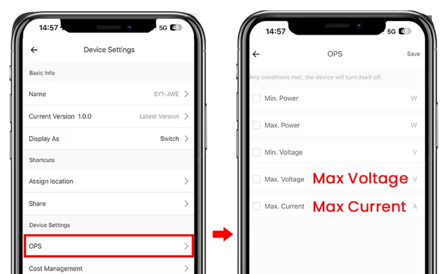

    This was originally the Ewelink version and it had voltage and current limitation, maximization.
    Two smartphone screens showing device settings and max voltage and current options
