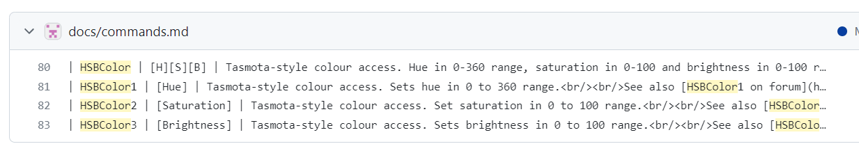

    Thanks for the heads up. I already configured it. Now looking into DDP integration with WLED and still fighting with OpenHab HSB Color model to RGB conversion. But that's on OpenHab's side until OpenBeken supports HSB model via MQTT. Looking into the source now.
  • #9 20827676
    Posts: 14782
    Rate: 12920
    Wait, isn't HSB support already in OBK? Via Tasmota command? HSBColor?
    Screenshot showing instructions for using HSBColor commands in the docs/commands.md file.
  • #10 20827692
    sebgarske
    Posts: 9
    Haven't tried via Tasmota command yet. And MQTT get state reflects RGB. Maybe I can get it via State or Result.
    Edit: Once I got it figured out, I will write up a tutorial for OpenHAB integration via MQTT.
