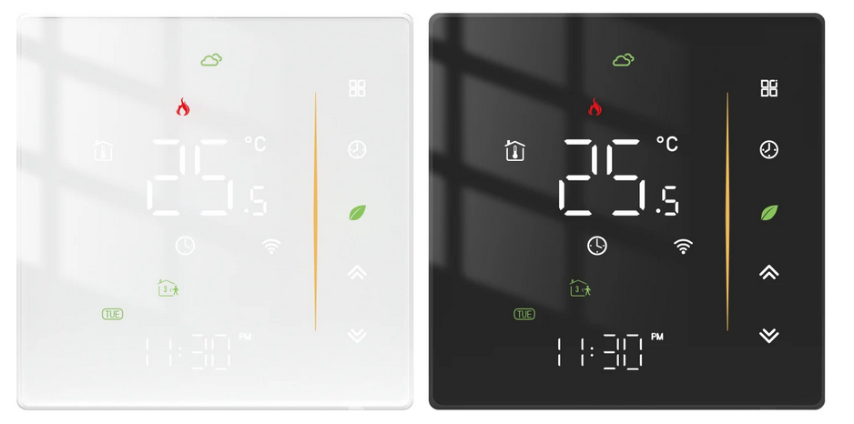

    Moes BHT-006GAW Thermostat with CB3S Module.
    AliExpress: https://www.aliexpress.com/item/1005004226680389.html
    Two Moes BHT-006GAW thermostats, white and black, with touch LED screens
    Sorry, no meaningful pins data found. This device may be TuyaMCU or a custom one with no Tuya config data.
    Baud keyword found, this device may be TuyaMCU or BL0942. Baud value is 9600
    No module information found.

    It is TuyaMCU so a different approach is required

    To get you started here are the dpIDs for your device.
    the schema 0000000id6 links it to this device which has the same https://www.elektroda.com/rtvforum/topic4003974-120.html#21361126
