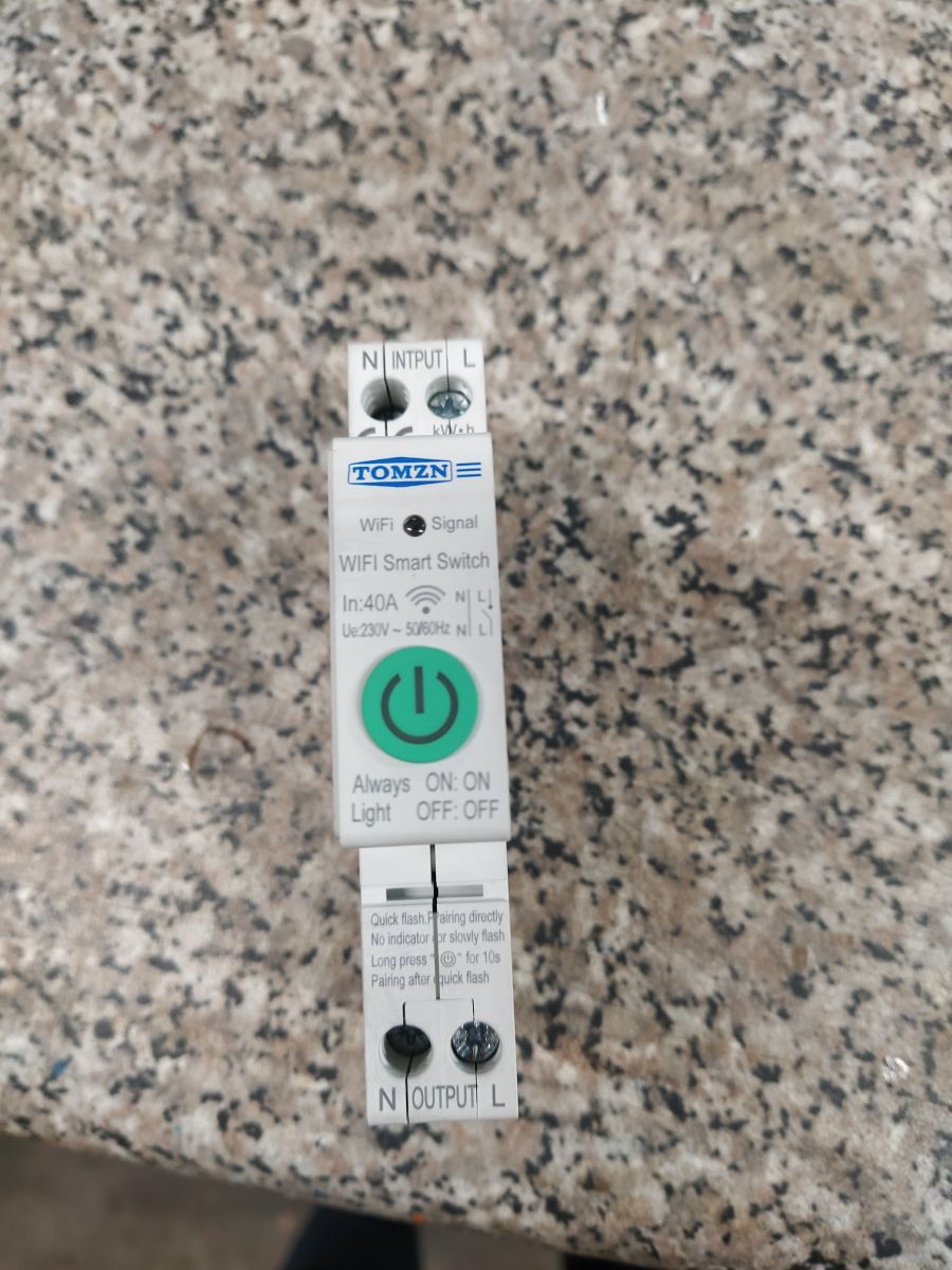

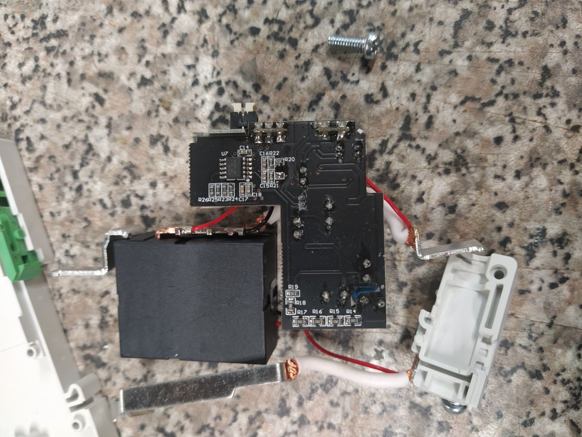

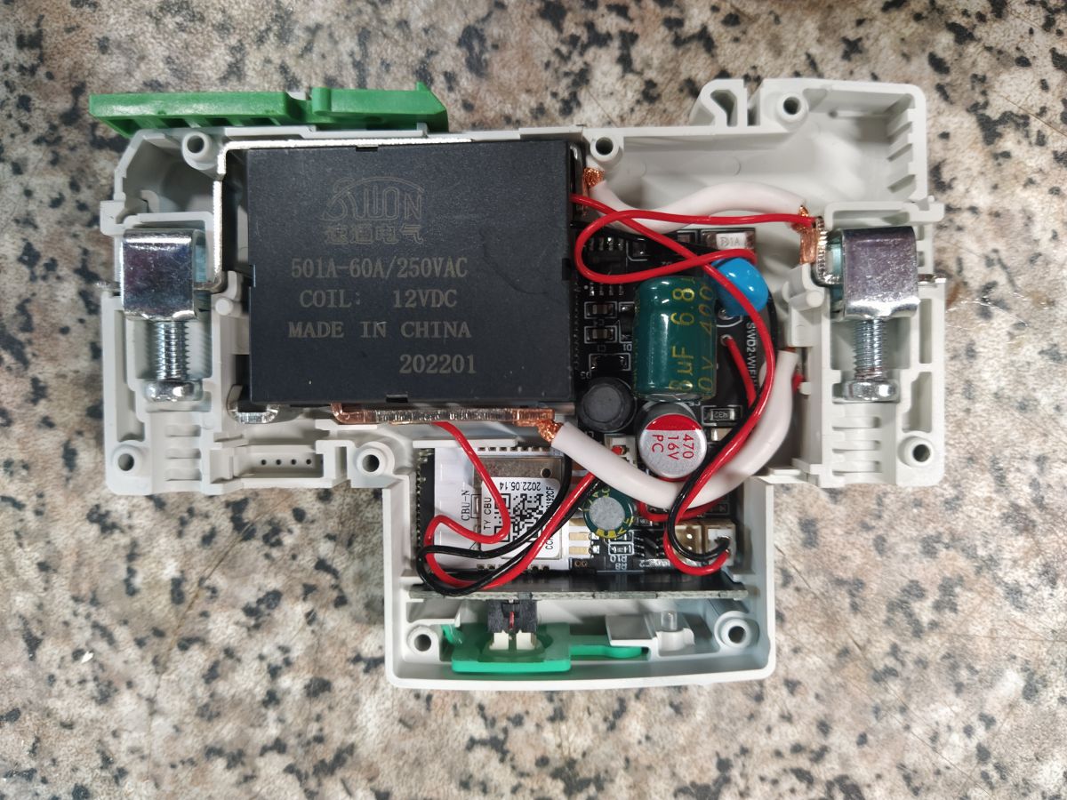

    Just a quick teardown. You have to drill out the rivets to disassemble so it's a bit of a pain in the ass.
    I have not tried to flash it just yet (ran out of time), I'll post the updates when I have. The old versions had an ESP but the new versions are using a CBU-N Module.
    TOMZN 1P 63A Circuit Breaker Power Monitoring DIN Relay [BL0942][CBU-N][BK7321N] TOMZN 1P 63A Circuit Breaker Power Monitoring DIN Relay [BL0942][CBU-N][BK7321N] TOMZN 1P 63A Circuit Breaker Power Monitoring DIN Relay [BL0942][CBU-N][BK7321N] TOMZN 1P 63A Circuit Breaker Power Monitoring DIN Relay [BL0942][CBU-N][BK7321N]
    Using a BL0942 Metering IC.
    Using a CBU-N Module, from what I understand this is a BK7321N
    I still need to confirm but I think the pinouts are:
    Pin Number	Symbol		Pin On IC	Use
    8			P8			24			Btn
    9			P7			23			LED_n
    10			P6			22			Wifi LED_n
    11			P26						Relay On
    12			P24						Relay Off

    If I remember correctly, I was able to flash CB2S module connected to BL0942 without removing BL0942. It was in case of LSPA9 smart socket with power metering - the newest version, BK7231N one. There is also an older version of LSPA9 in the market, which is using WB2S and BL0937, but it doesn't really matter.
    Anyway, try to flash this device and let us know if it worked for you. I hope it won't be too problematic.
    PS: so one of the ICs is BL0942, what is the other one? The one used in power supply section? I'm just curious.

    I was able to read the flash and dump the factory flash however I was unable to program it with bk_writer1.60.
    I keep getting a "deprotecting flash FAILED" error. Is this a known error or am I doing something wrong? Do I need to flash the unit from a linux PC using hid_download_py?
    The power supply IC looks like an ICW4009, never seen this one before.

    Managed to get it flashed and get the wifi, LED's and buttons set up.
    The issue I'm having is it is a latching relay. How do I set this up? So I toggle one pin to energize the relay and toggle another to de-energise the relay.

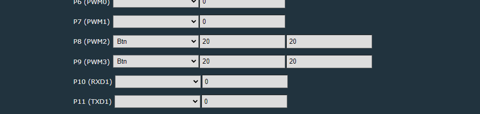

    You might need to use scripting for that.
    First link the two buttons to dummy, unused channel (let's say 20):

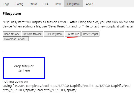

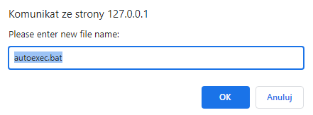

    Then, in LittleFS tool of Web App, create autoexec cfg:

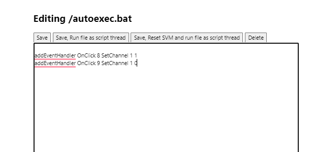

    Add script:
    // addEventHandler  buttonEventName pinid cmd
    addEventHandler OnClick 8 SetChannel 1 1
    addEventHandler OnClick 9 SetChannel 1 0
    Reboot.

    The Relay is a latching type.
    So you need to toggle one pin (P26) high then low to open the relay.
    Then, toggle another pin (P24) high then low to close the relay.
    The relay needs to be powered only for changing contact position.
    Then the relay holds the last position without power.
