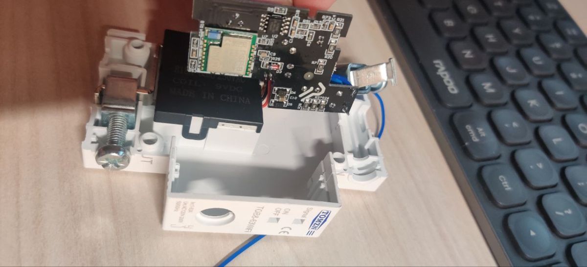

    Few days ago I received this Breaking hoping simple installation of Tasmota firmware
    https://templates.blakadder.com/tomzn_TOB8-63WiFi.html

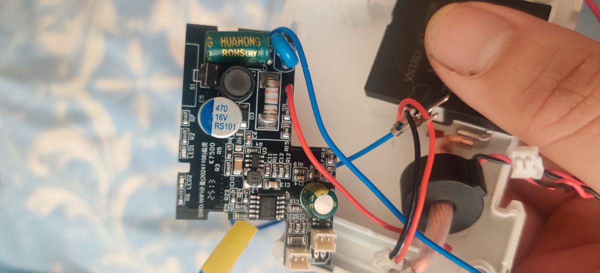

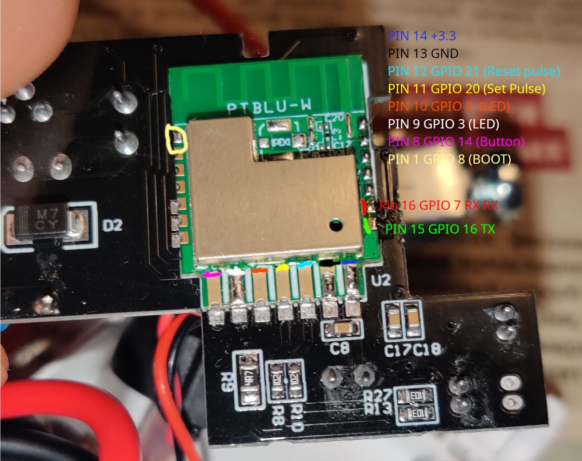

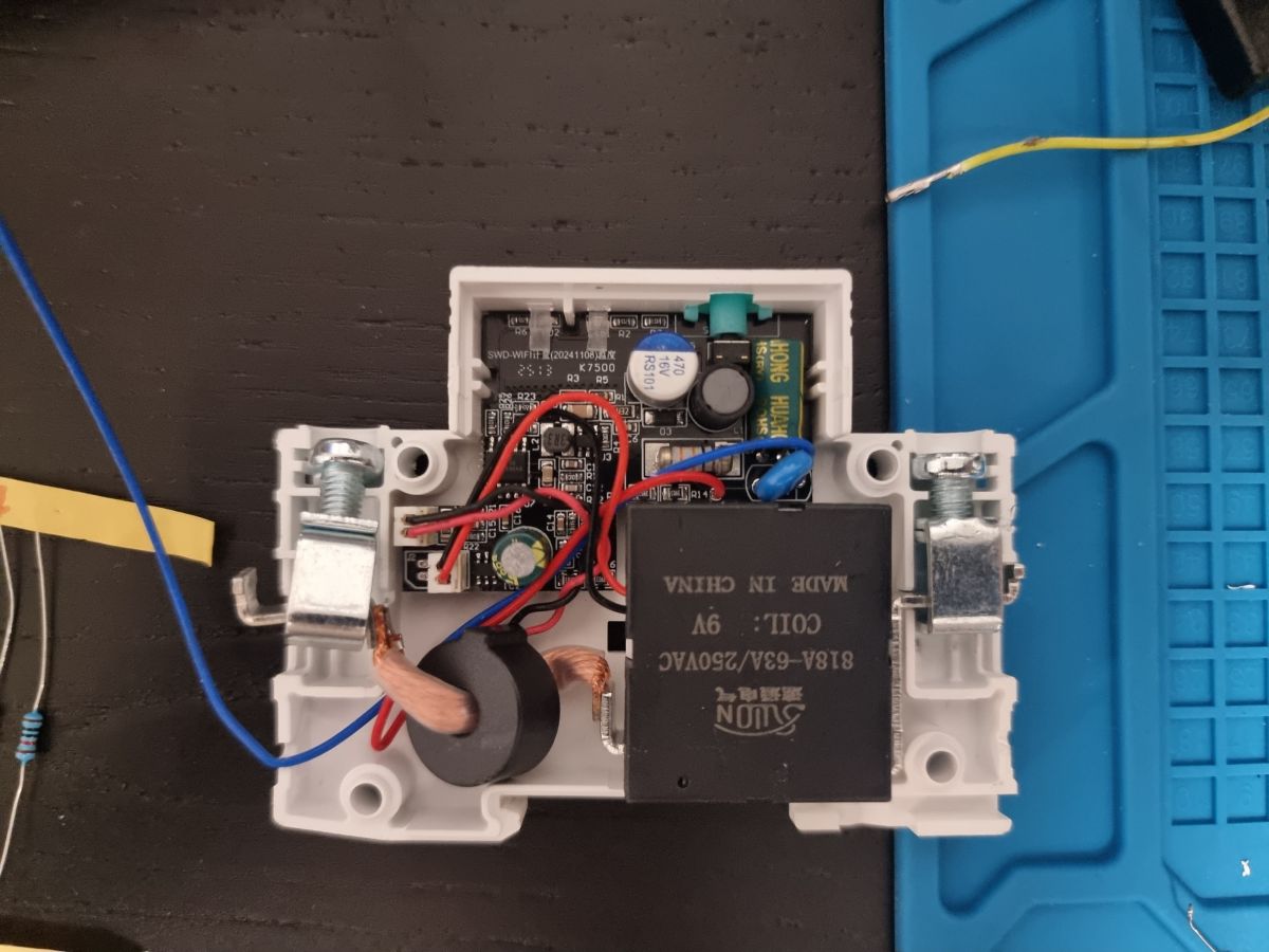

    During teardown I found completely different platform, looks like it contains
    ptblu-w motherboard with BL602 chip
    After tracing path using multimeter I found this pins layout.
    Close-up of an electronic module with labeled GPIO and signal pins.
    Using firmware tool and BOOT pin (with 10k resistor connected to 3.3V) I successfully flashed OpenBL602_1.18.164.bin image, after firmware I connect device to my WiFi.
    But during testing pins layout I found that no pins react to high signal. I tried filling config, I tried GPIO internal tool, no pins even WiFi and power LED are affected by high level

    I test all pins followed multimeter traced path
    Added after 4 [hours] 26 [minutes]:
    ok looks like i find issues with this this device, i wrong connect Phase and zero wire. so at this moment i successfully find and setup power and wifi led. and using GPIO doctor find BiStable Relay pins. its turnON and turnOFF without any problem, but how to configure bitsable relay in pins configuration menu? BridgeFWD BridgeREV only setup voltage to both pins

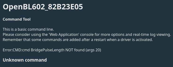

    looks like my i don't have activated BridgeDriver how i can activate this or i need recompile image?
    Screenshot from OpenBL602 showing a command error saying Unknown command.
    Info:MAIN:Driver Bridge is not known in this build.

    try this build
    • OpenBK7231T_App_bl602bridge_06326df0ee1a_OpenBL602.zip (1.72 MB) You must be logged in to download this attachment.
    • OpenBK7231T_App_bl602bridge_06326df0ee1a_OpenBL602_berry.zip (1.99 MB) You must be logged in to download this attachment.
  • Bridge driver works in the default firmware config

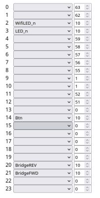

    Looks like i finally have fully work config for this relay.
    Everythink works normal PowerON/OFF, WIFI/POWER LED, and button.
    Can some one say, is it possible to add bridge driver in to default firmware?
    I think it's very useful driver.
      "vendor": "Tuya",
      "bDetailed": "0",
      "chip": "BL602",
      "board": "TODO",
      "flags": "1024",
      "keywords": [
        "TODO",
        "TODO",
        "TODO"
      "pins": {
        "2": "WifiLED_n;10",
        "3": "LED_n;10",
        "14": "Btn;10",
        "20": "BridgeREV;10",
        "21": "BridgeFWD;10"
      "command": "delay_s 11\r\nstartDriver BL0942",

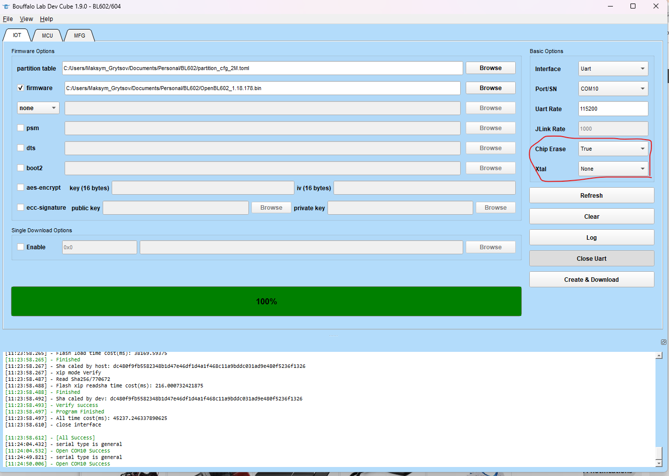

  • #12 21698937
    goblinmaks
    >>21698343
    Ok, looks I bricked chip, after erasing flash with xtal = none
    Which correct parameters for this chip ?
    Nothing received in UART, I found openBeken AP after first reboot, but not connected to Wi-Fi correctly, then I wrote chip again with erase option.
    Bouffalo Lab Dev Cube interface with loaded firmware file
  • #13 21698942
    insmod
    Posts: 1432
    Help: 168
    Rate: 455
    >>21698937
    boot2 is required
    xtal needs to be 40m
    dts is recommended to be bl_factory_params_IoTKitA_40M.dts (in chips/bl602/device_tree)
  • #14 21698977
    goblinmaks
    >>21698942
    which boot2 need to use ?
    Added after 7 [minutes]:
    >>21698977 >>21698977
    Works, Appreciate you.

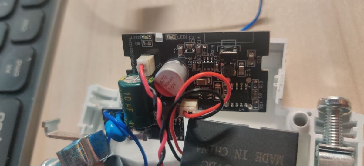

    suchystan
    Hi, has anyone discovered already what to do to make power measurement? All seems to be working fine with this build:
    OpenBL602_1808_merge_7a9531fa45b6_OTA.bin.xz.ota
    Relay on/off and pwr, Wi-Fi LEDs are fine as well, but the major thing I still missing is power measurement.
    I use this board:
    Open electronics enclosure with PCB, JYONN relay, and red/blue wires on a work mat
  • Missing startDriver BL0942 in startup script

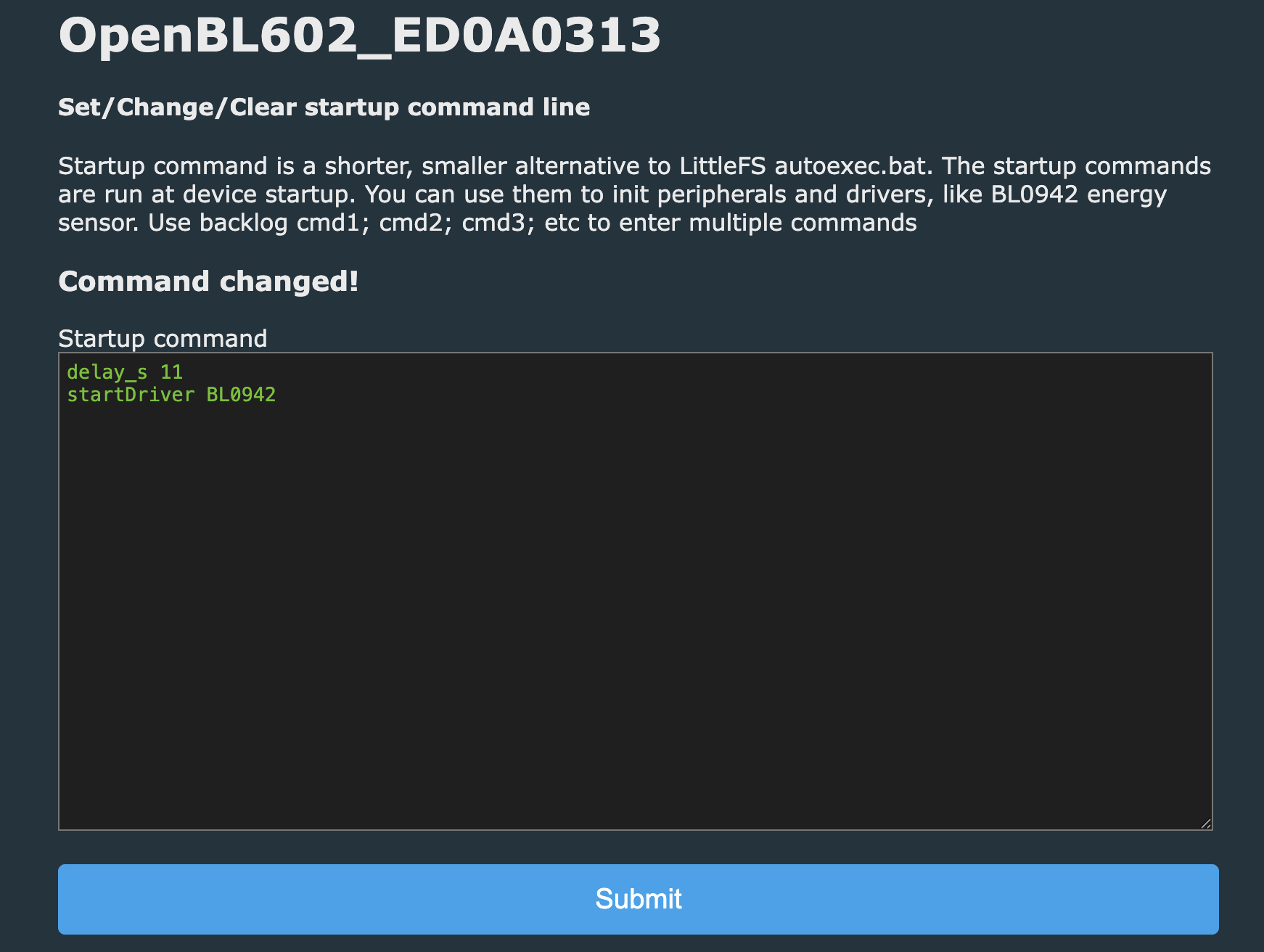

    #20 21867542
    suchystan
    Yes, it is BL0942 however I still cannot get it working.
    After applying json template, in logs I see following line:
    Info:MAIN:Driver BL0942" is not known in this build.
    As said above, I use this build: OpenBL602_1808_merge_7a9531fa45b6_OTA.bin.xz.ota where only power measurement does not work.
    When I use any of the latest builds like: OpenBL602_1.18.277_OTA.bin.xz.ota, the relay and button does not work while PINs config is the same and I get as well the same error message "Info:MAIN:Driver BL0942" is not known in this build."
    I have found a solution, for some reason the configuration from Json was not applied, after manually sending the command to startDriver BL0942 I got the readings :)
    Finall solution for me was to update startup script by adding startDriver BL0942 as it was missing.
