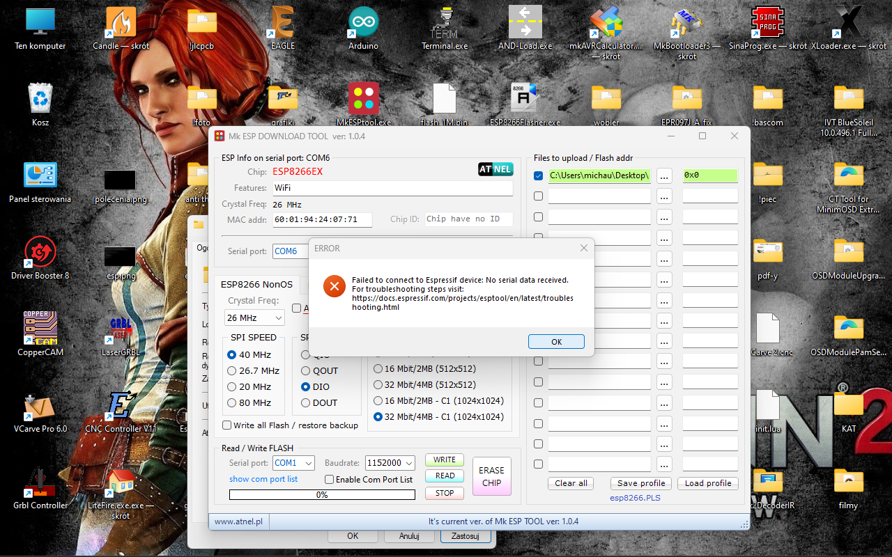

You can read back the ESP8266 flash as a .bin file for duplication, but not edit it directly from the dump [#20319836] Install Python and esptool, then use a command like `esptool.py -p COM6 -b 115200 read_flash 0 0x100000 flash_contents.bin` in CMD, making sure the COM port is correct and not adding `python` in front of `esptool.py` [#20319882][#20321387][#20321563] If the chip is not detected, put it into flash mode manually by connecting GPIO0 to GND and briefly toggling RESET while GPIO0 stays grounded [#20320463] Use the default or a stable esptool version, and check that the USB-UART/driver and wiring are correct if detection still fails [#20321387][#20321563] As an alternative, Tasmotizer also has a backup/read-flash function [#20322263]

  • #33 20321611
    elektrofil
    Posts: 509
    Help: 32
    Rate: 46
    And yes and no, it only recognises it partially, i.e. when I insert it into the usb for a moment before starting the program, but it still gives an error.
    Reading flash content from ESP8266 board - project data recovery .
  • #34 20321626
    raks0
    Posts: 788
    Help: 258
    Rate: 450
    In the picture it detected COM6 and at the bottom in read/write flash you have COM1 set
