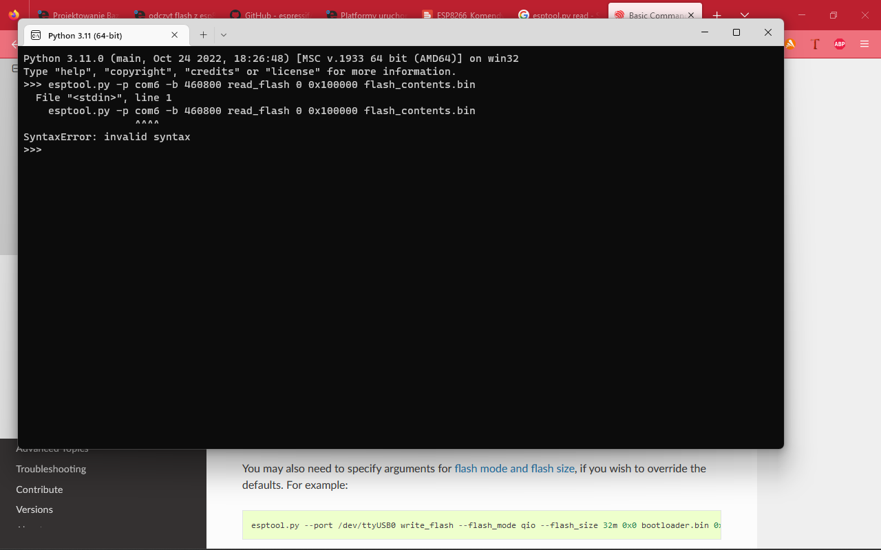

    Use the ESPtool.py. Read command, if there are problems you will need to set some other things. The file will save in the default esptool folder. You also upload with this.
  • #5 20319907
    elektrofil
    Posts: 509
    Help: 32
    Rate: 46

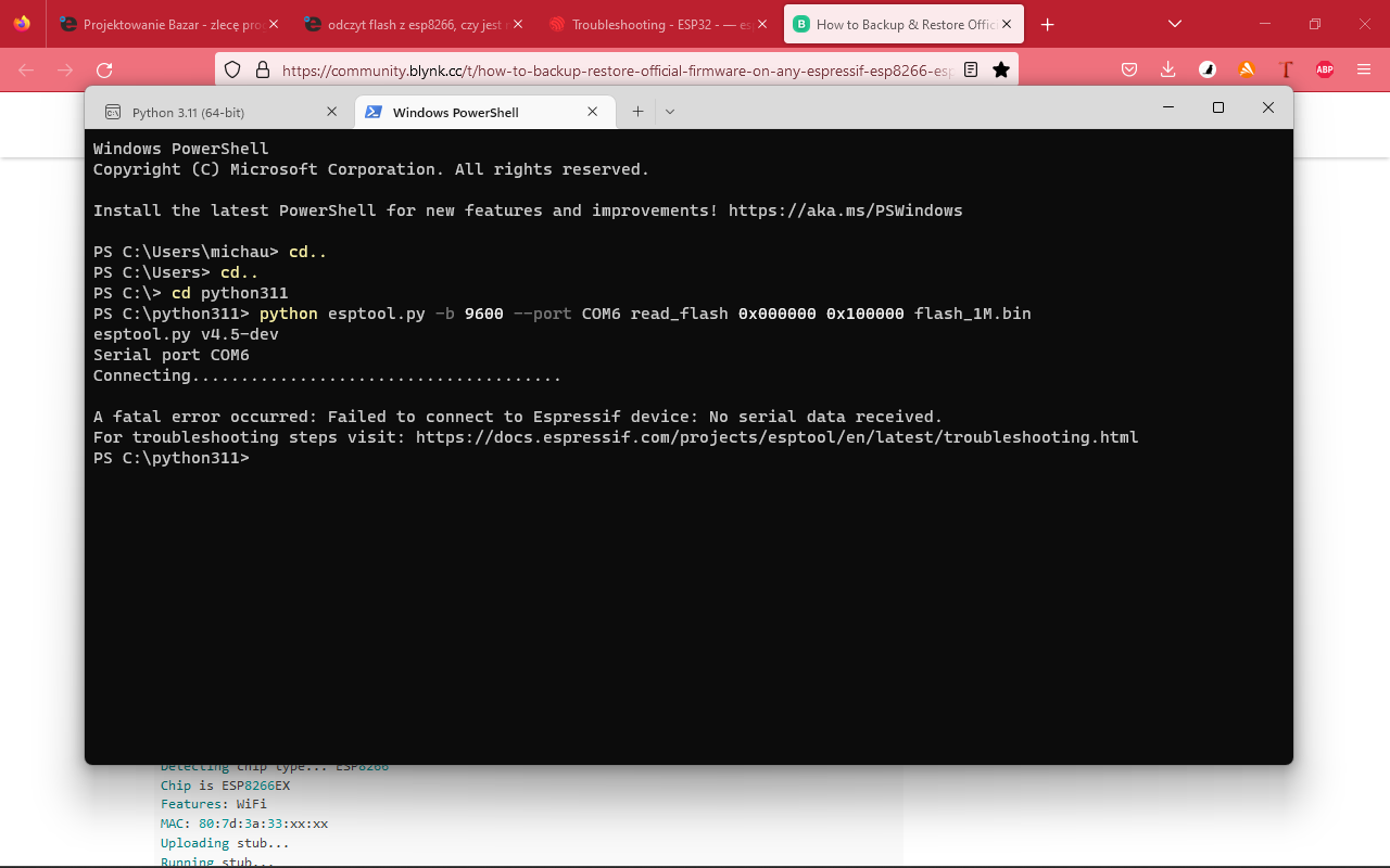

    I understand that I am to use the command:
    Code: AVR assembler
    and here I have a problem
    Reading flash content from ESP8266 board - project data recovery .
    #6 20319929
    csvrbntyu
    Level 30  
    Posts: 1394
    Help: 163
    Rate: 405
    "COM" not "com". Well, and check that you haven't got the port number wrong.

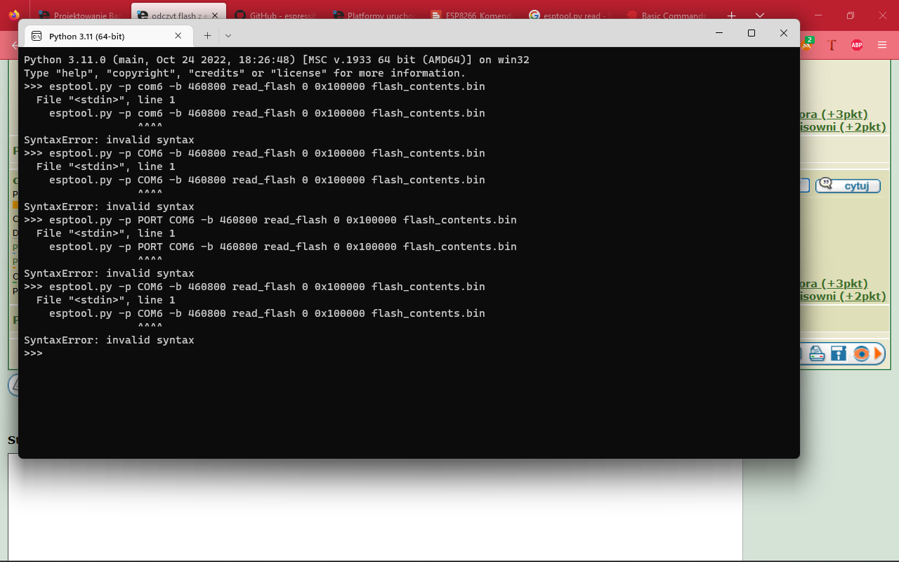

  • #7 20319934
    elektrofil
    Posts: 509
    Help: 32
    Rate: 46
    Unfortunately it doesn't work, even if I add the word PORT before COM6
    It is definitely on COM6.
    #8 20319993
    raks0
    Posts: 788
    Help: 258
    Rate: 450
    You are in Python interactive mode. Have you installed esptool via pip at all?

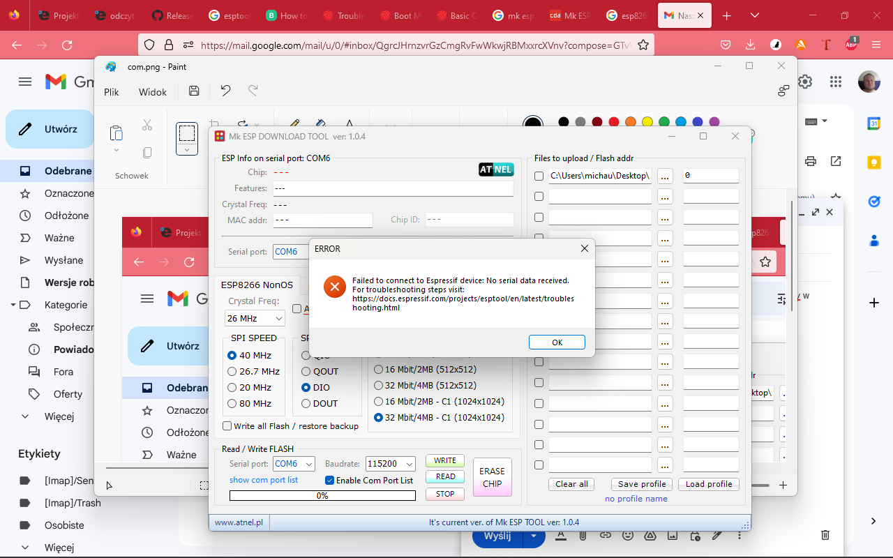

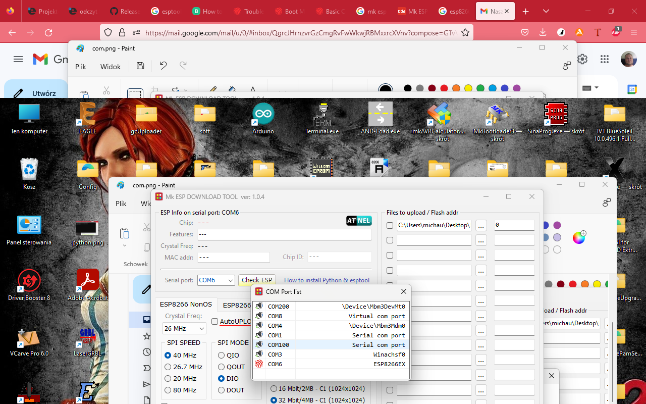

    Thank you for the video, I have installed, but I have a problem with the detection of the esp8266 module.The problem is already in the MK ESP Tool.
    Namely, it is detected in the COM Port list, but not detected through Check ESP.
    Same in python
  • #12 20320283
    raks0
    Posts: 788
    Help: 258
    Rate: 450
    GPIO0 connected to GND? maybe try a lower Baudrate
  • #13 20320289
    elektrofil
    Posts: 509
    Help: 32
    Rate: 46
    yes, connected, and lower baudrate e.g. 9600 or go even lower?

    What USB UART converter do you have? maybe the driver needs to be newer, check the connections again. ESP powered from the converter?

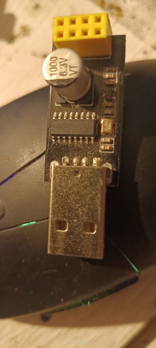

  • #15 20320338
    elektrofil
    Posts: 509
    Help: 32
    Rate: 46
    Programmer bought (probably on ch340), with arduino programs without problem.
    It has jumpers on the underside.

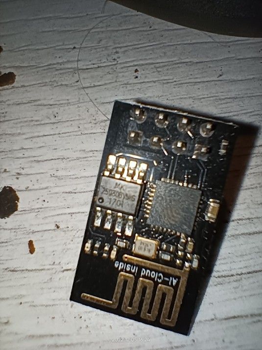

  • Manual ESP8266 flash-mode entry by grounding GPIO0 and reset
    #16 20320463
    xury
    Automation specialist
    Posts: 7083
    Help: 878
    Rate: 1498
    Without exaggeration, the baudrate is a minimum of 115200.
    Put it into flashmode manually, i.e. connect gpio0 to gnd and also put gnd on reset for a while. Then the esp8266 must enter flash mode. Supposedly these programmers should do it themselves via dtr and rts pin, but many times I didn't want autoreset to work either.
    What is the best way to do this?
    Solder a piece of wire to the GND of the programmer. At the other end, preferably fit a piece of stiff wire such as a male dupont end, or a needle etc. On the esp-01, gpio0 and reset are in one column.
    You attach the tip to the gpio0 and without detaching from it, you move it towards RST by touching it for a moment and then move it back while still in contact with the gpio0. After a while you can also disconnect the gnd from gpio0 being careful not to touch the reset again.
    So, in short: touch GND to gpio0 and, "sliding" the "bare" wire over gpio0, touch RST for a moment. Then we undo the pin and move the whole wire away from the board.
    After this operation, the esp-01 is in flash mode and you can read the flash.

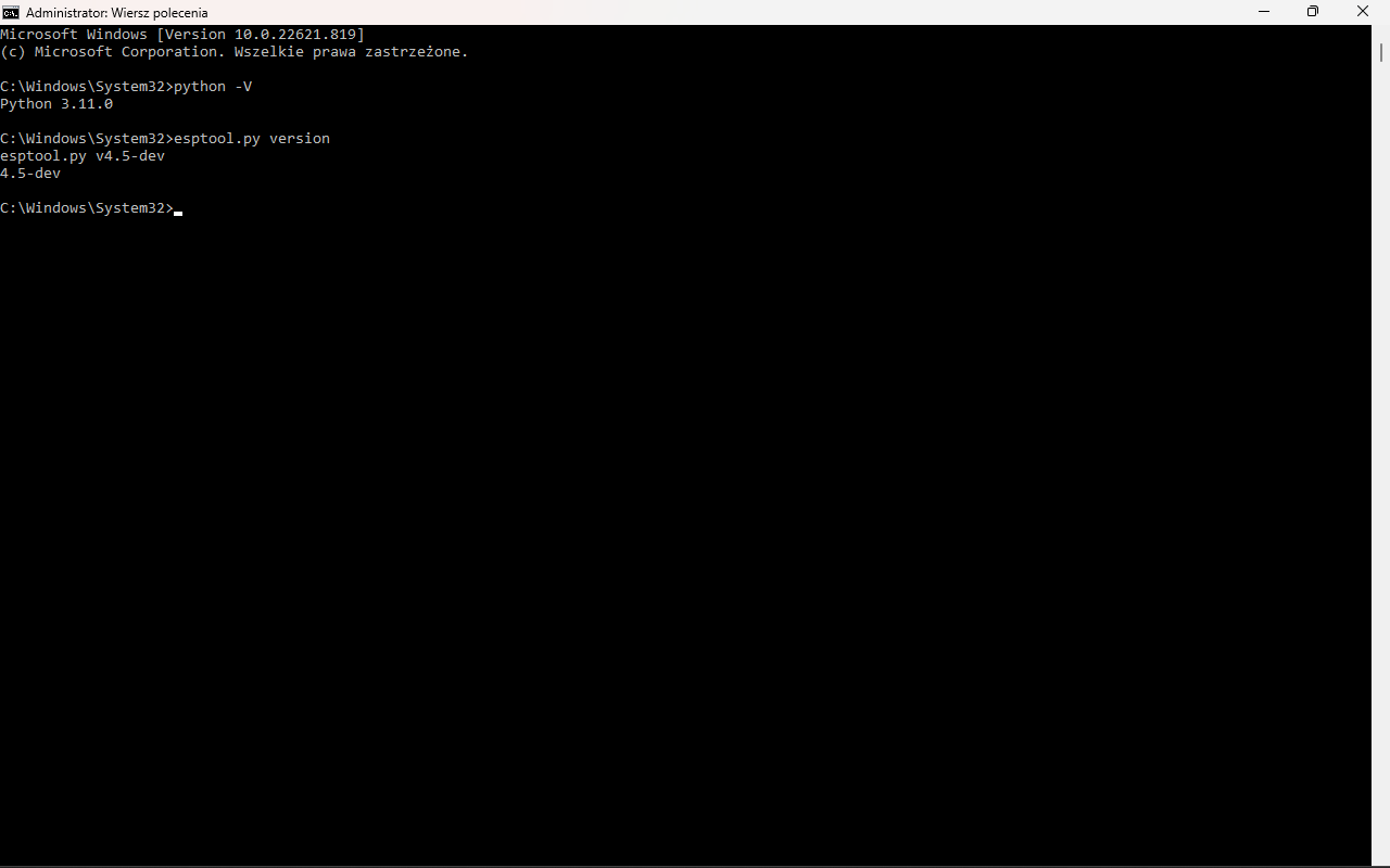

    I'm still puzzled as to why you are running this in such a complicated way via PowerShell and why your version of esptool is 4.5-dev.
  • #19 20320864
    elektrofil
    Posts: 509
    Help: 32
    Rate: 46
    As this is new to me and I don't know any other way of commissioning, I'm just learning it, so if you can give me some tips.

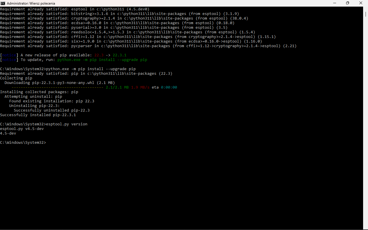

  • #25 20321402
    elektrofil
    Posts: 509
    Help: 32
    Rate: 46
    Version 4.5 is still available
  • #26 20321432
    raks0
    Posts: 788
    Help: 258
    Rate: 450
    If pip uninstall doesn't work then delete grandpa manually in the c:\python311\lib\site-packages directory delete the folders starting with esp.
    reboot your computer, and then esptool.py version as standard
    If that doesn't help then uninstall Python delete c:python311. And install everything from scratch
