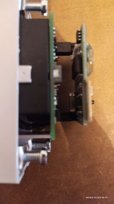

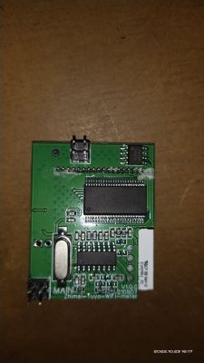

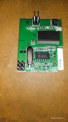

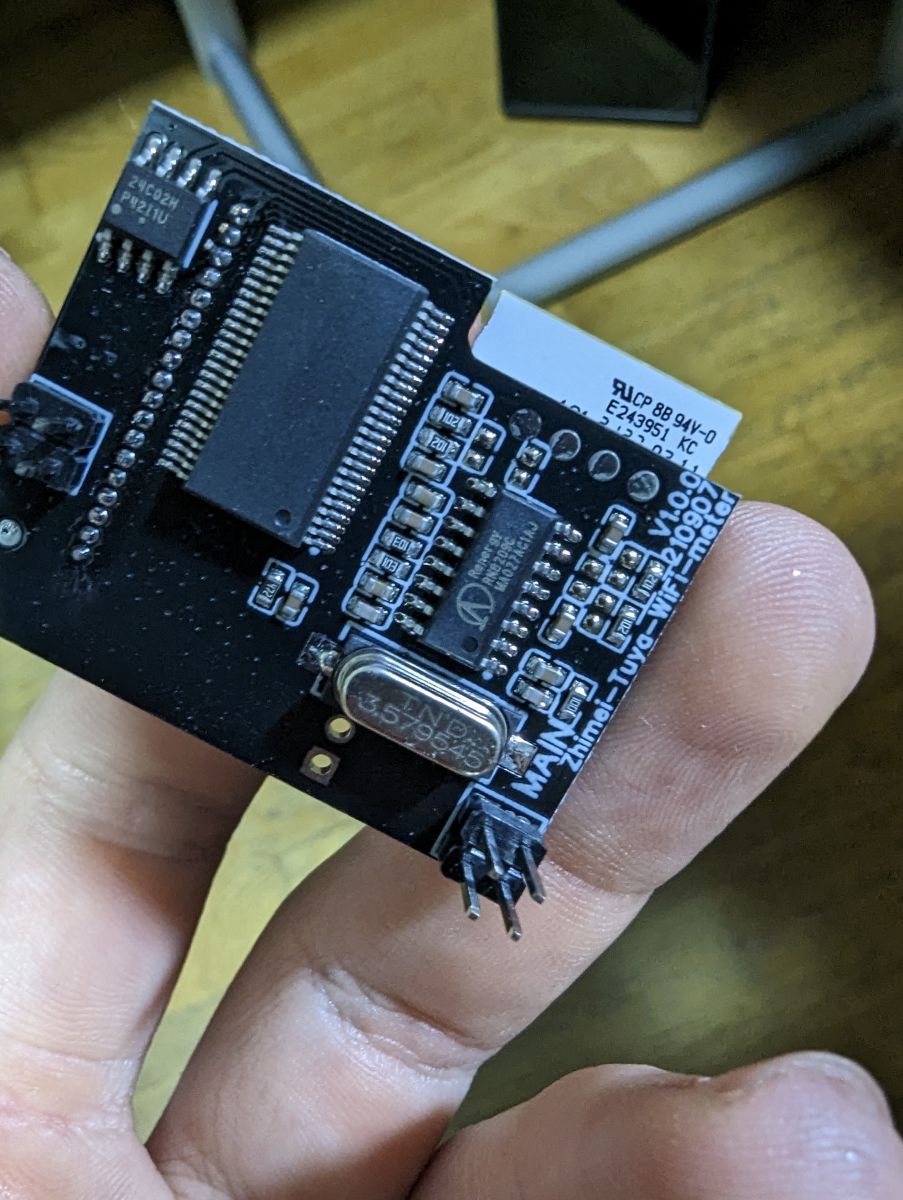

    Hello. Recently received new counters Zmai-90 with CBU module.
    When flashing the module, OpenBK was unable to start the module. Could not pick up pins (GPIO).
    An open access point is created, but no data appears on the LCD screen of the counter.
    All Zmai bought 09.2022, produced 06.2022.
    Attaching a photo of the counter, the CBU module.
    Who can help with GPIO for this counter, I will be very grateful!

    Hello @ghost198922 . Thank you for posting, this is a Zmai-90 version that I haven't seen before. I actually have one, but my one is WB3S-based (BK7231T) and not CBU (BK7231N).
    Zmai-90 with CBU module does not start after flashing. Could not pick up GPIO.
    Zmai-90 with CBU module does not start after flashing. Could not pick up GPIO. Zmai-90 with CBU module does not start after flashing. Could not pick up GPIO.
    Still, there should be no problem with that - OpenBeken already supports BK7231T, BK7231N, XR809, BL602, W800, W600 and T34.
    The only thing that the UART protocol is not yet implemented - but I think I can do it for you. can you wait, hopefully, several days? Maybe week, depends on amount on my free time and family matters.
    As said, I have this device at hand so I can look into it quickly.
    Question: do you have an original firmware backup?

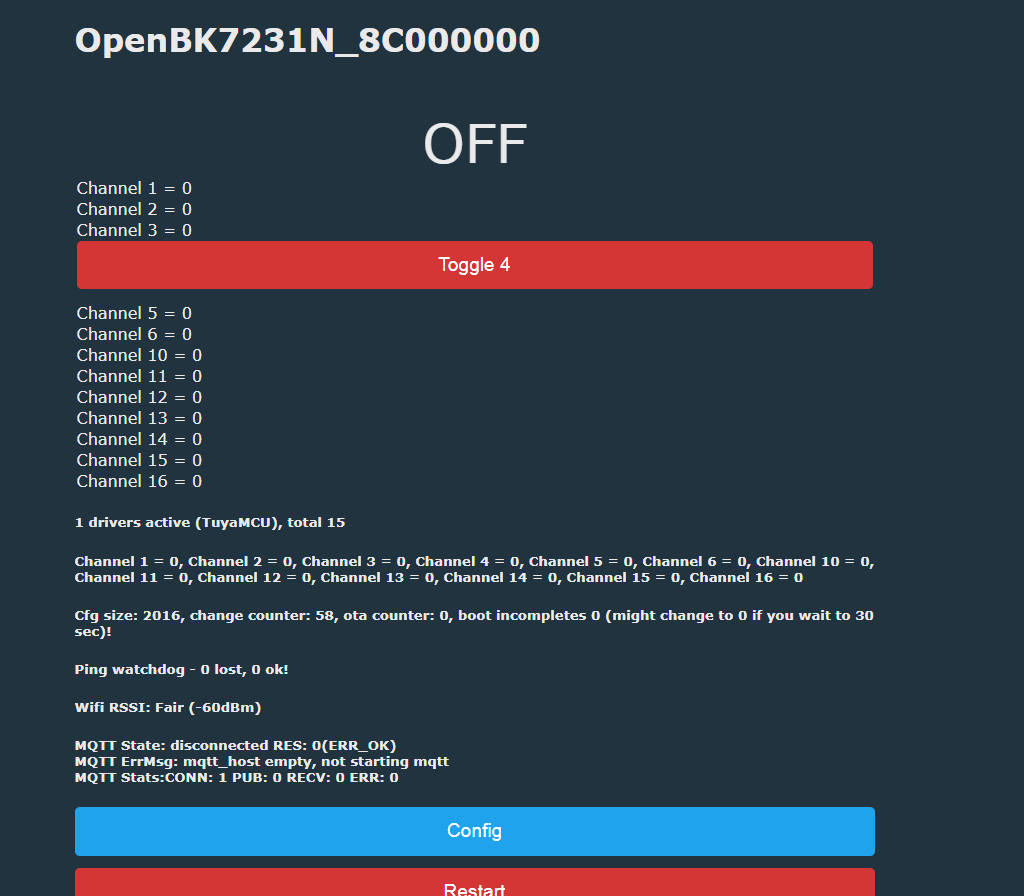

    Hi tried to create autoexec.bat file in LFS with code like this
    startDriver TuyaMCU
    setChannelType 1 ReadOnly
    linkTuyaMCUOutputToChannel 1 2 1
    setChannelType 2 ReadOnly
    linkTuyaMCUOutputToChannel 6 0 2
    setChannelType 3 ReadOnly
    linkTuyaMCUOutputToChannel 9 5 3
    setChannelType 4 Toggle
    linkTuyaMCUOutputToChannel 16 1 4
    setChannelType 5 ReadOnly
    linkTuyaMCUOutputToChannel 17 0 5
    setChannelType 6 ReadOnly
    linkTuyaMCUOutputToChannel 18 0 6
    setChannelType 10 ReadOnly
    linkTuyaMCUOutputToChannel 101 2 10
    setChannelType 11 ReadOnly
    linkTuyaMCUOutputToChannel 102 2 11
    setChannelType 12 ReadOnly
    linkTuyaMCUOutputToChannel 103 2 12
    setChannelType 13 ReadOnly
    linkTuyaMCUOutputToChannel 105 2 13
    setChannelType 14 ReadOnly
    linkTuyaMCUOutputToChannel 109 2 14
    setChannelType 15 ReadOnly
    linkTuyaMCUOutputToChannel 110 2 15
    setChannelType 16 ReadOnly
    linkTuyaMCUOutputToChannel 111 2 16
    The button does not respond, there is no data on the LCD counter.

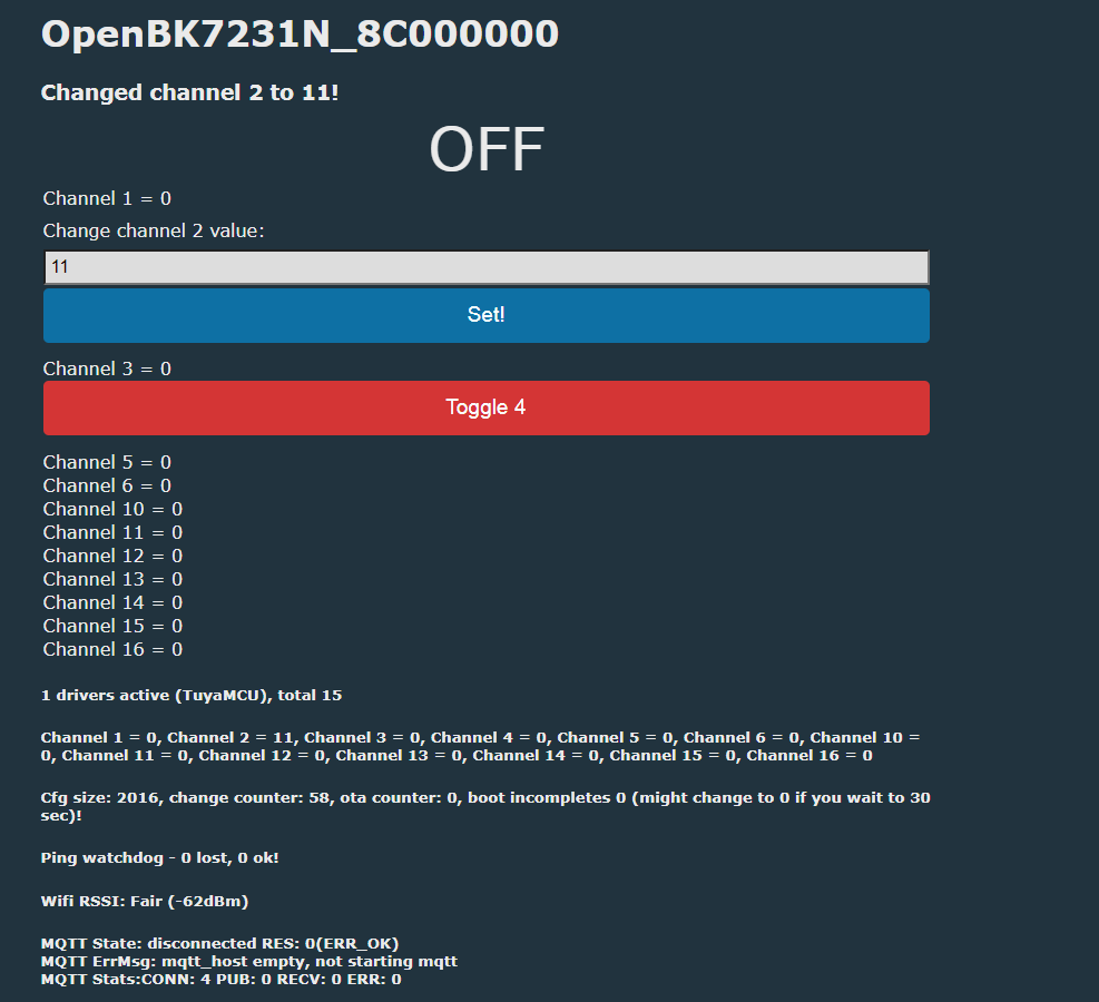

    Then I tried to enter commands, and send a number, the answer is below. The relay does not respond.
    setChannelType 2 TextField
    linkTuyaMCUOutputToChannel 9 4 2
    There is no data with the TuyaMCU flag in the logs.

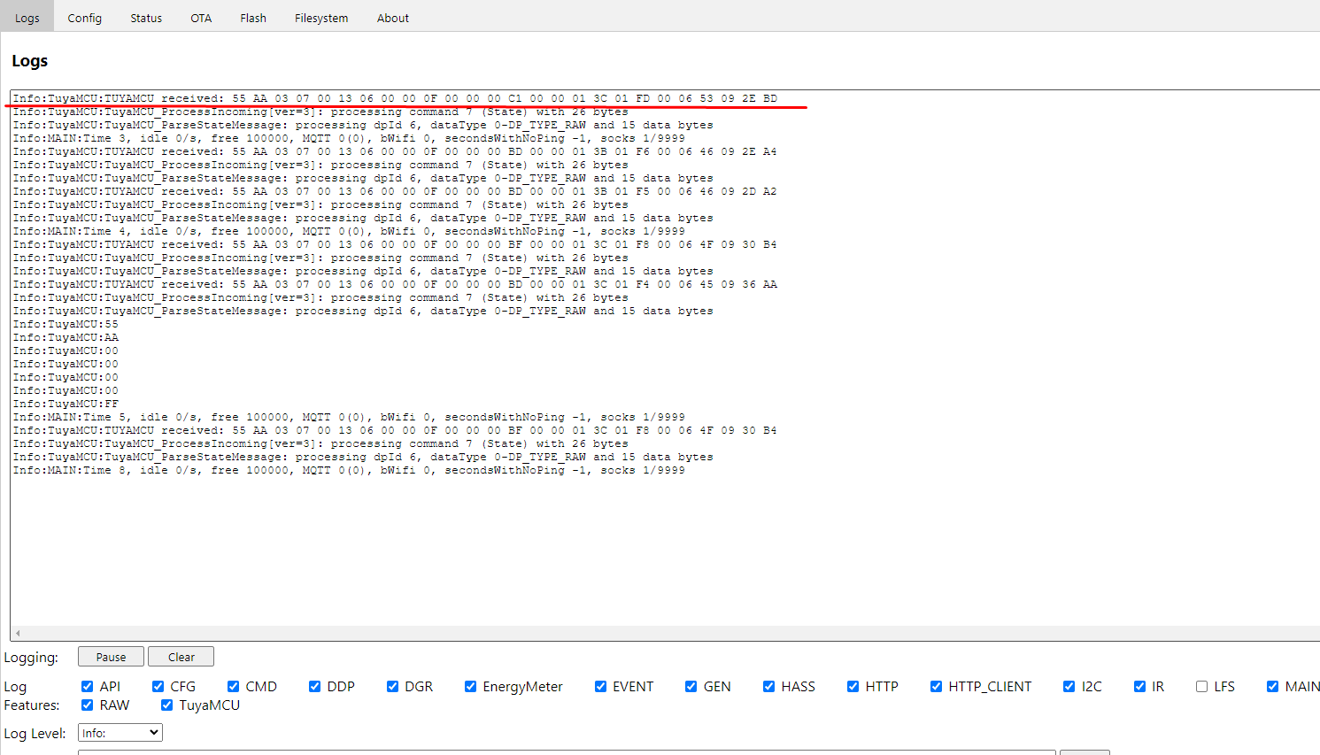

    In OpenBeken, when you go to Web Panel, and open Log, do you get messages like that:
    Like that:
    Info:TuyaMCU:TUYAMCU received: 55 AA 03 07 00 13 06 00 00 0F 00 00 00 BF 00 00 01 3C 01 F8 00 06 4F 09 30 B4
    is OpenBeken receiving any TuyaMCU packets?
  • Check whether OpenBeken receives TuyaMCU packets
    #10 20283620
    ghost198922
    Posts: 6
    Maybe let's do this slightly other way, just to be sure.
    Like that:
    There are no packets from TuyaMCU in OpenBeken in Web Panel, the TuyaMCU driver itself is running.

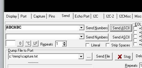

    Realterm has a very nice "capture to file" option.
    Once you do full TuyaMCU packets capture, then adding support will be very easy.

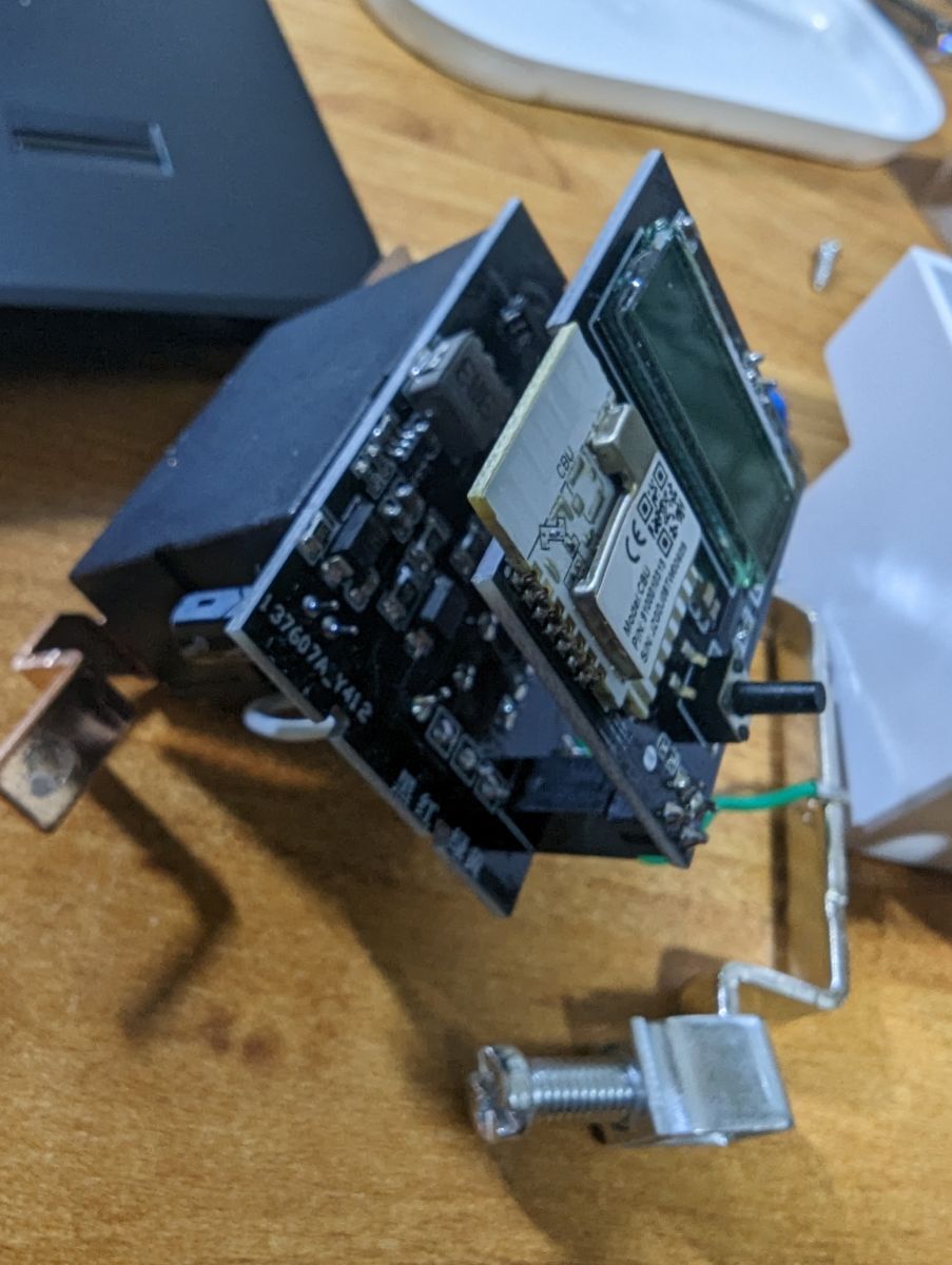

    Jinaria
    Posts: 21

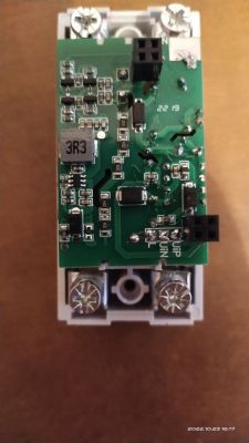

    I have some of the same DIN rail meter, with the same components, I managed to find some pins but faced a strange issue with the relay.
    Here are pins that I found so far:
    Wifi Led: Pin 6
    Button : Pin 7
    Relay: Pin 14
    Pins 15 and 17 connected to 24C02H EEPROM SCL/SDA (pin 5 and 6)
    Tripped OFF Led: Pin 26
    TX1 : Connected to Pin 13 of Renergy RN8209C Measuring chip (RX)
    RX1 : Connected to Pin 12 of Renergy RN8209C Measuring chip (TX)
    When I configured the relay pin, the first time I heard a relay click, after that there was no click at all and it just made a static noise when I turned the relay on! flashed the second one and the exact same thing happened.
    I am not sure how to get measurement data from RN8209C or how to save the measurement data to EEPROM, also the lcd controller chip has no marking, not sure how to control LCD as well.

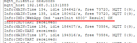

  • TuyaMCU still unresponsive after setting 4800 baud
    #18 20551799
    Jinaria
    Posts: 21
    Yes. Already tried that, but received nothing from the tuyamcu, In the log I have:
    ExtraDebug:TuyaMCU:TuyaMCU heartbeat_valid = 0, product_information_valid=0, self_processing_mode = 1, wifi_state_valid = 0, wifi_state_timer=0
    Then I noticed in the datasheet that the max baudrate for the rn8209c is fixed at 4800, so tried :
    startDriver TuyaMCU
    tuyaMcu_setBaudRate 4800
    tuyaMcu_defWiFiState 4
    but still nothing.

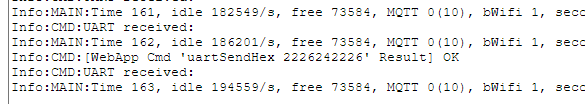

  • RN8209C RX stuck at repeating 0x24 0x22 0x26 pattern
    #24 20552966
    Jinaria
    Posts: 21
    I captured RX and TX @ 4800, analyzer software does not show anything.
    TX capture from RN8209C :
    000208D3FFFFFFFFDD0000CD0E00020BD0FFFFFFFFDD0000BA21000202D9FFFFFFFFDD0000BC1F00020ECDFFFFFFFFDD0000B724000208D3FFFFFFFFDD0000C01B000207D4FFFFFFFFDD0000BC1F000209D2FFFFFFFFDD0000B82300020AD1FFFFFFFFDD0000B922000212C9FFFFFFFFDD0000C417000209D2FFFFFFFFDD0000BB20000209D2FFFFFFFFDD0000B724000204D7FFFFFFFFDD0000B62500020BD0FFFFFFFFDD0000B82300020FCCFFFFFFFFDD0000C21900020AD1FFFFFFFFDD0000B823000207D4FFFFFFFFDD0000C11A0001F8E4FFFFFFFFDD0000C21900020CCFFFFFFFFFDD0000B62500020AD1FFFFFFFFDD0000C11A00020BD0FFFFFFFFDD0000B823000207D4FFFFFFFFDD0000BD1E00020CCFFFFFFFFFDD0000CA11000212C9FFFFFFFFDD0000C219000209D2FFFFFFFFDD0000C11A00020DCEFFFFFFFFDD0000BF1C000208D3FFFFFFFFDD0000B625000209D2FFFFFFFFDD0000BA21000204D7FFFFFFFFDD0000BD1E00020AD1FFFFFFFFDD0000B92200020AD1FFFFFFFFDD0000BC1F000210CBFFFFFFFFDD0000CC0F000203D8FFFFFFFFDD0000B625000206D5FFFFFFFFDD0000B82300020ECDFFFFFFFFDD
    RX capture from RN8209C :
    242226242226242226242226242226242226242226242226242226242226242226242226242226242226242226242226242226242226242226242226242226242226242226242226242226242226242226242226242226242226242226242226242226242226242226242226242226242226242226242226242226242226242226242226242226242226242226242226242226242226242226242226242226242226242226242226242226242226242226242226242226242226242226242226242226242226242226242226242226242226242226242226242226242226242226242226242226242226242226242226242226242226242226242226242226242226242226242226242226242226242226

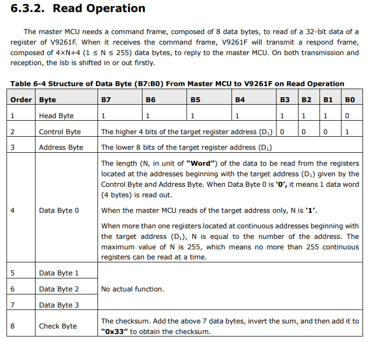

    I remember seeing that article about ZMAI 90 with a custom protocol:
    https://www.creationfactory.co/2019/12/reverse-engineering-zmai-90-din-rail.html
    but it's for V9261F:
    I don't think it's the same.
    It seems we will have to write a custom driver for that. Please disconnect UART capture, I will prepare an empty driver stub for you, then I will need you to connect it to mains and do some UART captures because we need to know which value is which. I will need you to:

    I did some tests and here are my new findings:
    - The relay is Bistable relay connected to pins P14 and P16, so to open/close the relay we should use Bridge driver:
     "pins": {
        "6": "WifiLED;1",
        "7": "Btn;0",
        "14": "BridgeREV;0",
        "16": "BridgeFWD;0",
        "26": "LED_n;0"
    The pulse length should be set to 5 using "BridgePulseLength 5" but at the moment it is not allowed to be set to any value lower than 50.
    - The LCD controller is connected to pins P9 and P28 but the controller has no marking.
    - The impulse Led connection seems to be controlled by the metering chip.

  • UART loopback test with uartInit 4800 and uartSendHex
    #30 20554660
    Posts: 14771
    Rate: 12914
    We have CH341 tutorial:
    https://www.youtube.com/watch?v=z9uLPo9QAY8
    Regarding UART testing, I will try to give you details what to do today or tomorrow.
    Added after 1 [hours] 41 [minutes]:
    @Jinaria please do this steps:
    1. update obk
    2. in console:
    uartInit 4800
    3. then to send something in hex, for example try:
    uartSendHex 2226242226
    and see if you are getting any replies
    Here is my test setup with Realtem:
    as you can see, the realterm receives bytes:
    of course, when i send something from realterm, i can receive it again on obk:
    My question now is - is the uart test system working for you and are you able to receive something back from the MCU by sending a bytes combination similar to 2226242226 on UART?
