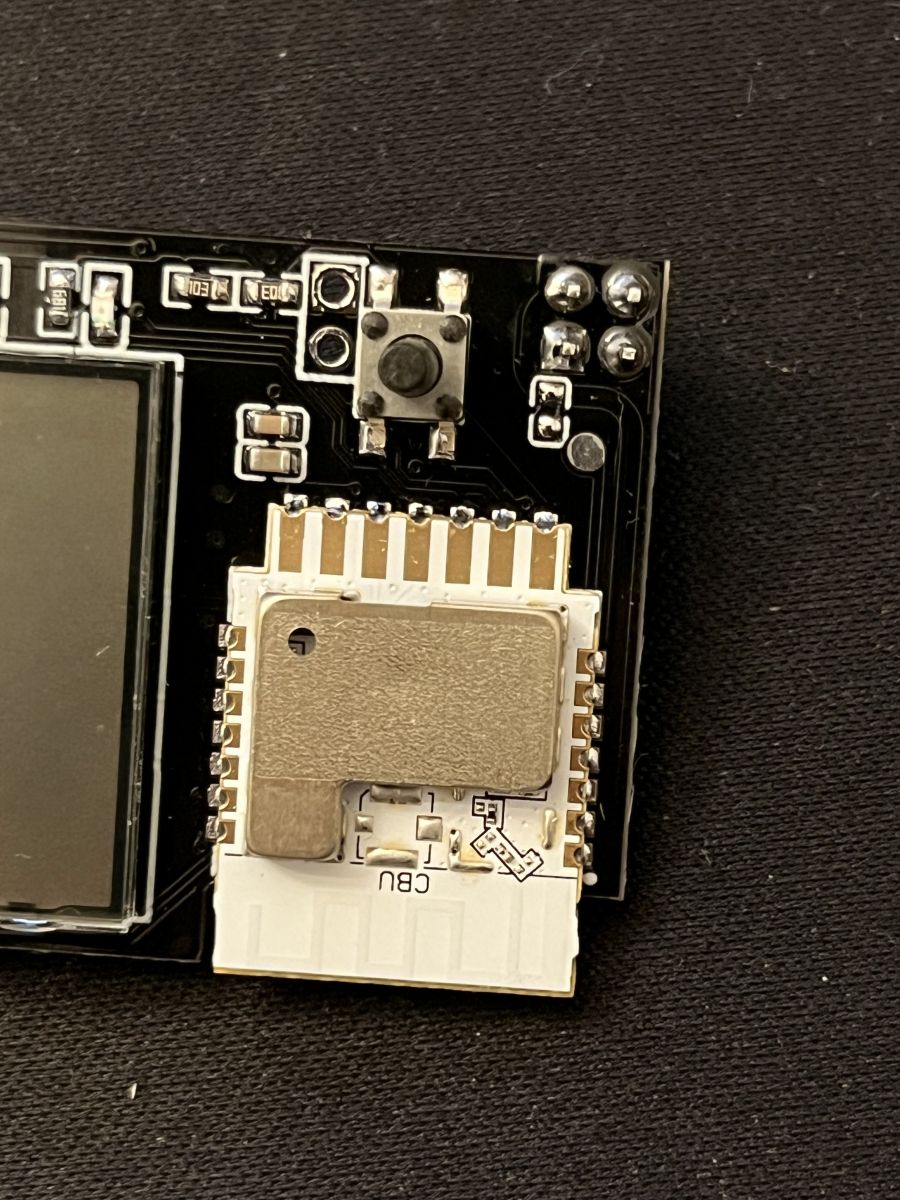

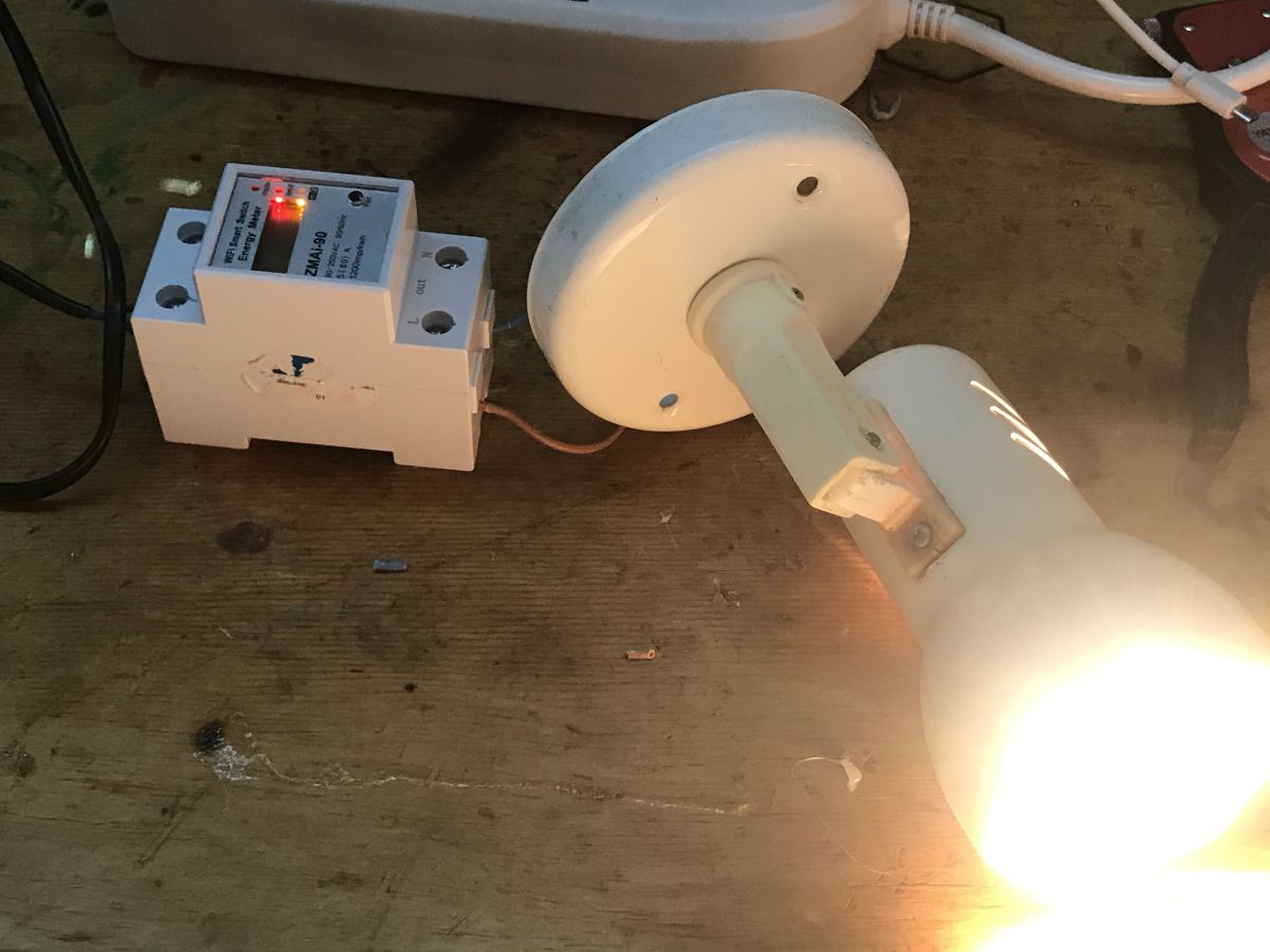

    Some time ago I acquired a ZMAi-90 smart energy meter to control energy consumption for a bunch of servers.
    This is a common device for Tasmota flashers: Link
    Since the beginning, I wanted to take control of the device locally from my LAN, removing cloud services completely. I actually found a few posts from around 2019 where people managed to flash Tasmota into them, when they used the ESP8266 chip. Thus, I decided to purchase a new one to try and flash it.
    For my surprise, these devices had been updated, and now come by default with a CBU using the BK7231N chip.
    Upon digging on the internet, I came by the OpenBeken project, which will literally save my life since this is now the only way to make these devices cloud-free without needing to resolder a new chip.
    I have all the tools, will provide quality pictures, and got 3 of these devices ready to break if needed just to get them fully working; but I do need some guidance, given that my experience with flashing and electronics is quite short and the information for every specific device seems to be very different.
    This guy did an incredible job of reverse-engineering all the connections between the WiFi board and the actual relay, to the point where even Tasmota included a patch to allow the mapping of the pins of this device. Thus, I was hopping some of the information he published in these posts will be useful, once the device is flashed, to facilitate the configuration:
    Part 1: Link
    Part 2: Link
    Part 3: Link
    Now, let's look at some pictures.

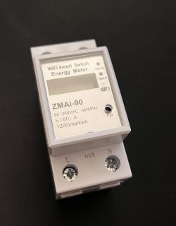

    The device from outside - a quite simple single-phase smart meter:
    Front view of the ZMAi-90 smart energy meter.

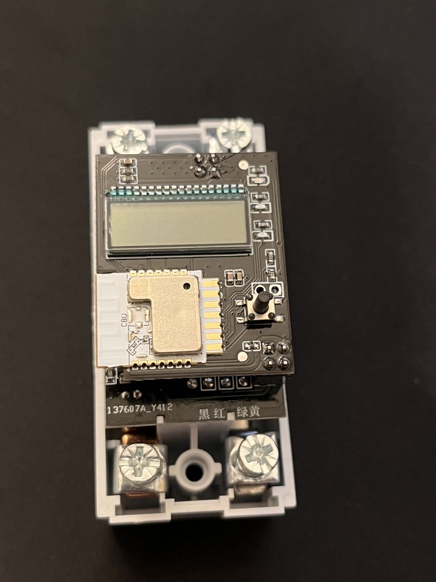

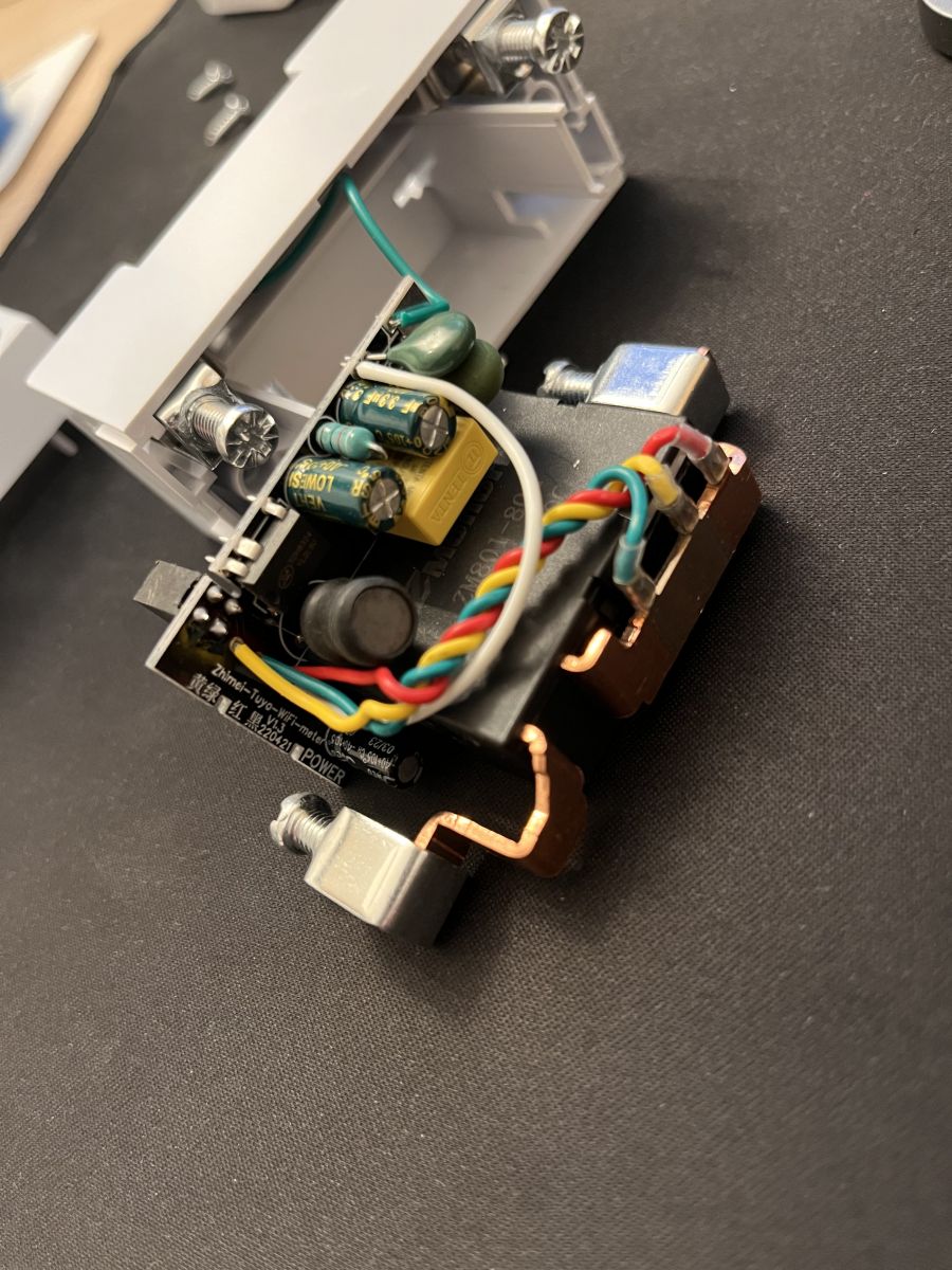

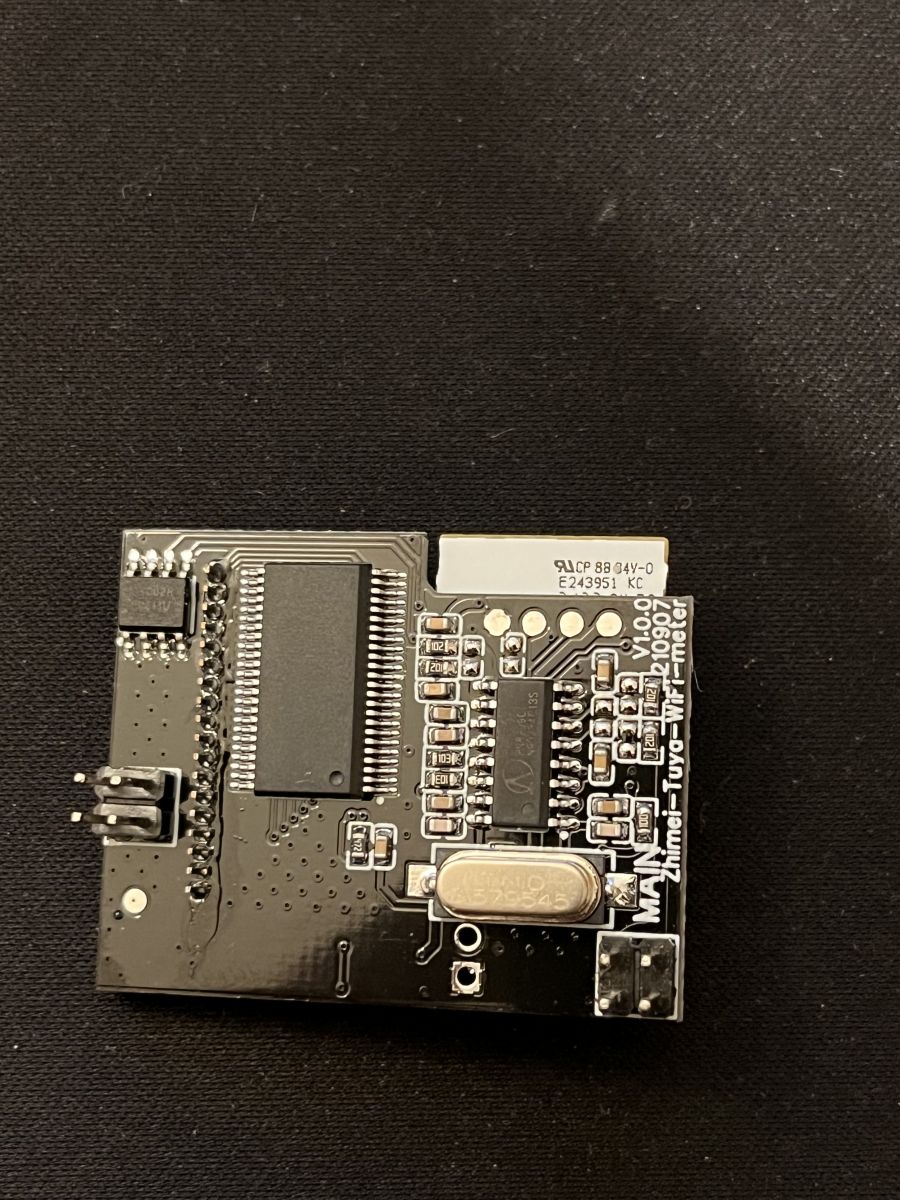

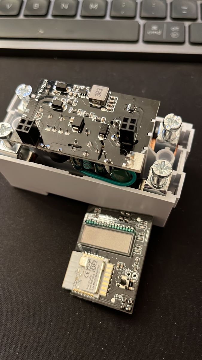

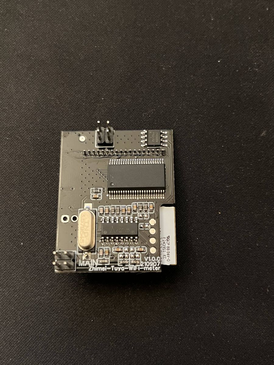

    Let's open it up:
    Top view of an open smart energy meter with visible circuit board.
    Open interior of a smart energy meter showing the relay board and other components.

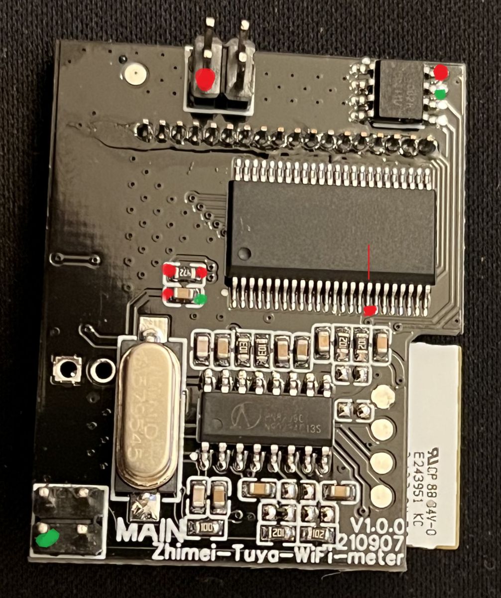

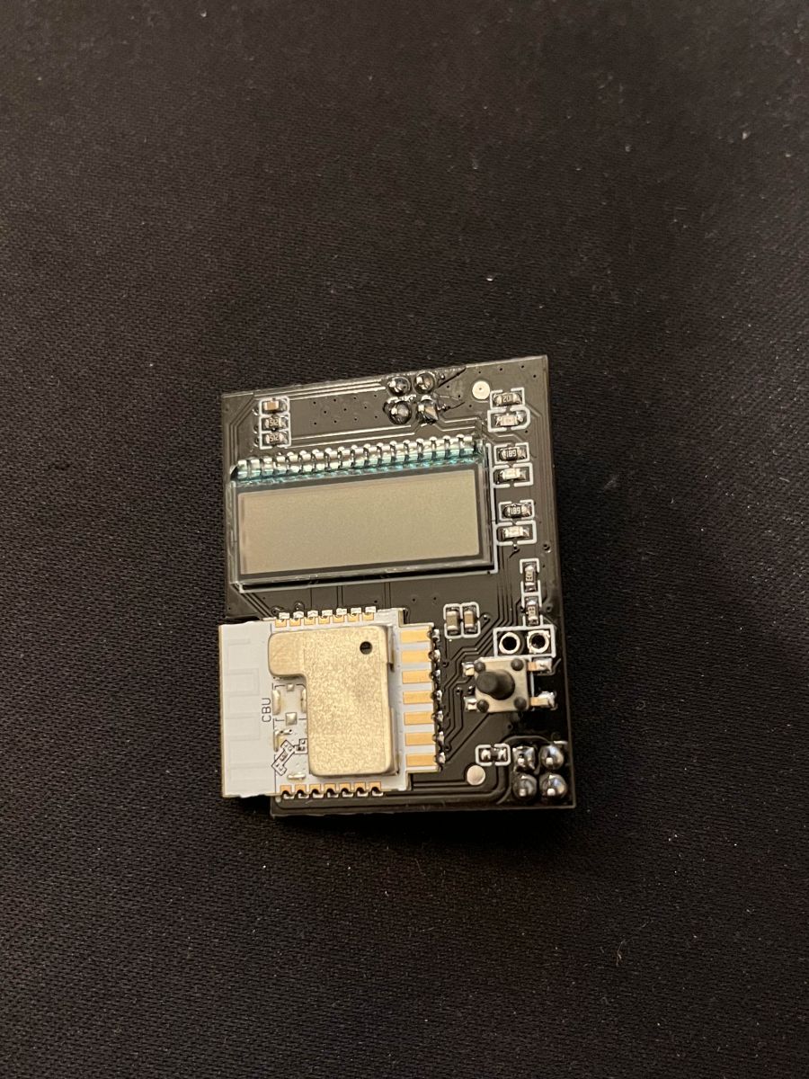

    Circuit board with electronic components on a dark background Printed circuit board of the ZMAi-90 smart energy meter on a black background. Circuit board inside the ZMAi-90 smart energy meter. Image of an electronic module with a visible button and CBU marking.

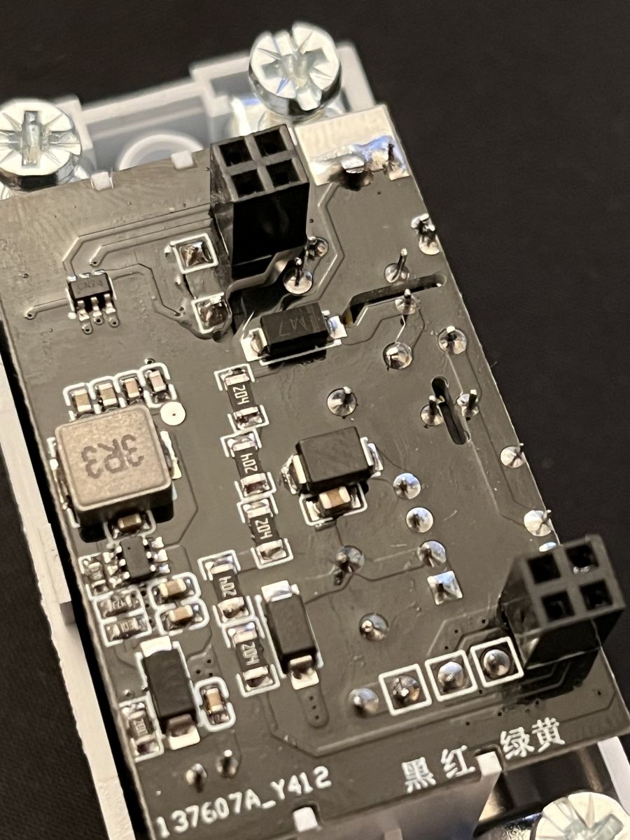

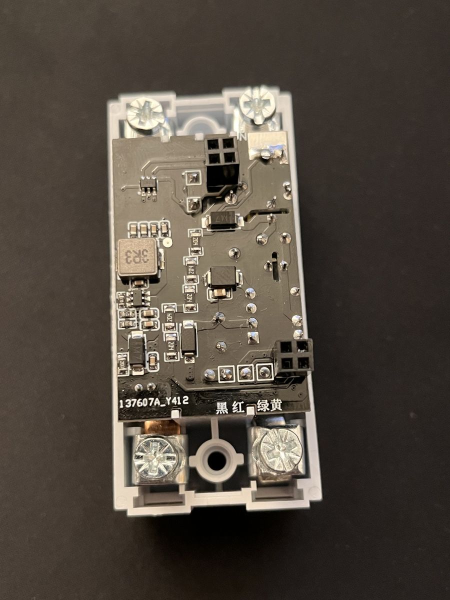

    The second board with the relay:
    Interior view of the ZMAi-90 energy meter showing the circuit board. Close-up of the circuit board of a smart energy meter with BK7231N chip. Image of the interior of the ZMAi-90 smart energy meter with visible electronic components.

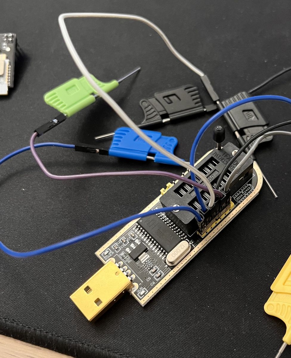

    And my flashing device with high precision grapples. I've also got a Raspberry that I can use for flashing:
    Programmer connected to a circuit using precision grabbers

  • Tracing UART pins to the RN8209C chip

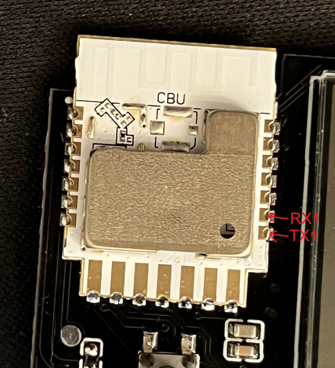

    So, where is UART port (TX1/RX1) of CBU connected? Does it connect to the MCU?
    Never done this before, but I guessed what you were asking could be achieved by running a 3.3V through a small speaker and see which points of the board closed the circuit (and made the speaker beep) with pins TX1/RX1. If this assumption is correct, my findings are as follows:

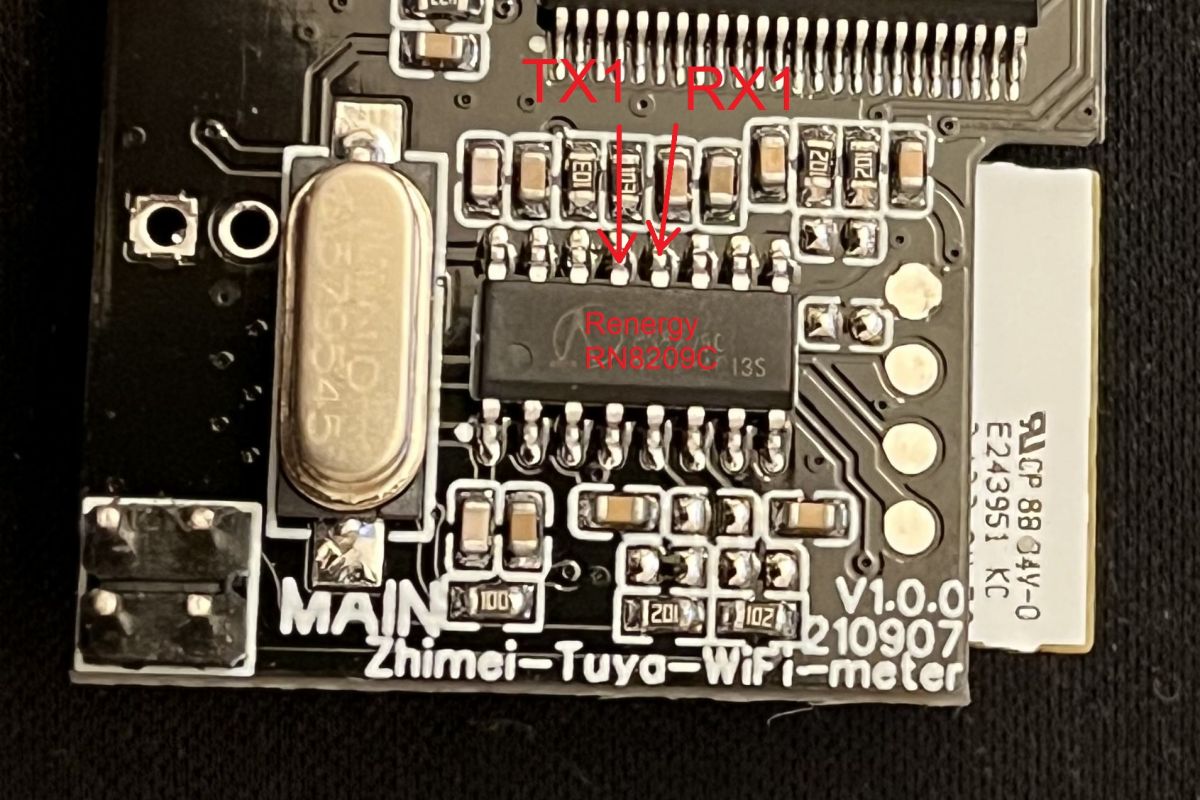

    These are the TX1/RX1 pins:
    Close-up of a circuit board with RX1 and TX1 pins marked.

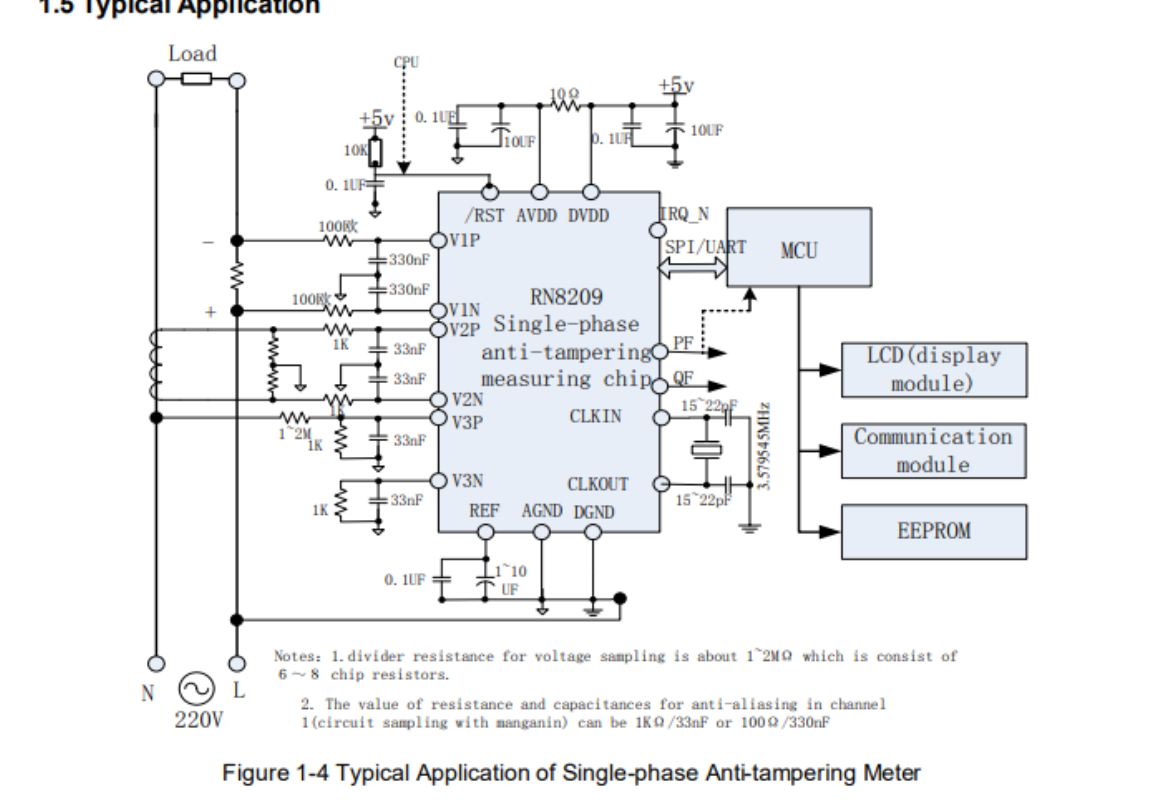

    They connect to these pins on the RN8209C chip
    Close-up of a PCB with the RN8209C chip and marked TX1 and RX1 pins.
    Other points where I have observed connectivity with both RX1 and TX1 pins on the RN8209C chip. Red is strong connection, green is weak (maybe resistor in path):
    Image of a circuit board with an RN8209C chip and red and green dots indicating connection points.
    Are you able to take a 2MB flash dump from that device for analysis?
    Given this new information, could you confirm where I need to solder/attach the cables to perform the dump? Will it work if I attach the cables to the pins on the RN8209C chip?

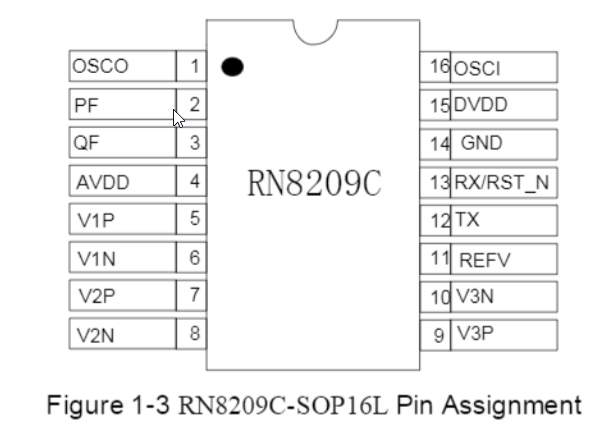

    I am a bit confused on how to take a 2MB flash dump from the RN8209C chip, since its pins don't align with the typical distribution of other chips I've used before like BIOS ones. Any tips for this?
    Pin assignment diagram for RN8209C chip in SOP16L package

    Flash dump should be taken from the WiFi module, so we can restore to Tuya firmware in case that something goes wrong. We do not flash the MCU itself. OpenBeken should be able to communicate with the MCU if TuyaMCU is used. If not, we can try to implement the required protocol...
    CBU is very similiar to CB3S/CB2S, you can look on our channel for CB2S tutorials: https://www.youtube.com/@elektrodacom

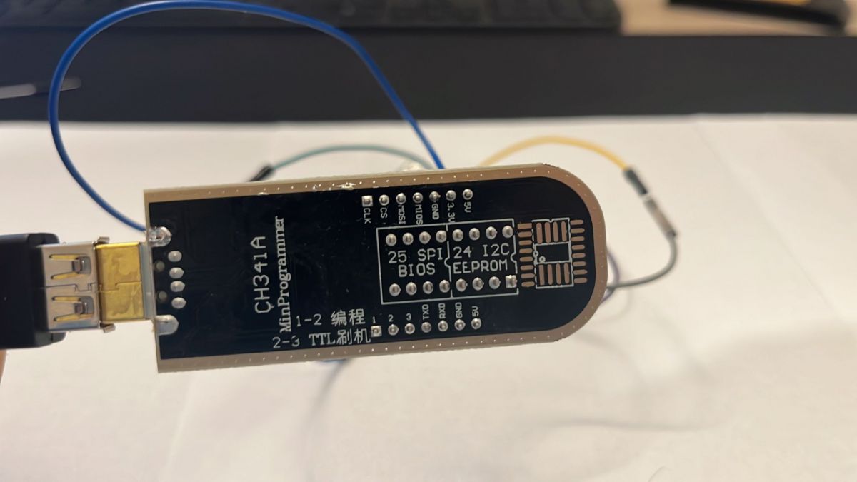

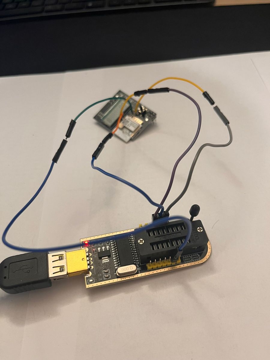

    I was using bk_writer1.60 and following the instructions on this video: Link
    Nonetheless, I wasn't using the same USB-UART device as in the video, but a CH341A programmer. CBU TX1 pin attached to USB-UART RX, CBU RX1 pin to USB-UART TX, and GND + 3.3V. That's it.
    Didn't detect anything when clicking "read", and then tried to use the TX/RX pins on an Arduino to read raw bits, but the CBU did not emit a single bit through the TX pins.

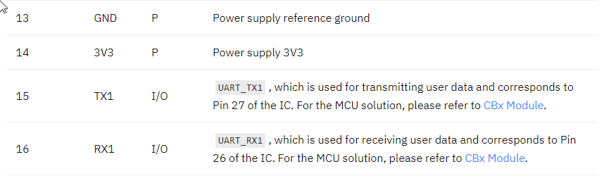

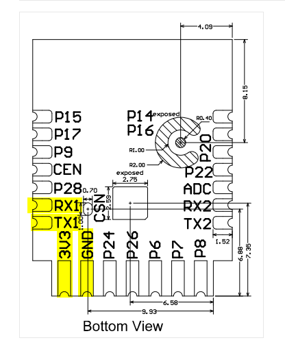

    Yes, I was following that procedure exactly. Using the following pins:
    Bottom view diagram of an electronic module with highlighted pins 3V3, RX1, and GND.
    Segment of a table with information about pins: GND, 3V3, TX1, RX1.

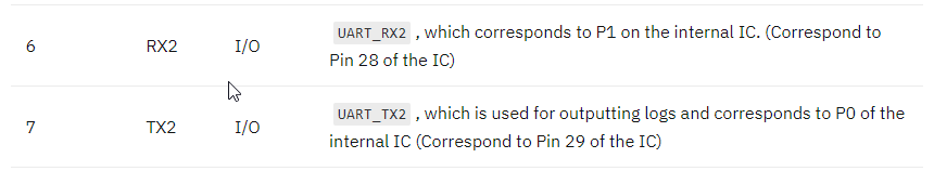

    There are also these other pins that I didn't try:
    Screenshot of a table describing RX2 and TX2 pins and their functions.
    I will try the new software next.

    TX2 is only for debug log output. TX1/RX1 is for both flashing and TuyaMCU

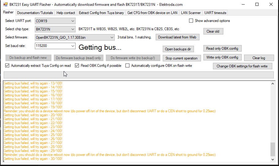

    No luck. I tried both on/off and shorting CEN.
    Screenshot of BK7231 Easy UART Flasher software with error messages at the bottom.

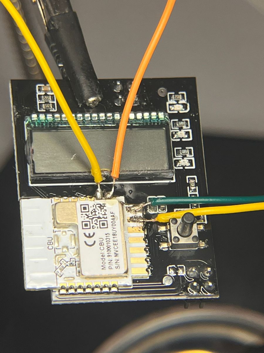

    Close-up of a PCB with yellow, orange, and green wires connected. Electronic circuit with a PCB connected to a USB adapter. CH341A programmer with visible pin labels on a black PCB.
    Is it possible that the other chip on the board is preventing communication on TX1?

    Posts: 14754
    Rate: 12875
    Is the other chip still on the same board? Do they connect via UART1, namely RX1 and TX1?
    It is very often the case that the other chip connected via UART blocks the programming. I had to cut the traces or desolder the chip many times just to get the flashing to work. You should check now with multimeter whether RX1/TX1 is still connected somewhere on that board.

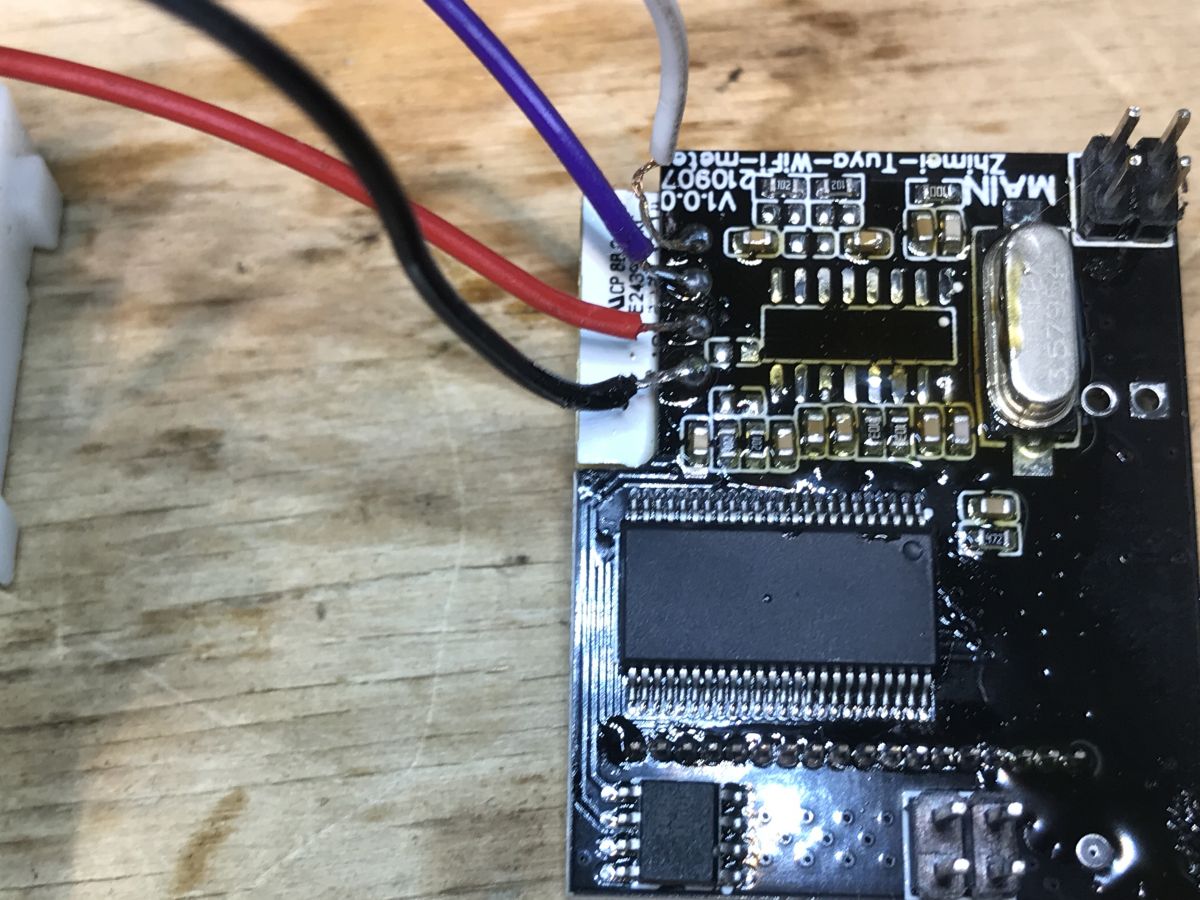

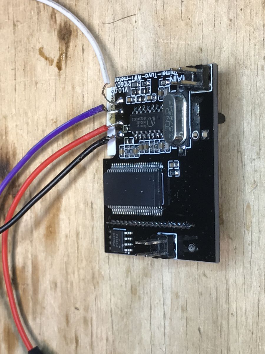

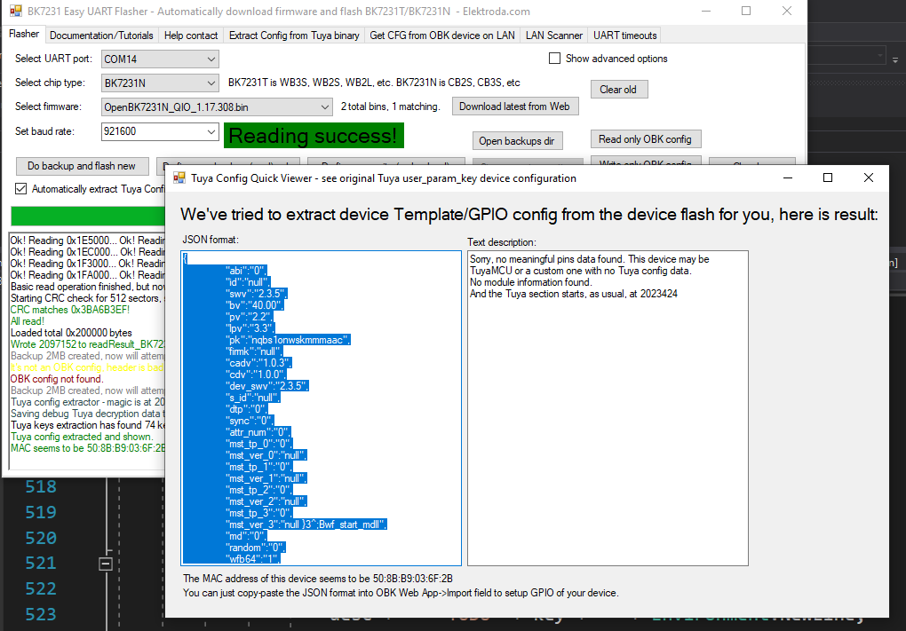

    Package from OP arrived so I am trying to investigate this device.
    There is GND, RX, TX and VDD on the pads:
    Photo of an electronic module with several connected wires.
    I can read flash BUT ONLY by using a trick - short VDD from the WiFI module side to GND and then leave it floating, it will still read:
    Screenshot of BK7231 Easy UART Flasher tool showing successful data reading.
    I can't flash with my trick, and I can't reset the RN8209C because it's RST is on RX... to flash, you need to desolder RN8209C:
    PCB board with visible electronic components and connected wires.
    2MB backup attached.
    • readResult_BK7231N_QIO_zmai90-2023-29-11-14-21-22.zip (1006.71 KB) You must be logged in to download this attachment.

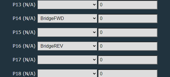

    P6 (PWM0) is a WiFiLED
    Added after 7 [minutes]:
    P26 (PWM5) is Tipped LED
    there is a bridge relay somewhere, I heard it click when I randomly toggled pins, it requies two gpios
    P16 is one of bridge relay pins
    P14-P16 is a bridge relay pair

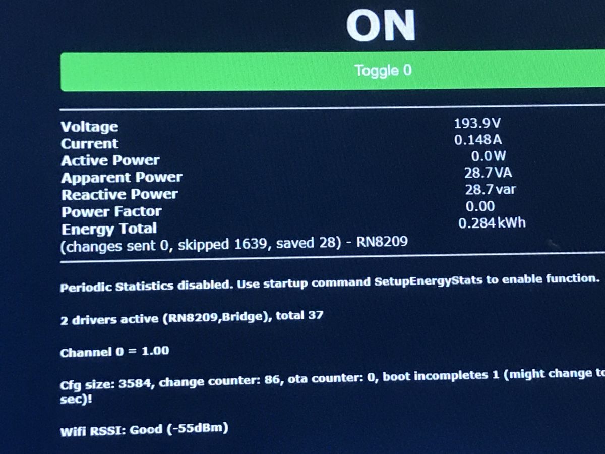

    yes, relay works:
    Screenshot showing GPIO pin settings on a device.

    thebeardeddragon wrote:
    So, was I doing it wrong by using the TX1/RX1 pins on the other side of the board, or is it the same as the pins you used?
    The RX1/TX1 on the other side of the board are the same that are on CBU.
    I used a so-called "trick" or "hack" to read flash, I connected GND, TX, RX VDD to my USB to UART converter and 3.3V LDO, and on flash tool I started read flash, and then I shorted WiFi module VDD to GND to force-discharge capacitors and then I left VDD floating, but it still has read flash, it's the same thing that EEVBlog shown here:
    EEVblog #831 - Power A Micro With No Power Pin!
    I did it because it allowed WiFi module to power but left MCU unpowered. Otherwise MCU would interfere with flashing.
    Still, don't try that, it failed for OBK write anyway, most likely because flash write requires more current
    Also, funny that you need to unsolder the RN chip... is there no way around this?
    I had to desolder RN because it's connected via UART to WiFi module. As said above, I managed to trick-read flash without it, but I was not able to write new firmware that way.
    RN has to be desoldered because it RST_N is on RX anyway, so you can't put that in RESET state without blocking UART, sorry.
    As a final question, I see you figured out a few LED connections and the relay function, but what about the power metering (total power consumed and current W)? Is that going to work with OpenBK, or not?
    I am afraid it's going to take some time, here's how this device made:
    Schematic of RN8209 single-phase energy measurement application.
    I will investigate PCB now to determine the connections, but it seems a custom driver will be needed for the LCD and power meter.

    Here is a draft of the most important connections:
    Connection diagram between 24C02, CBU, and RN8209C circuits.
    I will try to support the power meter, but it will require writing a driver from scratch.

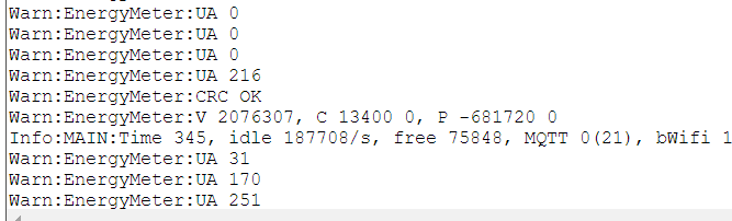

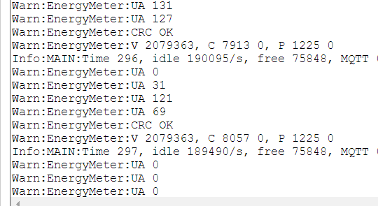

  • Implemented RN communication with CRC read operation
    #28 20840241
    Posts: 14754
    Rate: 12875

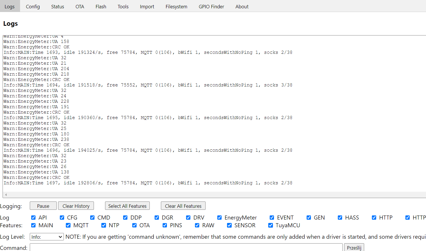

    GPIOs as template:
    Added after 2 [hours] 11 [minutes]:

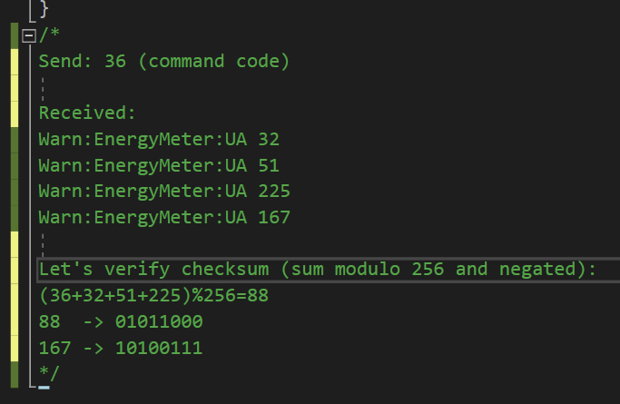

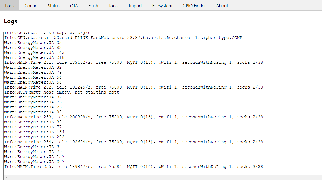

    Trying to communicate with RN...
    Screenshot of smart home application logs.
    Verification:
    Console with error messages and checksum calculation
    checksum matches!
    Added after 2 [hours] 29 [minutes]:
    @thebeardeddragon ok I implemented read operation with CRC:
    Screenshot of an IoT device management application log panel, showing various warning and informational messages.

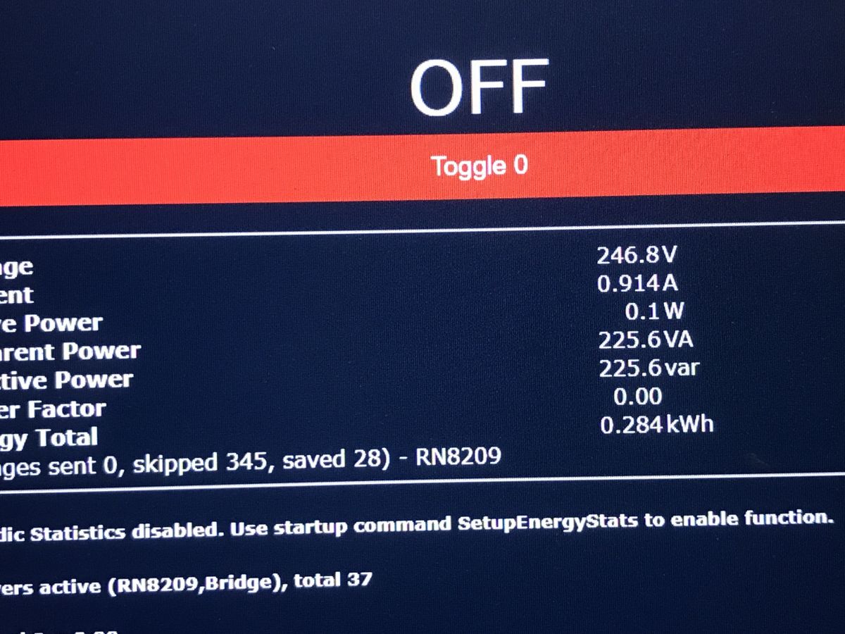

  • #29 20842263
    Posts: 14754
    Rate: 12875

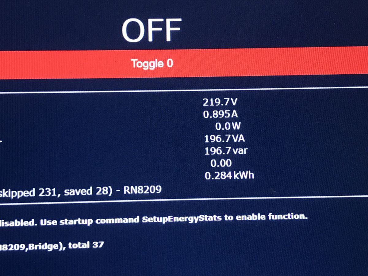

    Without load:
    Screenshot showing log data from an energy meter test.
    With 60W bulb:
    Screenshot of energy meter test results.
    Test setup:
    Electrical energy tester connected to a glowing light bulb on a wooden table.

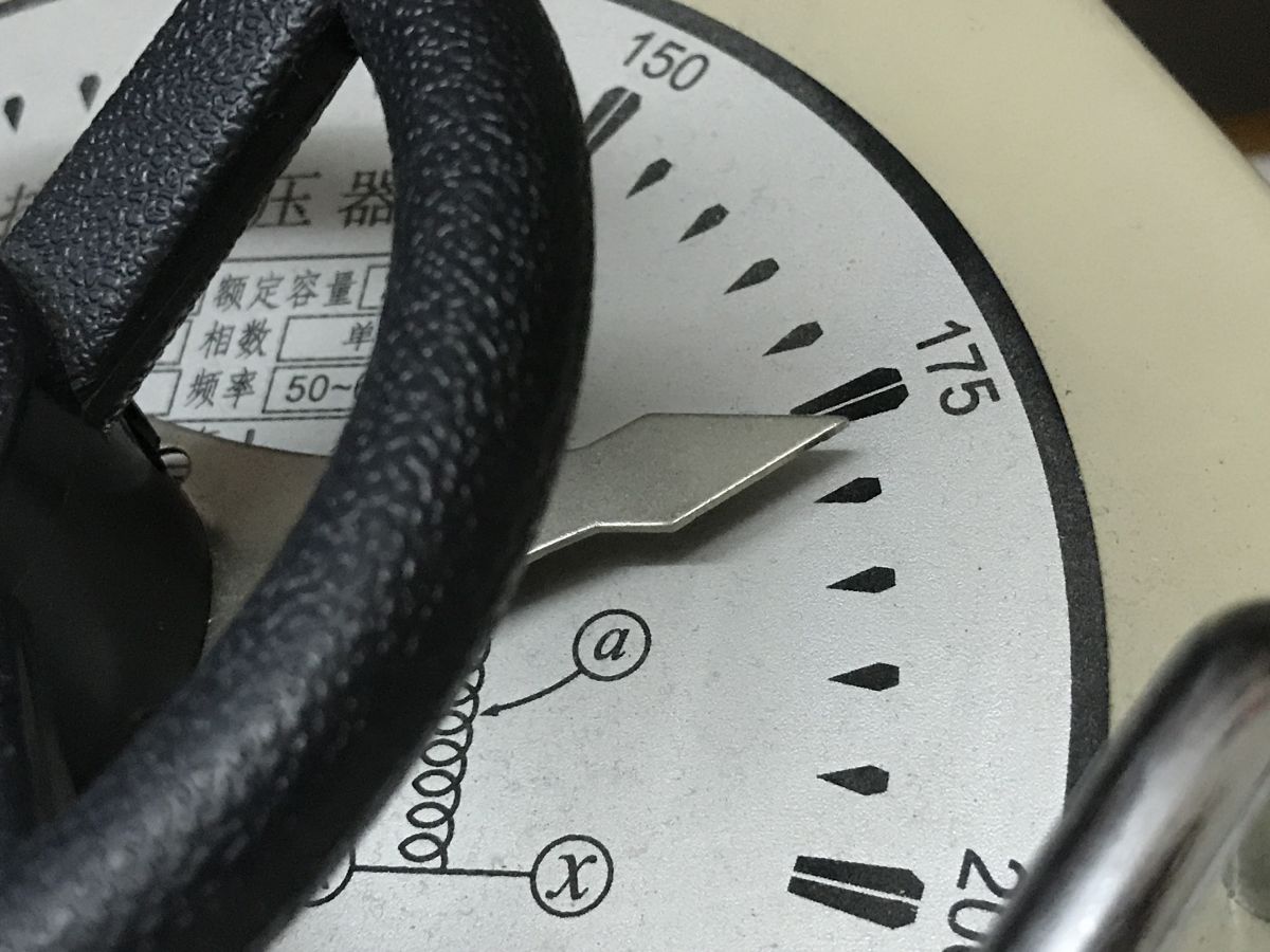

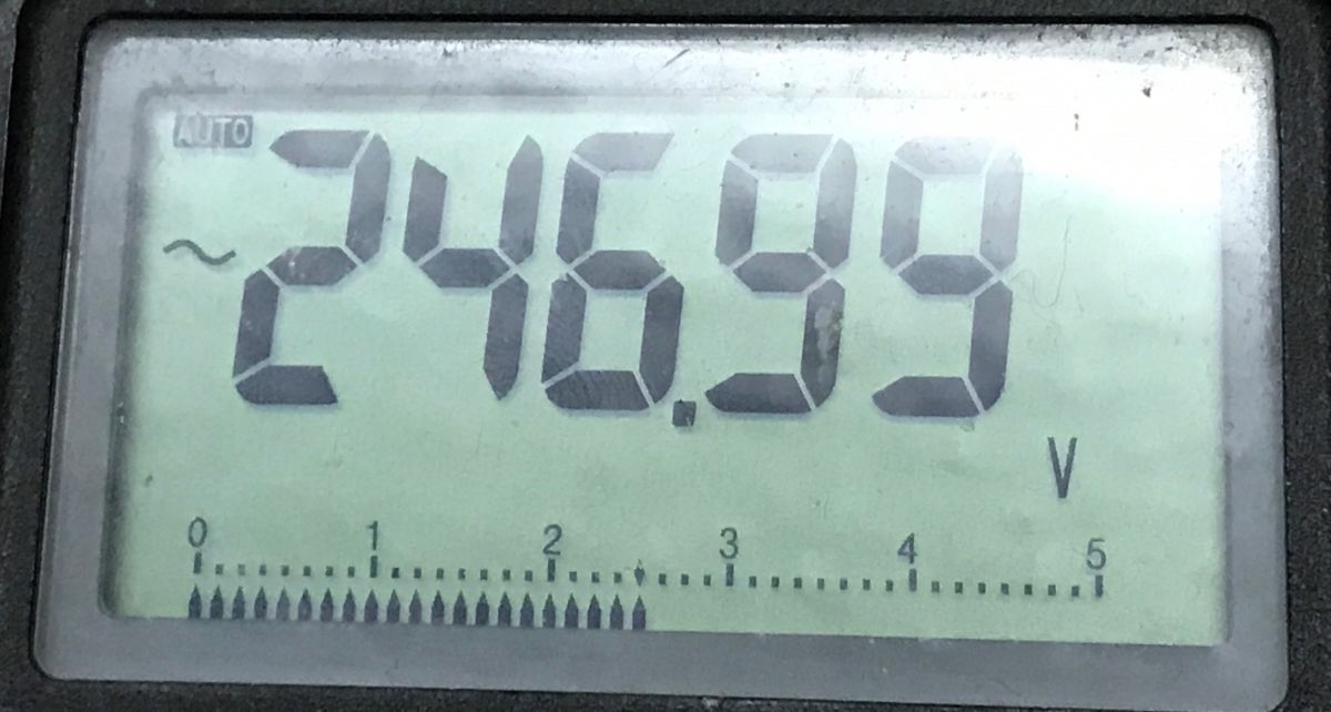

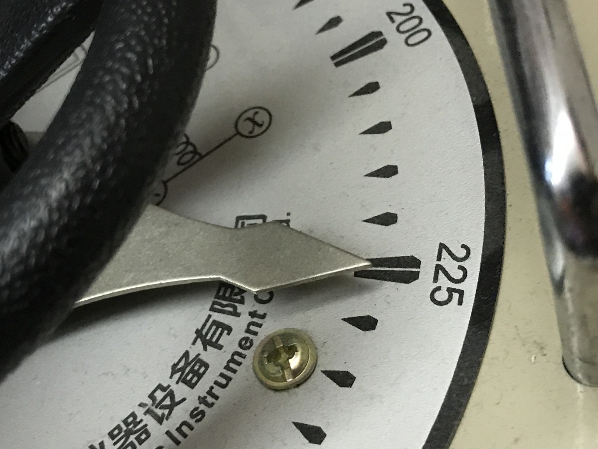

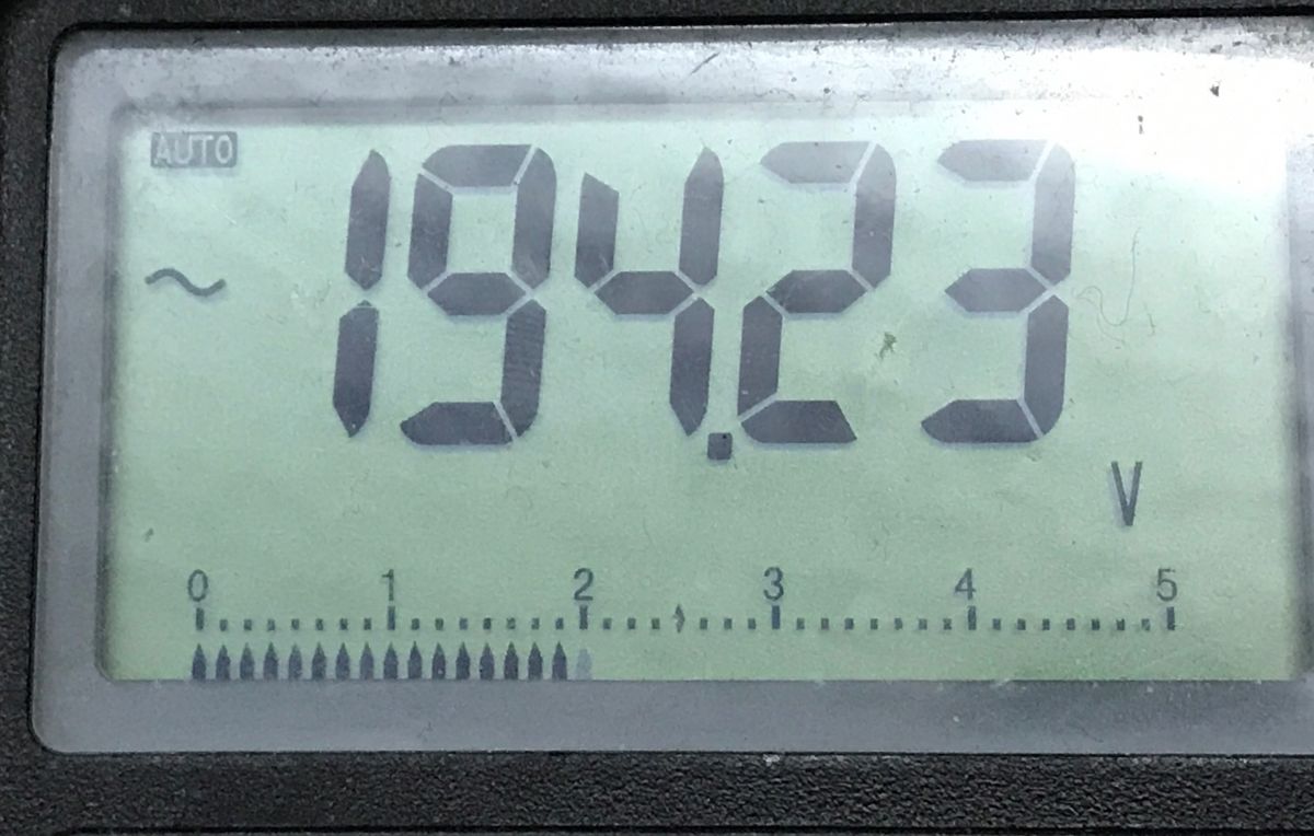

  • Autotransformer test at 220V, 247V, and 194V

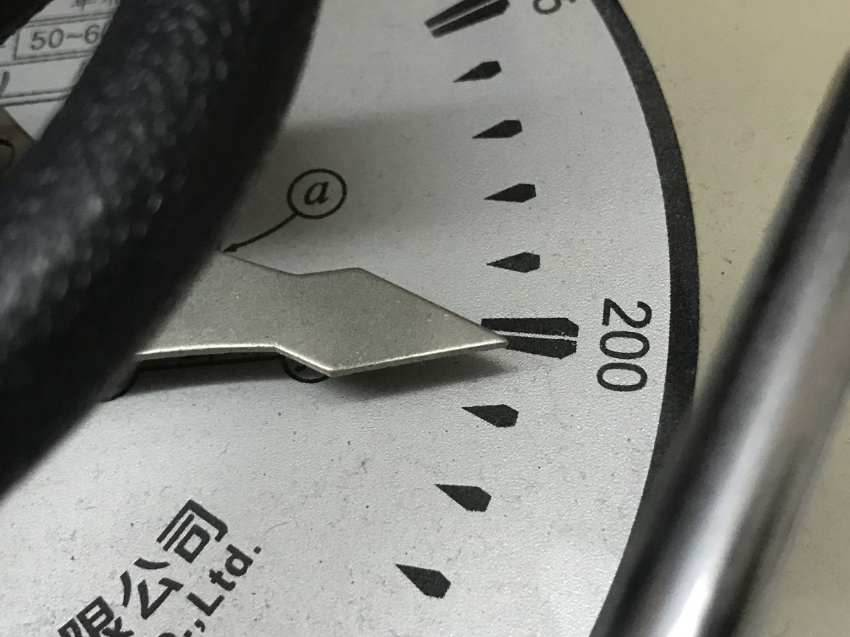

    #30 20850811
    Posts: 14754
    Rate: 12875
    Autotransformer test, 220V:
    Screen displaying parameters of an autotransformer test with voltage at 219.7 V. Close-up of an autotransformer gauge indicating voltage at 200V. Display of a meter showing a voltage reading of 220.32 V.
    247V:
    Display showing autotransformer test results with voltage and power values. The needle on an autotransformer gauge showing a voltage reading around 225V. Multimeter display showing a voltage of 246.99 V.
    194V:
    Display showing electrical parameters during autotransformer test. Close-up of an autotransformer meter gauge showing a reading of 175V. Multimeter display showing a voltage of 194.23 V.
