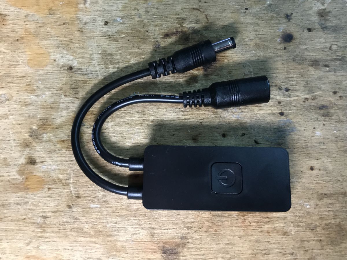

    I will show here the interior, programming, and configuration of the single-color Tuya WiFi strip controller sold under the AIP-Future (Smart Series) / SmartLife logo with the designation TY-02-1CH. The strip works on voltages DC5-24V, current (according to the manufacturer) up to 6A. By the way, we'll see what transistors are inside.
    The controller can be purchased in various places on the web, also on the Polish shipping portal, it costs PLN 40 here:
    [BK7231T] TY-02-1CH AIP-FUTURE WiFi single color WiFi LED strip WB3S
    The belt was given to me by one of our users so that I could change the batch - after programming the belt returns to the user. Thank you for providing me with the device to take tests and photos!
    Specification, types of plugs (both are classic DC Jack, dimensions below):

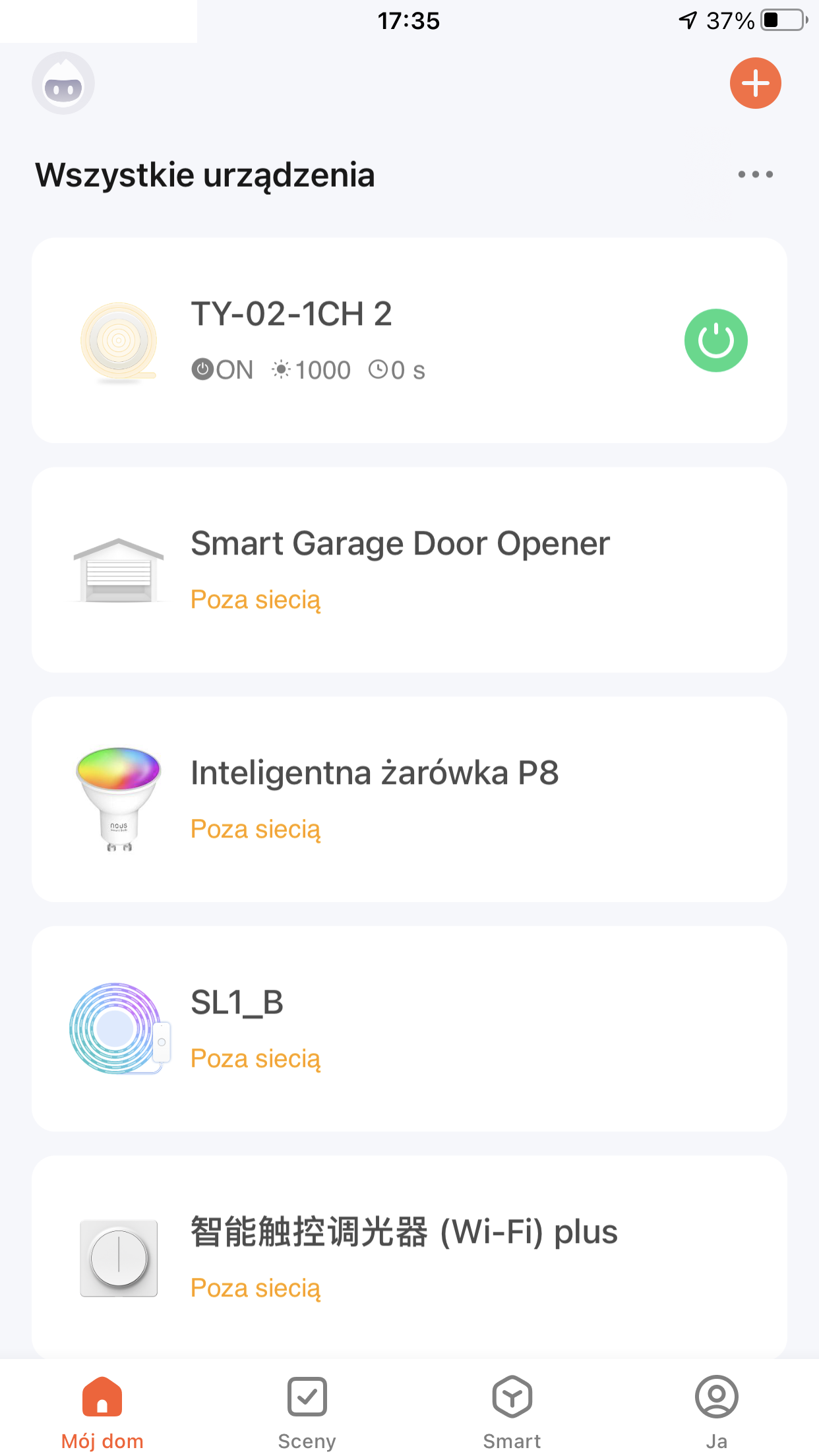

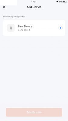

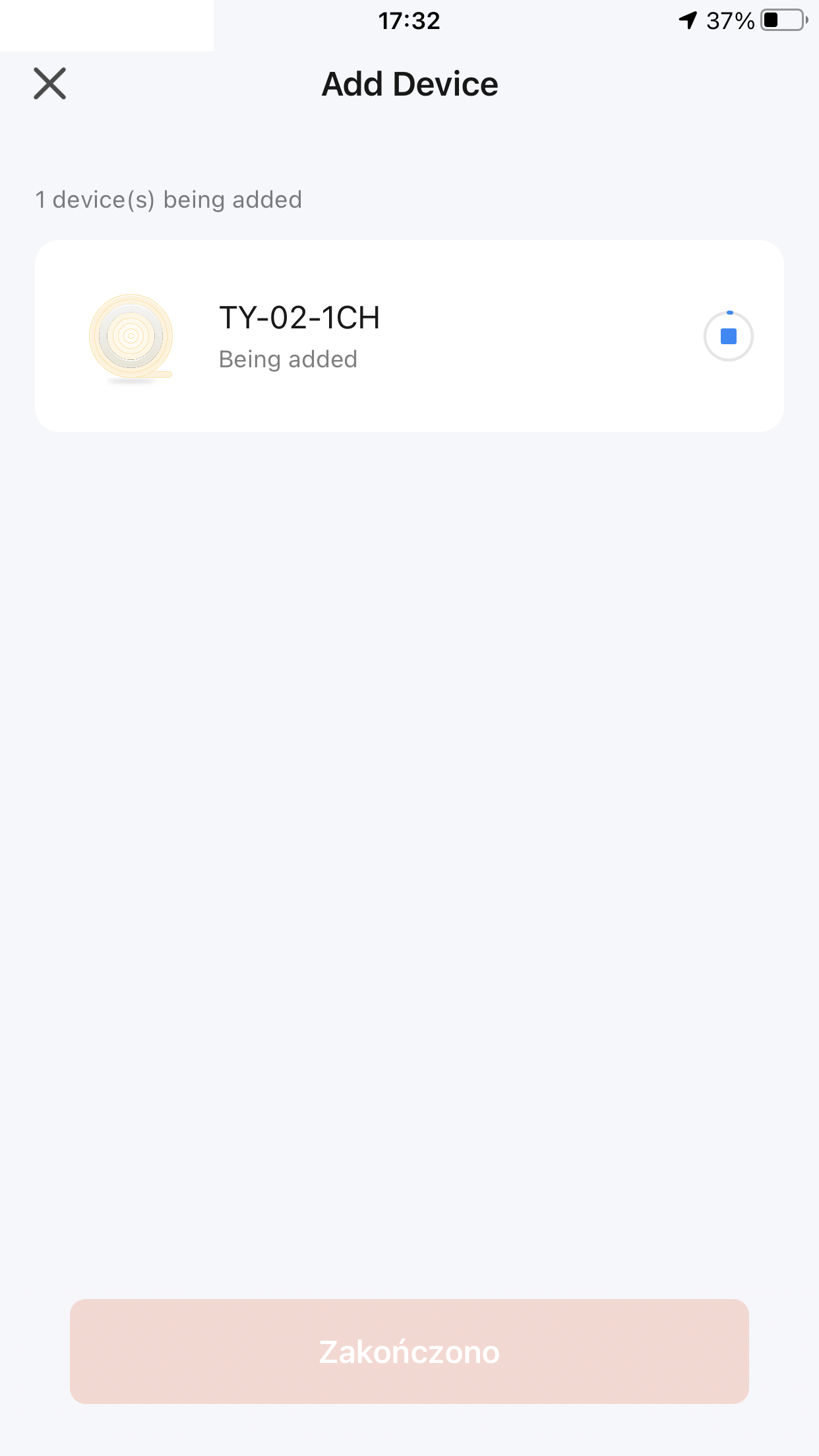

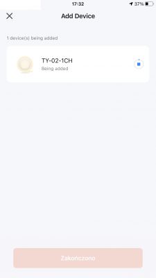

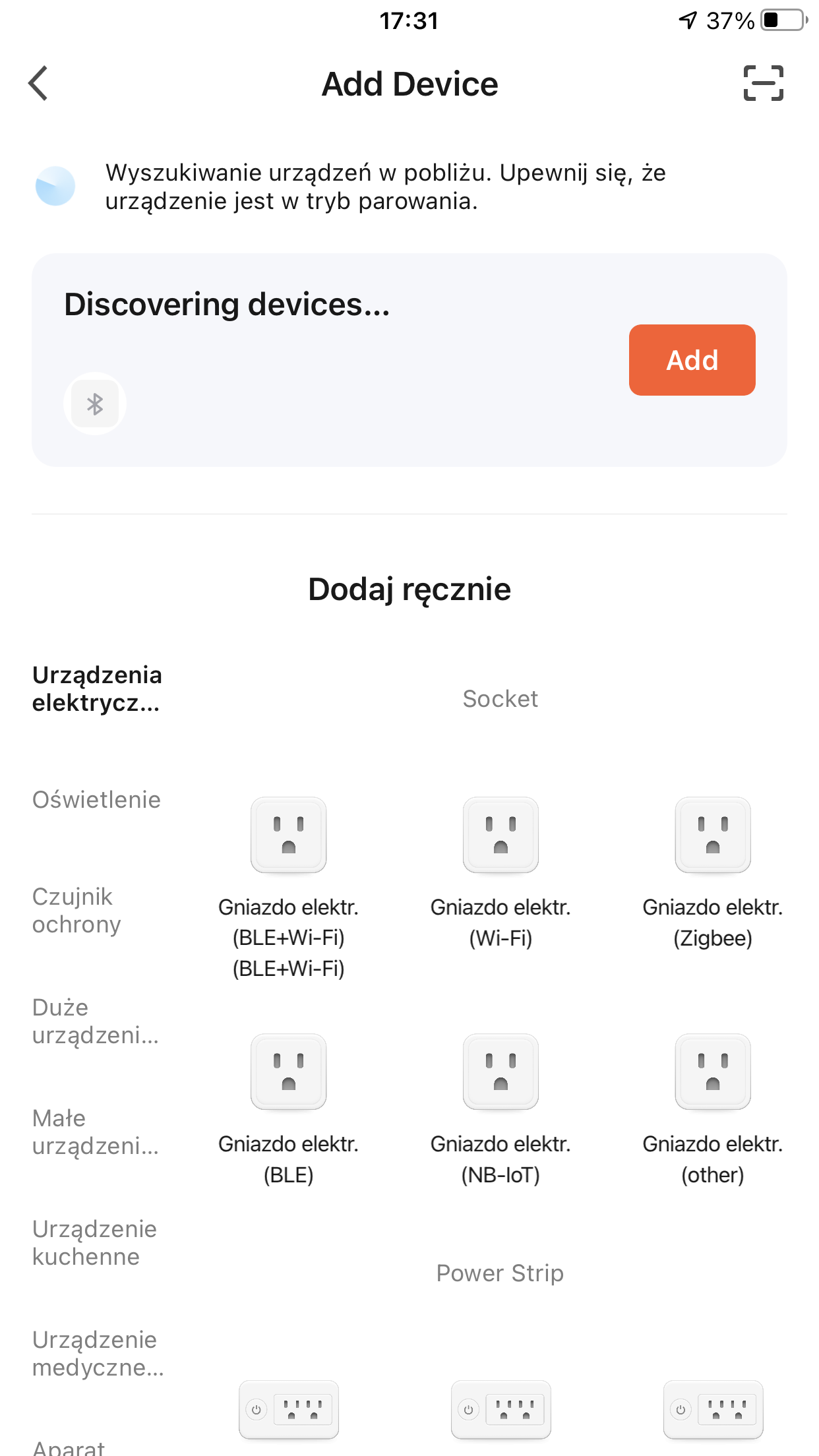

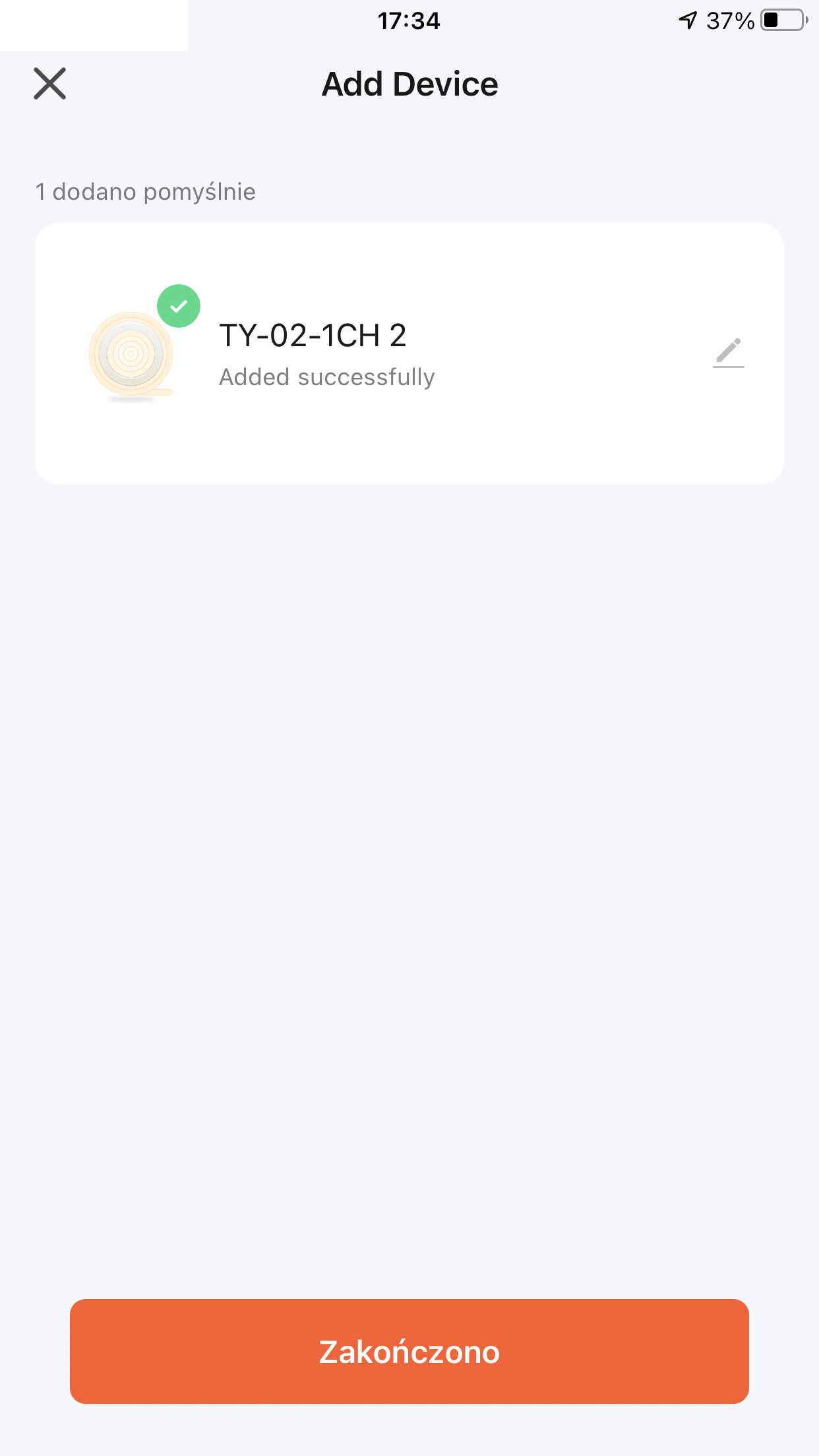

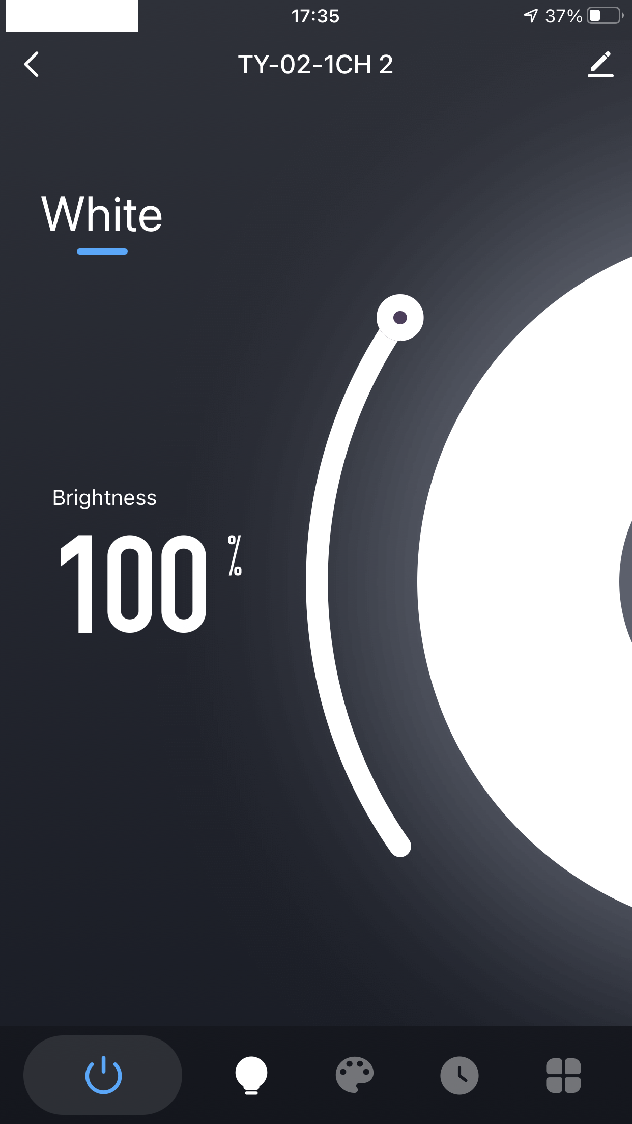

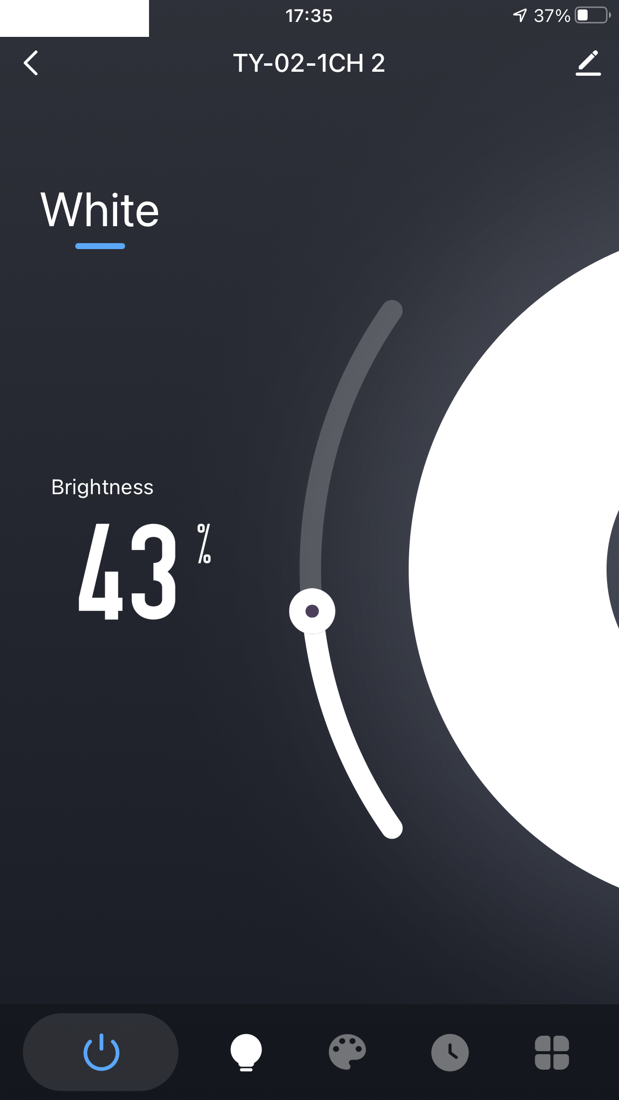

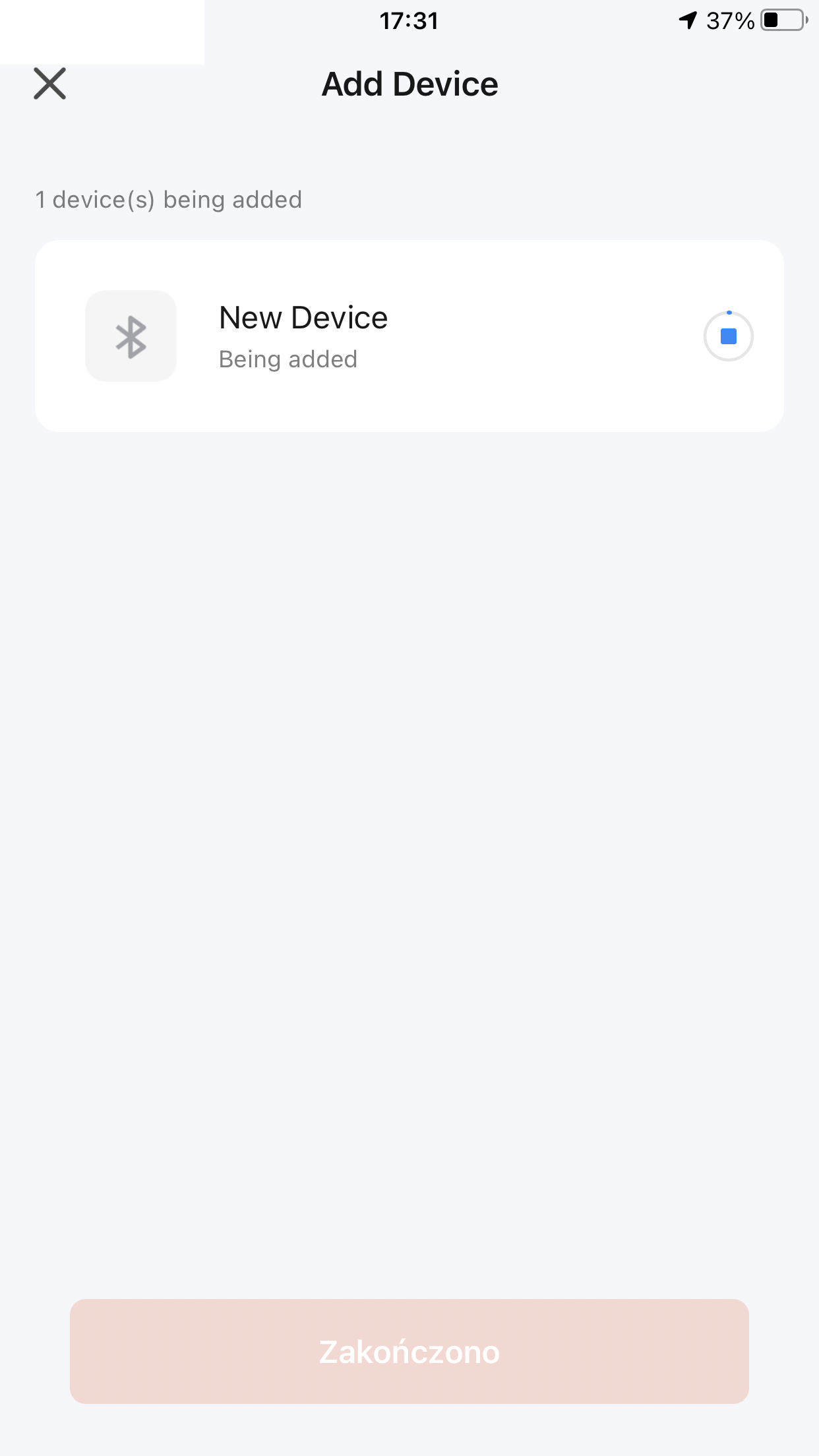

    A short test with the Tuya application
    The Tuya application and its automations/scenarios have already been discussed many times. I won't repeat it here. I just want to show that Tuya pairs without any problems and how the bar interface looks like in this application:
    [BK7231T] TY-02-1CH AIP-FUTURE WiFi single color WiFi LED strip WB3S [BK7231T] TY-02-1CH AIP-FUTURE WiFi single color WiFi LED strip WB3S [BK7231T] TY-02-1CH AIP-FUTURE WiFi single color WiFi LED strip WB3S [BK7231T] TY-02-1CH AIP-FUTURE WiFi single color WiFi LED strip WB3S [BK7231T] TY-02-1CH AIP-FUTURE WiFi single color WiFi LED strip WB3S [BK7231T] TY-02-1CH AIP-FUTURE WiFi single color WiFi LED strip WB3S [BK7231T] TY-02-1CH AIP-FUTURE WiFi single color WiFi LED strip WB3S [BK7231T] TY-02-1CH AIP-FUTURE WiFi single color WiFi LED strip WB3S

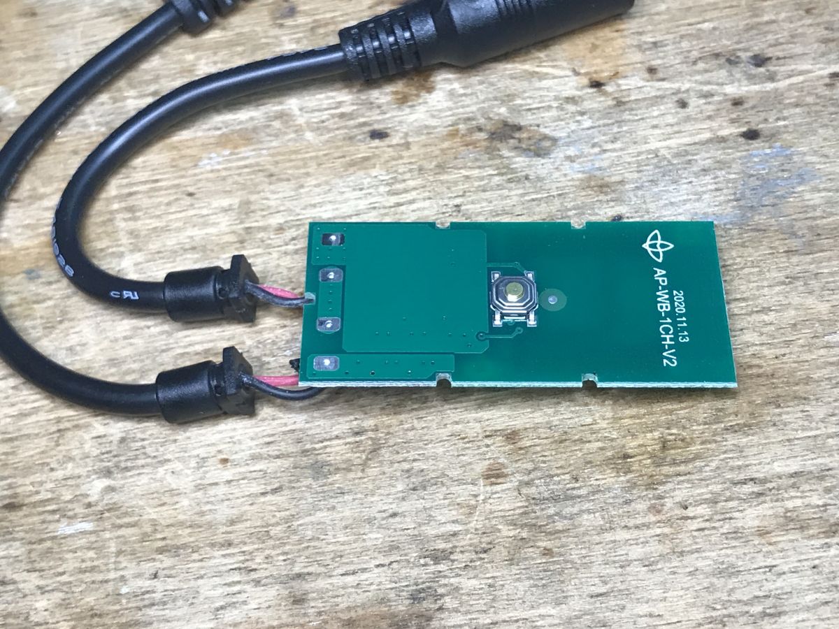

    Interior and programming of the TY-02-1CH

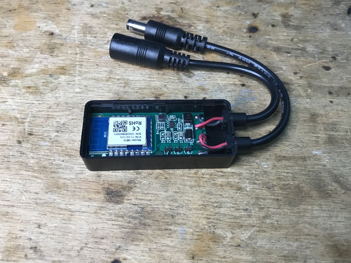

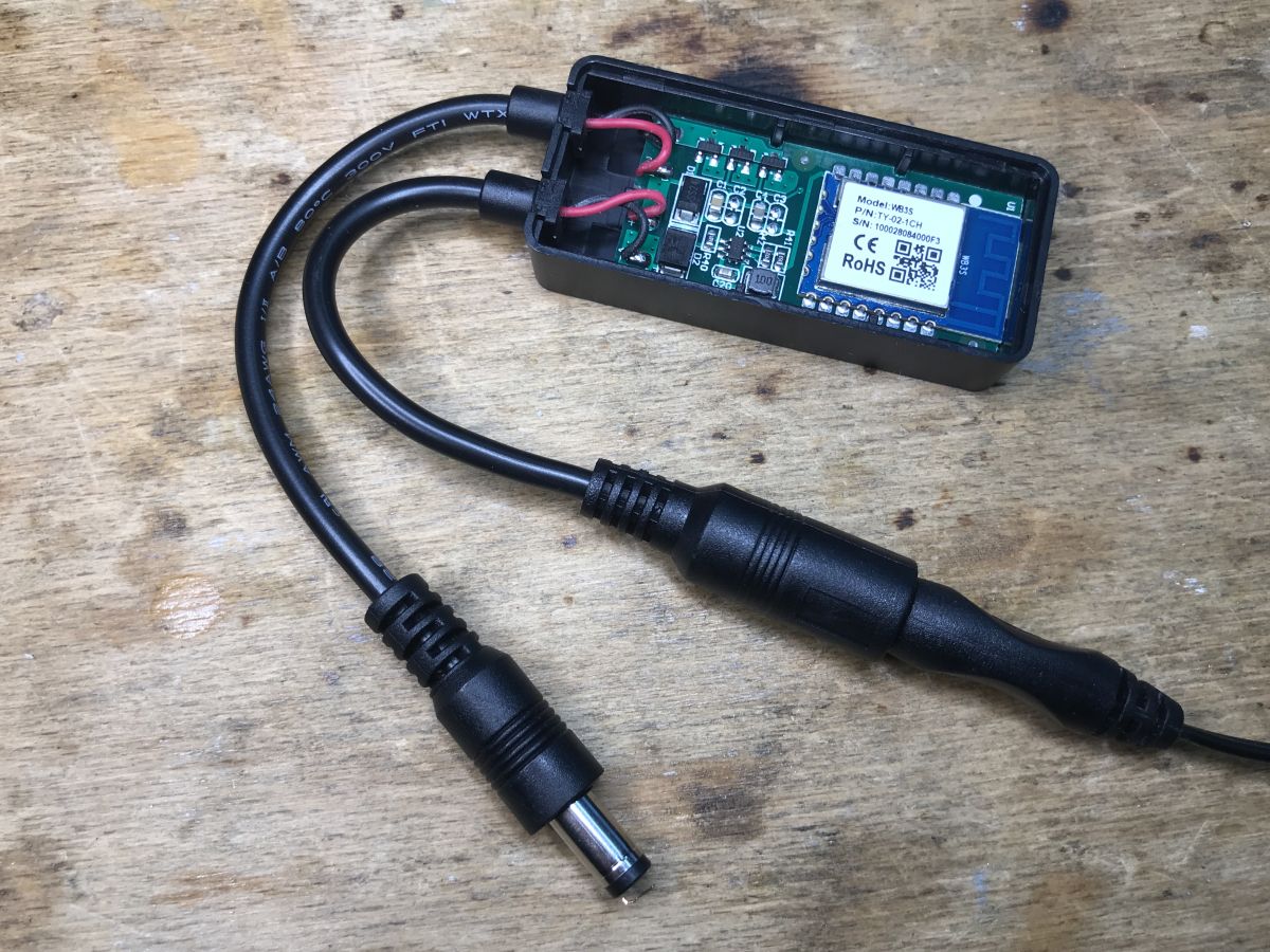

    The product does not have screws, the housing is simply held on with a latch:

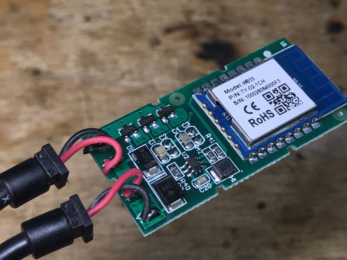

    Inside is ... the WB3S module, i.e. BK7231T:

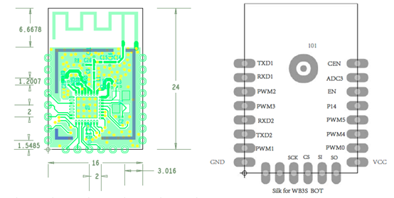

    Its derivations are well described in the Tuya documentation:
    https://developer.tuya.com/en/docs/iot/wb3s-module-datasheet?id=K9dx20n6hz5n4

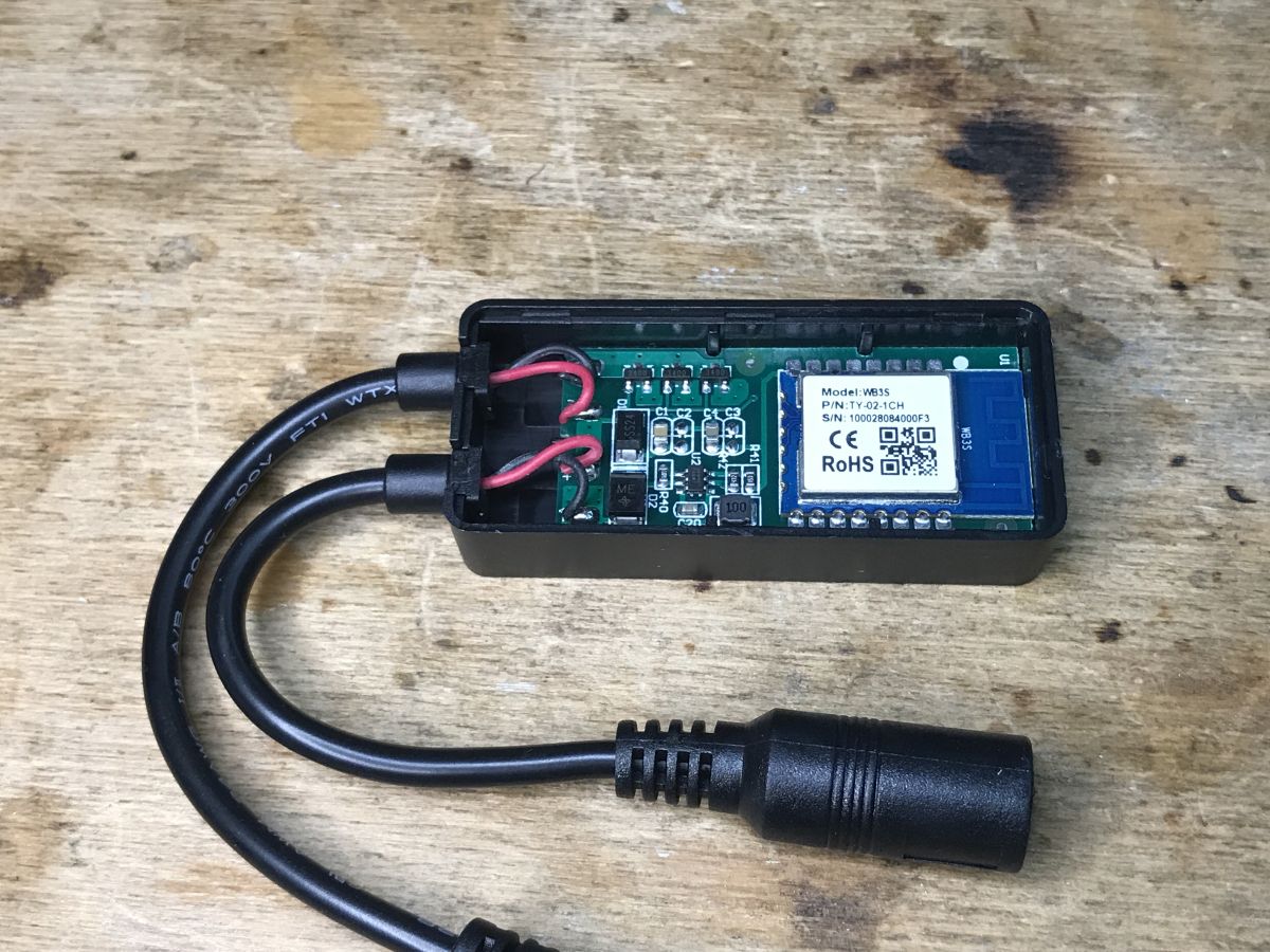

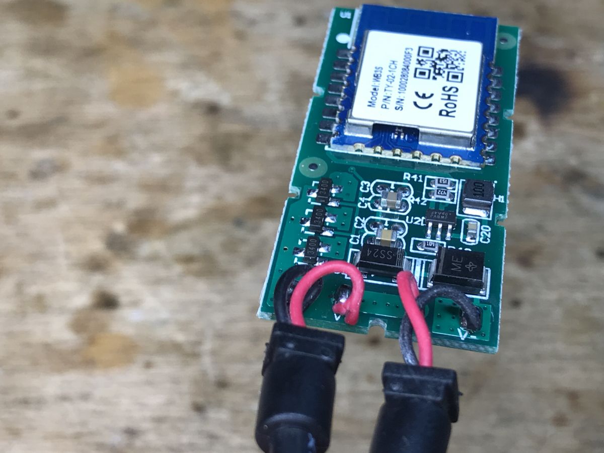

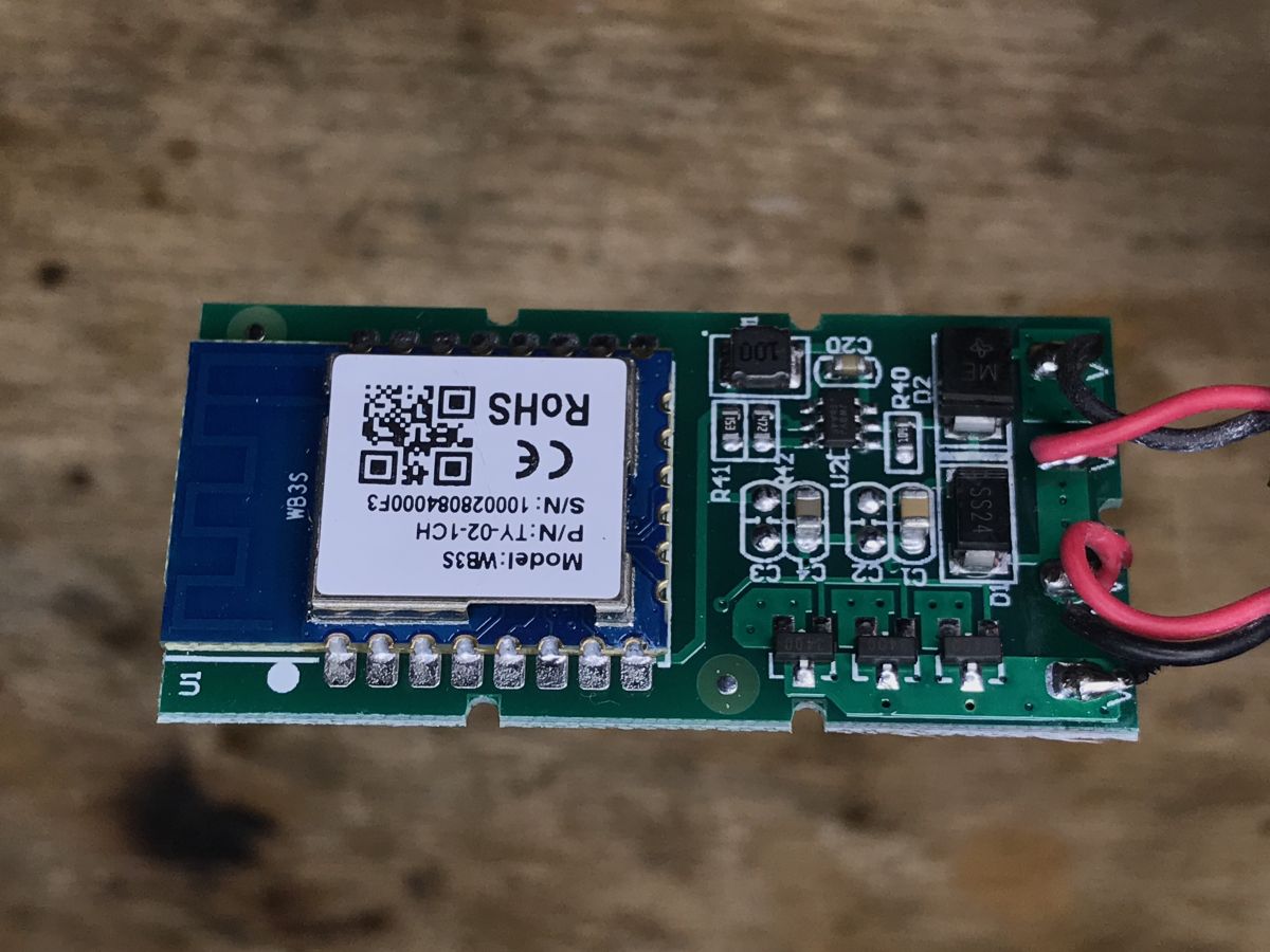

    The plate is also pressed in.
    It can be removed:

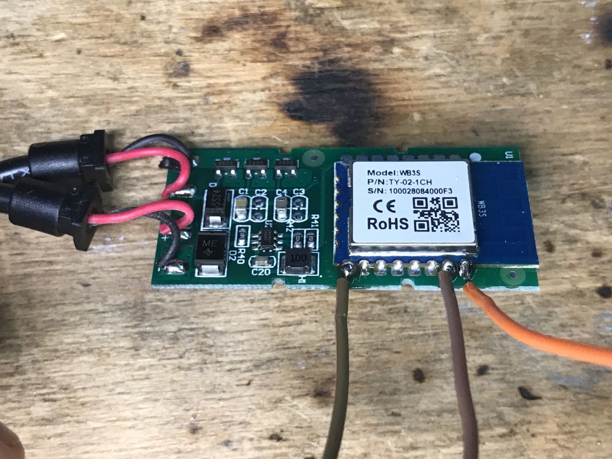

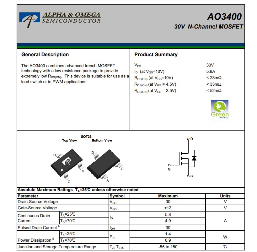

    On board we have a step down converter (you can see the chip signed JWBVJ 0pA4F with a coil and Schottky diode SS24) that converts 24-5V DC to 3.3V DC for the WiFi module and three 3400 transistors working together. These transistors are directly connected to the PWM pin of the WB3S, even without a resistor.
    3400 is probably AO3400:
    In order to program the BK7231T, I soldered TX, RX and GND. I connected a USB to UART converter to it. I used a 9V power supply anyway. I did the reboot/RESET of the system without the CEN pin, simply cutting off the power for a moment.
    In the OpenBeken panel, set:
    - P14 - Button (channel 0)
    - P8 (aka PWM2) - PWM (channel 0)
