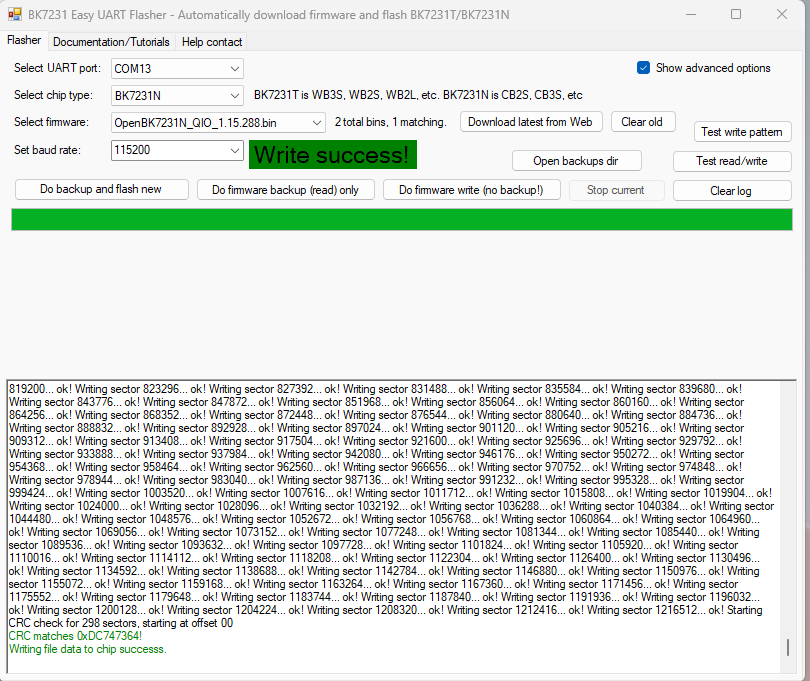

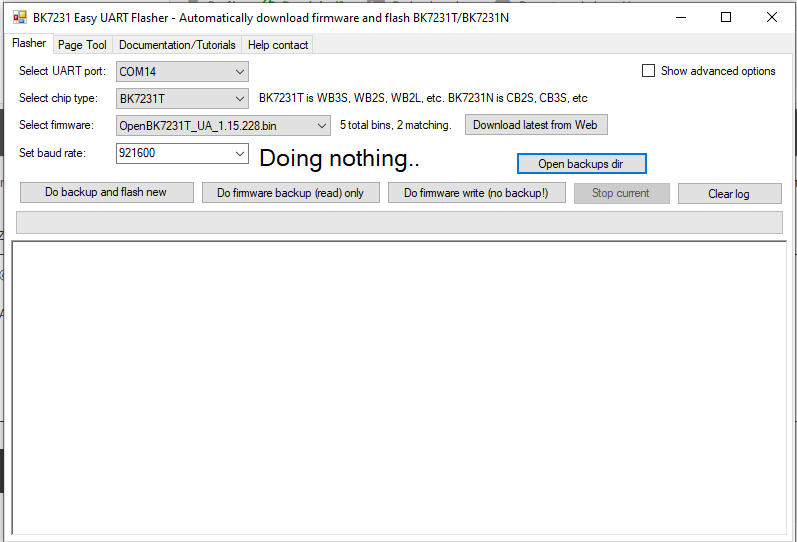

    I just wanted to follow up on the new flasher. It worked for the T and the N boards I've here for testing purposes.
    Looking for provisioning OpenBeken devices via URL or any other automated procedure
    Only the Do firmware write (no) backup is not working, and the log output window is not resizing.
    I did have some issues starting, but it could have been an issue with my USB to Serial adapter. Once reconnected twice flashing went fine.
    Niels
