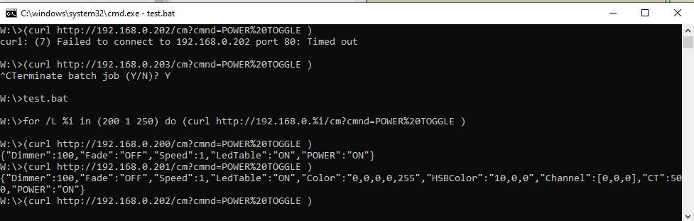

    Let's check if my curl is visible:
    Automatic configuration of Tasmota and OpenBeken devices on Windows with cURL HTTP API
    It is visible what will I show us the help switch?

    curl http://192.168.0.201/cm?cmnd=POWER%20TOGGLE
    Lamp status changes - POWER is switched from ON to OFF or from OFF to ON, everything works:

    Windows - Batch Script - Mass Control
    Now let's do something like an IP scanner, a very primitive one. We will also use a loop, but this time we will put the iterative variable into the target IP address. The following script will change the status of all OBK/WiFi devices visible on the given IP range:
    Code: text
