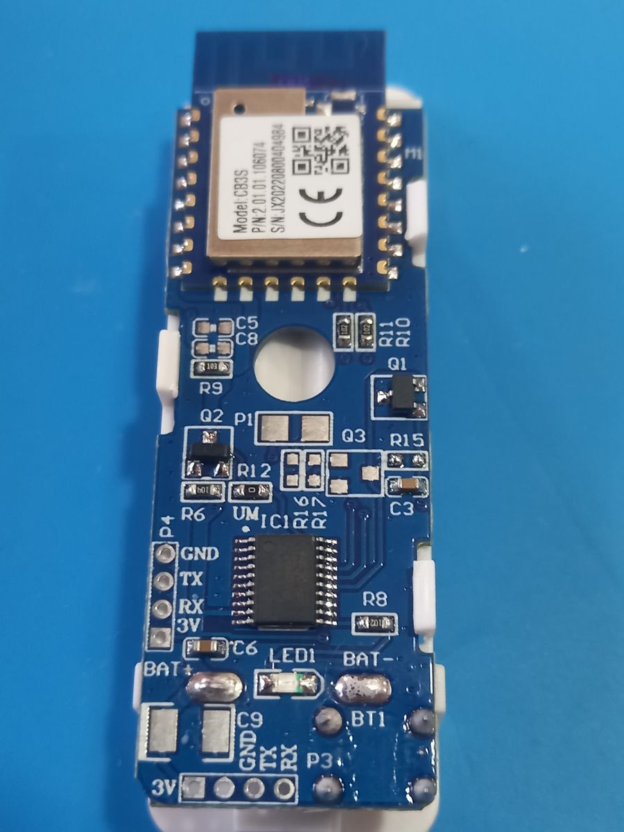

    Hi,
    A new variation Door/Window sensor from Tuya.
    This sensor coming without a bi-metal but still working with a magnet for open or closed showing.
    The module is CB3S so have the BK7231N inside.
    I have flashing this BK7231N with the version 1.15.203 and the connection vcc, gnd, tx1 and rx1 straight on the modele CB3S.
    After flashing i get this log file.
    55AA 00 00 00 01 01 01
    55AA 00 02 00 00 01
    From what i can understand from this is that the ID not changed but that the TP changed when i bring the magnet to the sensor.

    Have we working here with TP ?

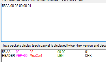

    #2 20340718
    Posts: 14754
    Rate: 12875

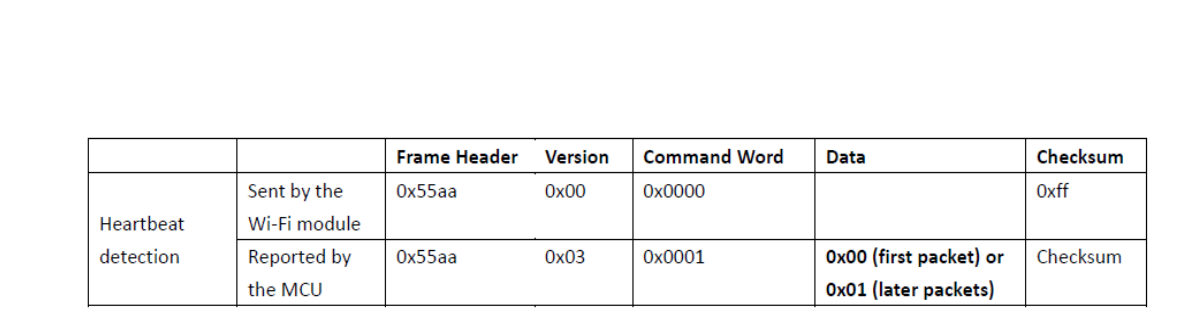

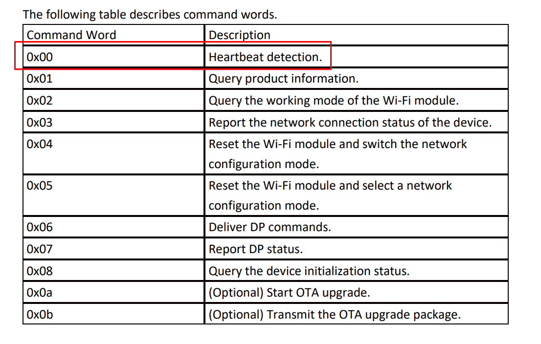

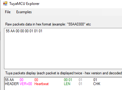

    Are you sure there are no dpID packets?
    Info:TuyaMCU:TUYAMCU received: 55 AA 00 00 00 01 01 01
    Info:TuyaMCU:TuyaMCU_ProcessIncoming[ver=0]: processing command 0 (Hearbeat) with 8 bytes
    This is "heartbeat". This is not a variable. It is send by TuyaMCU to just let us know that TuyaMCU is still online. It contains no dpIDs.
    New Tuya Door/Window Sensor CB3S (BK7231N): Magnet Functionality & Flashing Version 1.15.203
    55AA 00 02 00 00 01 is a Query working mode aka mcu conf.

  • TuyaMCU sleep mode blocks dpID reporting
    #4 20340915
    Posts: 14754
    Rate: 12875
    This fragment:
    Info:TuyaMCU:Consumed 255 unwanted non-header byte in Tuya MCU buffer
    Info:TuyaMCU:Skipped data (part) 00 00 00 00 00 00 00 00 00 00 00 00 00 00 00 00 00 00 00 00 00 00 00 00 00 00 00 00 00 00 00 00 00 00 00 00 00 00 00 00 00 00 00 00 00 00 00 00 00 00 00 00 00 00 00 00 00 00 00 00 00 00 00 00 00 00 00 00 00 00 00 00 00 00 00 00 00 00 00 00 00 00 00 00 00
    Info:MAIN:Time 26, idle 186613/s, free 77248, MQTT 1(1), bWifi 1, secondsWithNoPing -1, socks 2/38
    Indicates that you are most likely powering CB3S separately, when the TuyaMCU is in sleep mode. I had similar CB3S sensor and I saw those 00 00 00 streams many time.
    You will not get any dpIDs that way. You should disconnect your power supply from CB3S and then let the TuyaMCU enable the CB3S, because only then TuyaMCU can report the value.
    Can you check if it works for you that way?
  • Powering CB3S from battery pads and boot log errors
    #5 20342206
    caubergjef57
    Level 4  
    Posts: 42
    Hi,
    I connect the vcc (3.3V) and gnd now to the + and - from the battery connectors.
    This is the log file.
