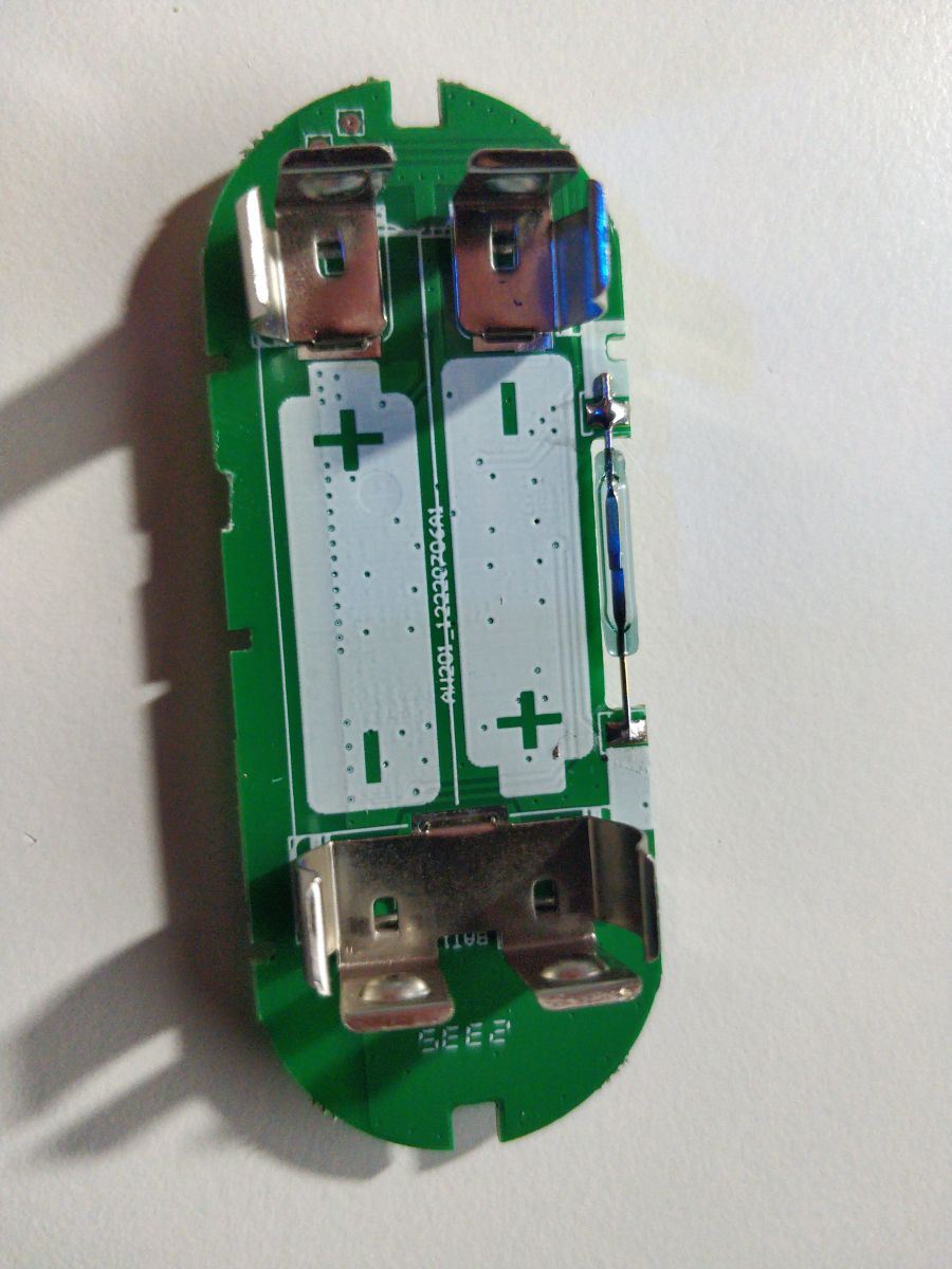

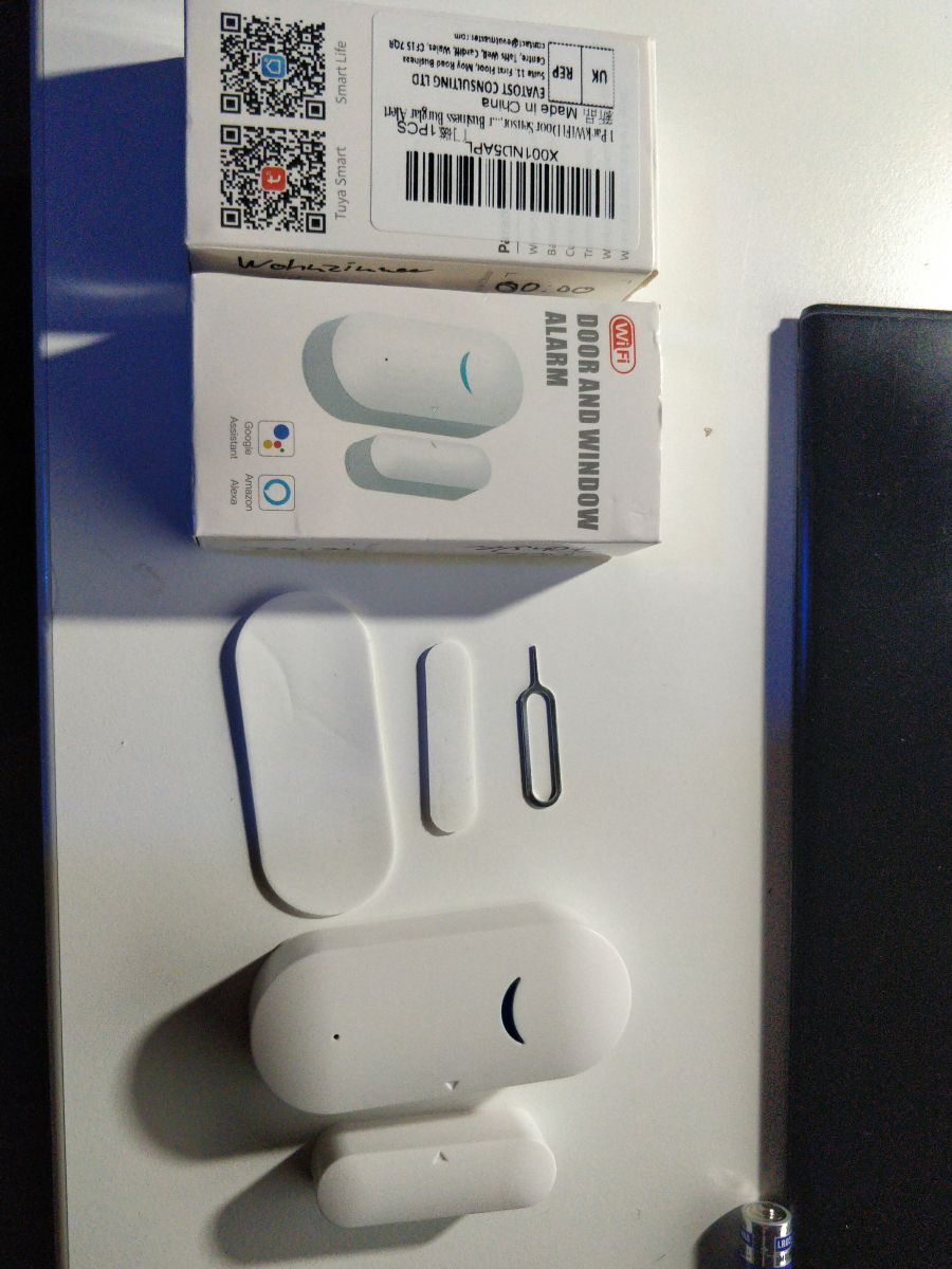

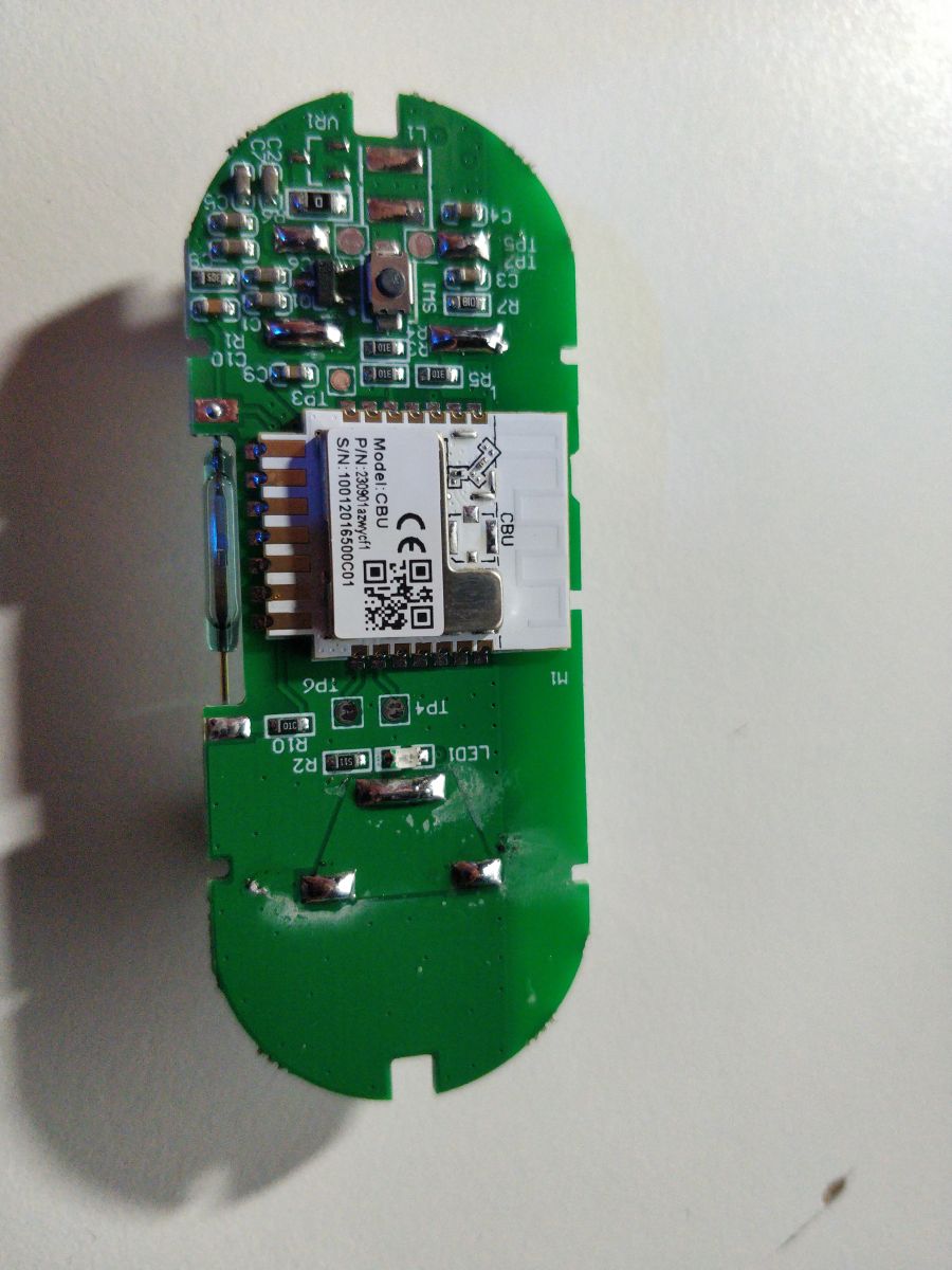

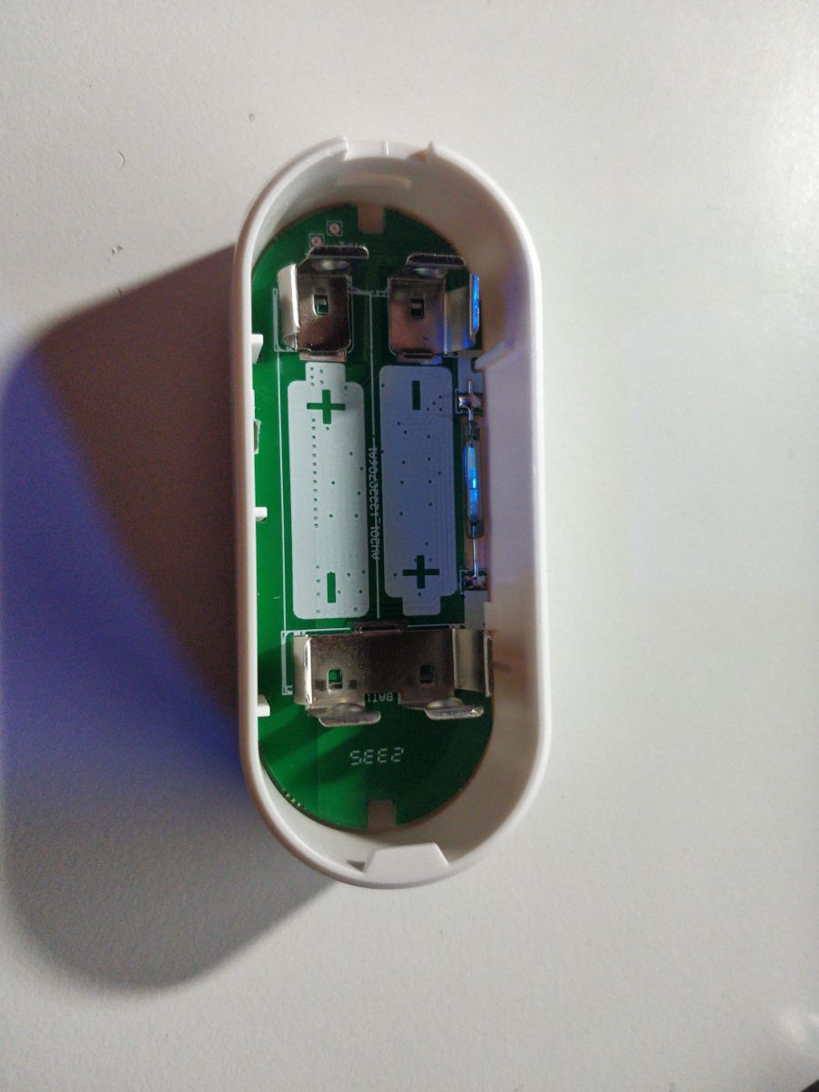

    Hello, I got a battery powered Door/Window-Sensor from Amazon which is compatible with Tuya and Smart Life.
    It looks like this one:
    https://www.elektroda.pl/rtvforum/topic3771510.html#gallery-29
    But with a CBU processor.
    PCB of a door/window sensor with battery holders. Close-up of an open door/window sensor showing battery contacts and electronic components inside the casing. Tuya door/window sensor set with components on a white background. Close-up of a circuit board with mounted electronic components, including a CBU processor.
    With this configuration the device connects to the mqtt broker and goes to sleep until the magnet sensor state is changed.
    It will indicate a state change with the build in LED on the front.

  • #3 20902090
    schnuphggd
    Level 4  
    Hey, it's this one:
    WLAN-Türsensor, intelligenter Tür-Fenstersensor, kabelloser Fenstersensor, Echtzeit-Alarm, kompatibel mit Alexa, Google Assistant, Sicherheitstür, Sensor für Geschäftseinbruchsalarm (4 Stück) https://amzn.eu/d/aDo8nNi
