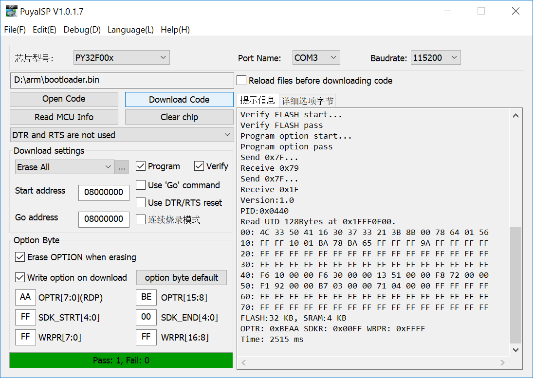

  • #45 20512071
    witawat57
    How to download program to mcu PY32F002A on windows?
    Can use st-link V2?

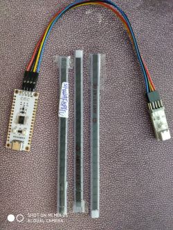

  • #47 20525759
    wichers
    Made some PY32F002 boards for testing purposes, Two blue printed circuit boards with integrated circuits and pins, lying on a dark background..
    I accidently messed around with A13. Is there any way to 'unbrick'/erase a device before the firmware is loaded? Couldn't find anything in the documentation.
    A manual reset quickly following by a erase does not help..
    Thanks!

    piotr_go
    DIY electronics designer
    Posts: 2910
    Help: 94
    Rate: 3351
    Have you tried BOOT0=Hi ?
  • Wrong MCU selection caused flashing issue
    #49 20525933
    wichers
    Thank you for your quick reply, I fixed it.
    I should have mentioned this, it was the QFN (PY32F002AW15U6TR) giving me problems it has no BOOT0 pin. BOOT0 did help to erase the TSSOP20. Solution for the QFN is to do hardware RESET when powered on.
    All very obvious. I made stupid mistake though, I had two projects with the same name but both with different MCU's. I had the wrong processor selected, ouch!

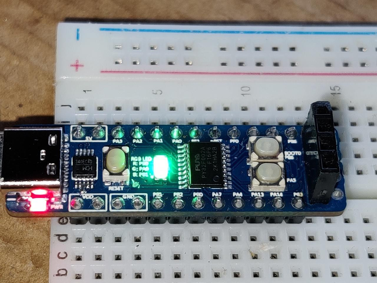

    #57 20598134
    dabyd64
    Posts: 6
    Rate: 11
    Hi, I've been watching those puyas for several months, finally I ordered some to lcsc also made some development boards for py32f002/003/030 and hk32f030m :)
    Three development boards with microcontrollers, USB-C ports, and pin headers.
    But now I've seen you're using serial to program them?
    Do they have embedded bootloader?
    What software to use?
    If this is true, I might embed a CH340E for easier programming, though I hope I can use J-Link too.
    Thanks!!

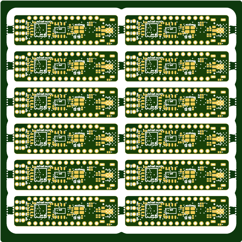

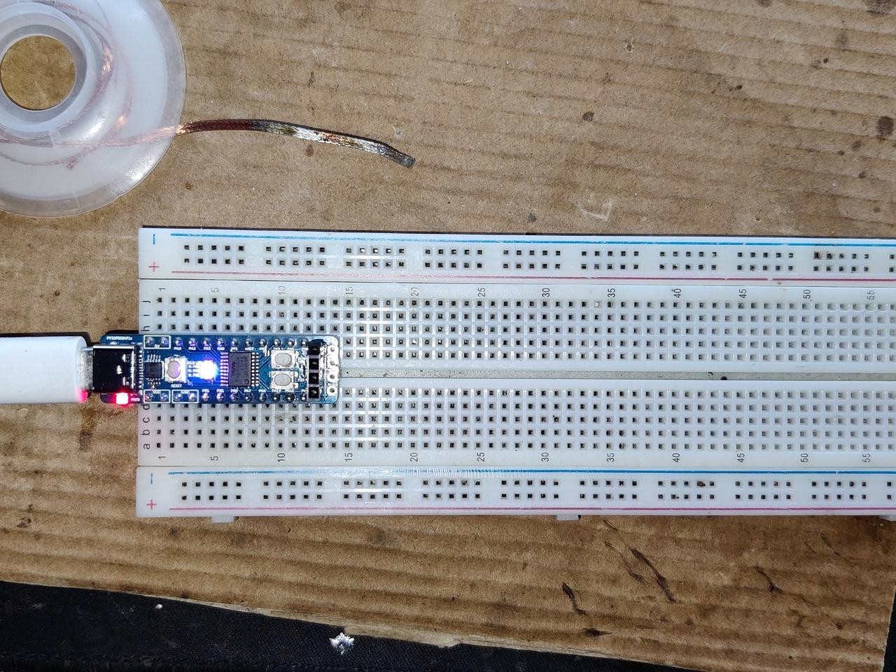

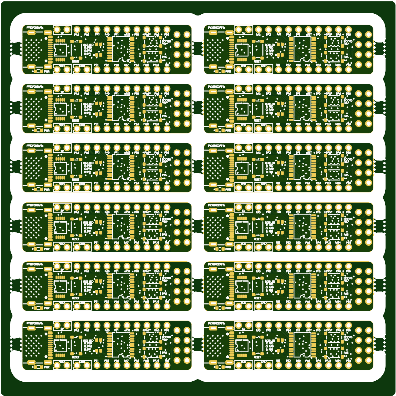

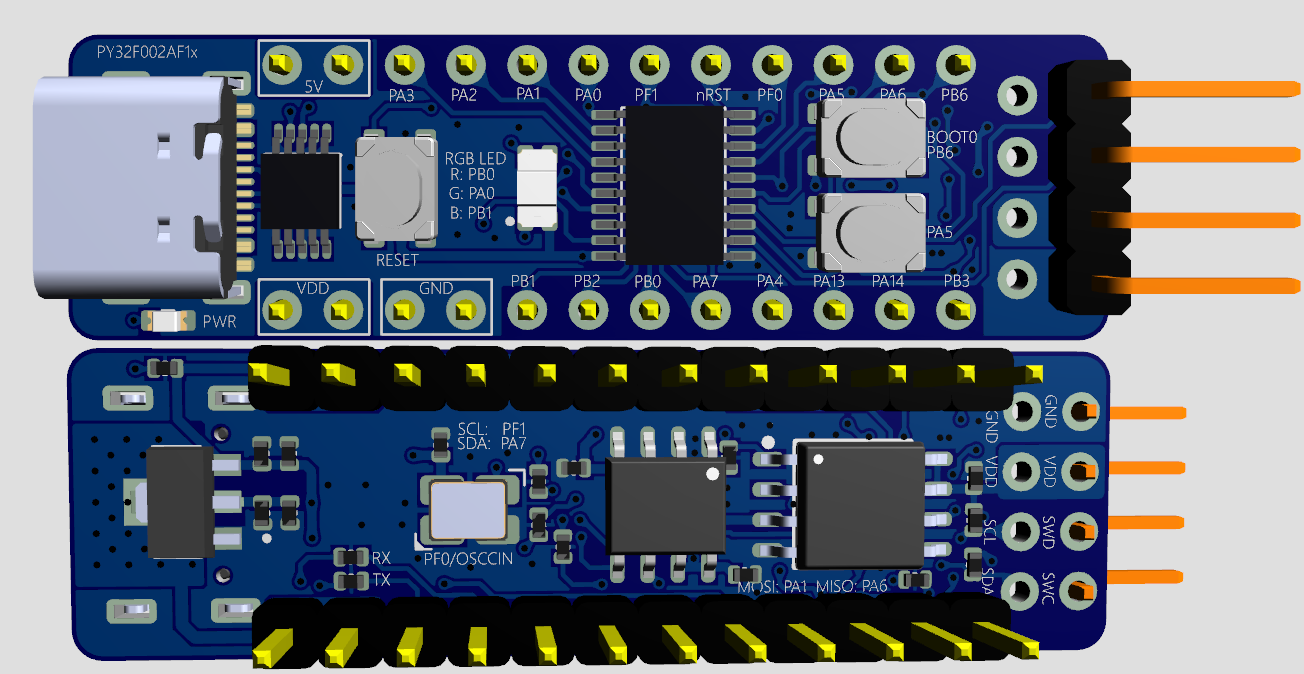

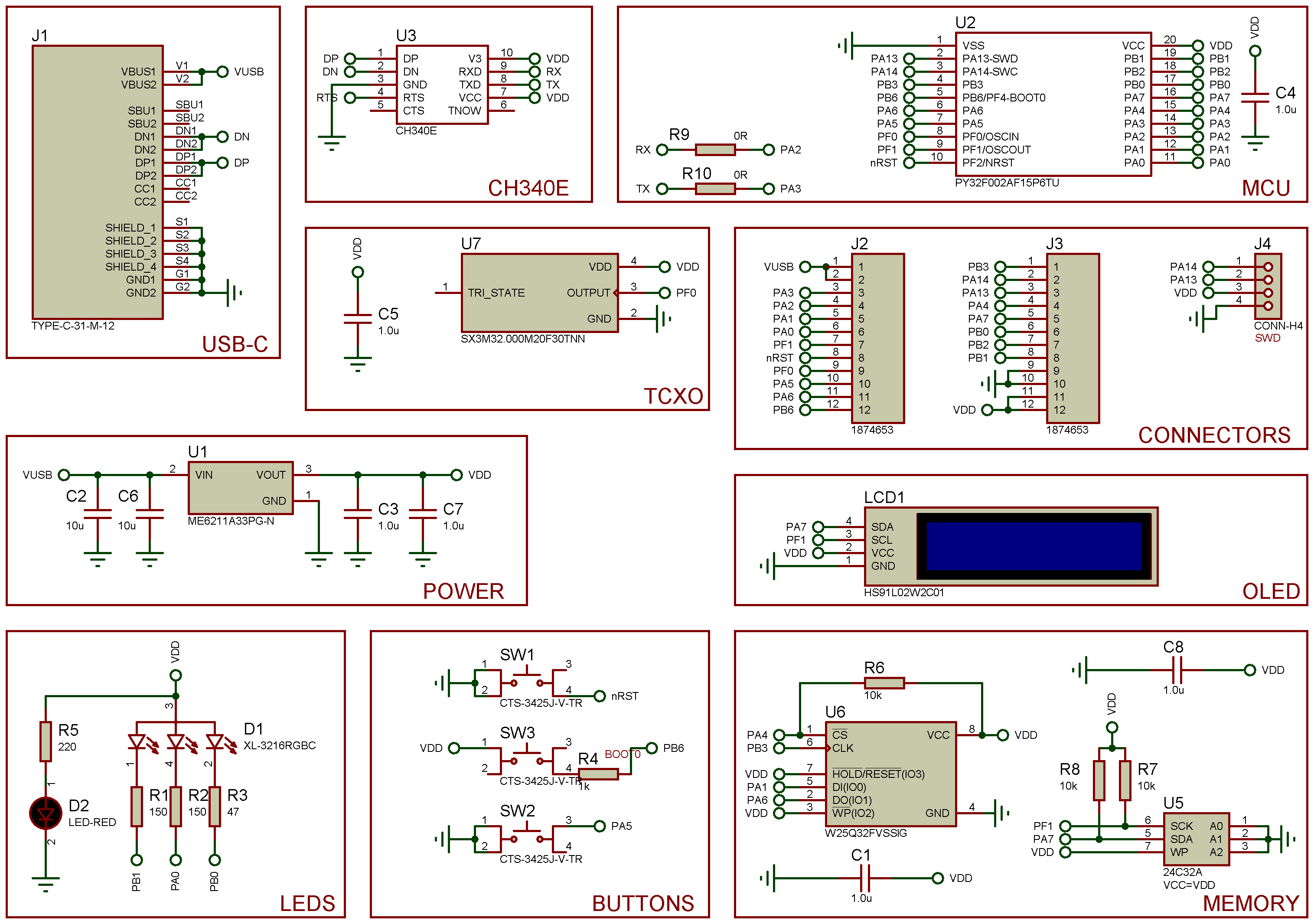

  • Final PY32F002 board BOM and PCB fixes
    #59 20611428
    dabyd64
    Posts: 6
    Rate: 11
    So this is the final board for PY32F002, I'll be ordering this soon.
    Uses the same parts as the other board for HK32F
    Rest are common parts easily sourced anywhere, 0402 resistors / capacitors, pin headers, 25xx/24xx memories...
    Edit: Fix PCB
    - Missing GND trace for CH340E.
    - CH340E RTS/DTR not working as expected, remove them.
    - Fix BOOT0 button, pull pin high instead low.
    • PY32F002 - Chinese ARM for 8 cents from PUYA IMG_20230630_202656_1_1280x960.jpg (322.81 KB) You must be logged in to download this attachment.
