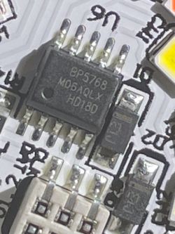

    I discovered Tasmota some time ago and immediately, without reading through it much, ordered the lamps described above, then did a bit of tinkering and tried to flash the ESP8266, but then had to realize that these lamps are not compatible with Tasmota. They have now BK7231 inside.
    Have then further researched, am then on this Instructions encountered, since I didn't know exactly which chips are installed, I quickly dismantled a lamp.
    Immax C37 6wE14 RGBCW smart bulb lying on its side with visible markings.
    Image of a disassembled LED bulb with a visible chip and colorful diodes.
    Close-up of the BK7231N chip on a circuit board labeled CBLC5.
    Close-up of a BPS768 integrated circuit on a printed circuit board.

    P24: BP5758D_DAT
    P26: BP5758D_CLK
    Now there was only one problem, the colors were not correct, BGR instead of RGB, but I solved that with the software control.
    I hope I could help someone with this. Kind regards
