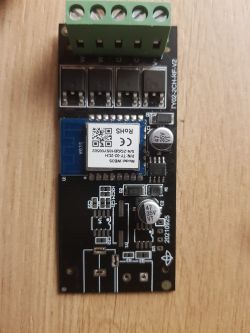

    Hi!
    I am appreciate to contribute.
    Bought here https://www.aliexpress.com/item/4000080534824.html
    Was looking for 2 channel CCT LED for my DIY pendant dinner room to be integrated in HomeAssistance through ESPHome (as my favourite one) however, inside found Beken chip.
    Title: [BK7231T] AP Future CCT LED Controller: Flashing & ESPHome Integration Guide
    How should I solder in order to Flash by USB-UART?
    btw. actullay why I can't use ESPHome binaries? I mean from one hand is kind of copy ESP8266 but no? what are diffrent, where I can find comparison article?

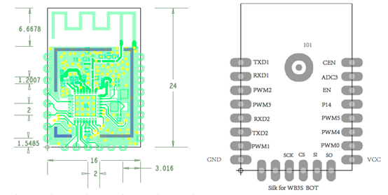

    It's a totally different microcontroller architecture. Please solder GND, TXD1, RXD1, then use our tool:
    to read backup and flash.
    The procedure is simple:
    - start read backup and flash in tool
    - disconnect and reconnect power from the strip
    - wait for flashing to finish
    Here is a silk for WB3S bot:
    Pin No.SymbolI/O typeFunction
    1CENILow-level reset, high-level active (internally pulled high) Docking IC-CEN
    2ADC3AIADC pin, which is connected to the P23 pin on the internal IC
    3ENInputEnabling pin, which is internally pulled up and compatible with other module design
    4P14I/OCommon GPIO, which is connected to the P14 pin on the internal IC
    5PWM5I/OGPIOP_26, which is connected to the P26 pin on the internal IC
    6PWM4I/OGPIOP_24, common GPIO, which is connected to the P24 pin on the internal IC
    7PWM0I/OGPIOP_6, which is connected to the P6 pin on the internal IC
    8VCCPPower supply pin (3.3 V)
    9GNDPPower supply reference ground pin
    10PWM1I/OGPIOP_7, which is connected to the P7 pin on the internal IC
    11TXD2I/OUART2_TXD, which is used to display the internal information of the module and connected to the P0 on the internal IC. Unavailable to customers.
    12RXD2I/OUART2_RXD, which is used to display the internal information of the module and connected to the P1 on the internal IC. Unavailable to customers.
    13PWM3I/OGPIOP_9, common GPIO, which is connected to the P9 pin on the internal IC
    14PWM2I/OGPIOP_8, which is connected to the P8 pin on the internal IC
    15RXD1I/OUART1_RXD, which is used as a user-side serial interface pin and is connected to the P10 pin on the internal IC
    16TXD1I/OUART1_TXD, which is used as a user-side serial interface pin and is connected to the P11 pin on the internal IC
