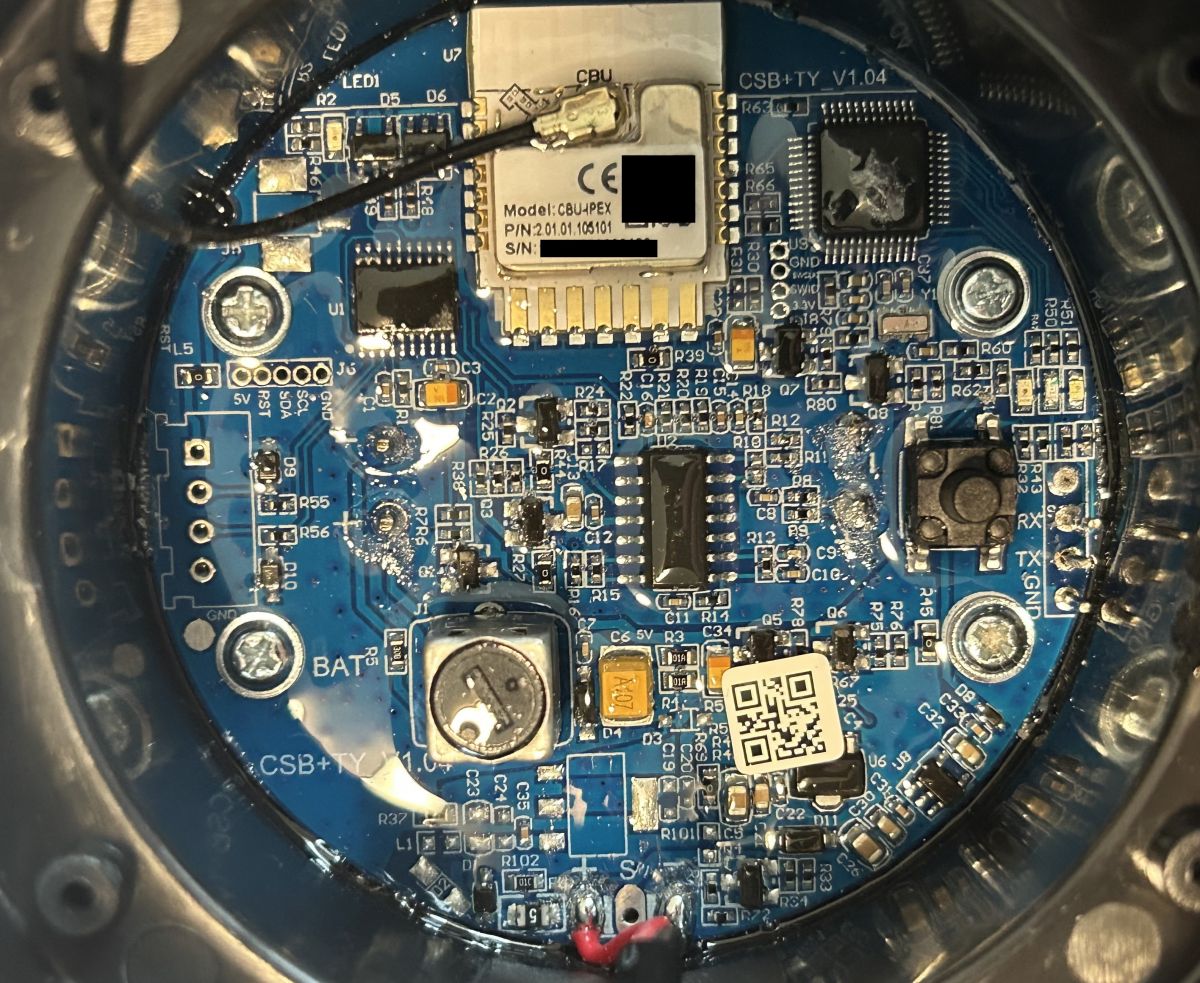

    Hello!
    I recently purchased a tank level sensor (EPT Tech TLC2206) that has a Tuya CBU-IPEX board with a BK7231N SoC. I was hoping to flash ESPHome (or something local, other than Tuya) on it, but I'm struggling to get it recognized by any of the flashing tools. The whole board is covered in epoxy, which doesn't make things any easier.
    EPT Tech liquid level sensor set with smartphone app.
    https://www.aliexpress.com/item/1005005940048434.html
    Any help would be appreciated!

    Posts: 14771
    Rate: 12914
    This is most likely a TuyaMCU device. It wont work if you just flash a new firmware. It requires futher configuration.
    I don't know how to do it in ESPhome and if it's supported or not, but here is my detailed TuyaMCU guide for OBK:
    TuyaMCU flashing, setup and configuration guide - configure dpIDs for Home Assistant
    I can help you with the setup step by step if you decide to take the approach I suggested.

    I can see the extra coating on the board. It's used to secure the PCB against the moisture.

    I've got this device and I was able to flash it using cloudcutter.
    It is indeed a tuyamcu device. You can use it in esphome, but currently it is not possible to set the height or alarm levels due to a bug in esphome (until this gets merged: https://github.com/esphome/esphome/pull/7024). I was able to make it work with my custom external component.
    Works nicely so far.

    Do you recall the steps needed to flash it with ESPhome via CloudCutter? If I recall from when I tried originally, it said the device was not exploitable.

    Thanks; I should have clarified. I'm not sure which profile to use with cloudcutter as one doesn't seem to exist for this unit specifically.
    Edit: Looks like it now exists. Yay! Will give that a shot and update.

    I was able to get this going as well. Looks like someone added the profile/model information to cloudcutter recently, and it worked.
    Would you mind sharing your YAML for Esphome? I'm not sure I'm interpreting the datapoints correctly, or if there's just an inherent inaccuracy in the reporting (as long as it's consistent is all that matters). Looks like distance is reported in centimetres from datapoint 22 - but I get different results with liquid vs solid.

    Everything's been working well with the first unit, so I opted to order a 2nd one as well. Unfortunately, the seller on AliExpress swapped the listings around and I didn't catch it (used the Buy it again option, but the item had been changed at the same link) and they shipped a TLC2326. The TLC2326 has a slightly different (better, IMO) form factor, and more importantly has a patched firmware (2.1.17) and can't be exploited with tuya-cloudcutter.
    After bashing my head against a while trying to extract the firmware and re-flash with ltchiptool, I found a post saying they couldn't re-flash while the Tuya MCU was still connected. Indeed, that was my issue as well.
    For anyone finding this by Google, trying to load ESPHome onto a TLC2326, best I can tell you'll need to use a hot air rework and remove the IBU entirely, flash with ltchiptool, and then resolder to the PCB. The rework was great at removing the potting. Heat it up, pierce with tweezers and it'll pull off the board cleanly in chunks.
    This was a bit fiddly, but it did work and everything is working as expected using the same ESPHome YAML config as the TLC2206. Logs show an error on boot on the Tuya component (Initialization failed at init_state), but the data is being reported properly so not sure what that's about.

  • Hair dryer removal of the IBU for no-solder flashing
    #17 21762741
    lamero345
    Posts: 33
    No solder. Only heat hair to remove the IBU.
    [07:53:13.084][C][tuya:041]: Tuya:
    [07:53:13.087][C][tuya:044]:   Initialization failed. Current init_state: 0
    [07:53:13.087][C][tuya:049]:   If no further output is received, confirm that this is a supported Tuya device.
    [07:53:13.313][D][uart_debug:114]: >>> 55:AA:00:00:00:00:FF
    [07:53:13.445][E][tuya:489]: Initialization failed at init_state 0
    [07:53:27.023][D][uart_debug:114]: >>> 55:AA:00:00:00:00:FF
    [07:53:27.347][D][uart_debug:114]: >>> 55:AA:00:00:00:00:FF
    [07:53:27.630][D][uart_debug:114]: >>> 55:AA:00:00:00:00:FF
    [07:53:27.929][D][uart_debug:114]: >>> 55:AA:00:00:00:00:FF
    [07:53:28.269][D][uart_debug:114]: >>> 55:AA:00:00:00:00:FF
    [07:53:28.457][E][tuya:489]: Initialization failed at init_state 0
  • #18 21762753
    piotrszulc1
    Posts: 37
    Rate: 8
    From the log it looks like the TuyaMCU chip does not answer at all.
    Did you actually solder it back on? The TuyaMCU chip is on the mainboard, not on the CBU.
  • #19 21762756
    lamero345
    Posts: 33
    No solder was made
  • #20 21762759
    piotrszulc1
    Posts: 37
    Rate: 8
    Then solder the CBU back to the main board, and then it should work.
  • On-board CBU flashing works with ESPHome config
    #21 21762814
    lamero345
    Posts: 33
    CBU was never desoldered from main board. I flashed it on board.
    Model on Aliexpress
    Now It works. Final configuration:

    And yes, I have an error on boot on the Tuya component
    [09:46:35.077][C][tuya:041]: Tuya:
    [09:46:35.079][C][tuya:044]:   Initialization failed. Current init_state: 4
    [09:46:35.081][C][tuya:049]:   If no further output is received, confirm that this is a supported Tuya device.
    After few seconds it works
