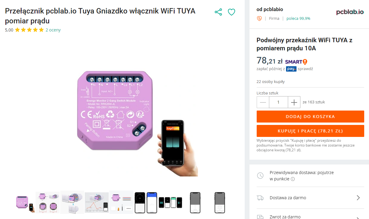

    Buying the RR620W
    The RR620W is very popular in the network. You can find it both in stores with shipping from China:
    [CB2S/BK7231N] RR620W dual flush relay offering energy metering
    Parameters according to the Chinese:
    Input Voltage 100-250VAC, 50/60Hz
    output voltage 100-250VAC, 50/60Hz
    max. load 5A / Gang
    wireless type Wi-Fi 2.4GHz
    App Name Smart Life or Tuya APP
    dimensions 47mm*48mm*23mm
    works with toggle wall switch
    As well as Polish sellers:

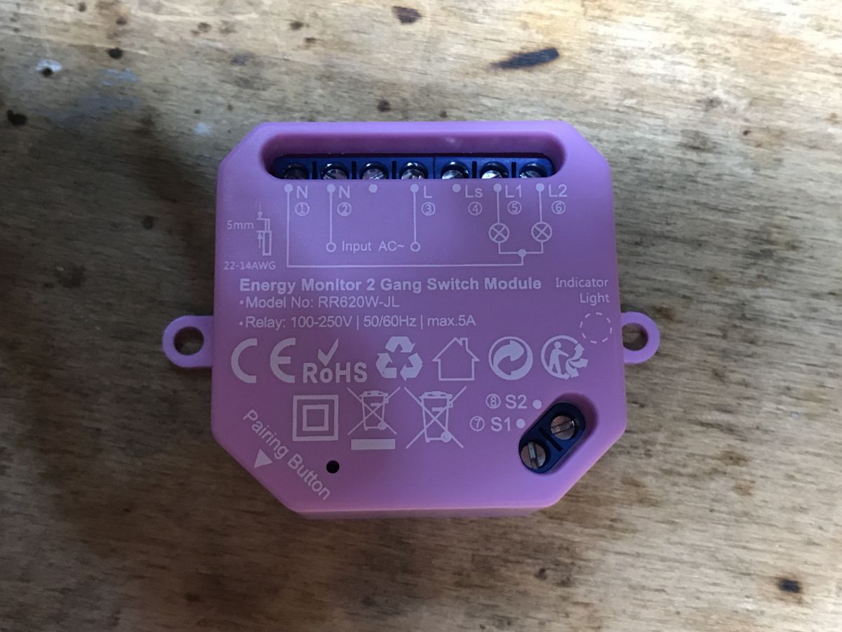

    We already see the inaccuracy here - the Polish seller summed up the current of both channels and gave 10A instead of the actual 5A . Let's read on:
    Even on the housing there is 5A ...

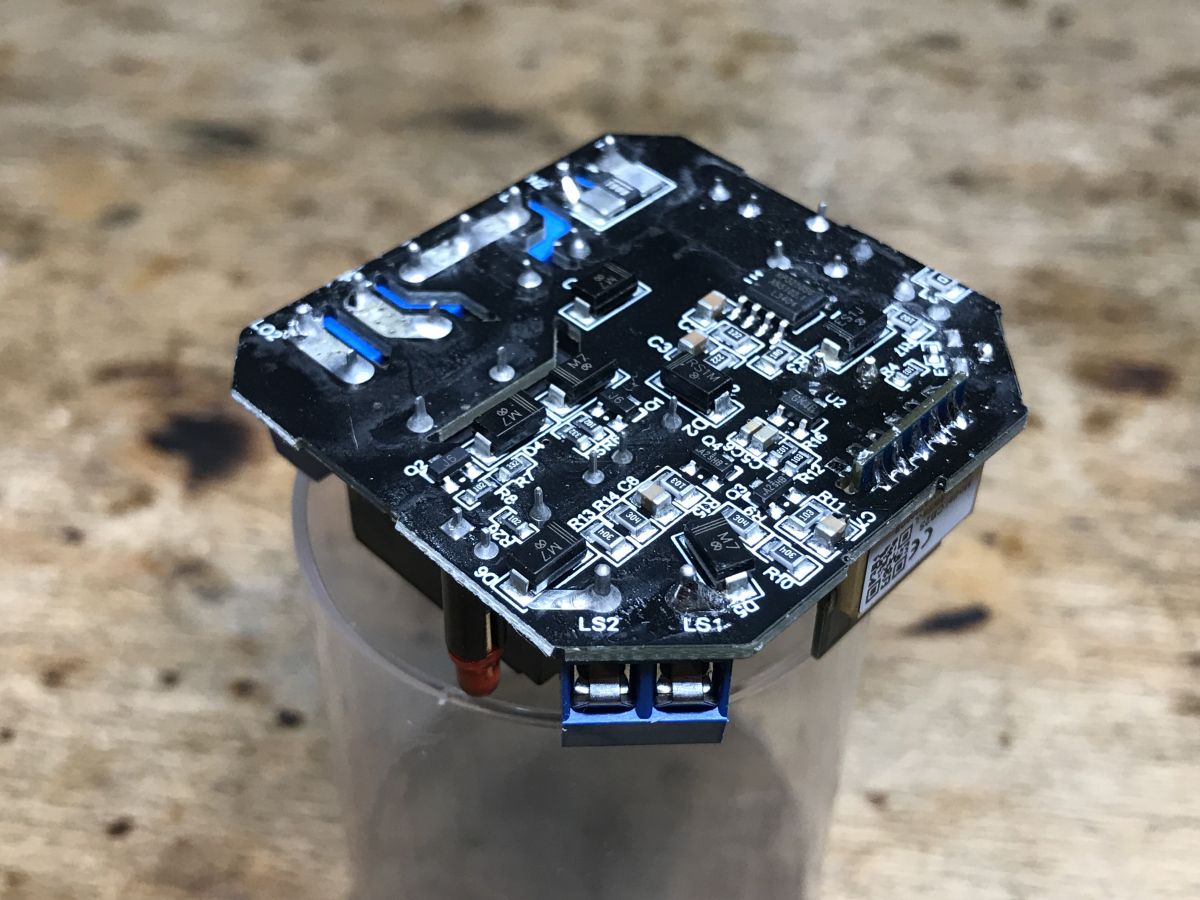

    Now the bottom of the PCB:

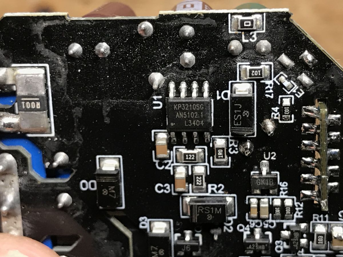

    KP3210SG is a power supply system:

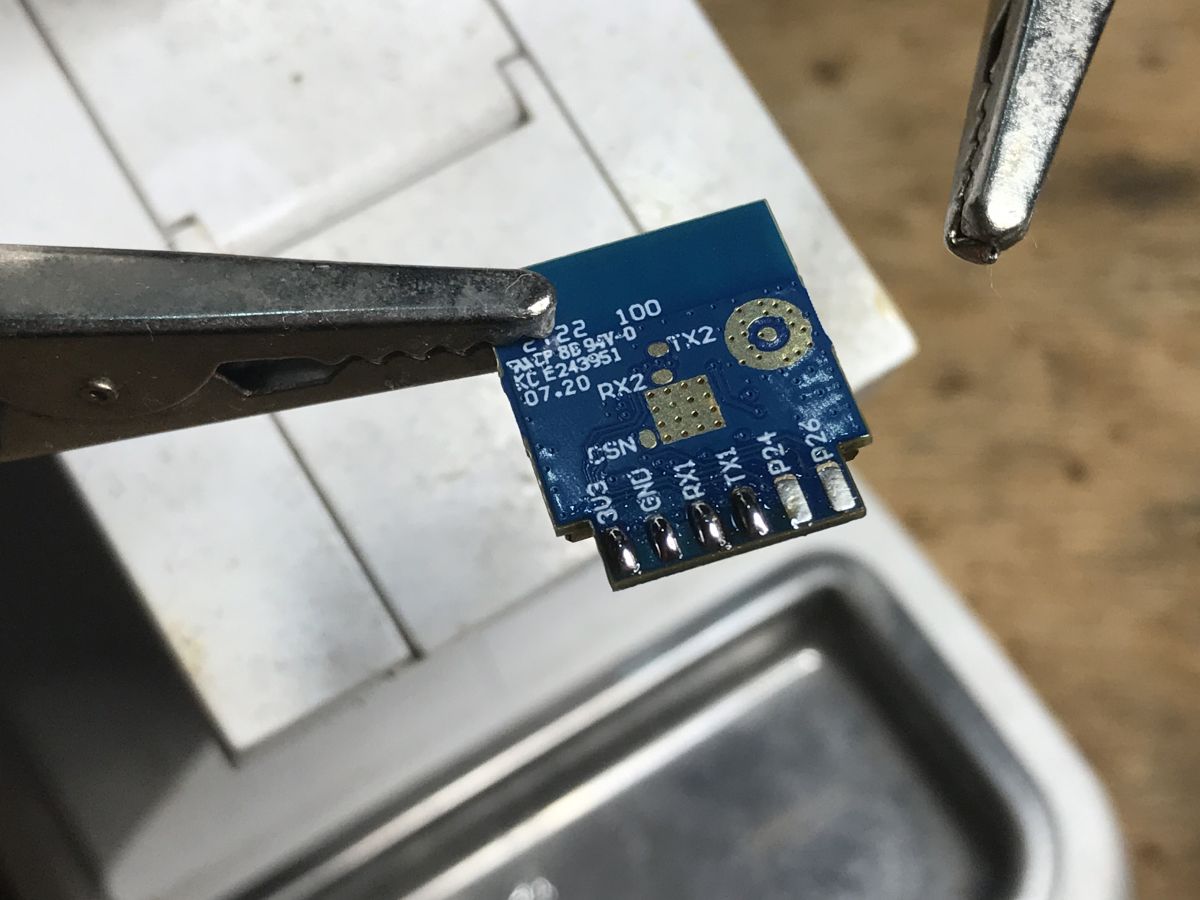

    Firmware change procedure
    This product uses CB2S, which is BK7231N. You can change the firmware to cut it off from the cloud and, among others. pair with Home Assistant. I uploaded my project to him:
    Personally, they prefer to desolder the entire module with a braid and flux, and then power it with 3.3V and connect only RX and TX (except ground and power) and program it with your tool:
    I reboot by turning off the power.
    This is what the pads look like after removing the binder with a braid:
    And after removing the module:
    The module before soldering the wires, but already with the binder on the pads:
    The cables are:
    Ready programming system (LDO 3.3V TC1264 and 5V derived from USB):
    And after programming - while soldering the module:
