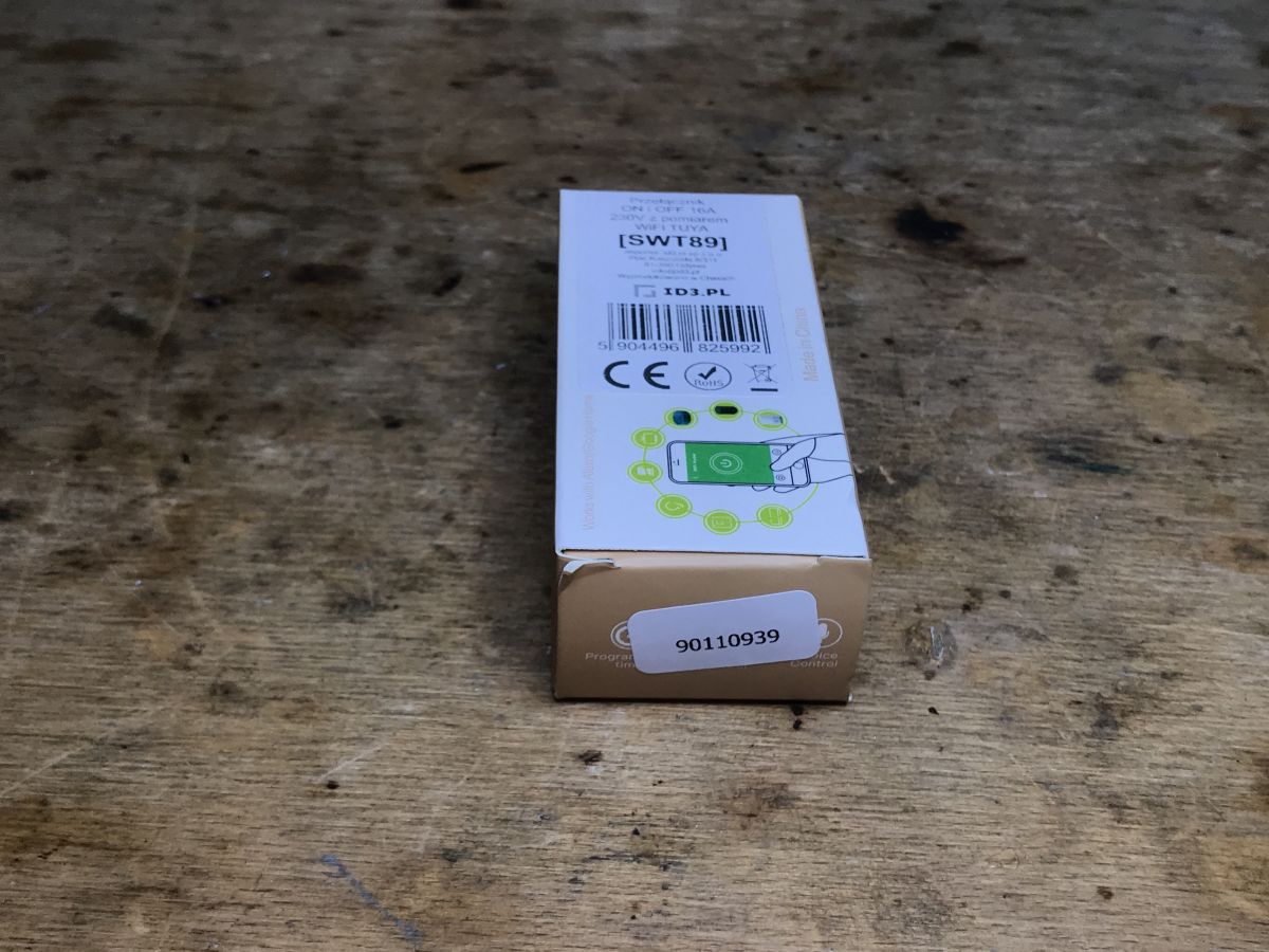

    Purchase, packaging, kit content
    MS-101 was purchased from the Polish shipping service:
    [BK7231T/WB2S] WiFi relay MS-101 16A SWT89 with energy measurement
    Initially, the name was SW SWT89, now it's just SW.

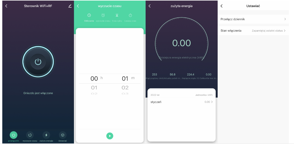

    This is how it looks in the manufacturer's application, which I have not tested:

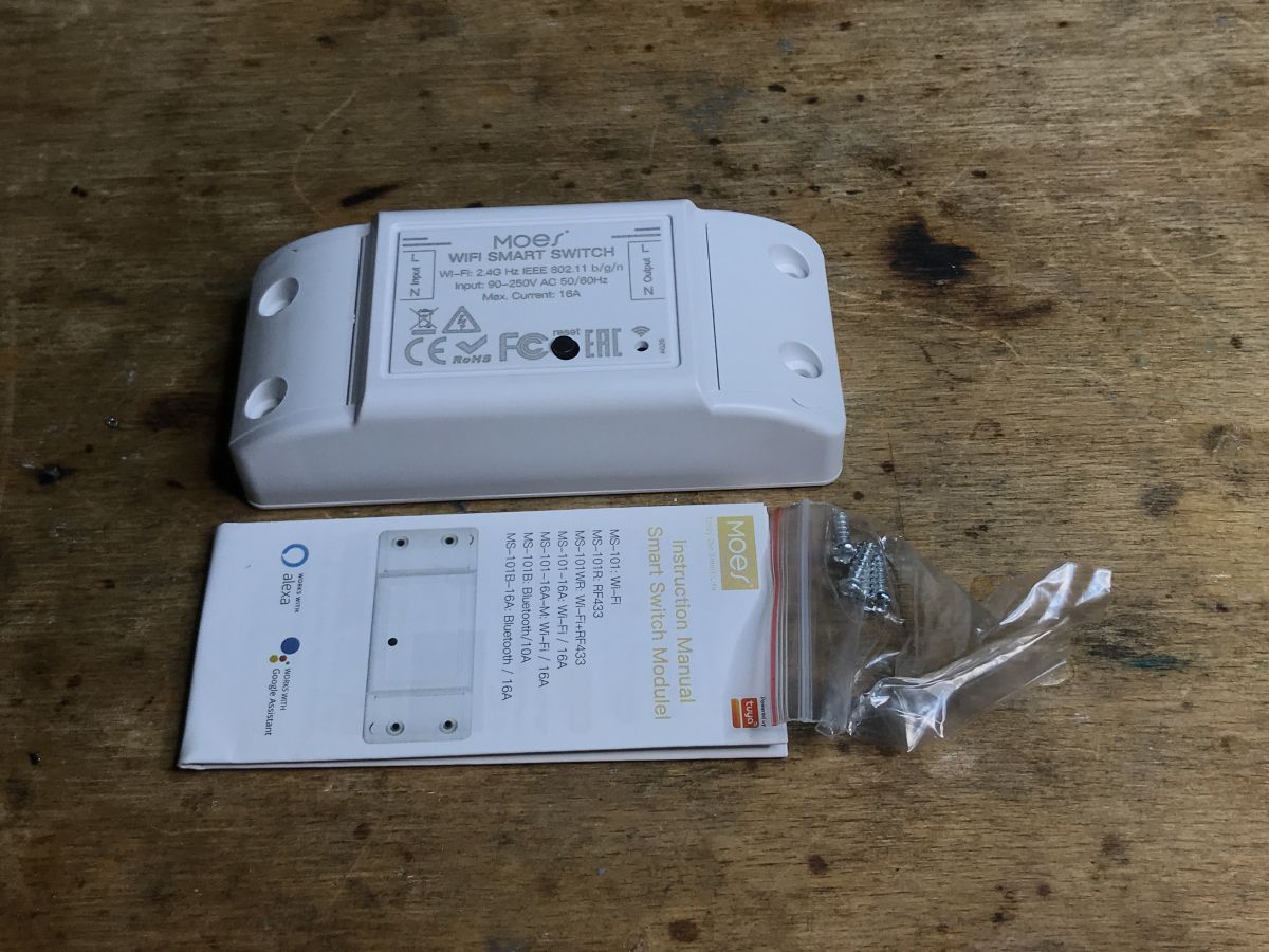

    Actual Packing:
    [BK7231T/WB2S] WiFi relay MS-101 16A SWT89 with energy measurement [BK7231T/WB2S] WiFi relay MS-101 16A SWT89 with energy measurement [BK7231T/WB2S] WiFi relay MS-101 16A SWT89 with energy measurement [BK7231T/WB2S] WiFi relay MS-101 16A SWT89 with energy measurement
    Kit Contents:

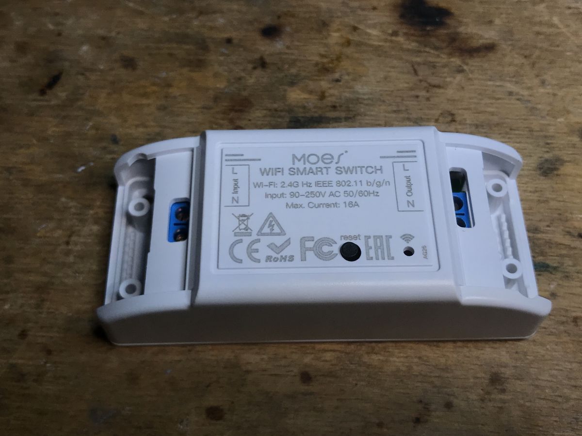

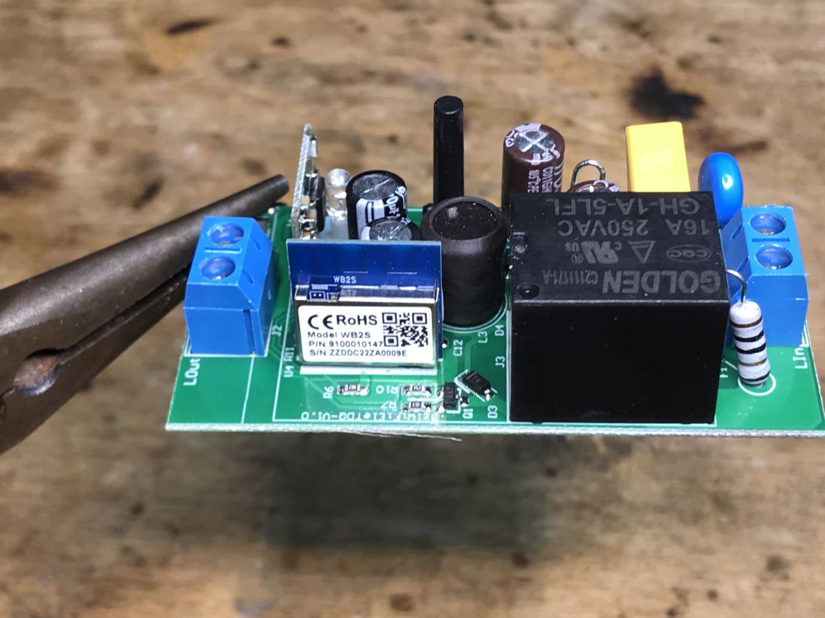

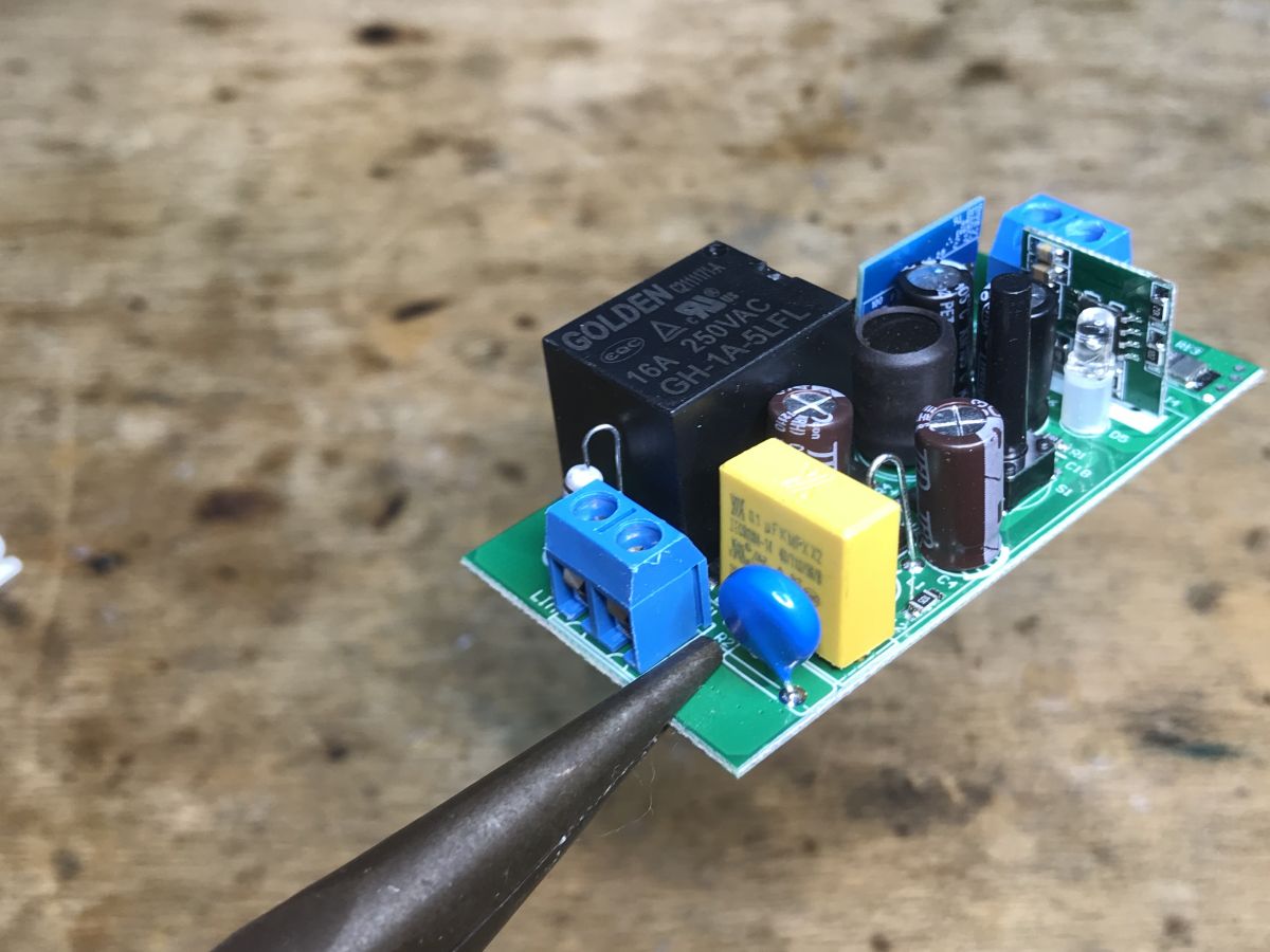

    Interior of the MS-101
    As with other products of this type in this case, all you have to do is pry:

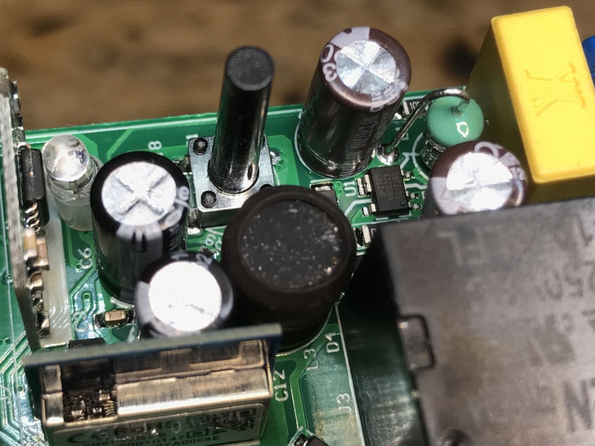

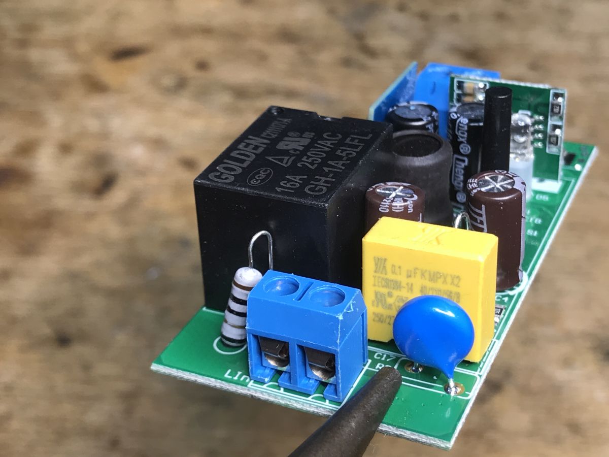

    Immediately inside a positive surprise. Varistor? Or even the X2 capacitor? Many manufacturers do not care a bit about such things, I met such relays only with a fuse resistor ... it is better than usual.
    Then as standard, behind the bridge there are two electrolytic capacitors and a choke between them, then there is probably a converter without galvanic separation, on the PCB you can also see a separate WiFi module and an energy measurement module:

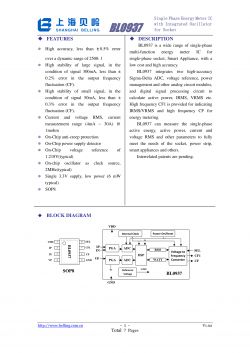

    This energy measurement module is marked WMetBLi1 V1.0. You can also see the current/voltage shunt resistor, R13, coded R002, which is probably 0.02 ohms.

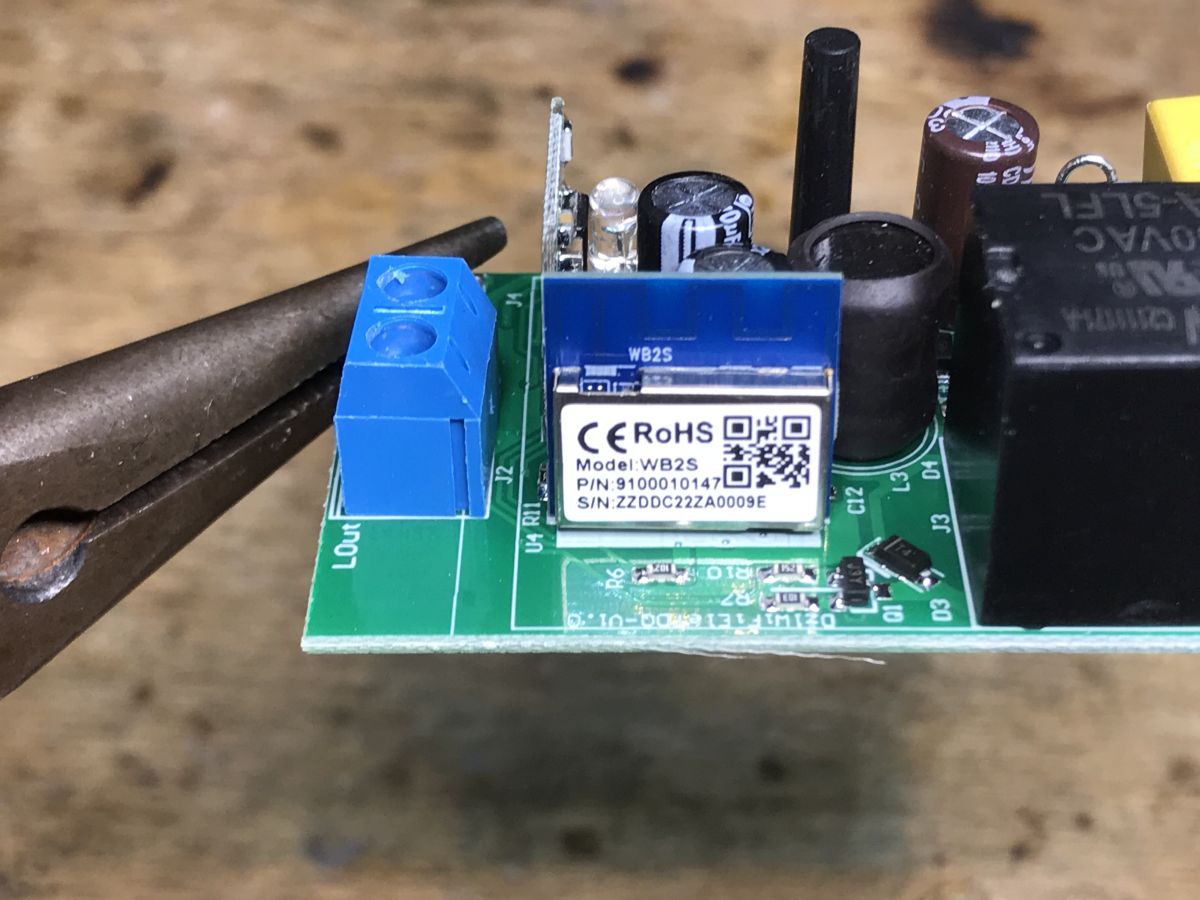

    The WiFi module is WB2S, BK7231T, it is known:

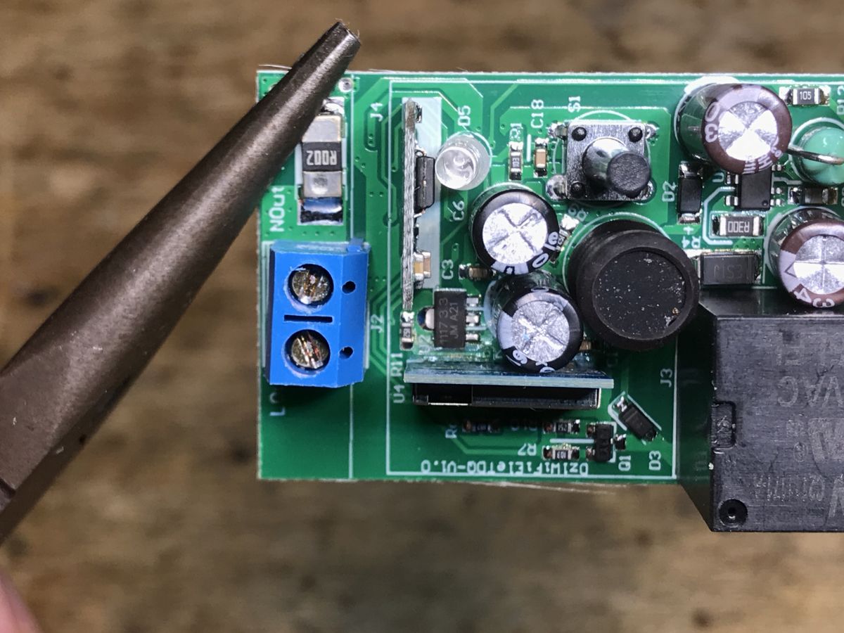

    View from above:

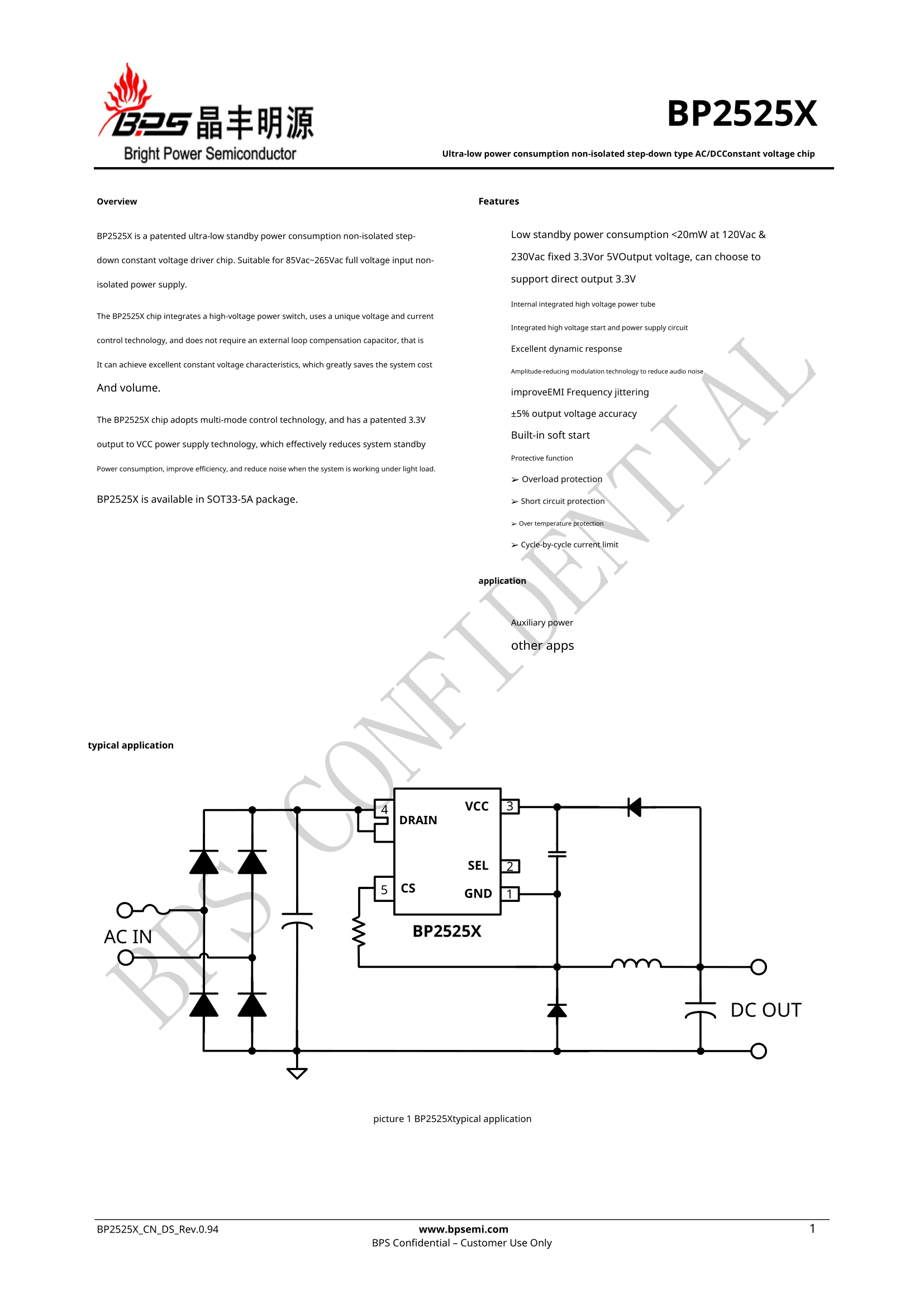

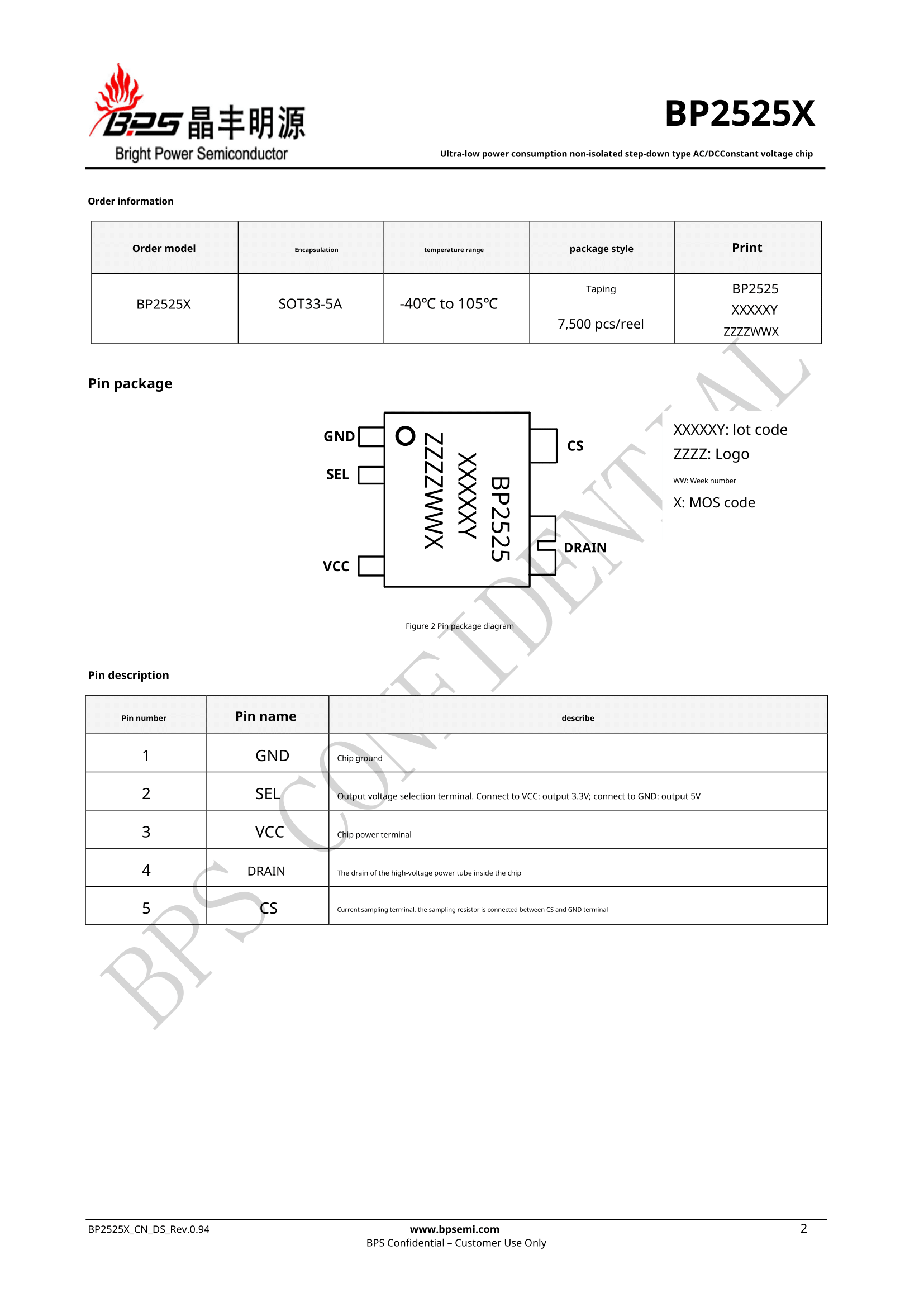

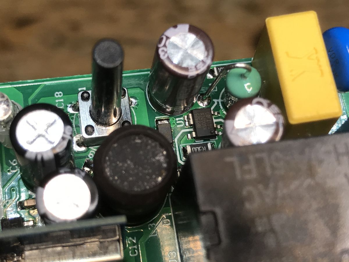

    What does this 5V (and then 3.3V for AMS1117-3.3V) provide for this chip?
    There is BP2525.

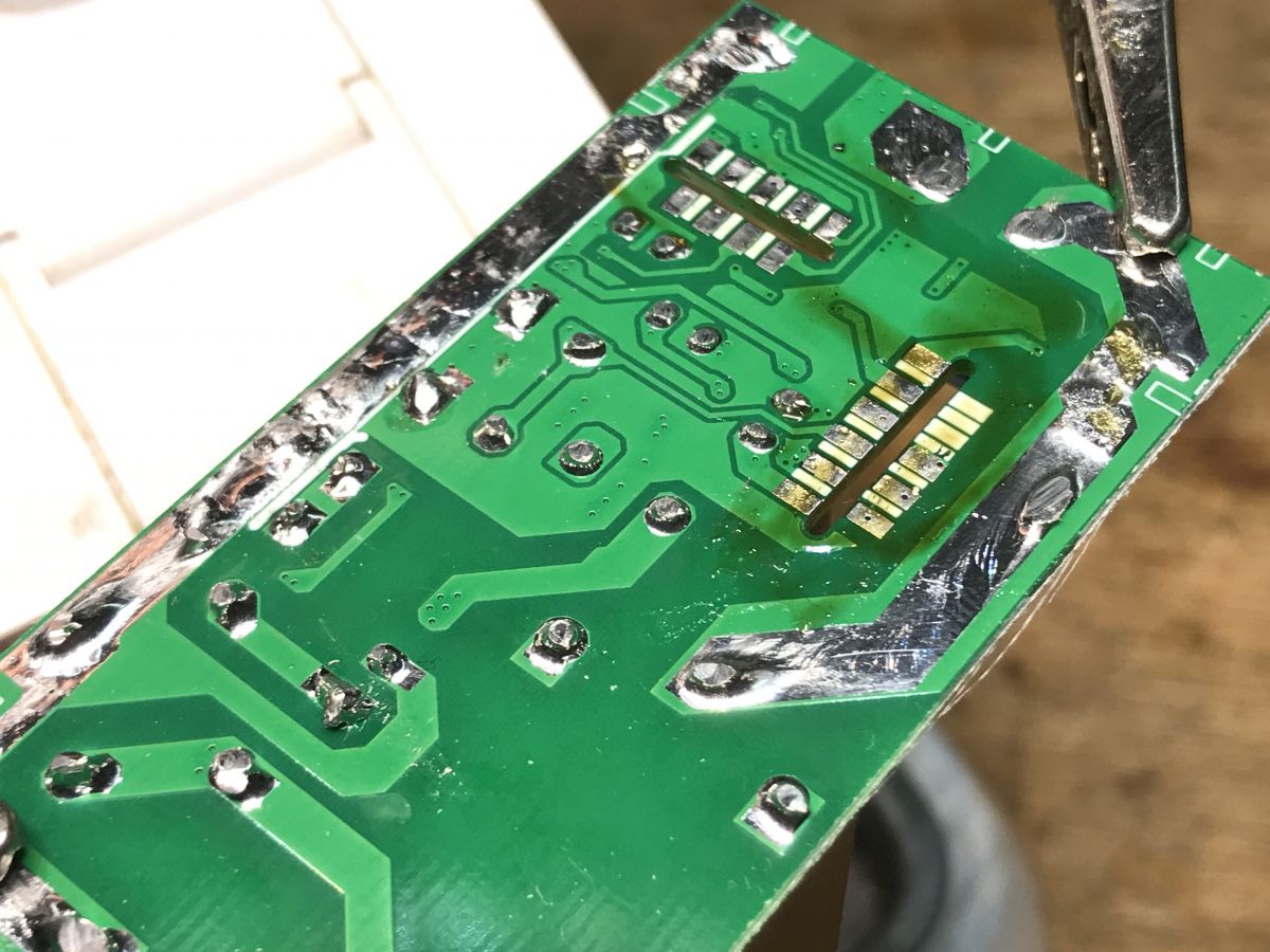

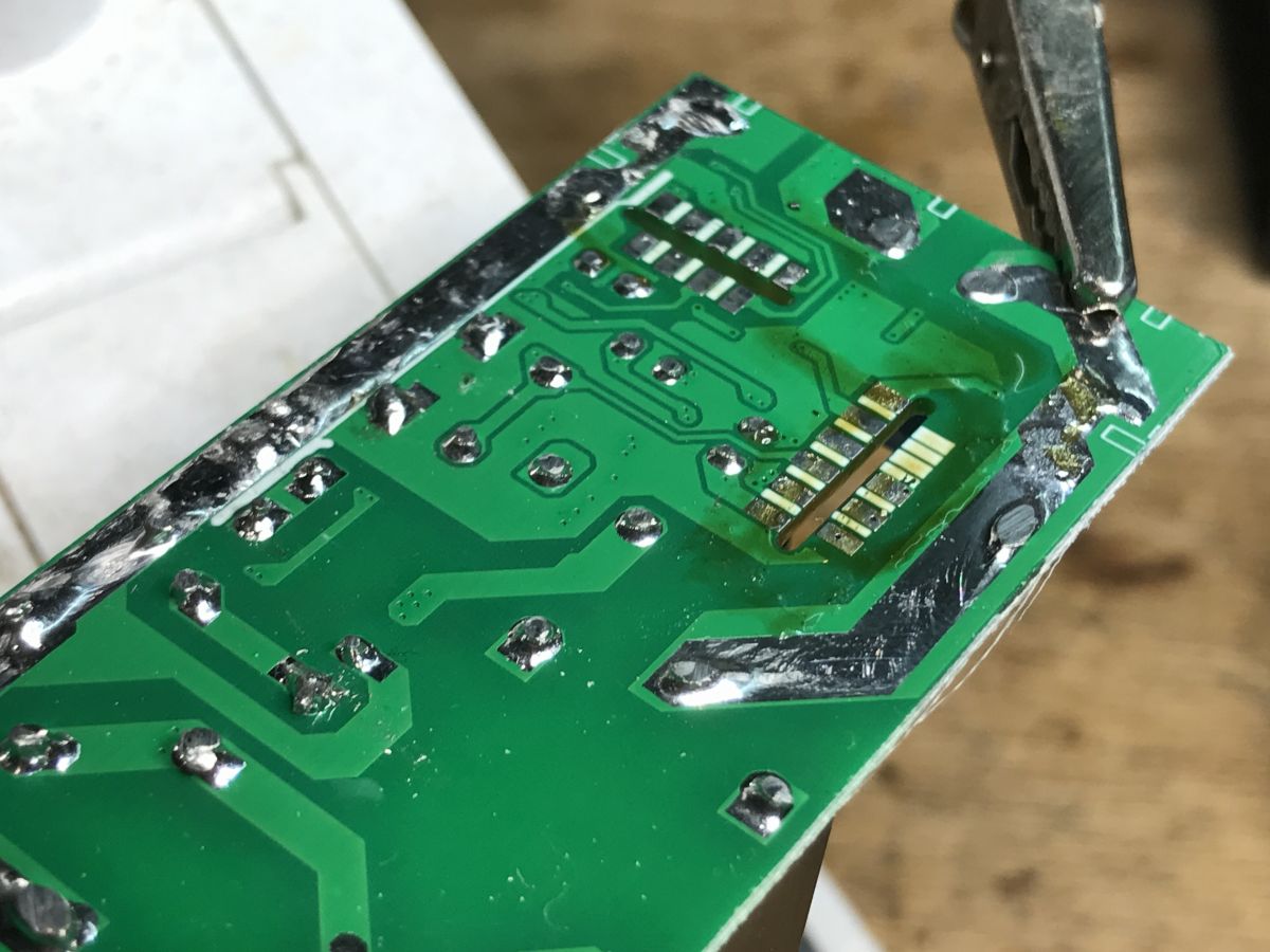

    Another bottom of the PCB:

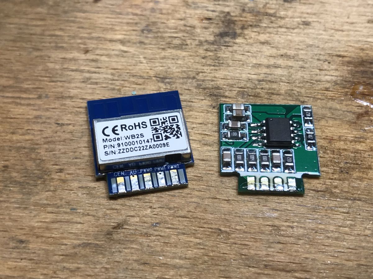

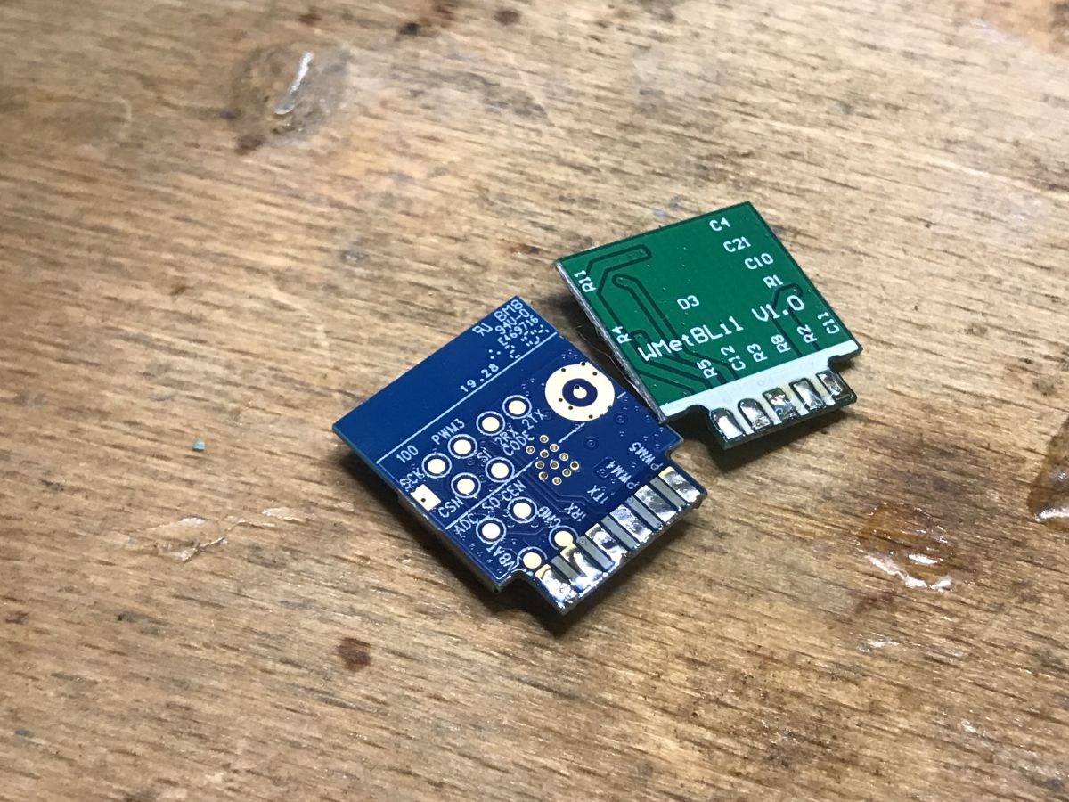

    I desoldered it to take better pictures both modules (to change the firmware, you only need to desolder the WiFi module, and sometimes you can do without it). First we apply the flux, then we collect the tin with a braid:
    Released modules:

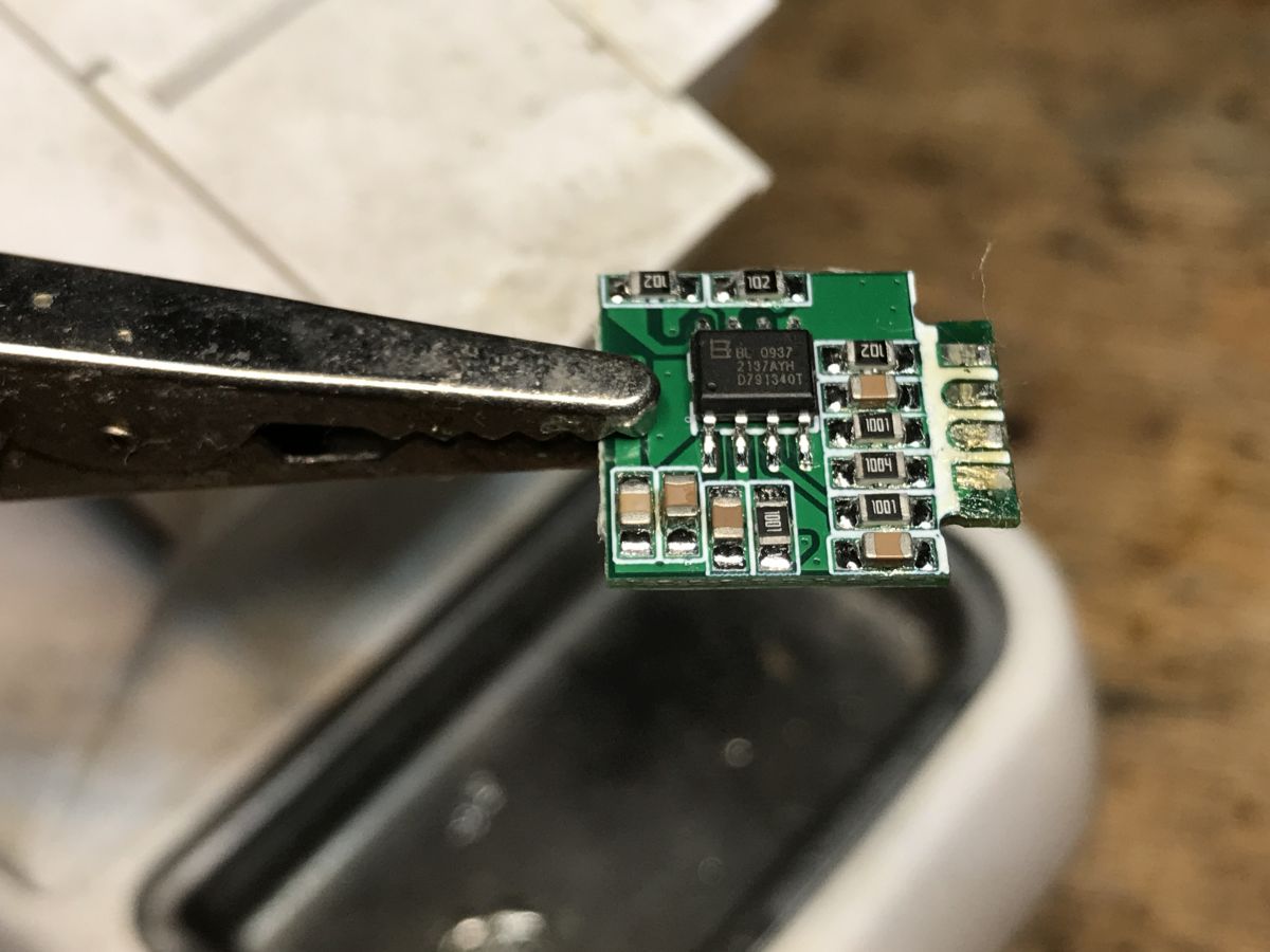

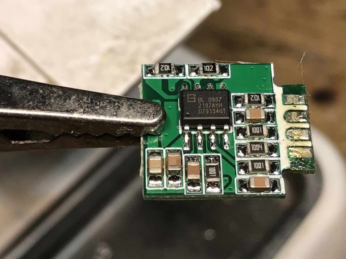

    So WMetBL11 V1.0 is a module for measuring energy ...
    This is the module from BL0937, along with the basic "hardware", but not complete, the current measuring resistor (shunt) is on the main PCB:

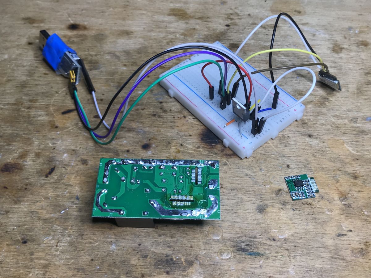

    Firmware change...
    By default, we use BK7231 Easy GUI Flasher:
    You can rely on our videos:
    https://www.youtube.com/playlist?list=PLzbXEc2ebpH0CZDbczAXT94BuSGrd_GoM

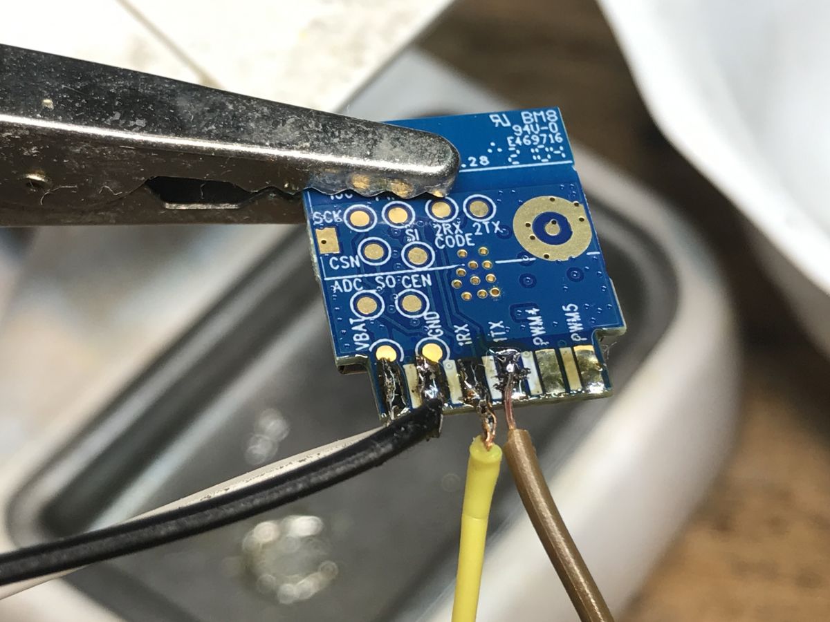

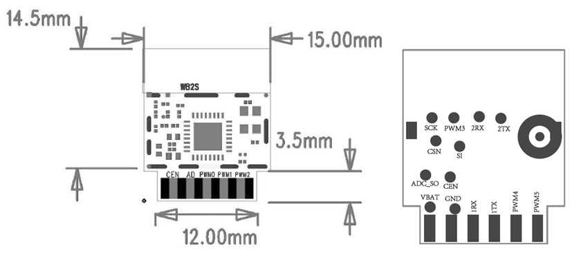

    The module is WB2S (BK7231T):
    Solder the power supply, RX, TX:
    Whole layout:
    Verbal description of the pins:
    Device seems to be using WB2S module, which is BK7231T chip.
    - Relay (channel 1) on P26
    - WiFi LED on P6
    - Button (channel 1) on P10
    - BL0937 ELE on P7
    - BL0937 VI on P8
    - BL0937 SEL on P24

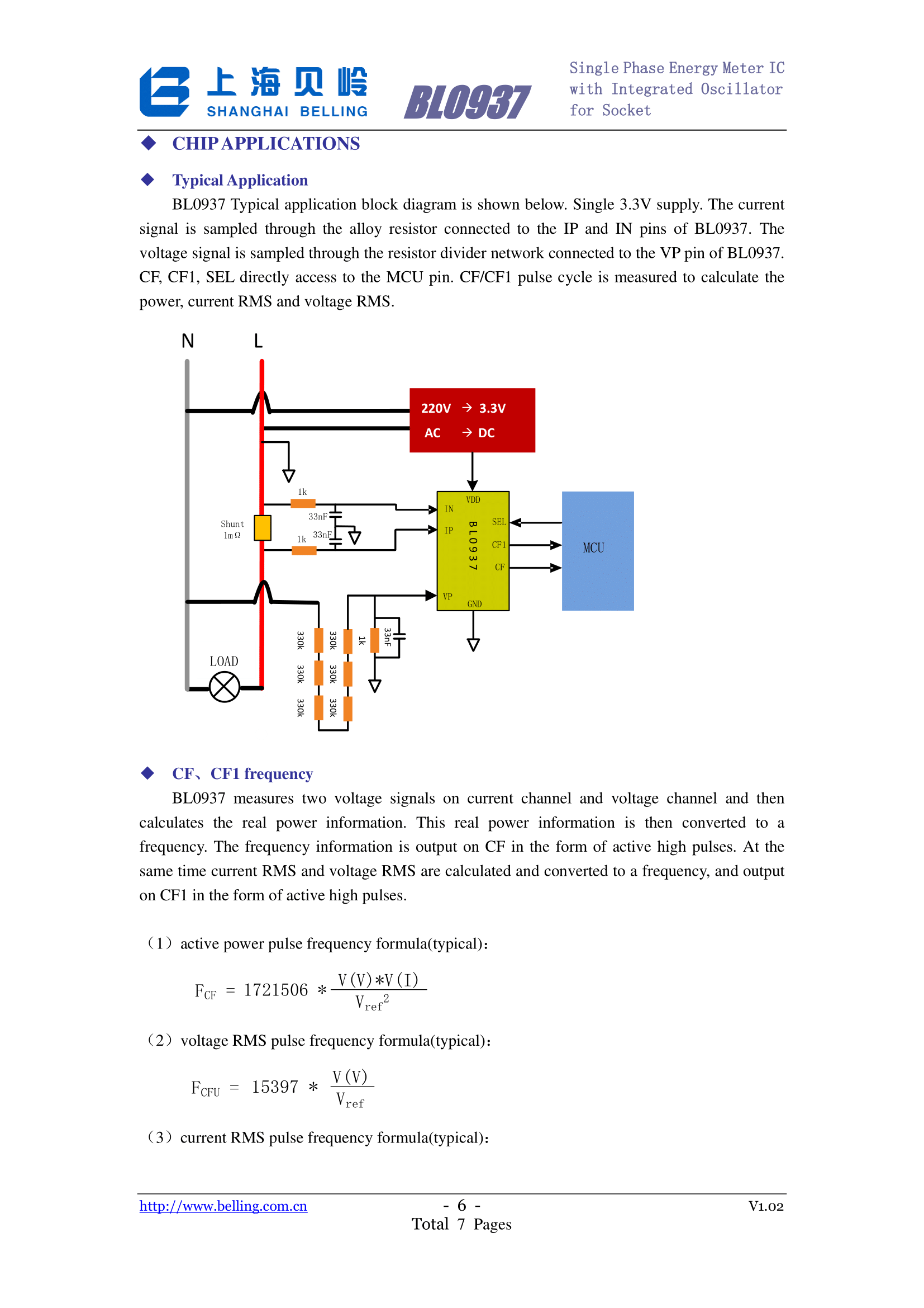

    Well, the "energy meter" - does it work correctly?
  • BL0937 calibration still needed after firmware change
    #3 20660965
    Posts: 14771
    Rate: 12914

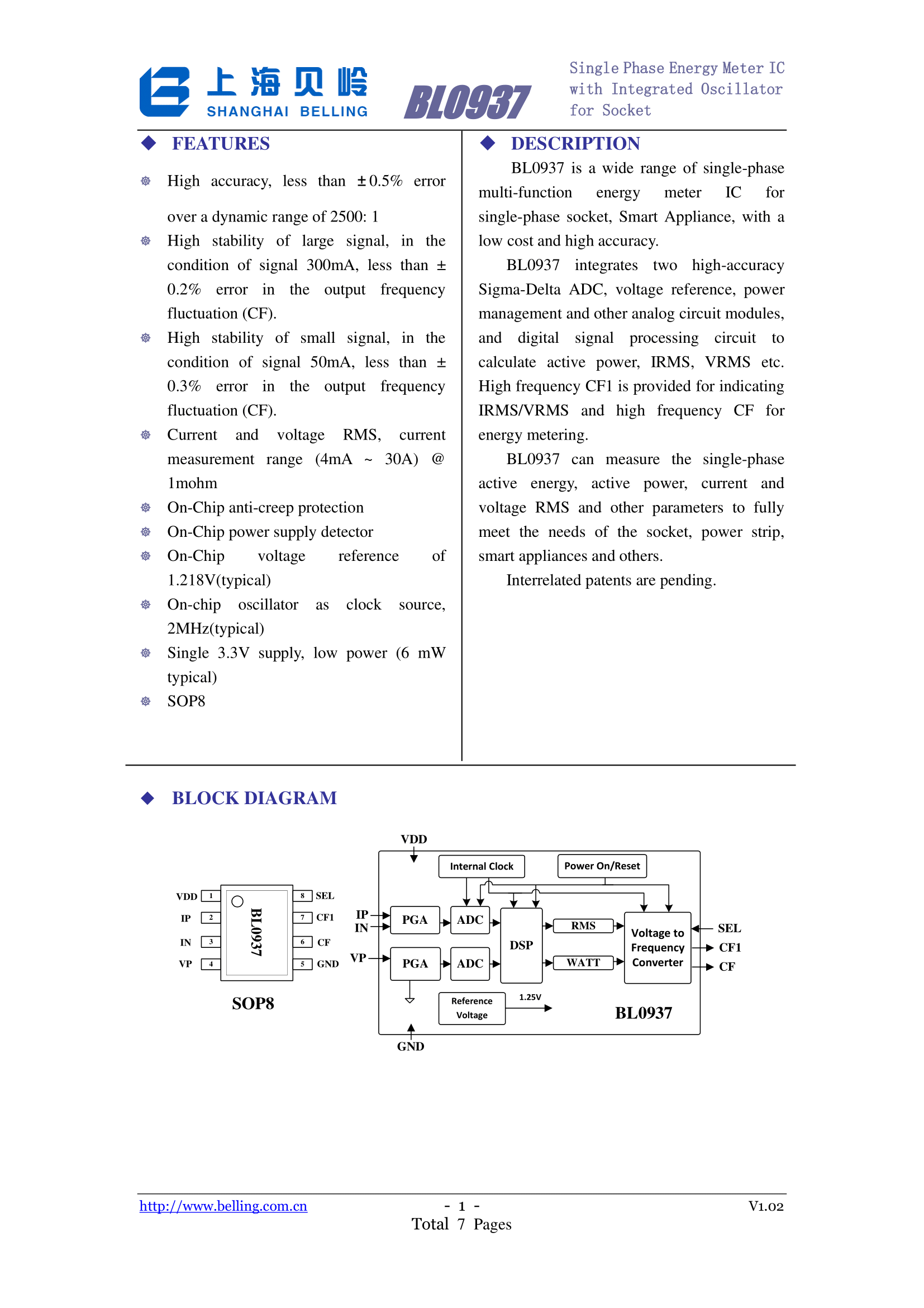

    Energy measurement is carried out on the standard BL0937 chip, very popular in this type of products, right next to its brother BL0942. I did not perform precise measurements precision tests, but it is worth adding that after changing the firmware, we still manually calibrate BL0937 (or BL0942) using a reference to measurements made with a device of a better (I hope) class, as in Tasmot:
    https://tasmota.github.io/docs/Power-Monitoring-Calibration/
    So the quality of the measurements depends to some extent on us.
    It is possible that in the future I will be able to answer your question better, like you could try to do a comparative experiment, take some Tuya device, a better meter, test it and then change the firmware and calibrate it, then we will also check if we can beat the manufacturer's accuracy ... I will think about it.

    @nomek unfortunately you are quite confusing two separate issues here, but no problem, I can clarify.
    OpenBeken is my alternative batch for IoT devices using WiFi modules other than ESP8266. It now includes BK7231T, BK7231N, BL602, XR809, W600 and W800. We upload OpenBeken ourselves, if we do not upload it, it is the manufacturer's batch and everything "works" there, but people do not like the risk of surveillance and limits and the risk that if the manufacturer's server fails, their devices will fail ... they want to be able to pair the device with HA and fully control it.
    My batch is cross-platform, but on the platform from the linked topic (BL602 by Bouffallo lab), there is no BL0937 support yet. It's just that when I tried to do it by feel, it didn't work, and I don't have BL602 + BL0937 in the device to test efficiently, in addition, the lack of BL602 documentation also makes it a bit difficult (it's kind of modest).
    On the other hand, on the BK7231T and BK7231N platforms, the discussed BL0937 and BL0942 fully work and have been working for a very long time. We have support for these two systems along with Tasmota-style calibration (via VoltageSet commands etc, although recently I also added it to the Web App gui in the Tools tab).
    So I assure you, on the Beken platforms (ie BK7231T and BK7231N) these energy measuring chips work and I have already scrolled through 20 or more IoT gadgets with and with Beken and everything worked. The simply linked BL602 is much less popular and I, for example, have never had a live BL602+BL0937 connection to start implementation work on it at all.
    If you have any other questions, feel free to ask, I'll try to help.
